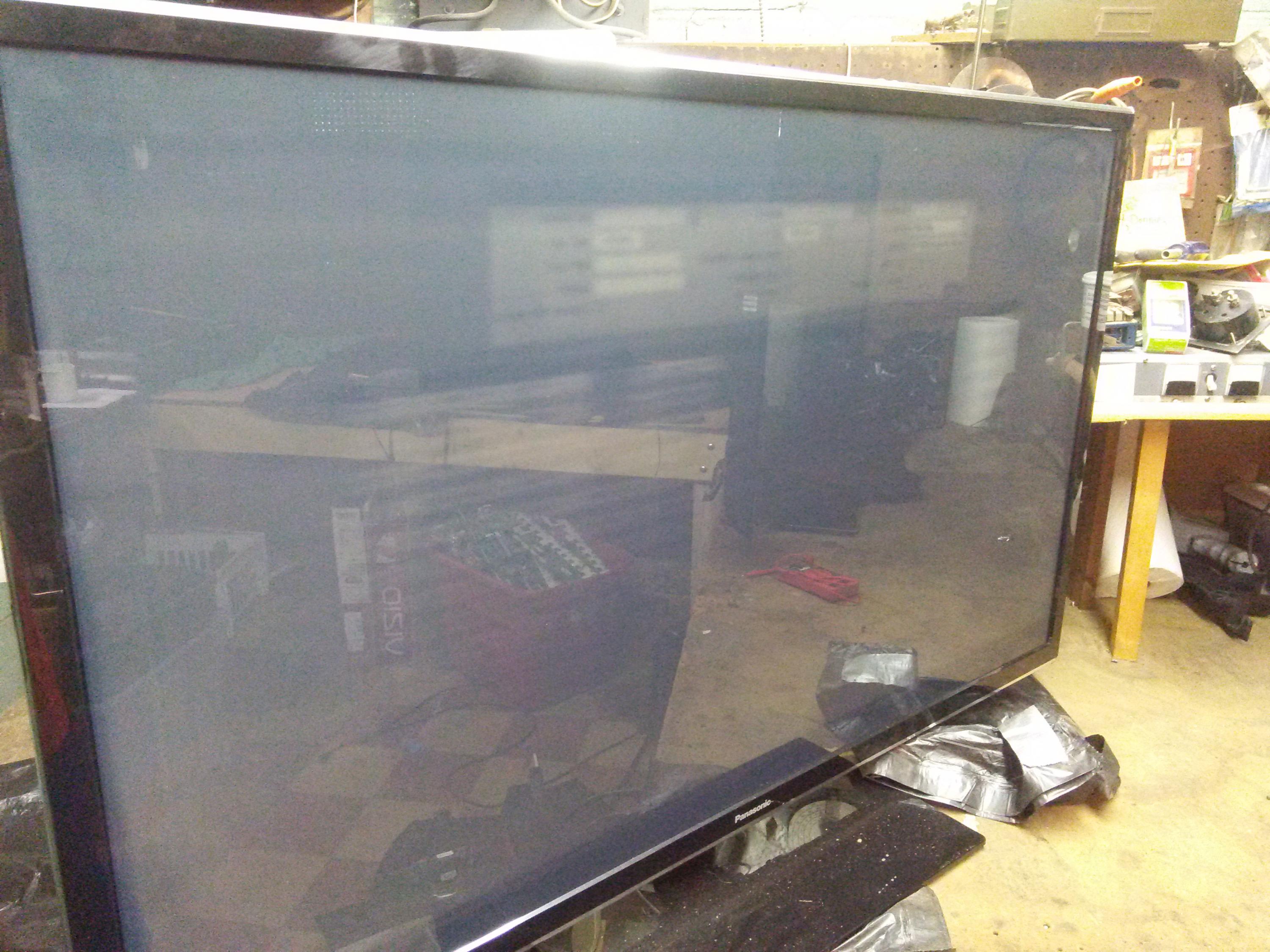

anyway to remove image retention or burnt image panasonic plasma
  • mattstolte
    • Dec 2013
    • 612
    • usa
    just came across a Panasonic plasama that has serious burnt image anyway to get this gone? model tc-p50s60
    Re: anyway to remove image retention or burnt image panasonic plasma
    Nope.
    New panel as well. Maximum 2 years old. Must have been used 24/7 as a computer montor or something ... wow...
    • Per Hansson
      • Jul 2005
      • 5895
      • Sweden
      You could try having it display "with noise" i.e. an untuned channel for a few days.
      But I think it's too severely burnt in to be fixable...
      http://en.wikipedia.org/wiki/Noise_%28video%29
      • ReeceyBurger123
        Never Give Up !
        • May 2014
        • 7325
        • Britain
        You wont be able to remove it but possible lift it off the image slightly, I had an lg that was used in a pub and it has sky sports logo burnt in. I left it running for around a week on a high contrast plasma image burn remover it did lift but still visible.
        • popeye
          • May 2011
          • 155
          You could try injecting a pure white signal and leaving it on permanent may take some time to get better
