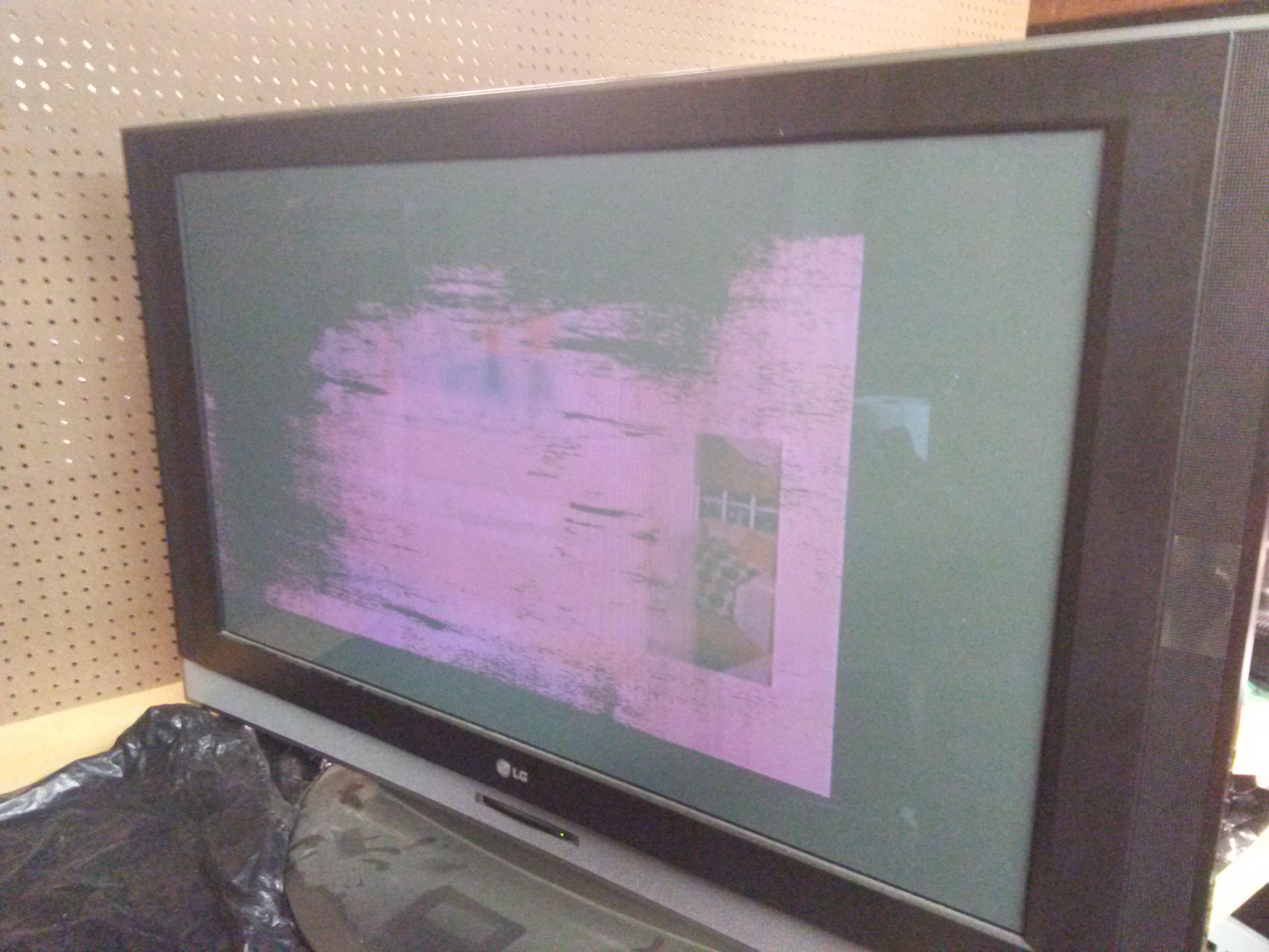

    I have no clue what the problem is with this plasma? can anybody throw out some ideas? It says on but just the picture is screwed up im thinkn ysus?
    Re: lg plasma 42pc3d issue?
    Z-sustain... read the diagnosis thread on plasmas linked in the FAQ... purple picture is almost always Z-sustian.
    It will be IPMs on the Zsus in 99% of cases, rarely economical to fix for these 8-9 year old sets.
      Tom66 is correct Zsus faulty Lower IPM (common fault)
      put you hand on both IPM heatsinks ,i suspect the lower will be cold
