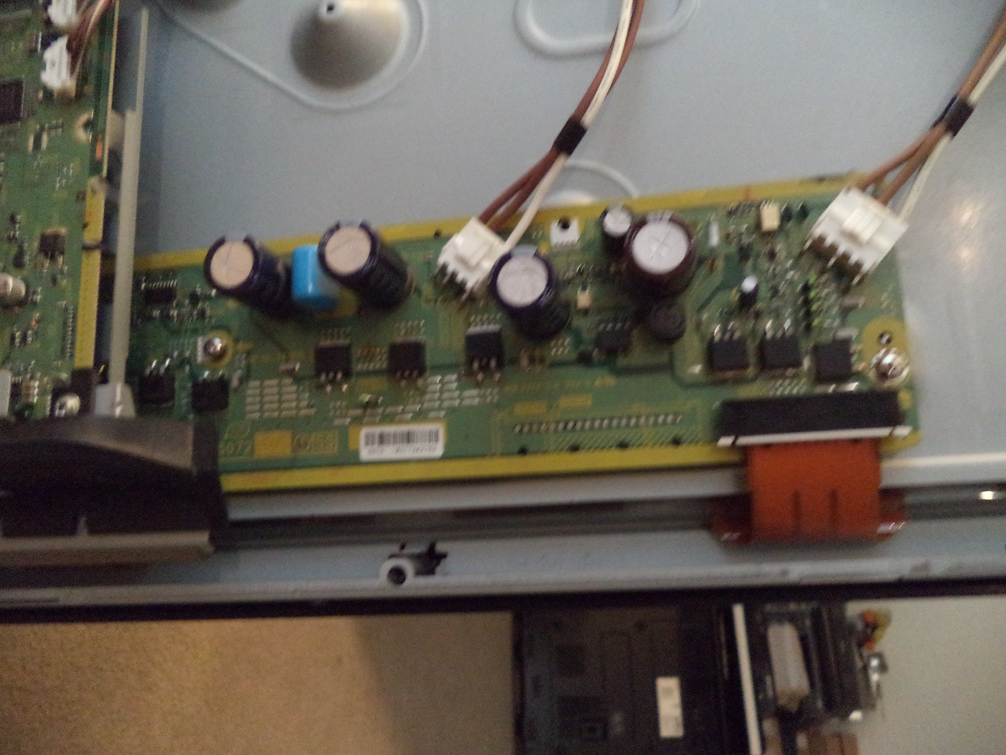

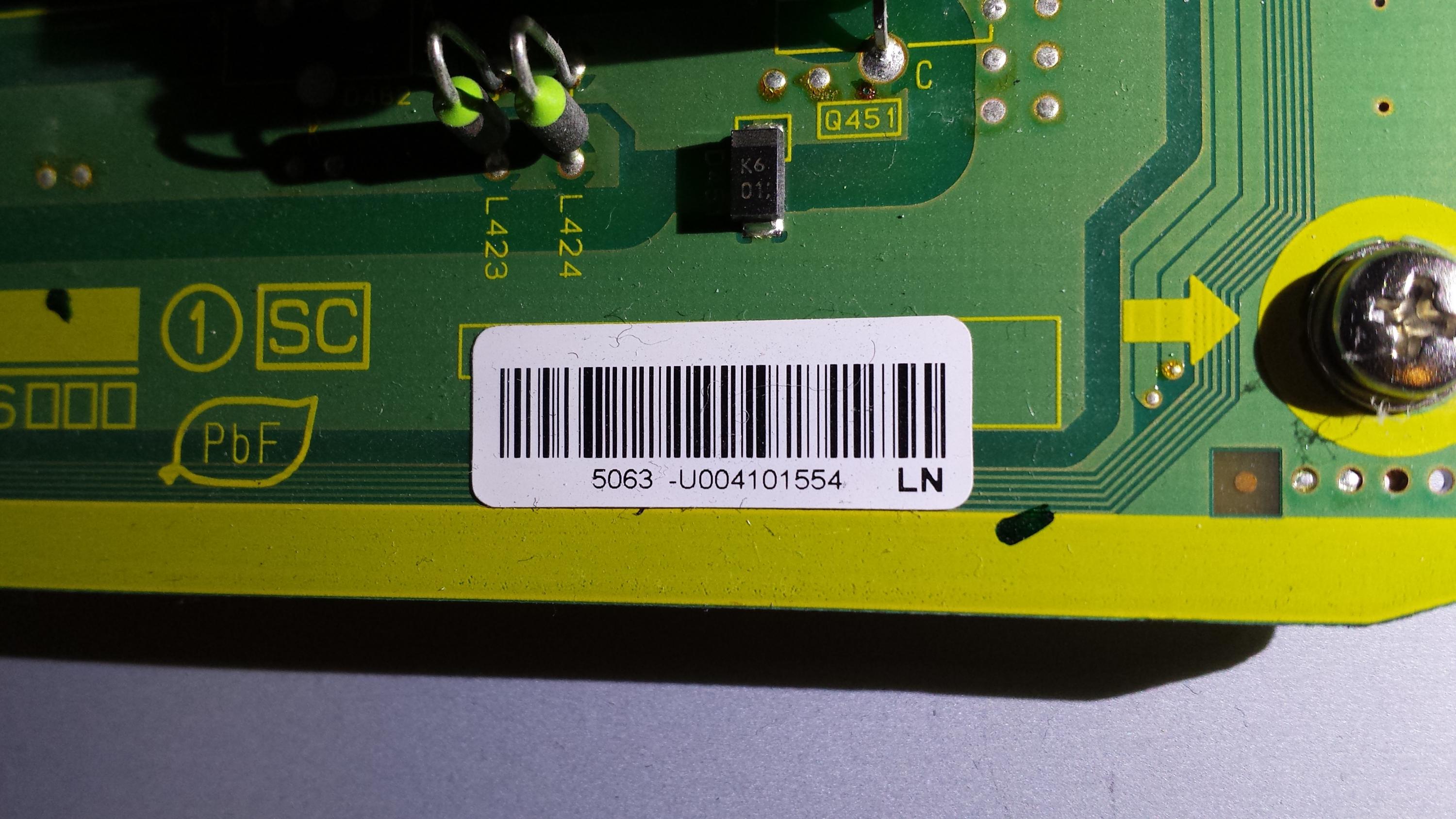

            I do have a low quality picture of the SC board, and it is indeed the TNPA5063. I will add pictures later this evening for clarification.
            I must have gotten the TNPA5105 from shopjimmy's website.

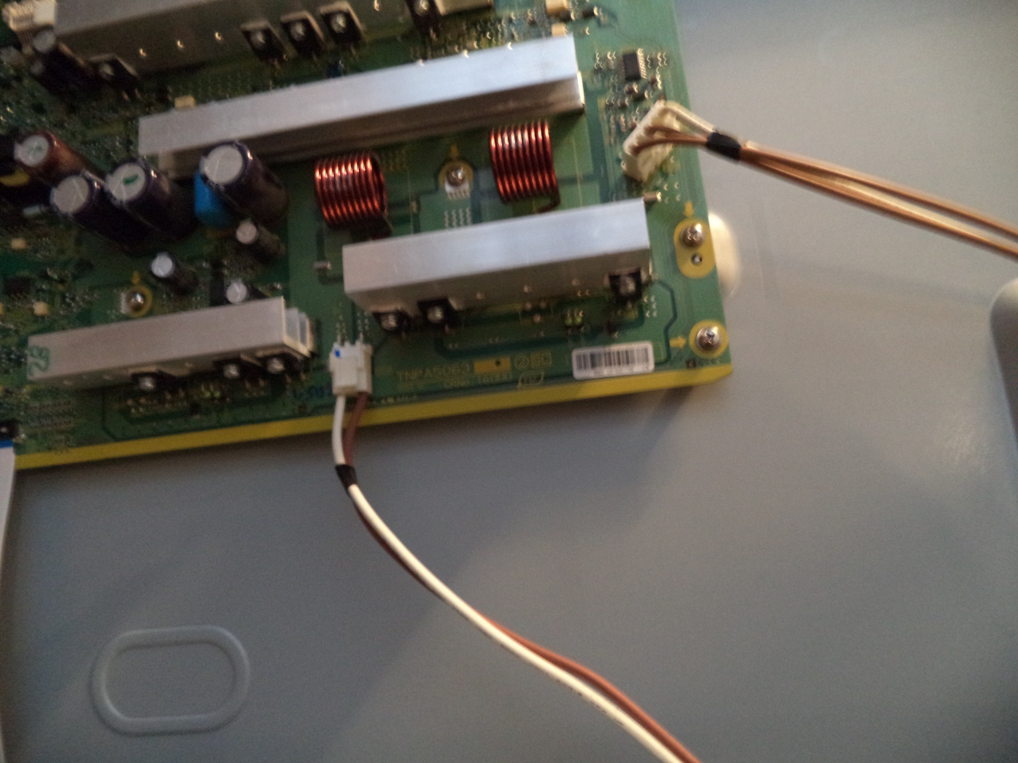

              picture confirmation for SC board TNPA5063
              SS board: TNPA5072
              SU/SD: TNPA 5068/ 5069
              The sale is over, at $65 for the repair is still cheaper what I have seen online.

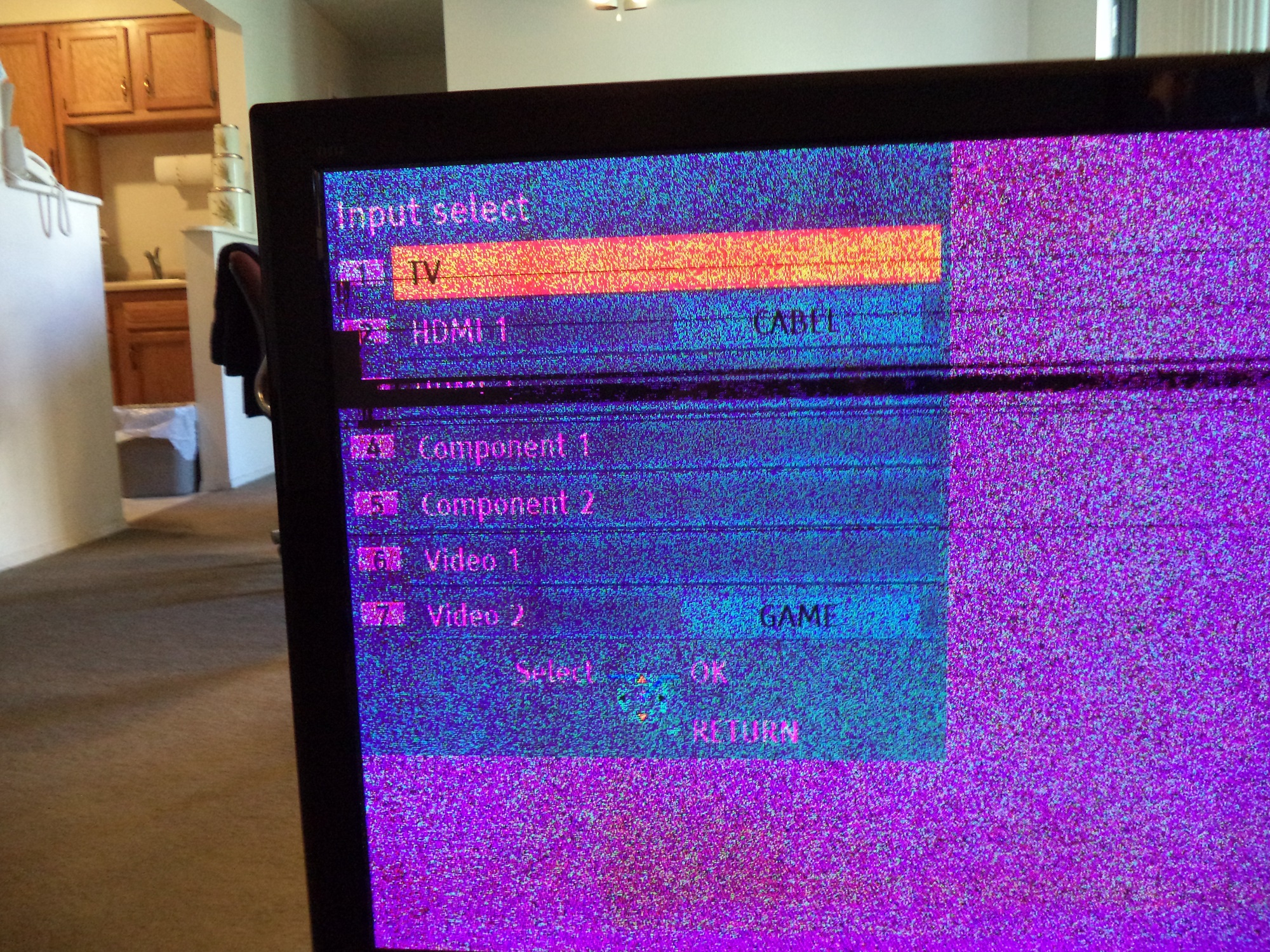

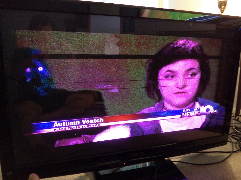

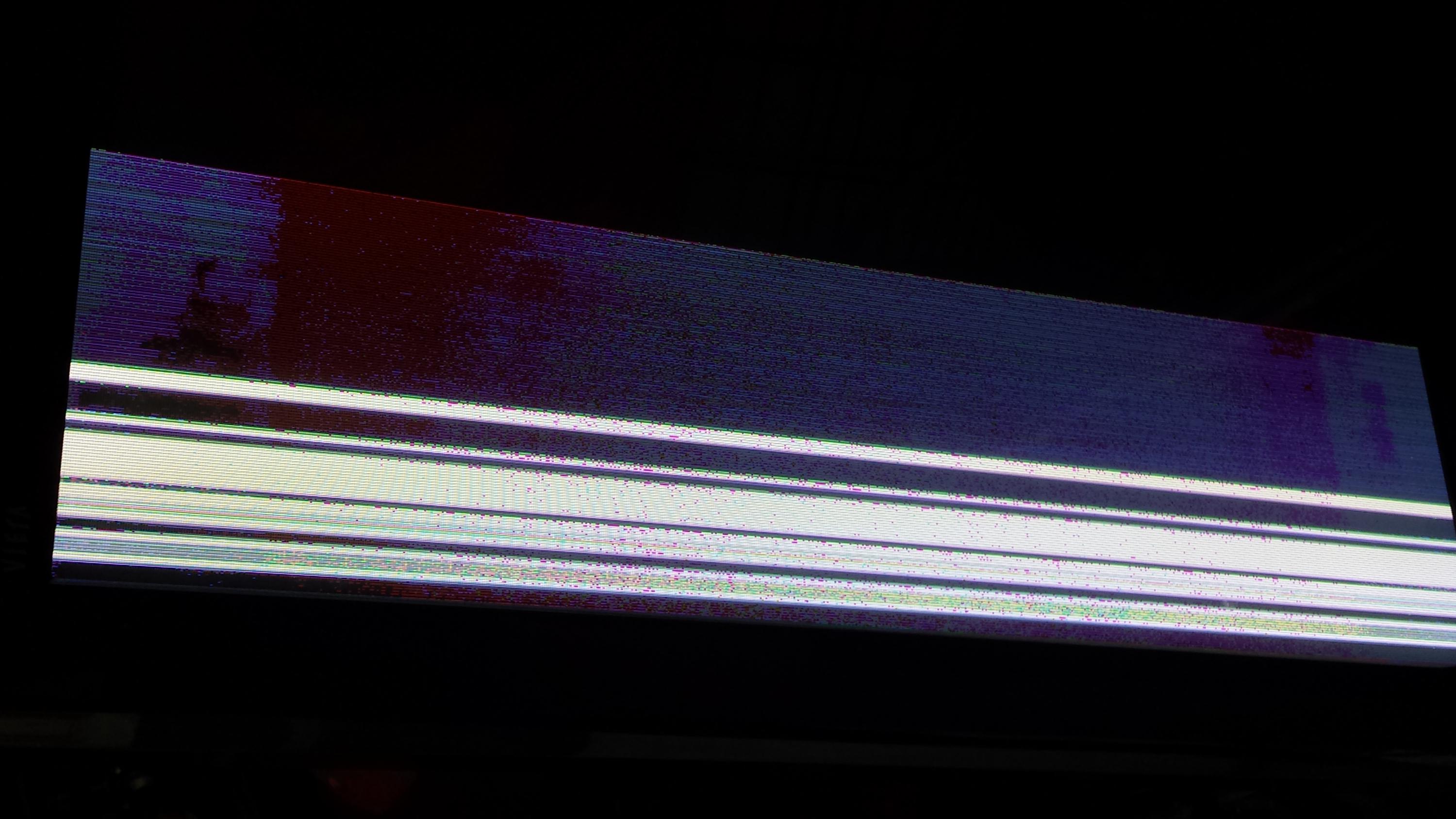

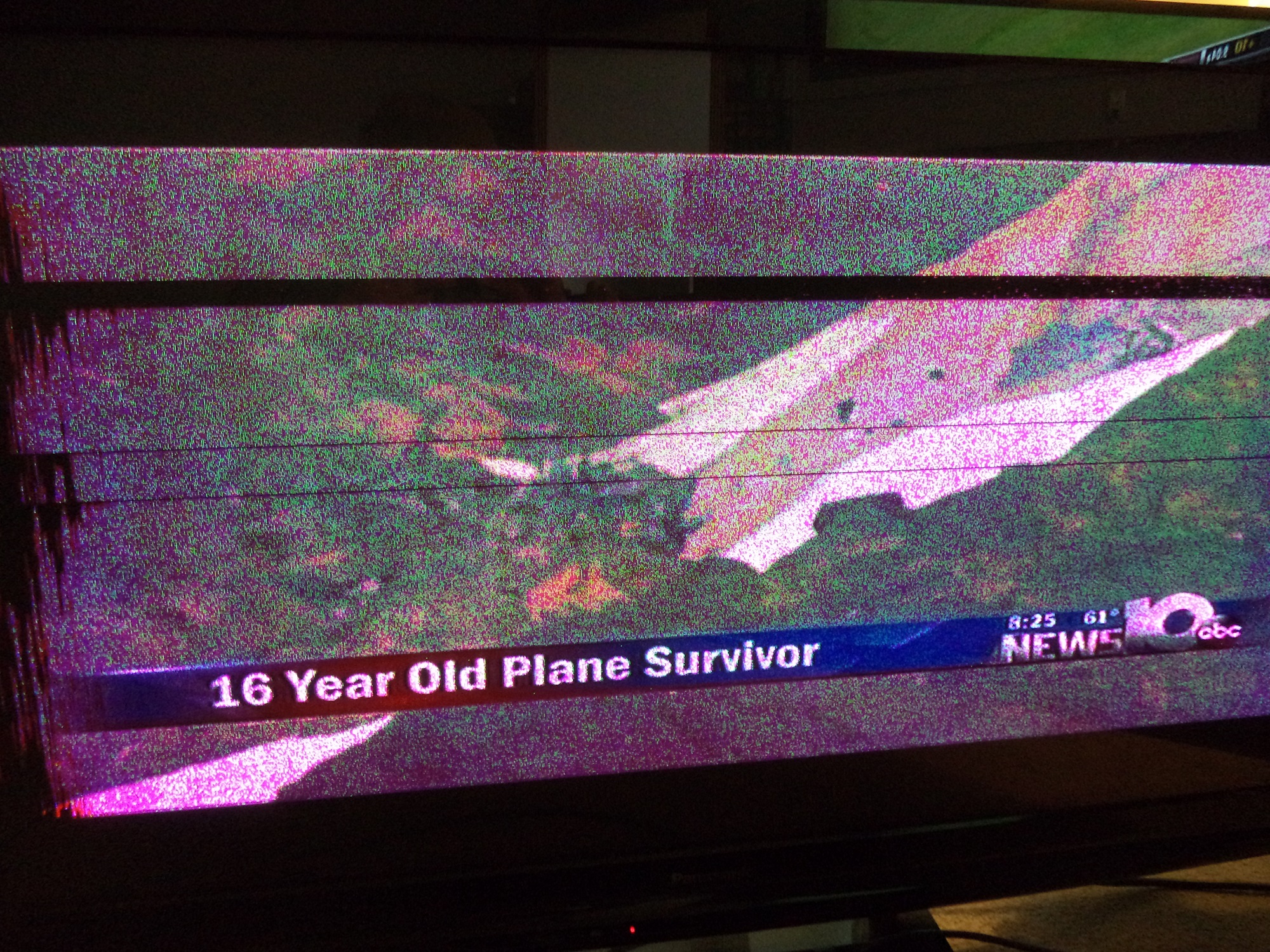

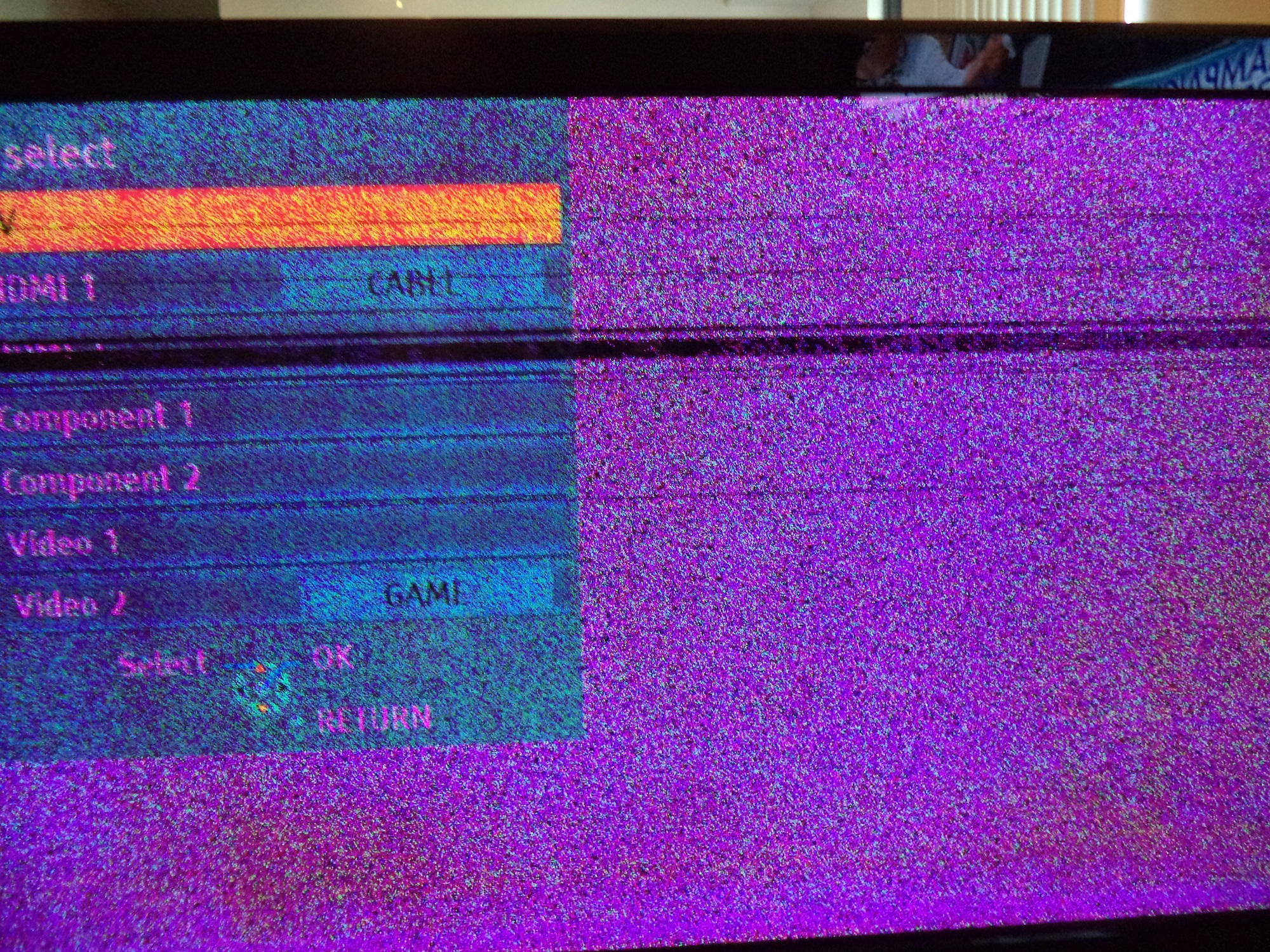

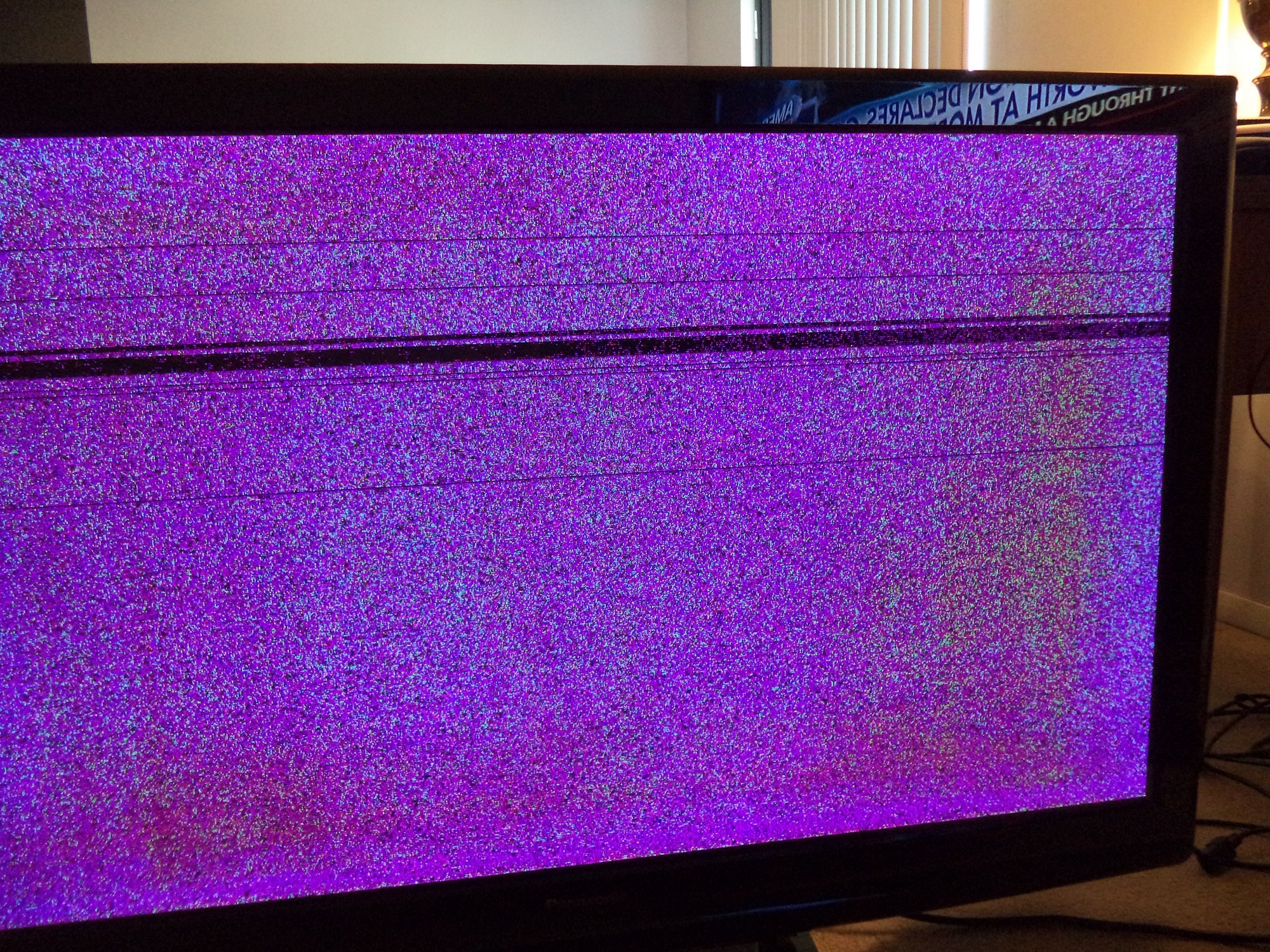

                            Got the SC board repaired and its back in. Now the TV powers on, however, just have red lines on the screen. The SU/SD boards tested high in the resistance test, so I assume those are bad as well. Getting closer on getting this thing working again.
                            See attached pictures. Please note, no input devices are plugged in.

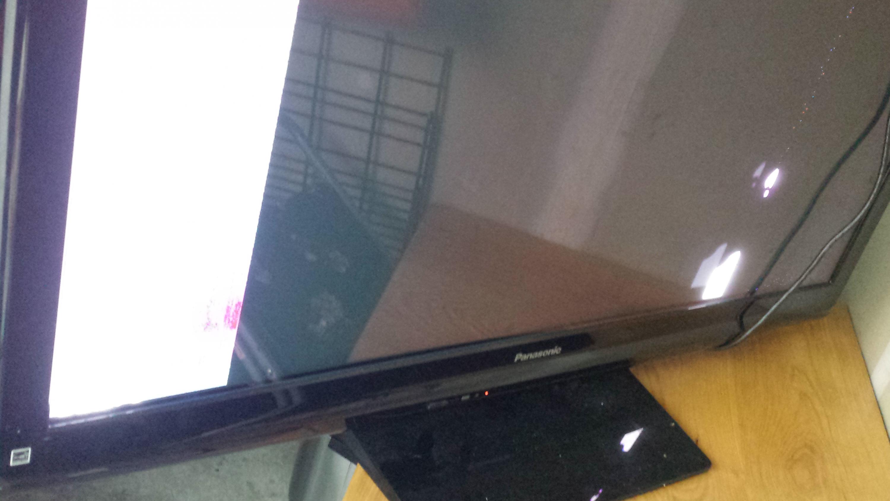

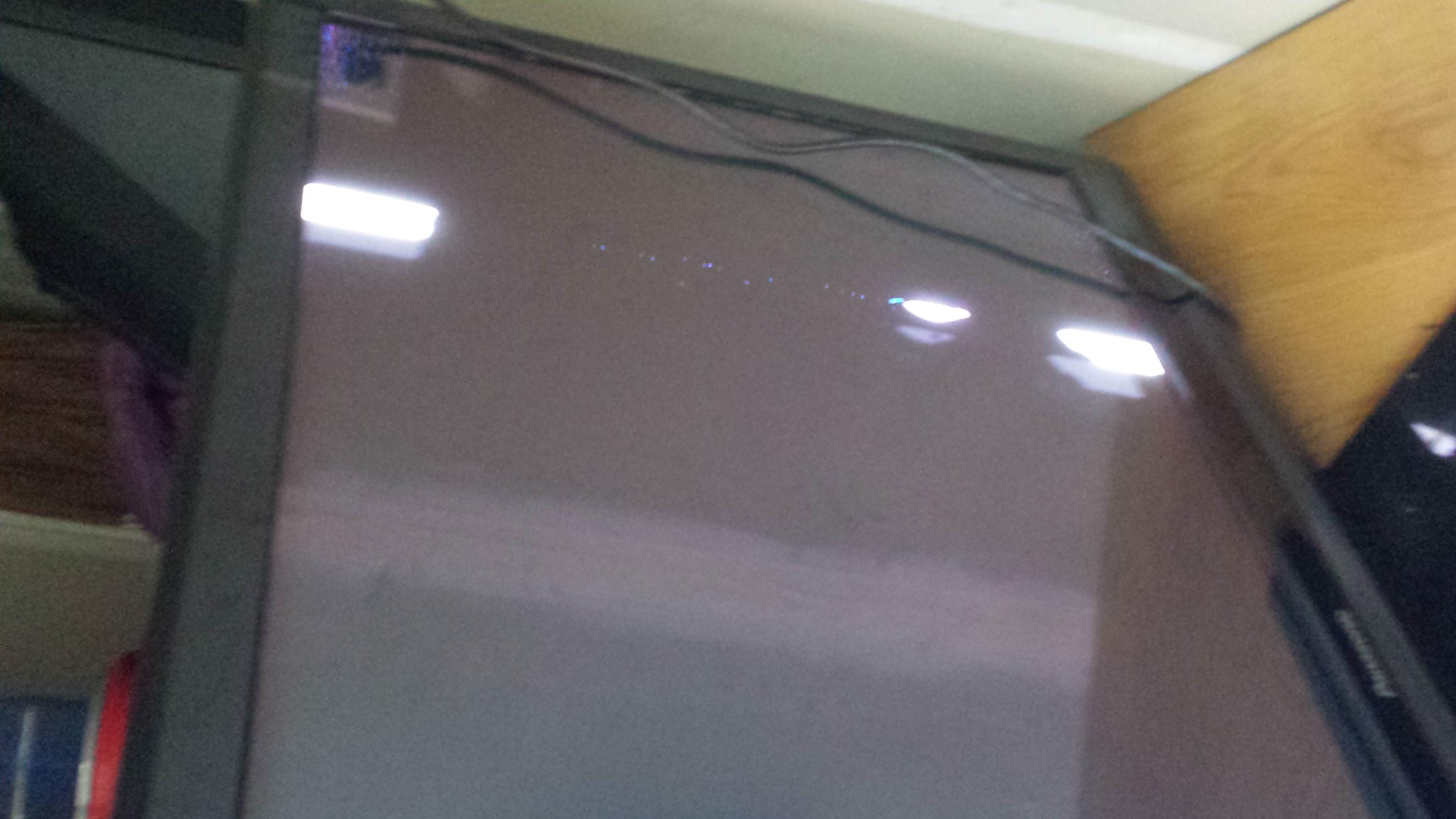

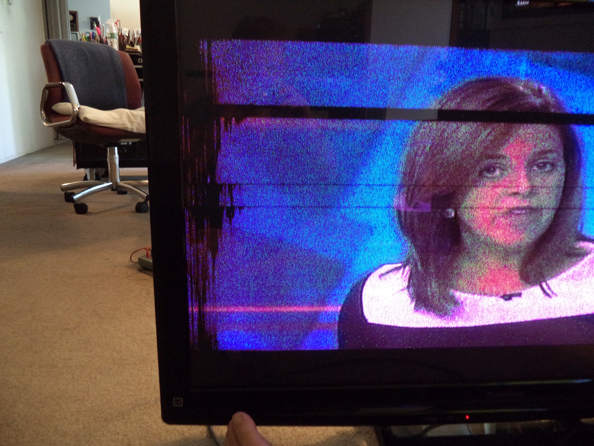

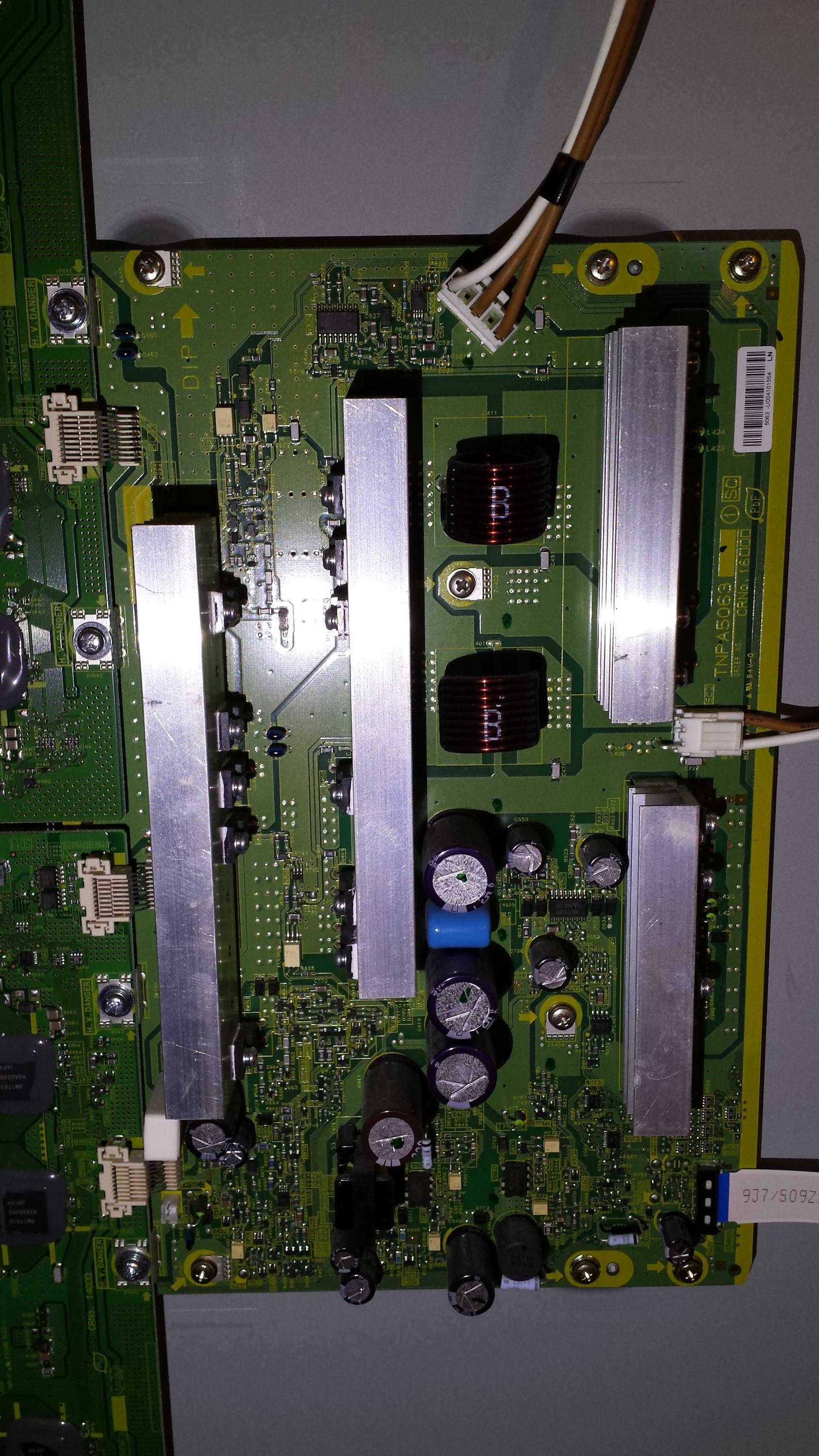

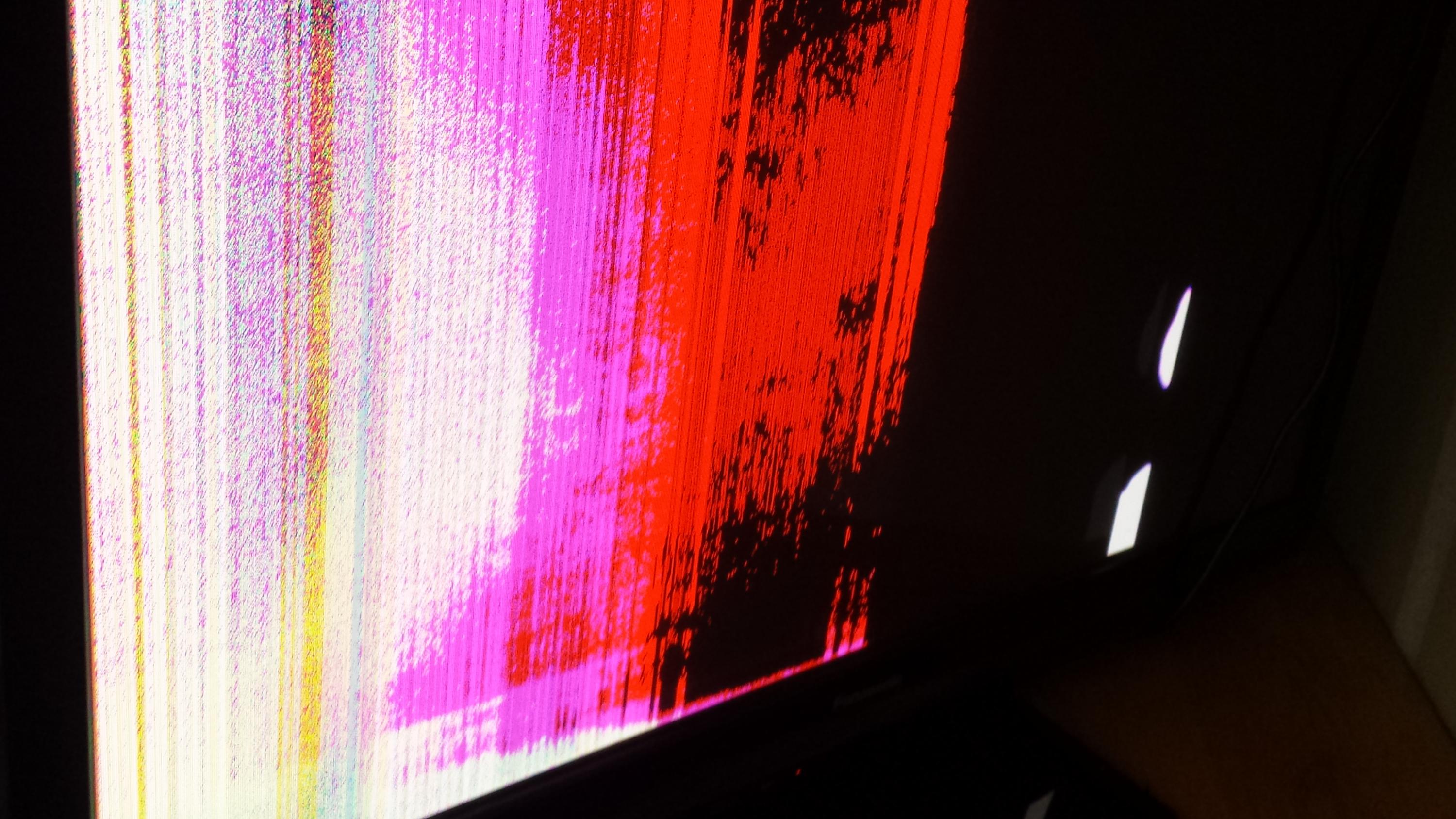

                              Hope someone like Tom or TW can help. After a lot of repairs to this TV i now have a picture but not what i expected. Pro leonk got to the same point i did and the thread ended.
                              SC TNAP5063 SS TNAP5072
                              Started out with 10 blinks. Found SS board with shorted Q001,Q002,Q021,Q022 also replaced IC131. Checked IGBT and diodes tested fine. Turn on TV.
                              Now have 7 blinks. Rechecked SS components and OK. Started reading forum about these plasma and wish i never started. Did all the parts research for finding parts for SC board. Replaced Q661,Q451,D481,D451,IC771,Q701,702,IC521. Checked Q818,Q672,D701,D702 out of ctt. Checked buffers for shorts and tested OK. Put in repaird SC board with SC50 jumpered and NO blink codes. Connect buffers and turn on TV and get the picture in attachment. Not sure what the problem is. Can't see any screen cracks. Don't know if problem is the panel or just missed something in the SS or SC repair. Wanted to replace IC561,IC562 AND IC563 but don't know how they affect picture. After all these parts replaced and time i spent i hope all is not in vain.
                              Here is the reading when TV in running.

                                there's a size limit. no bigger than 2000 x 2000. go advanced then manage attachments. going to bed though so I'll have a look later, can't pronise I'll know what's wrong, not a model I had much fun with in the 42" size and lots of dramas

                                  Hope i have this resizing down. Bought this camera for Ebay sales. Didn't know about the resize for upload. I can do more pics now if anyone needs them. Hope someone can help. I saw something Tom put up that these probems are SS related. Now to the upload

                                    i would say you need to reseat some of the buffer ribbons for the lines and SS board is most likely the fault. Is everything connected on the SS, there's a small connection hidden under the a board on the ss is that connected.
                                    maybe take the SS out and take some decent shots of the repair work so we can see just in case something is obvious.
                                    I think the 50" SS boards are still obtainable

                                        Day started out OK. Read TW post and reseated the buffer jumpers. Took a little work and used a litle Deoxit on them. Got all the black lines cleared up. That was great and thanks TW. Still had the snowy dim picture. This is the bad part. Before i even got to take pictures i thought i would take some reading on the SS board. I was on Q102 and POP!!! My probe went source to drain. Now back to 10 blinks again. Didn't find any shorts on SS but SC shorted Q441,Q661,Q401,Q402,Q421 and Q422. So how have to order more parts from UTsource so on hold for a while. Thanks again and will get back soon.

                                          The panel is primed as there is a slight glow from the entire panel. This means the problem should be logic related. The service manual also confirms this and recommends replacing the A or the D board.
                                          I have tried to get the TV to display the test sequence but I have been unable to and I don't even know if this TV has a test sequence or not. I tried following tom66's instructions in post #3 on this thread https://www.badcaps.net/forum/showthread.php?t=26790. There was...
