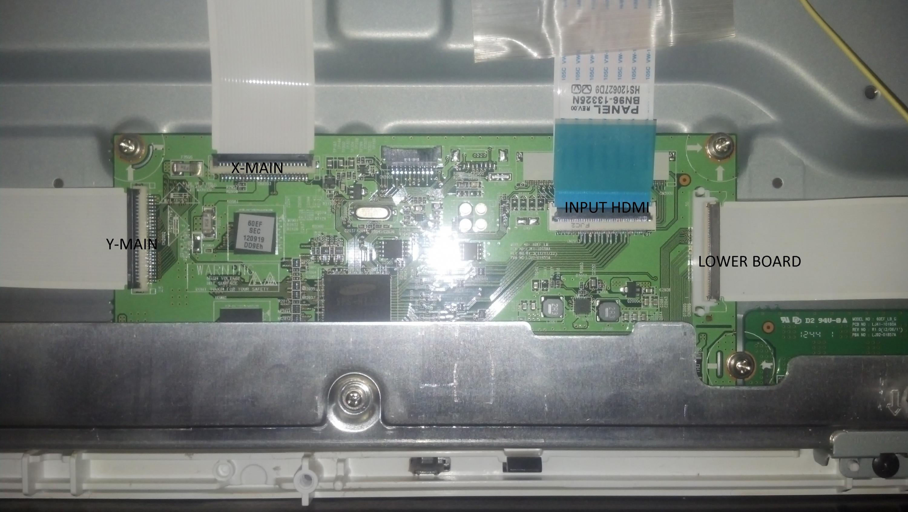

I bought a 60" plasma that would intermittently display the picture. It would always have sound. After a couple days it would no longer display at all. The logic board will flash every 5 seconds. I found two televisions with the same boards. I bought both television sets with cracked screens (cheap). I changed all the boards. Still no picture. Same result with the logic board. I changed the y main and buffers, x main and buffer, the power board and all the cables. from the 3rd set. Still no change. The ve and va voltages are good. If i unhook the ribbon to the y main the logic board flashes normally. Any advice on what next?
