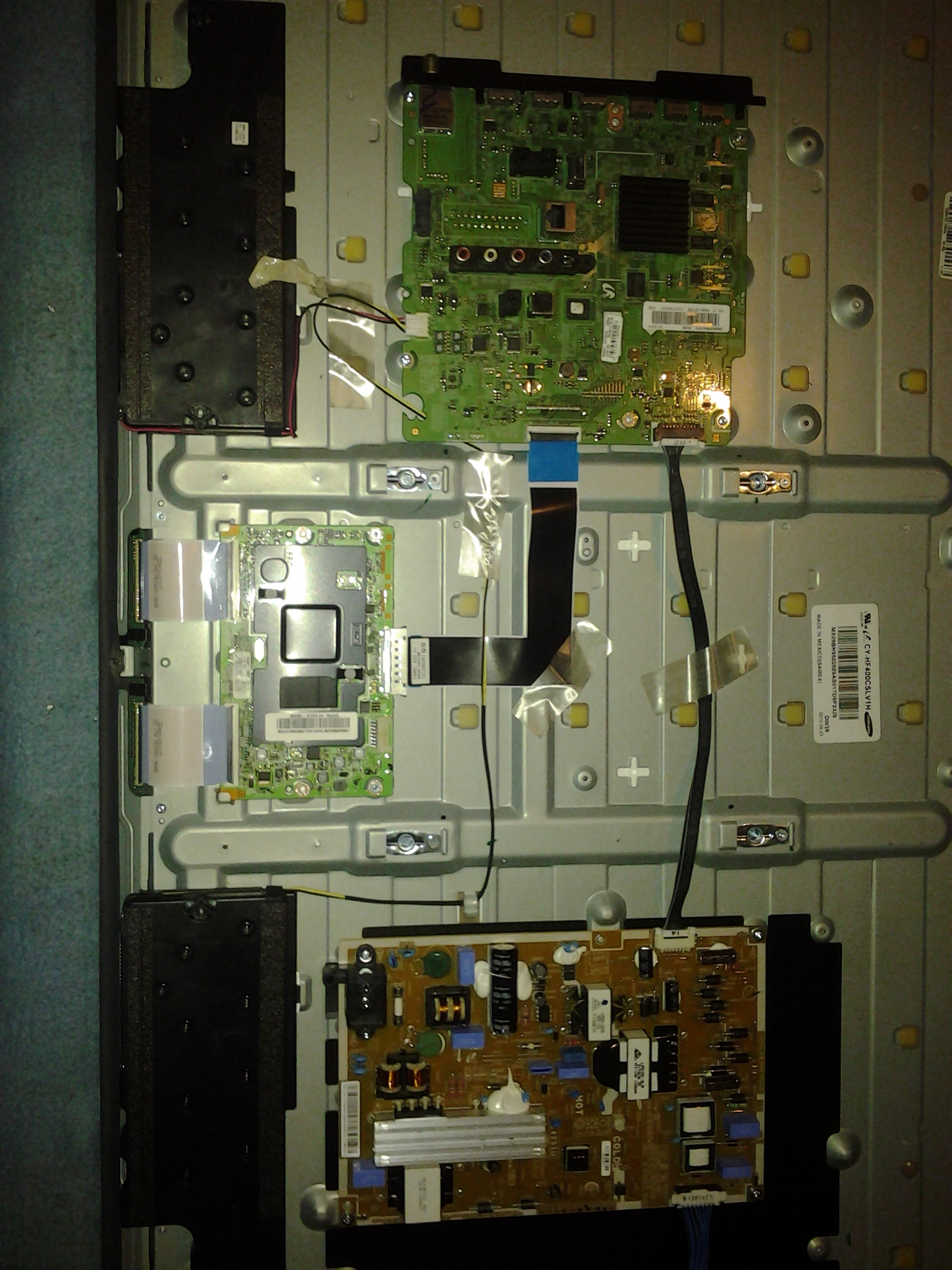

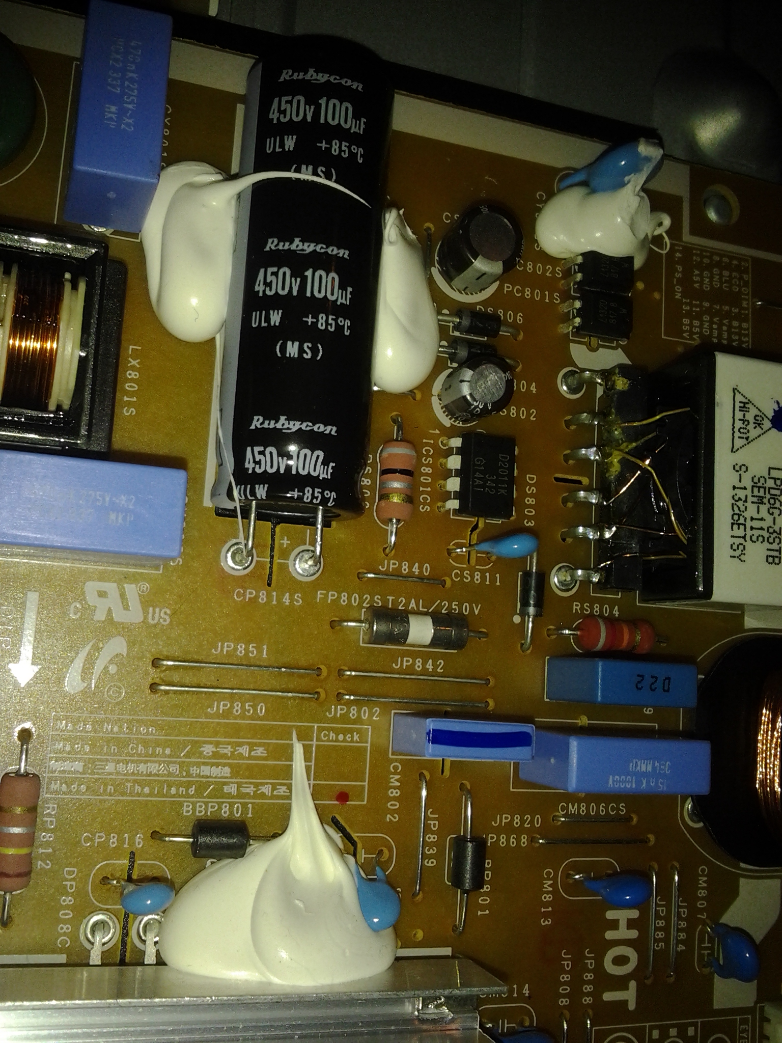

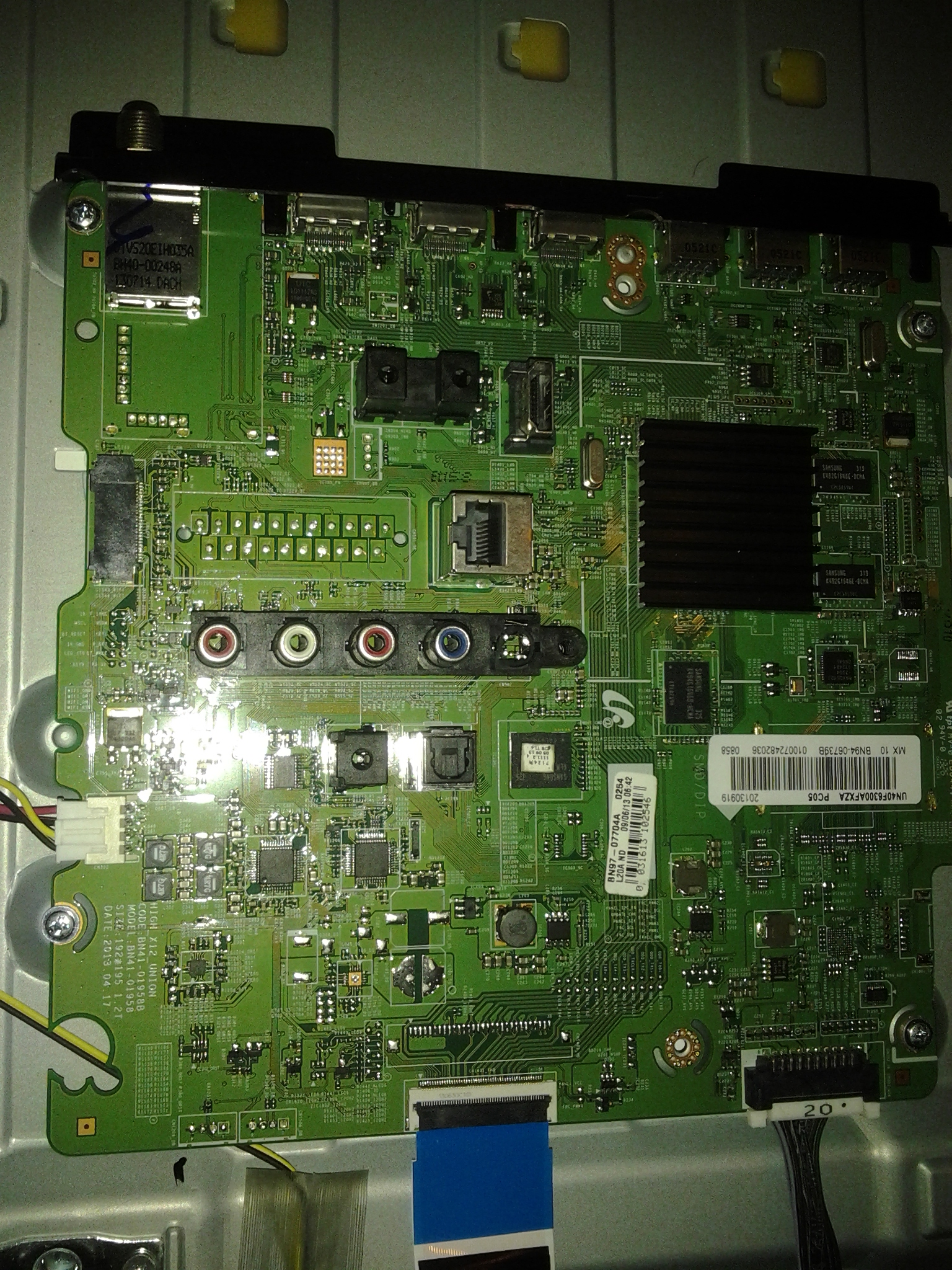

    classic samsung I think but I can't find a bad cap.red led power light is on.When power button is pushed it blinks twice 5 times then goes back to solid red,then repeats.thx for the time.
  • Hamie
    • Apr 2014
    • 1383

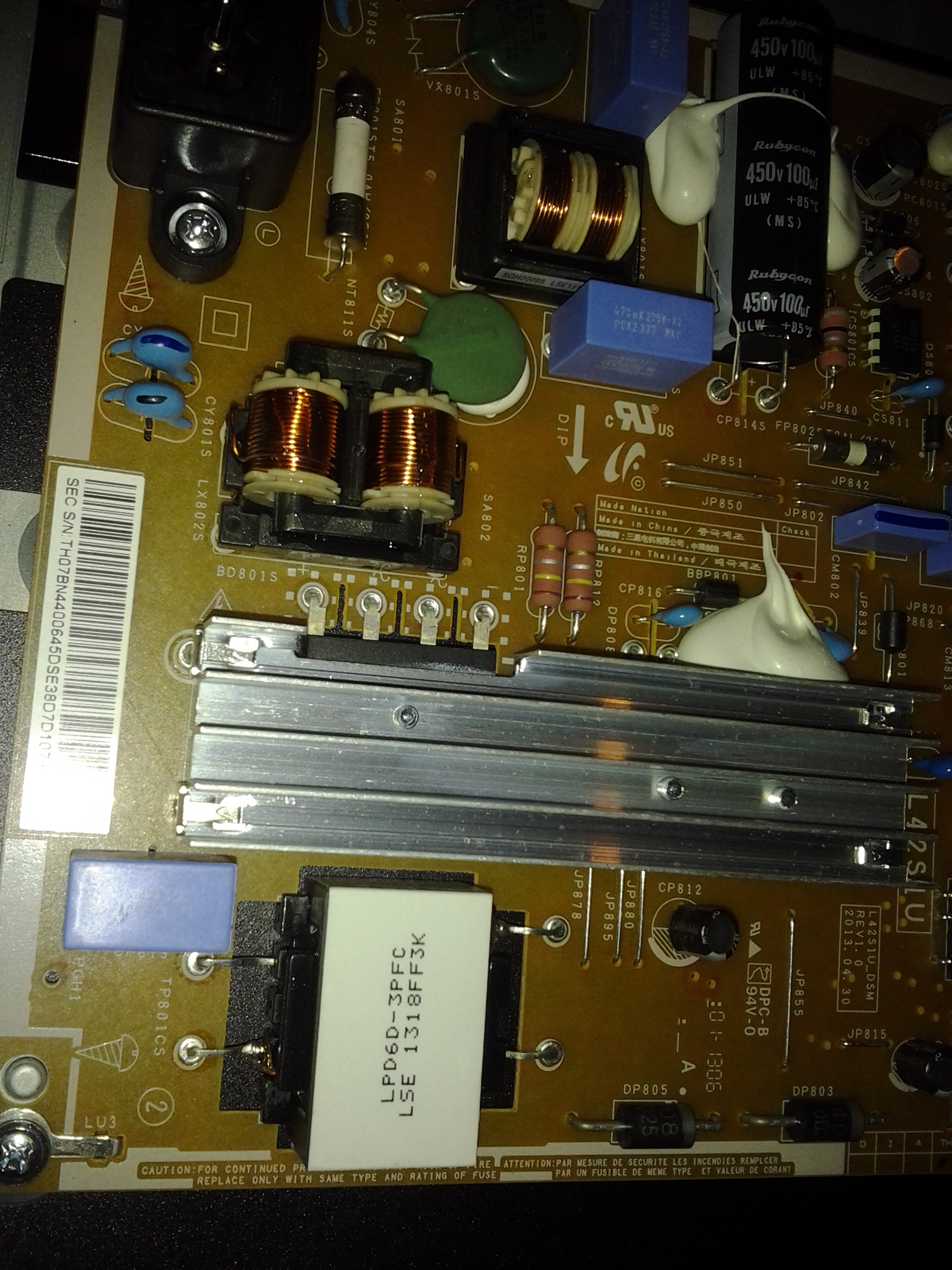

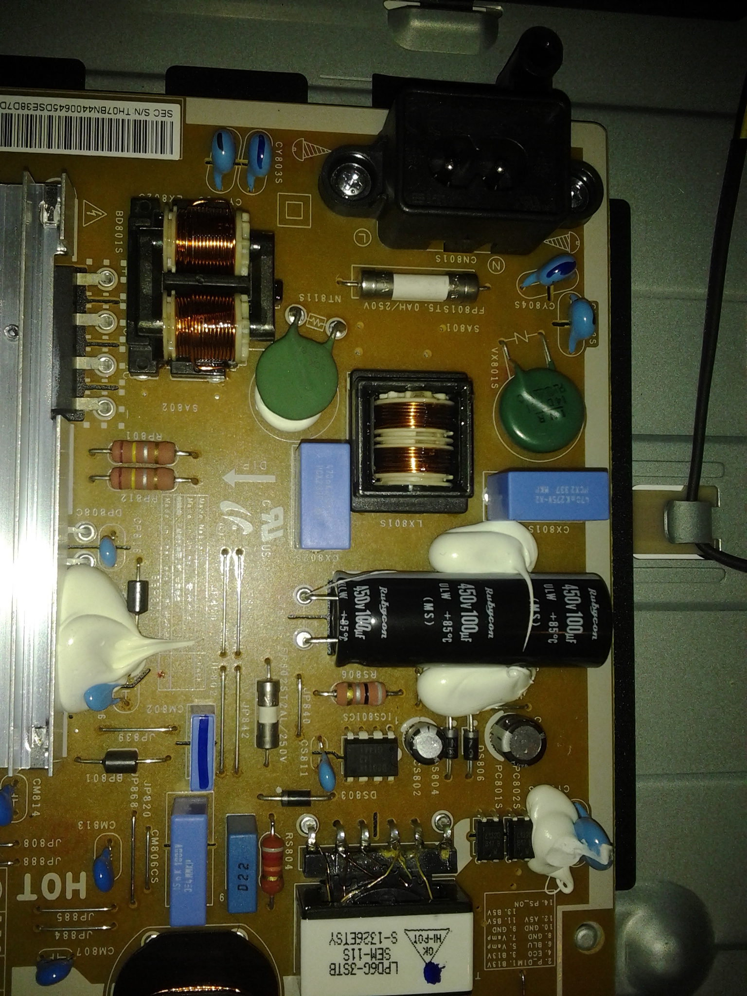

    Re: samsung UN40F6300AF won't power up
    With this model the power supply should work without the mainboard.
    Unplug the power supply from the mainboard, does the TVs back light come on?
      back light did not come on.

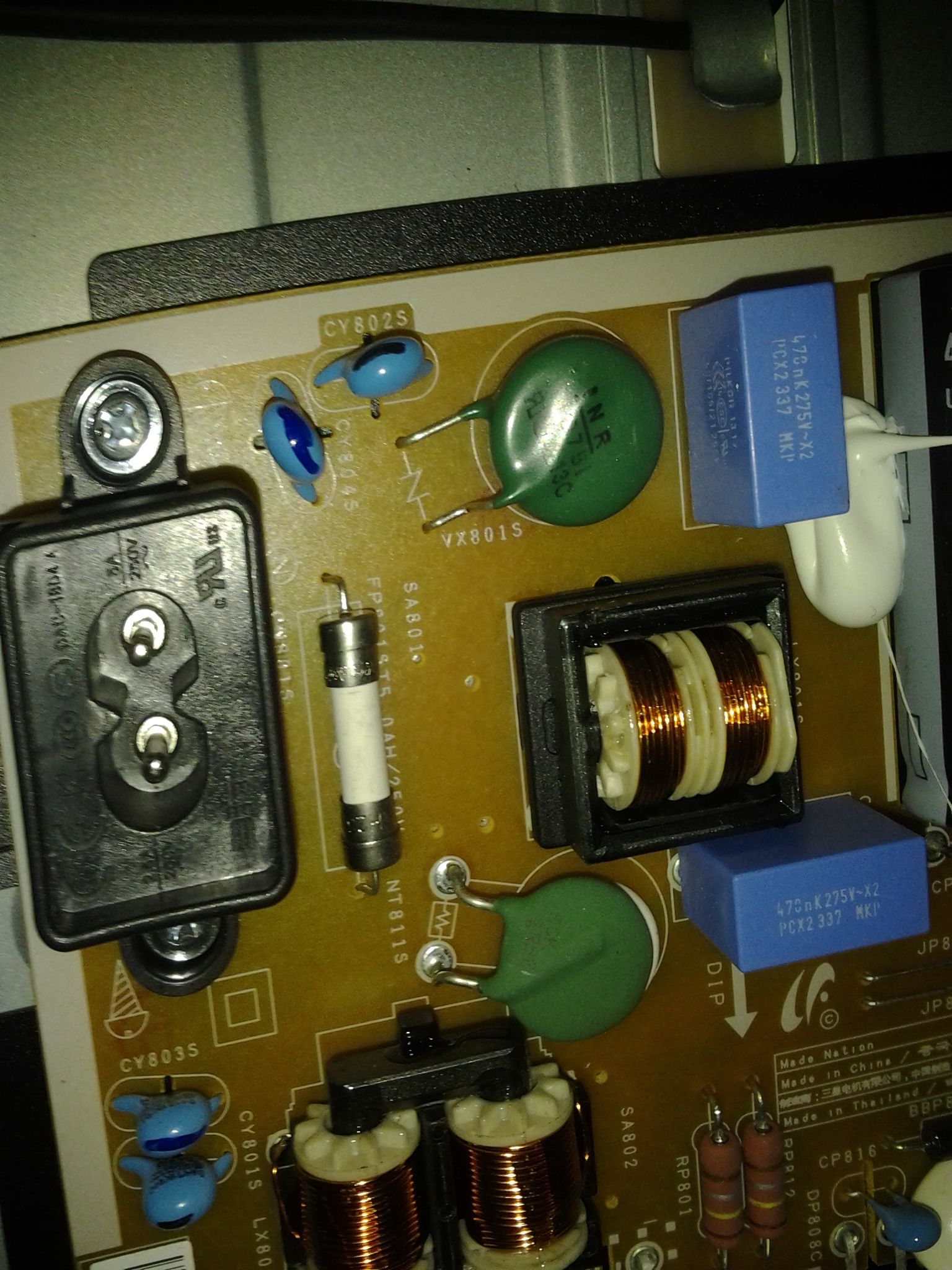

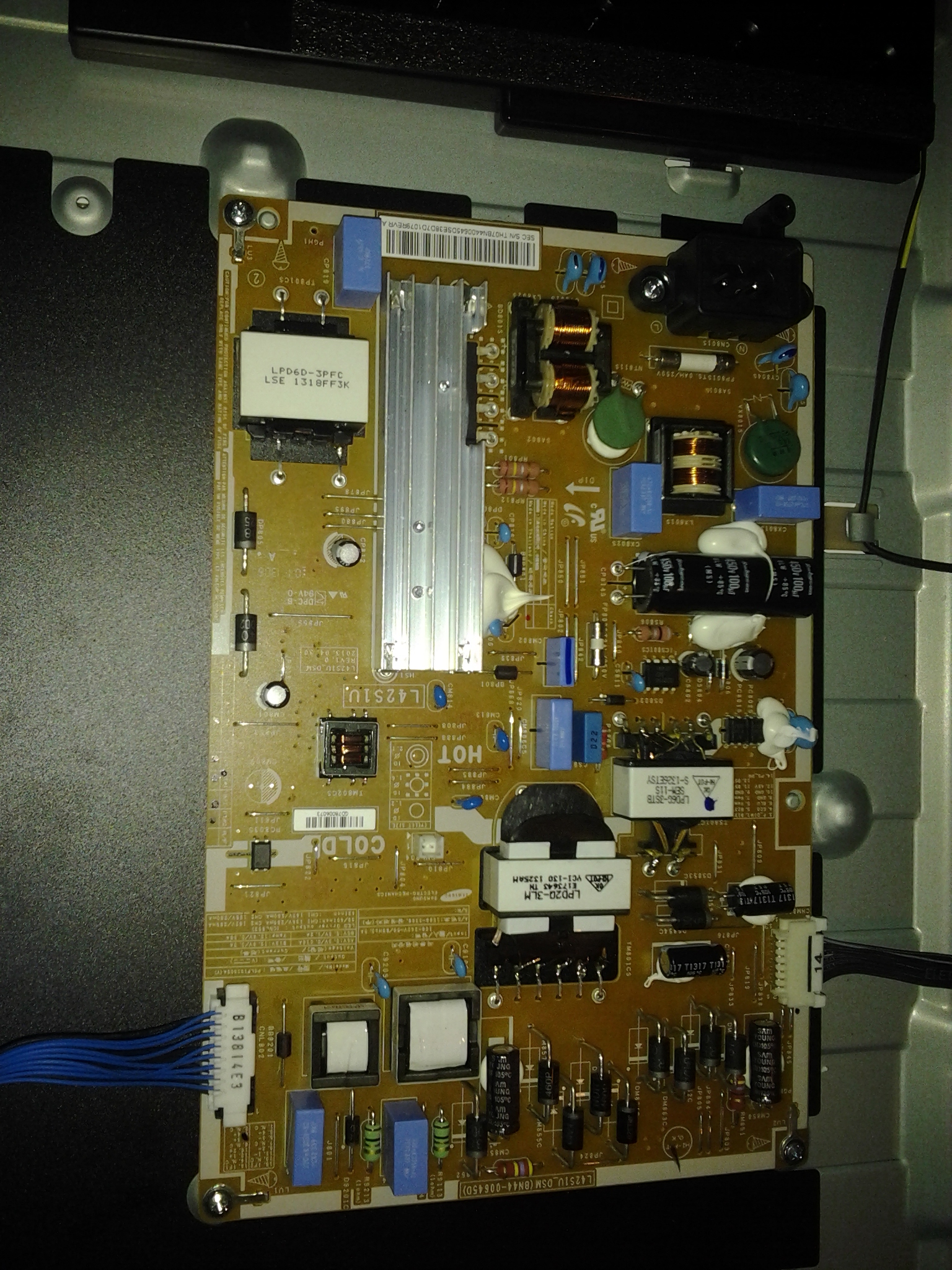

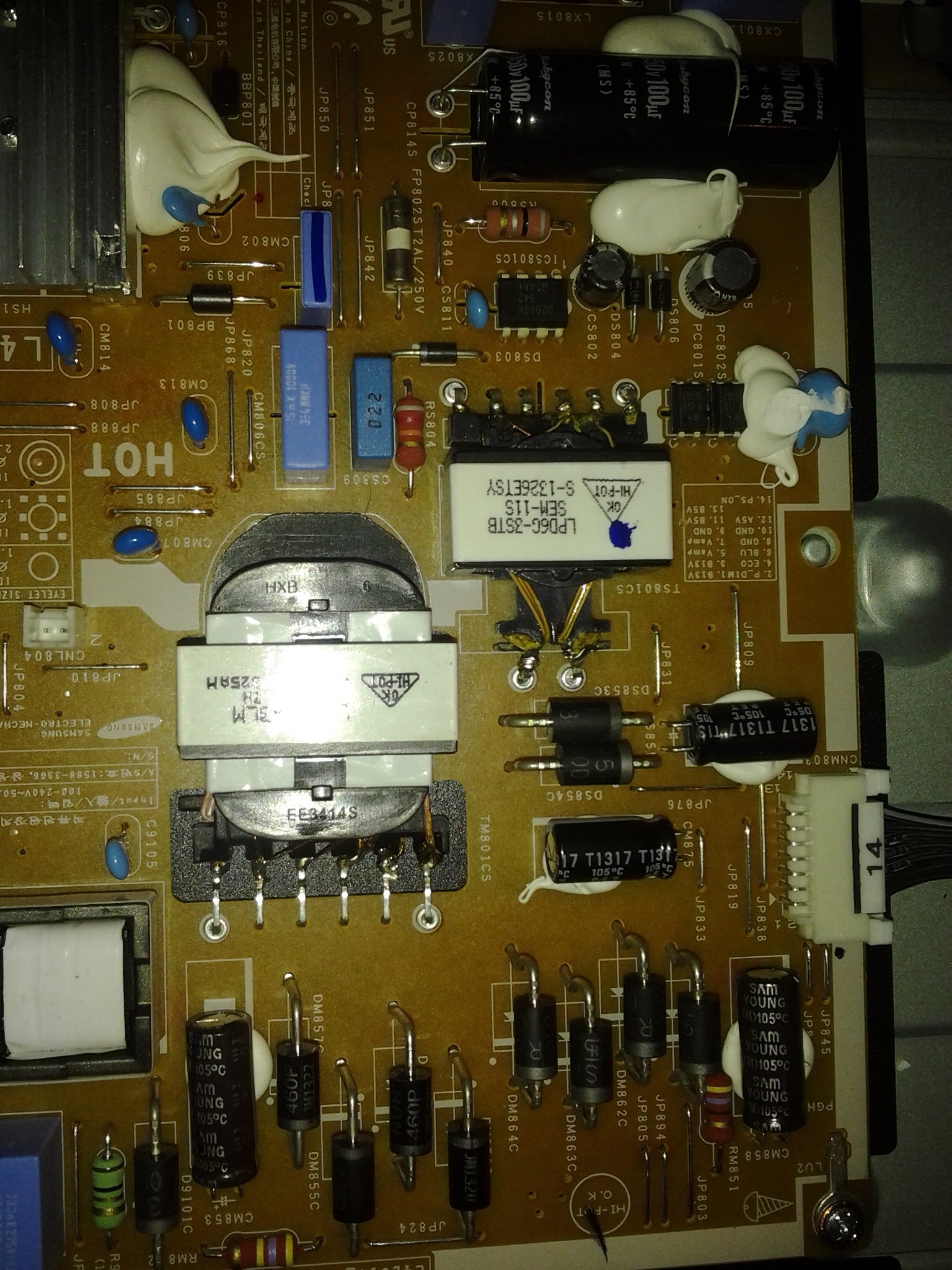

        Hello, I have same symptoms as OP
        TV BRAND & NAME Samsung
        Model No. UN40F6300AF
        Model Code UN40F6300AFXZA
        Version No. TU02
        Manufactured Nov 2013
        Power supply readings
        Unit blinks 2 times when power switch is pressed. No backlight
        pin#-desc-stby-p_on
        01-B13V-0-0
        02-P_Dim-0-Jumps to 2.1v then drops
        03-B13V-0-0
        04-ECO-0-0
        05-Vamp-0-0
        06-BLU-0-0
        07-Vamp-0-0
        08-GND-0-0
        09-GND-0-0
        10-GND-0-0
        11-B5V-0-p
        12-A5V-5.3V-5.3V
        13-B5V-0-0
        14-PS_ON-0-jumps to 3.3v then drops

          Do the backlights come on and stay on when the cable between the main board and the power supply board is disconnected?
          What are the Voltages on the power supply connector's pins when the connector is not connected to the main board?
