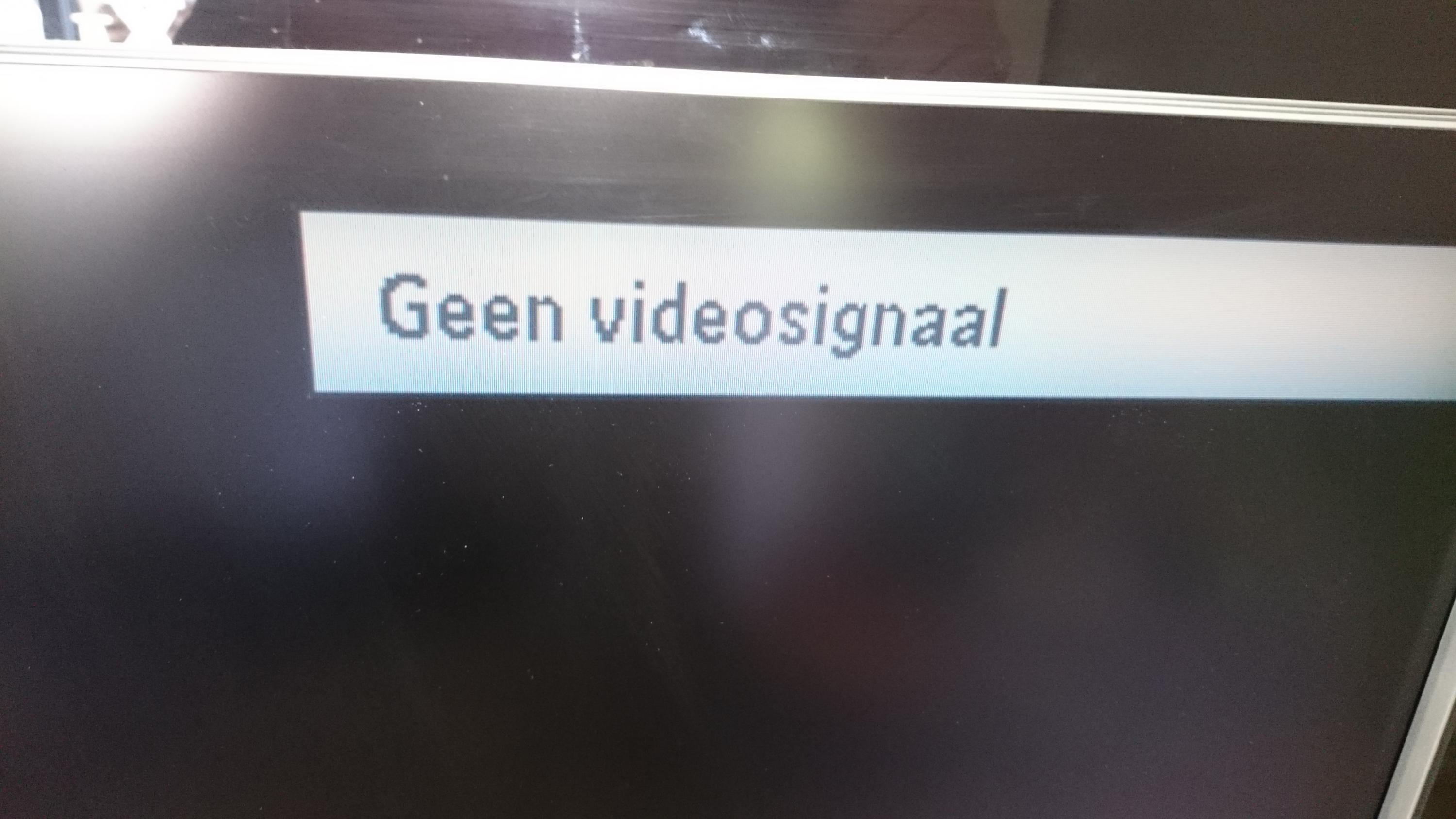

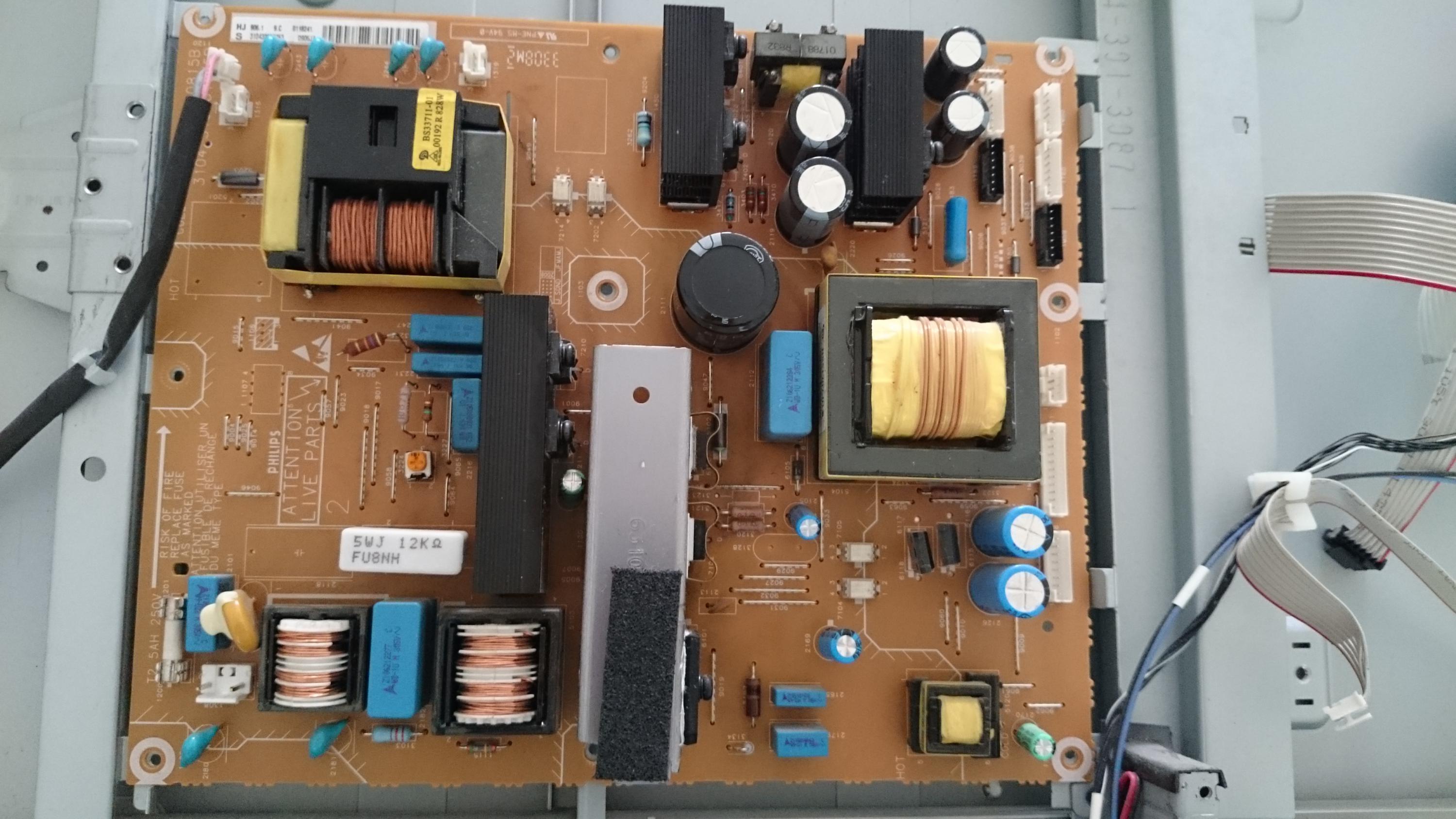

    Just bought this tv with the symptoms that it does not turn on.
    I asked the owner what happened and he said he heard a buzzing noise and the tv went to black. ( Sound and ambilight works ).
    Removed the cover and i didn't see any visible damage. Removed the PS and checked the bottom and no damage there.
    When i turn on the tv it stays on , front light flashes on start up but then stays on. Tv responds to the remote , going to standby etc but i don't get a picture on the screen. I don't see any backlight.
    Been searching the forums but most problems for this model are " tv does not turn on" so replacing capacitor "2179 + 2165" won't do much i think.
    Will post some pictures in a minute and do some measuring! If anyone has a tip for this particular model..i would appreciate it!

      I replaced the caps on the PS , i now get a faint picture if i use a flashlight. So there is no backlight.
      What can i test now?

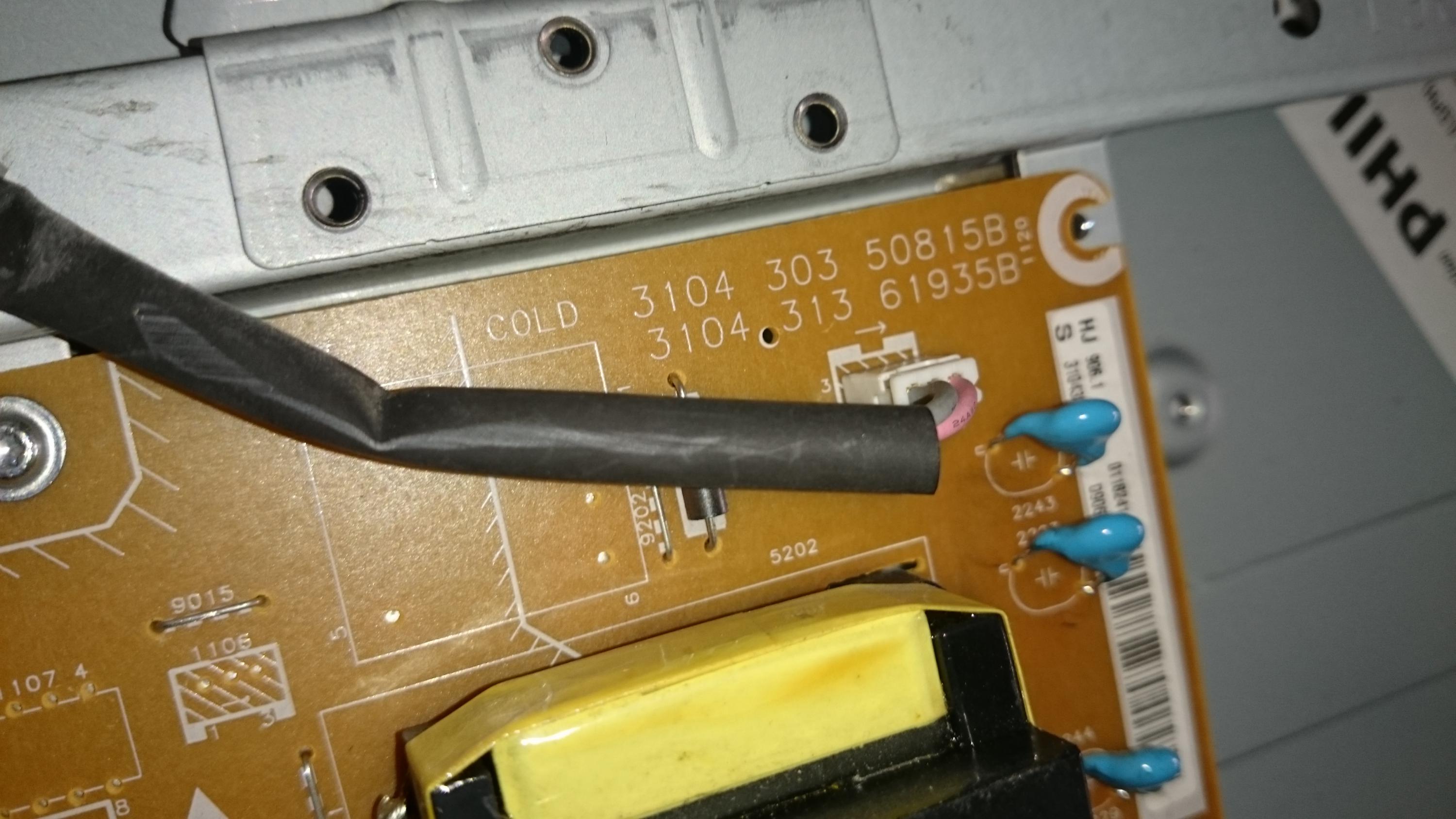

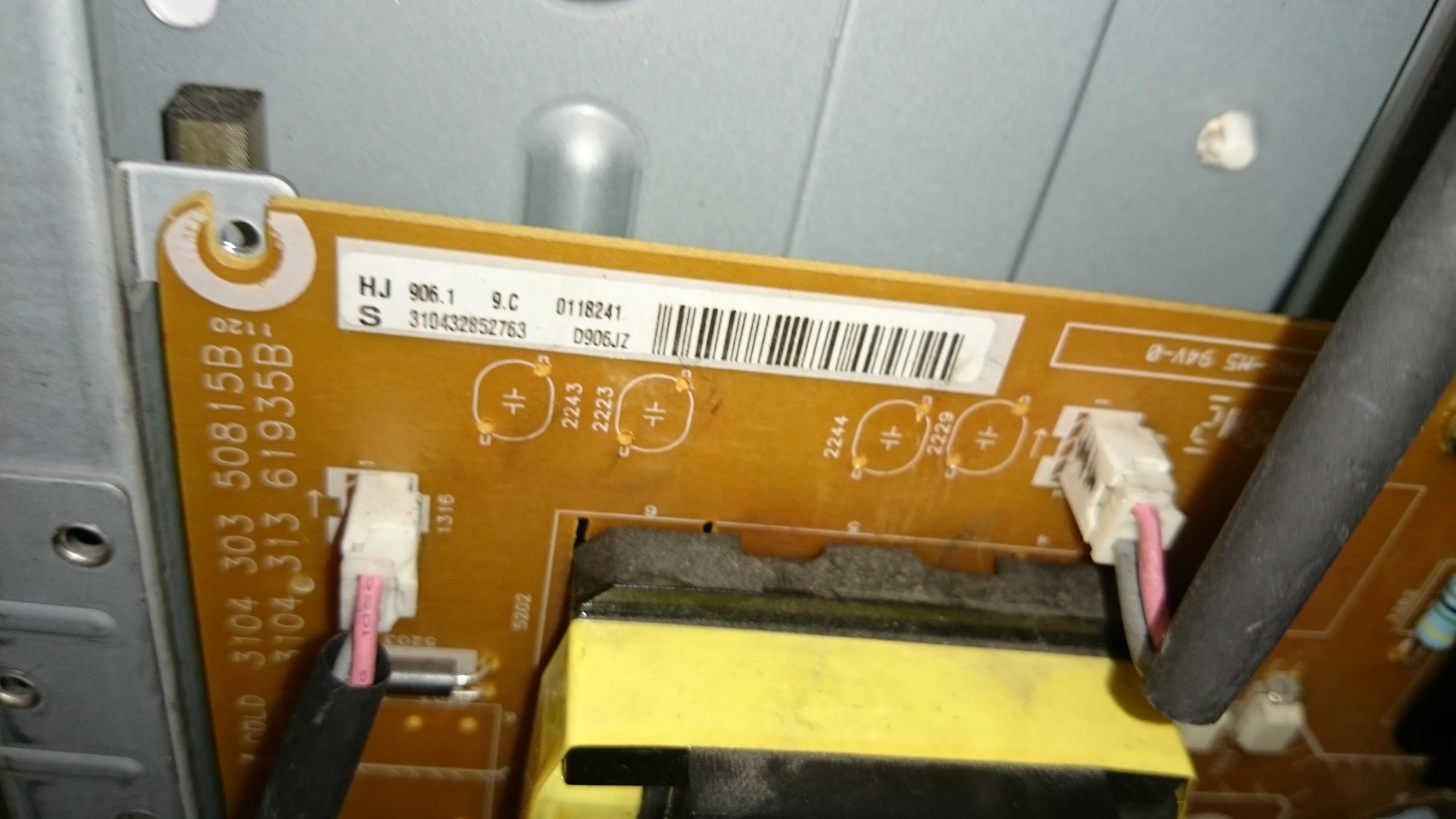

          Ok , i will check the inverter board. Requires to remove the complete back cover right? :o

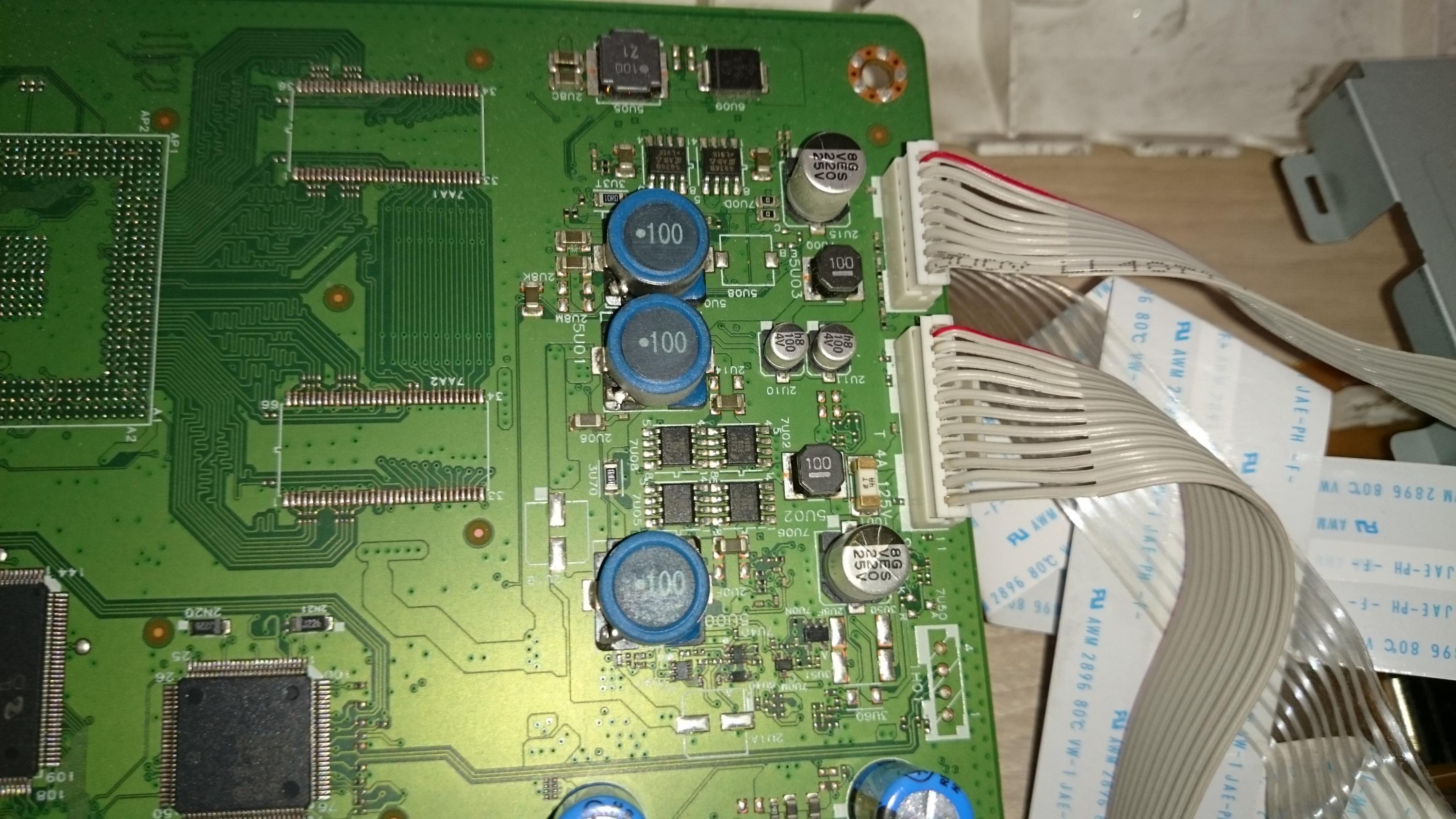

          Also , as seen on the pictures! When the TV is on i don't get any voltages on the 4 blue capacitors ( 22nF I think ). Is that correct?
          I could remove those 4 and see if i get backlight back?

              What voltages do i need for the backlight? What i measured before removing everything was 25V for ambilight and 12V on a "spool". spool is right next to the blue capacitors.

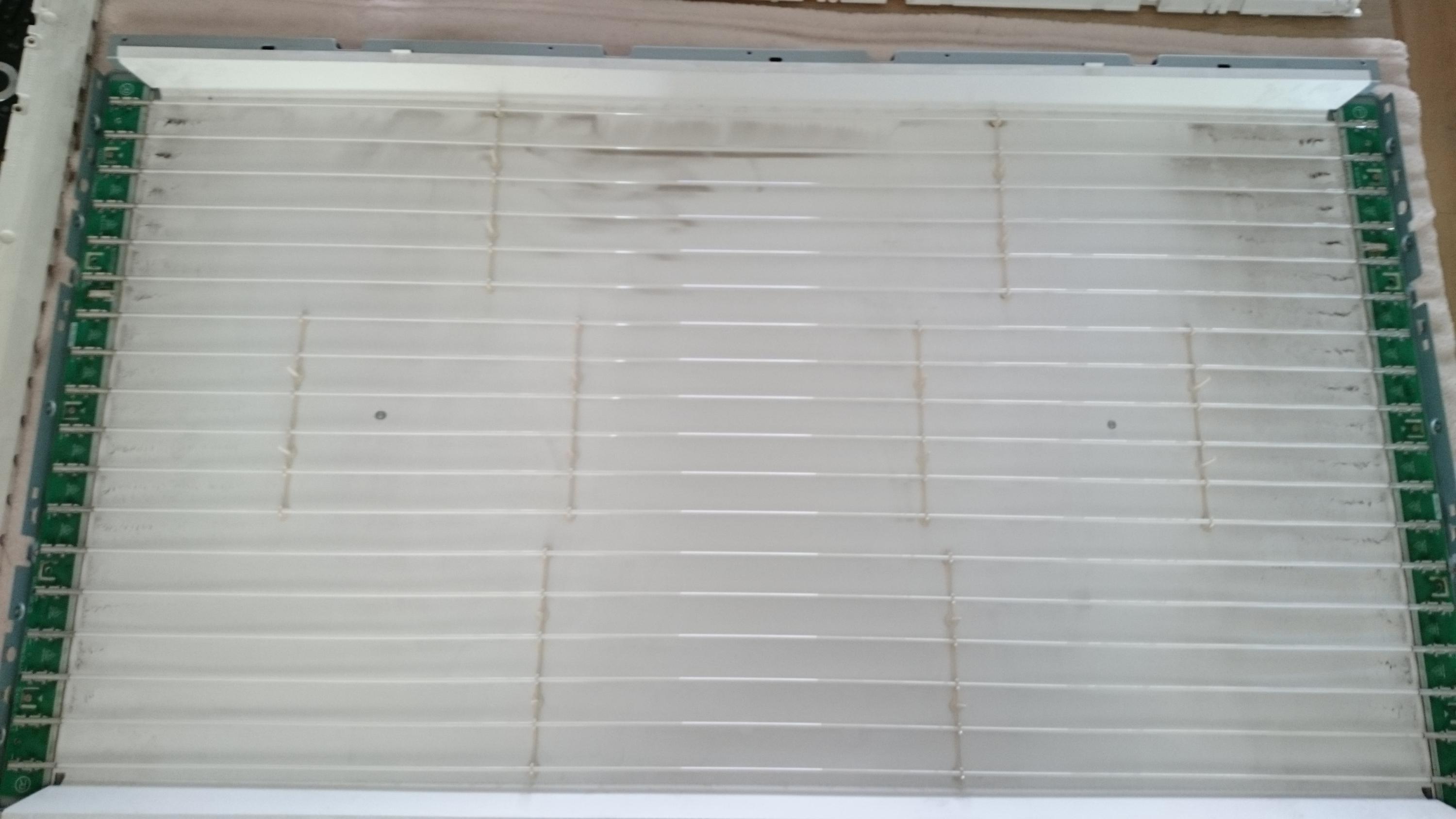

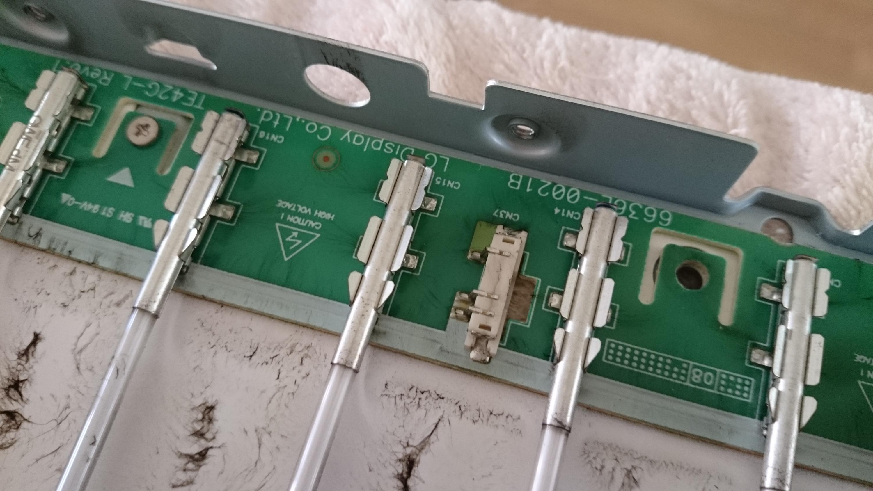

                  These are the lamps and inverterboards. Dont see any burned lamps or spots.
                  Shall i rebuild the tv?

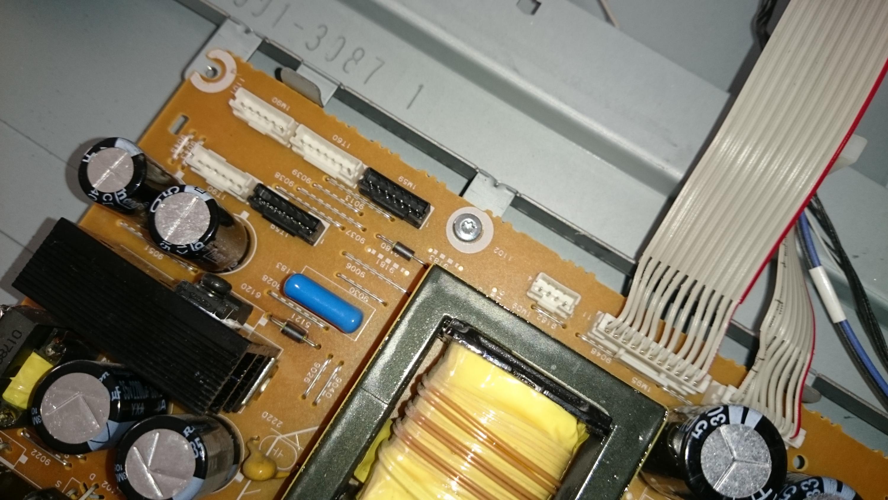

                    Last picture is the main board connectors going to PS.

                      Hi, I'm quite sure the inverter board is actually built into the main PSU board, I direct you to picture two on your first post, top left and across to the right a little. If you have a DMM you need to test as many components as you can in that area, so which one's are shorted or blown.

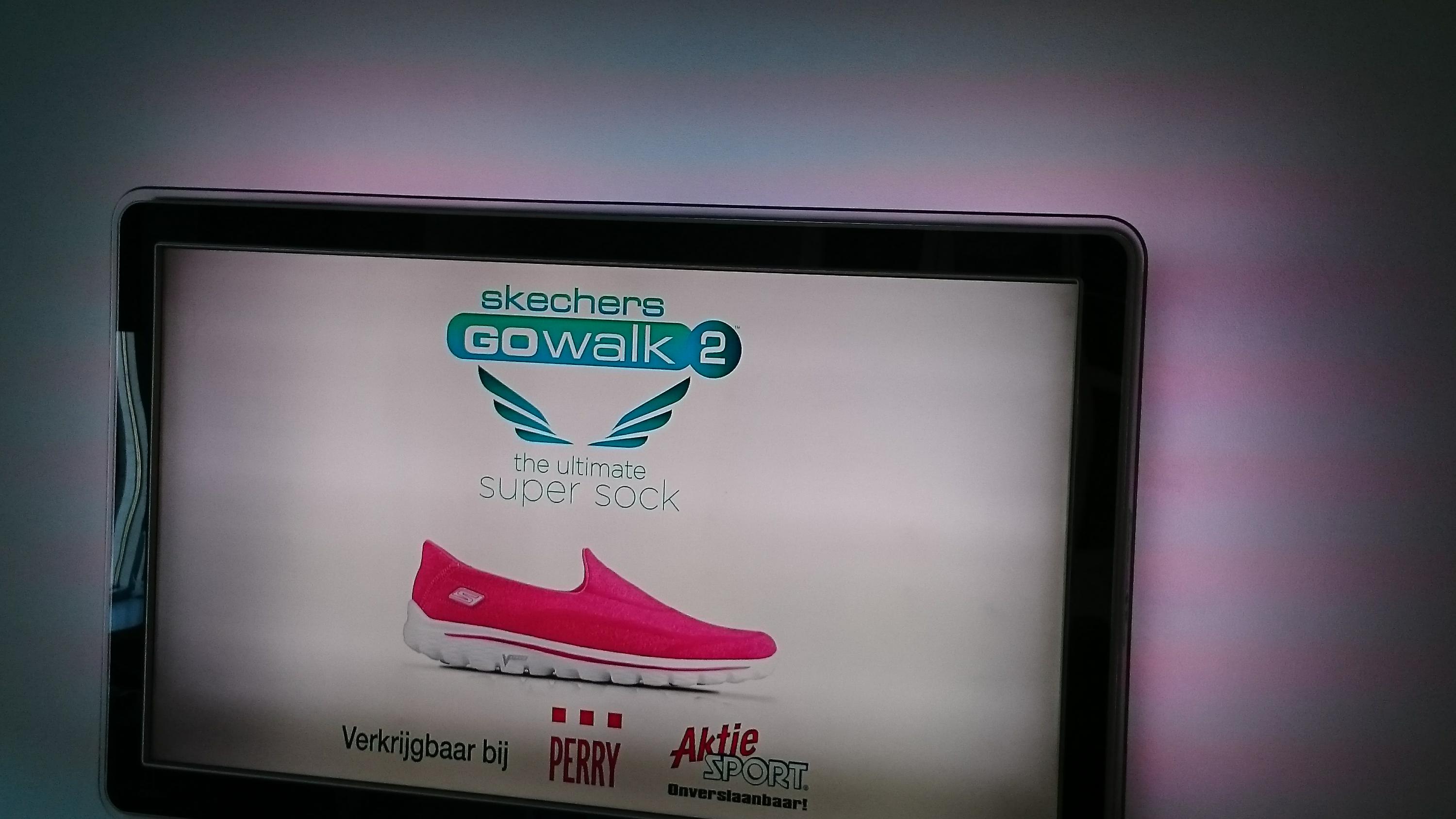

                        Removed the 4 capacitors and now the tv works! Probably 1 or 2 lamps were asking to much power from the PS.
                        Will the tv last long without those 4 caps? How much voltage drop will the lights get with those 4 caps in place?
                        On the pic its clear to see that a few lamps are not on. Are these for sale?

                          On first startup after removing the blue caps , the screen on the bottom was flickering. Can it be it needs more voltage to turn them all on?

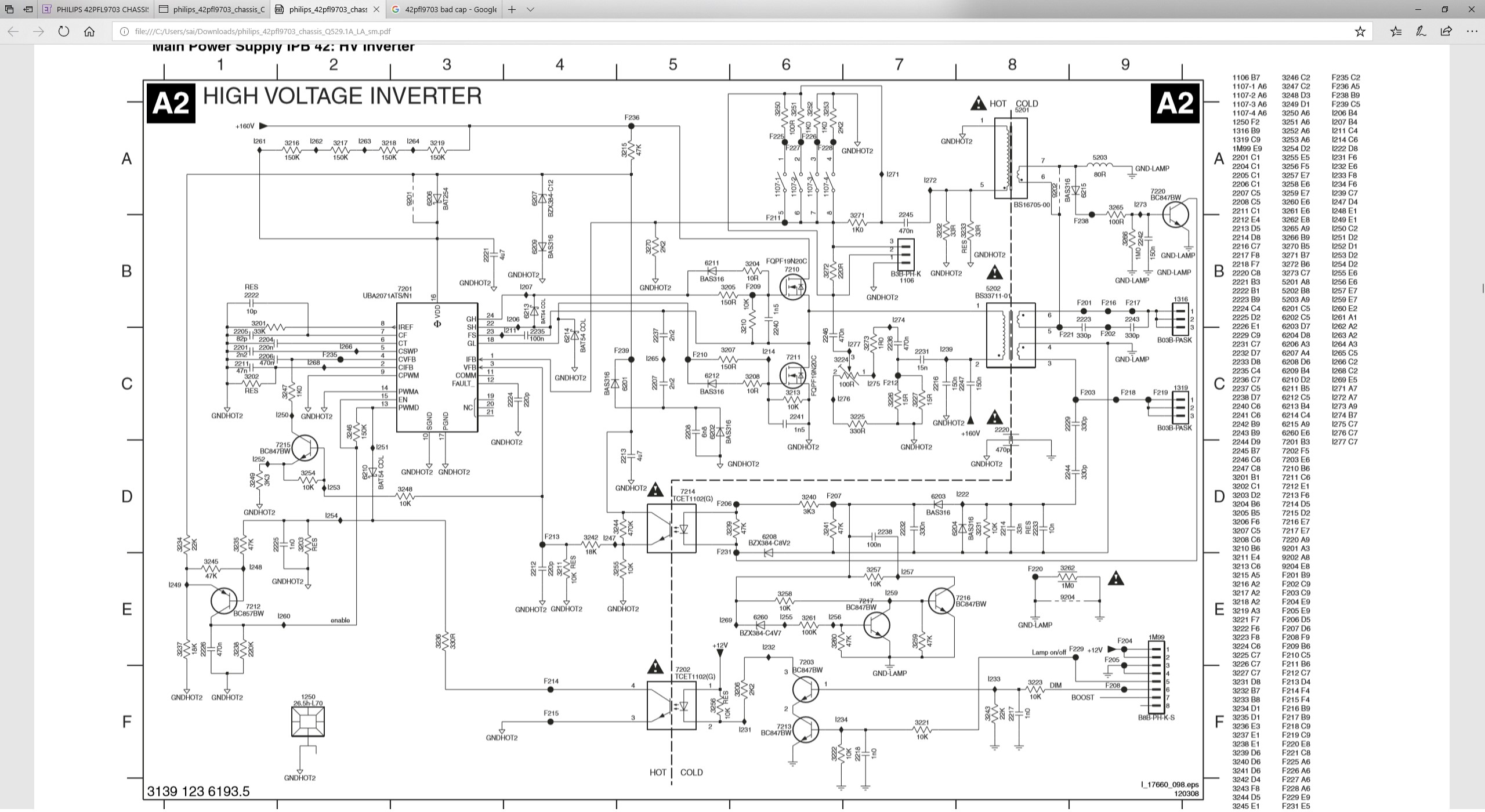

                            I have the same problem. Replace the 4 capacitors (330pF 3KV) can only work for one or two days. Before no video, the back light will flash.

                              I found a circuit for the high voltage inverter. The variable resister 3224 is for current adjust for 32"and 42" TV. Should I adjust it?

                                either that or "beefier" caps. In what condition are the CCFL's? If they are getting kind of pink hue, then they are toasted.

                                  The TV are ocassionally work, so the CCFL and the active component should be fine. I intend to replace cap 2231, 2216 and 2247. These three caps are high voltage cap.
