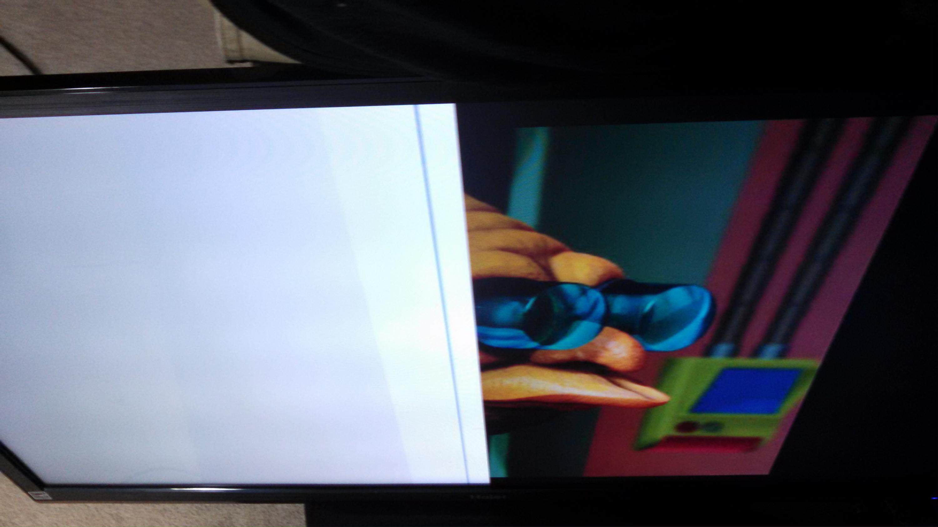

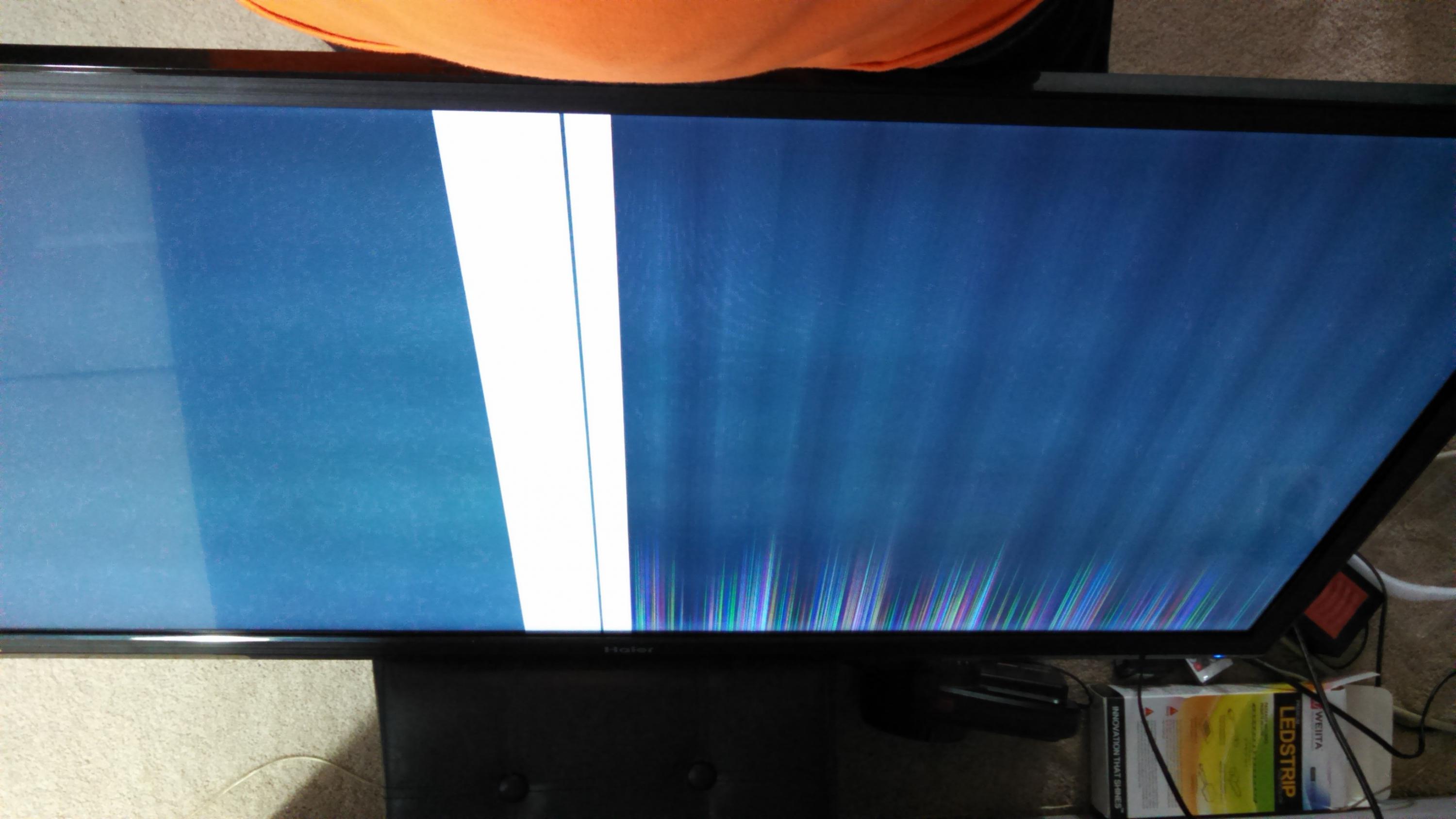

    Hello everyone, any advice and opinions are much appreciated. Im going to try and give a lot of information so that maybe someone will just know for sure no question what the issue is!
    So I got a Haier (junk brand dont ever buy from them) LE46F2280 as a warranty replacement for another that died after 6 months. This one lasted only about a year but its out of warranty now. Heres what I know:
    I plugged TV into a pure sine wave UPS and around that time it started making a buzzing sound for about 2 minutes whenever first powered on. The pure sine wave should be better for it than regular so maybe that part is a coincidence not sure. The TV was on and I needed to change a light switch I just left it on and let the UPS keep it running. After I swtiched the circuit breaker back on the TV was still on but picture is messed up. I did some research that strongly suggested that the t-con board was the issue so I swapped with one from ebay but it had no effect. By the way it is now plugged into a regular outlet. The backlight appears to be fine but you can see the vertical lines and half the screen is black. After being on about 30 seconds the half that was on goes black as well. The pictures are when first turned on and after 30 seconds.
    So does anyone know or have strong opinions about what is bad? As I understand I can replace the power supply board and mainboard but not the "panel itself". Thanks for all help!

        Re: Help! Diagnosing a Haier LE46F2280 LCD TV
        looks like a bad LCD panel, JMO.
          That's a panel failure

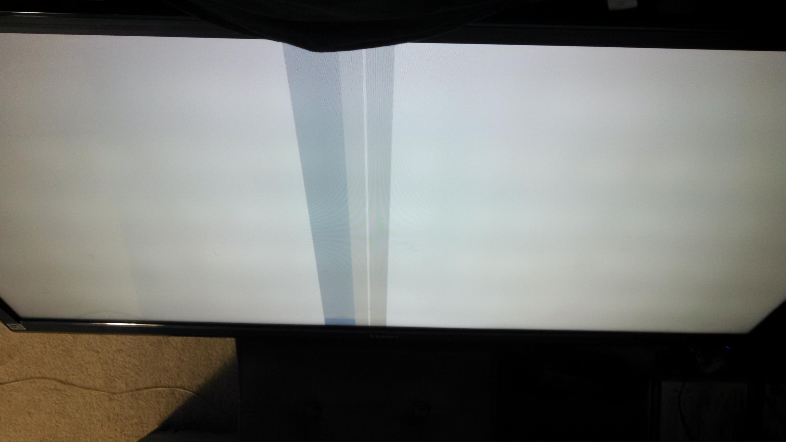

              Looks as if the driver board has failed on the right side.
              Just to check, remove a ribbon from the TCON and power one side only... then do the other. What do you get?

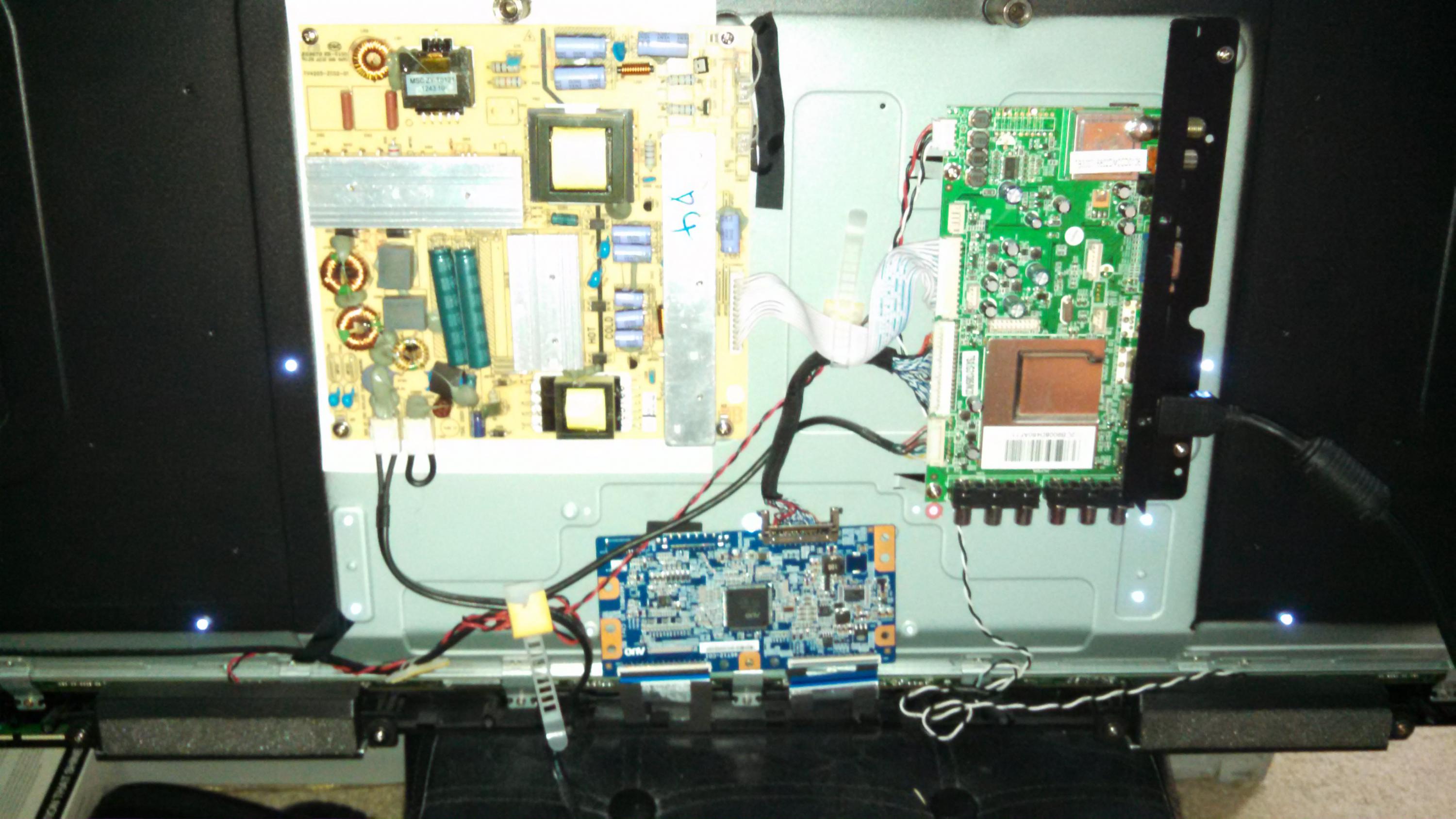

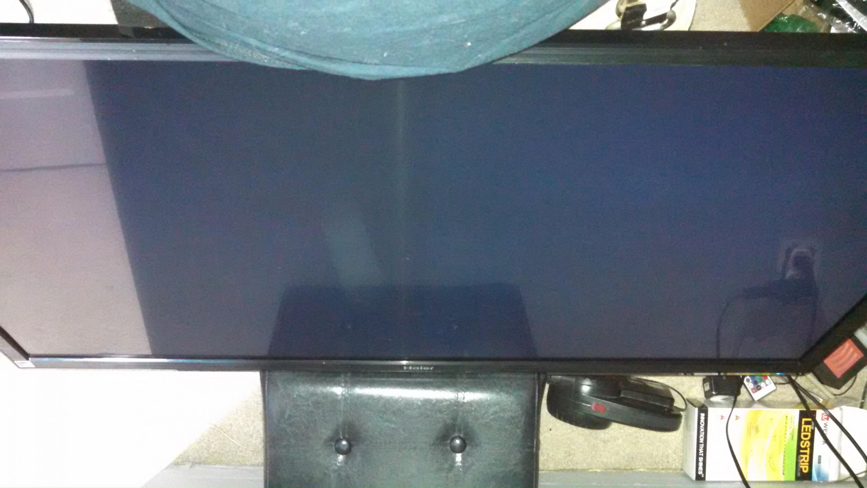

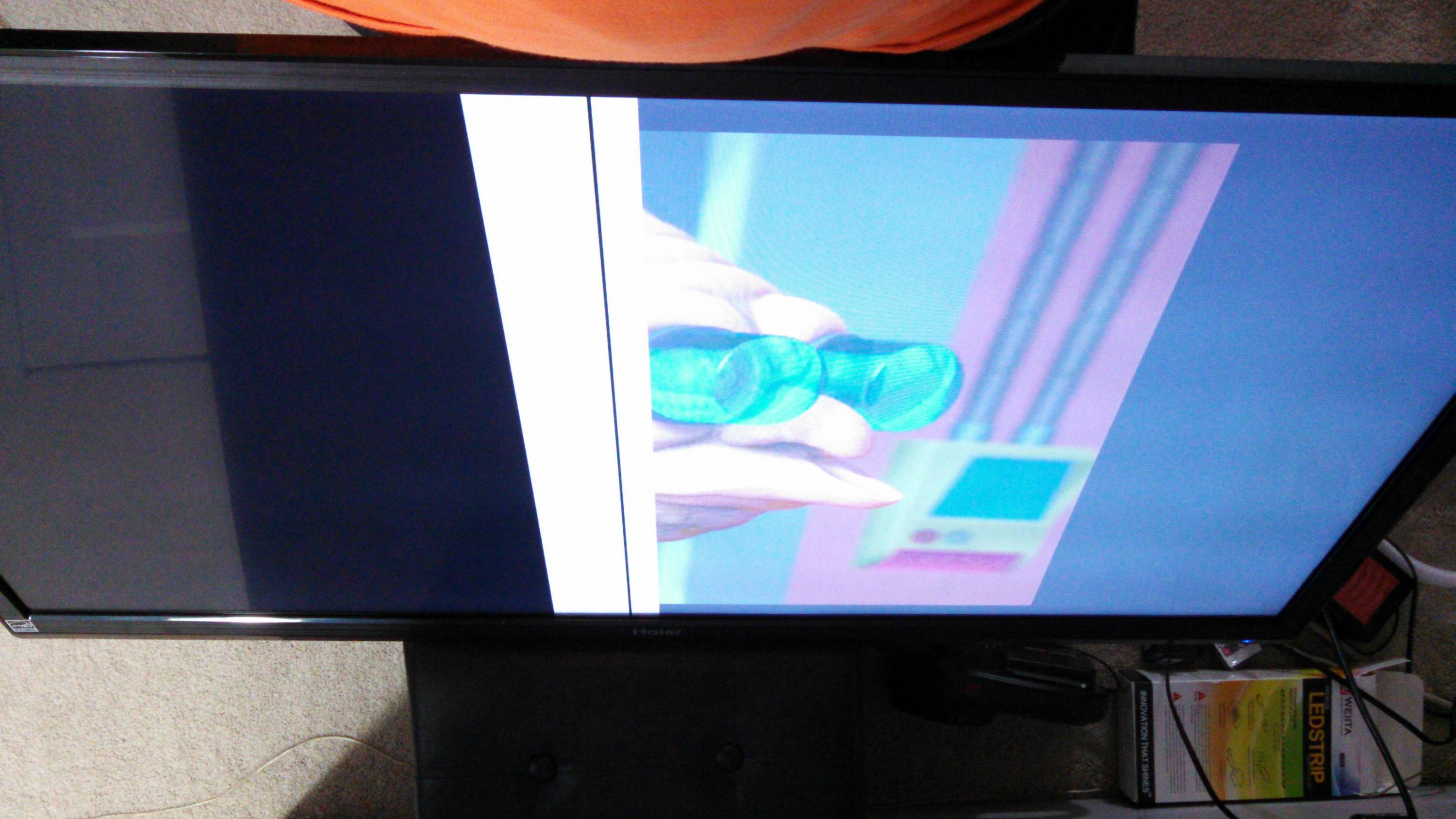

                Here are the results of the suggested test. First is with one t-con ribbon plugged in. It stays like that one half looking perfect and does not change. Second two are with the other ribbon plugged in, starts out all white then slowly goes to all black with a subtle line down the middle. What do you mean by the controller board? Final picture shows all the boards.
                Also does anyone think there is a possibility of power supply causing this behavior because there is a slight buzzing I believe coming from it.
                        That is bad panel, when the bad side is connected, it kills the T-CON circuits, similar to this:
                        https://www.badcaps.net/forum/showpo...7&postcount=10.
                        You already tried new T-CON. I did too.
