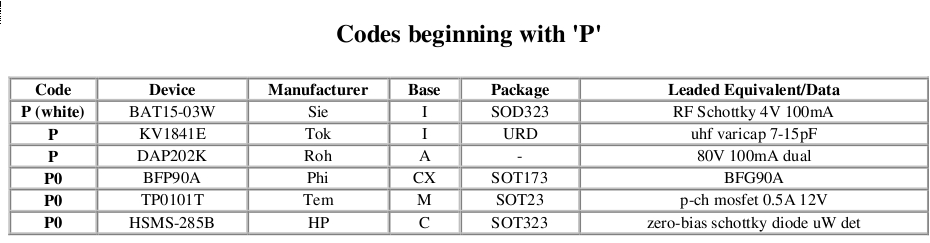

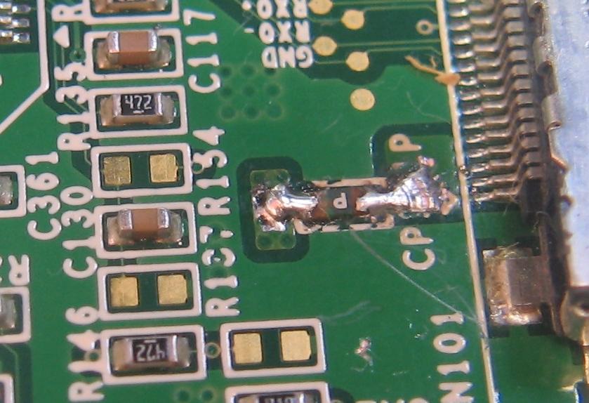

    Burned component located on the bottom near cable connector above marking "CP101P", on shopjimmy pic SMD ilooks greenish and marked "P"
    I found manual for codes and it looks like it might be KV1841E
    Is it correct?
    In this case, what substitutes I can use (looks like this one is hard to find), and what are chances that it will fix t-con?

    CP101 = Circuit Protection = Fuse
    I would check the board for shorted circuits, that can be difficult since the shorted load may connected to the power supply line due to electronics switch has to be turned on after power is applied. The fuse is probably 3~5A range, you can look up the LCD penal spec to see how much current it needs to run and the in-rush current spec.

      According to SJ (http://www.shopjimmy.com/catalogsear...ny+KDL-40S2000), this T-CON board is used in LCD panels:
      LTY400WS-L02
      LTZ400WS-L02
      The spec for LTY400WS-L02 show Max current is 2A, in-rush of 5A.
      I would try 3A.

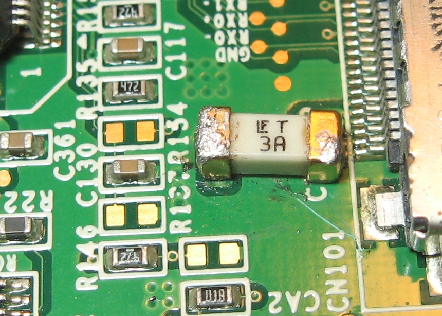

            I just finished soldering that littelfuse one from another board like on ebay link above, since its bigger, I extended contacts on board by scratching paint off, just tried it - and it worked! Got nice picture, but I didnt try it on long run yet, just for minute.
            Is it OK to leave it with that fuse? Or I should try to find something else for permanent fix?
              Re: Sony KDL-40S2000 T-Con - looking for help to ID SMD
              Try it like that for now to see how it will work, you will have to use the TV and turn it on and off every day to see if the in-rush current will blow the fuse or there is intermittent shorts in the panel or on the T-CON board.

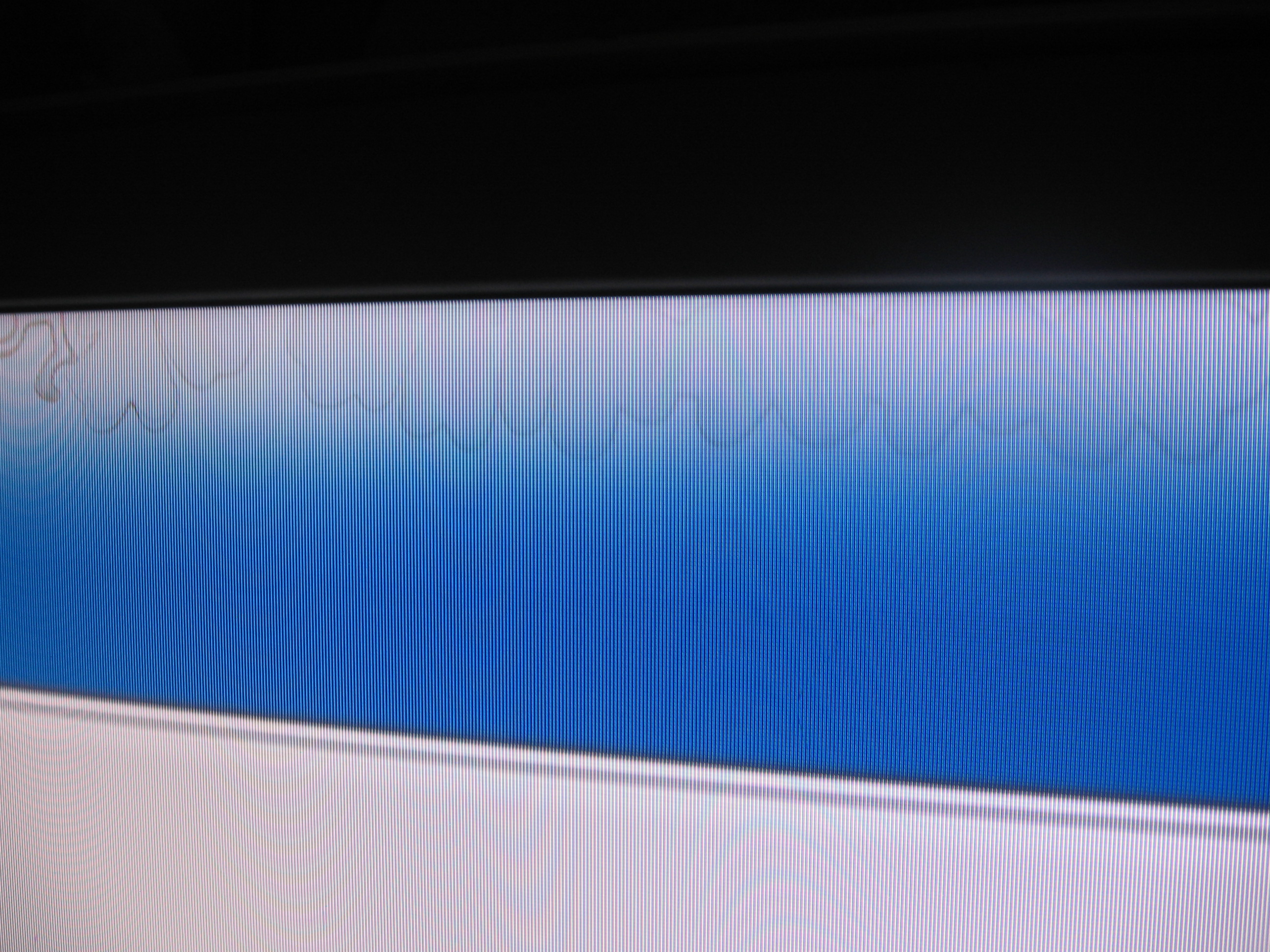

                                  I found something on screen that may be source of fuse blow. I was testing it for two days and it was working OK so far, but today I realized it has some spots on screen. So I took all apart to clean it and completely removed lcd panel just to find out that "spots" cant be cleaned, they in fact bubbled coating on the panel. All located near circuit board.
                                  Obviously, they dont affect video signal because picture is nice, clear and with really good colors. But maybe something, like overheat happened in the past that caused it? Or something else? What are chances it will cause problems in the future? Those bubbles are not really noticeable because it took for me 2 days to find out about them, only because I was standing next to TV and there was solid background, from like 10 feet I cant even see it.
                                  I ordered fuses to solder one properly after I'll get it, but now I not sure what I'll do with TV and whatever I should just take it apart and sell boards.
