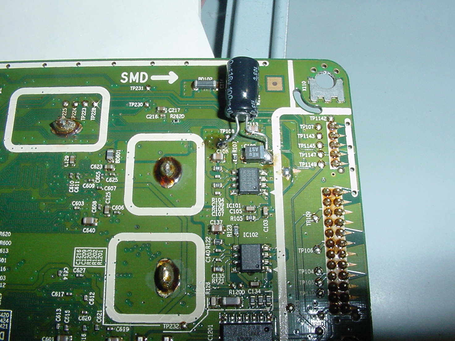

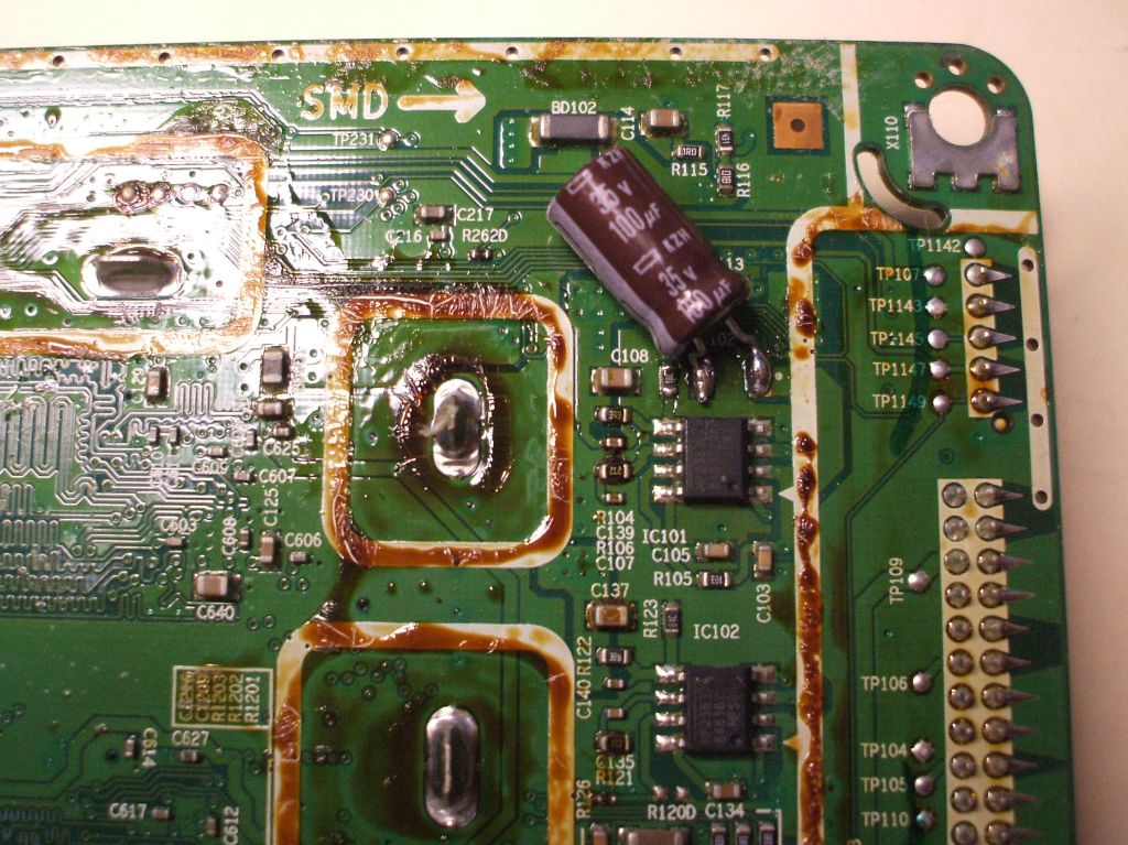

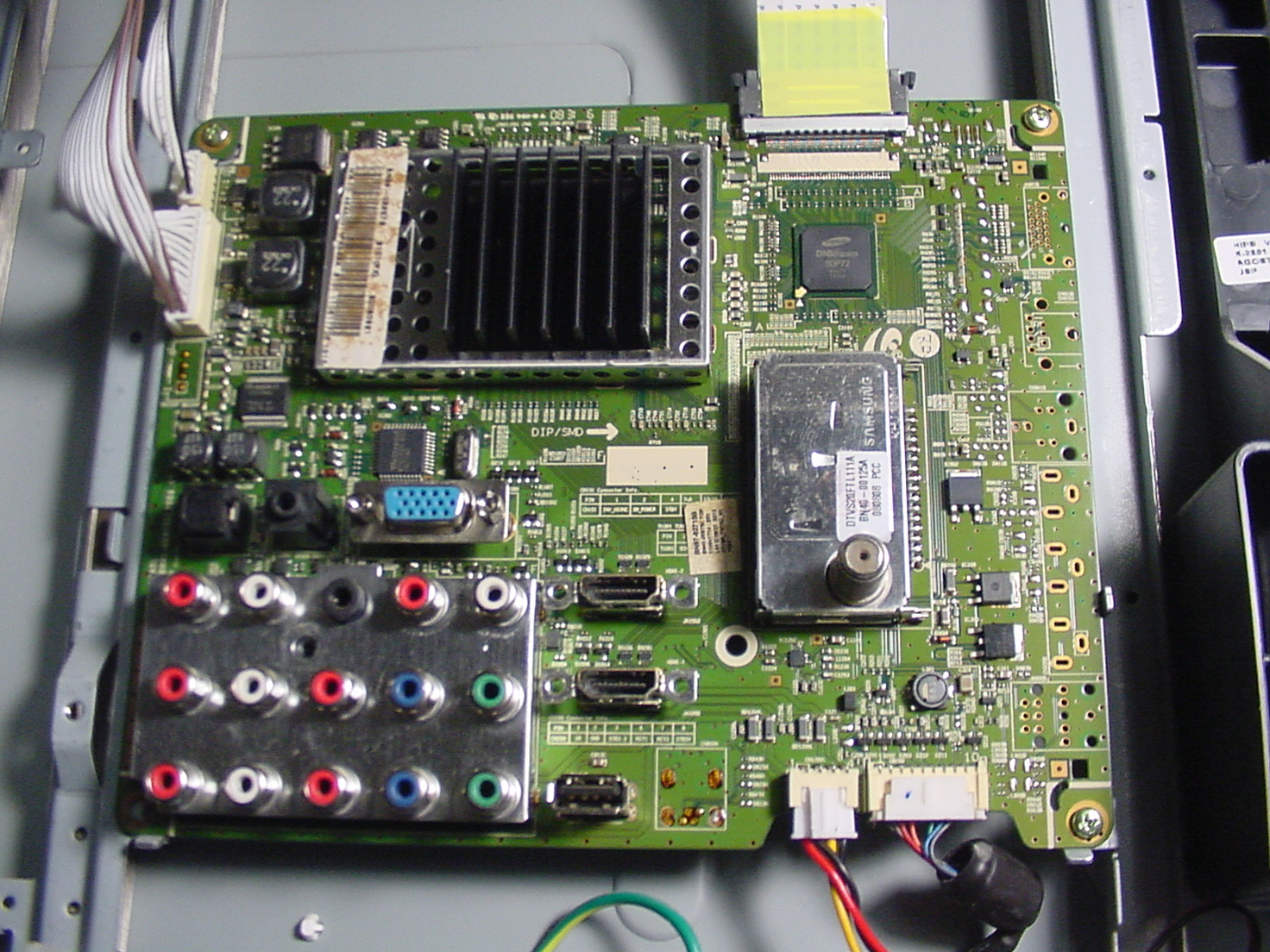

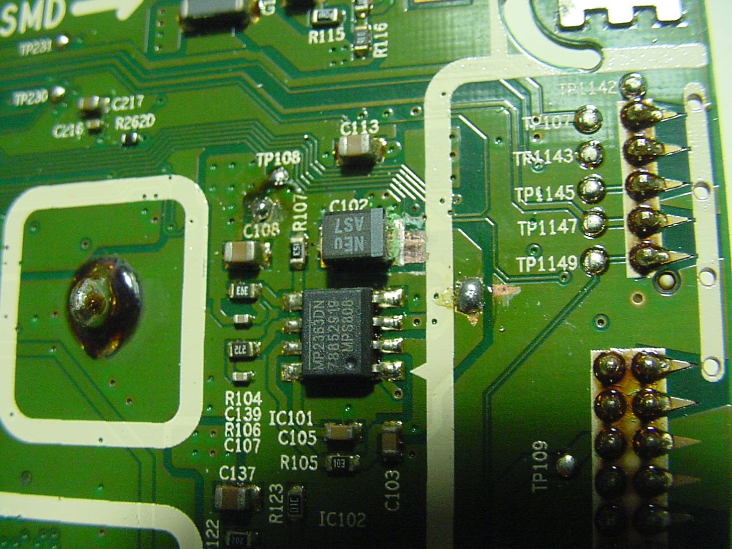

    Symptom: blinking red LED, PS-ON OK, BL-ON not present, power relay clicks on.
    Bad C102 on the main board, solder in 100uF10V low ESR in parallel to fix the problem, easy fix.

    Re: Samsung LN46A500T1FXZA fixed
    Why not replace C102? I've seen you do that before, along with a cap on the other side of the board. Too fiddly?
      Just to do the experiment to see how long it will last since the original cap did last either, I gave it to the person I know to keep using it and see how long it will last, I did that to one of my TV also about 6 months ago and it still working.

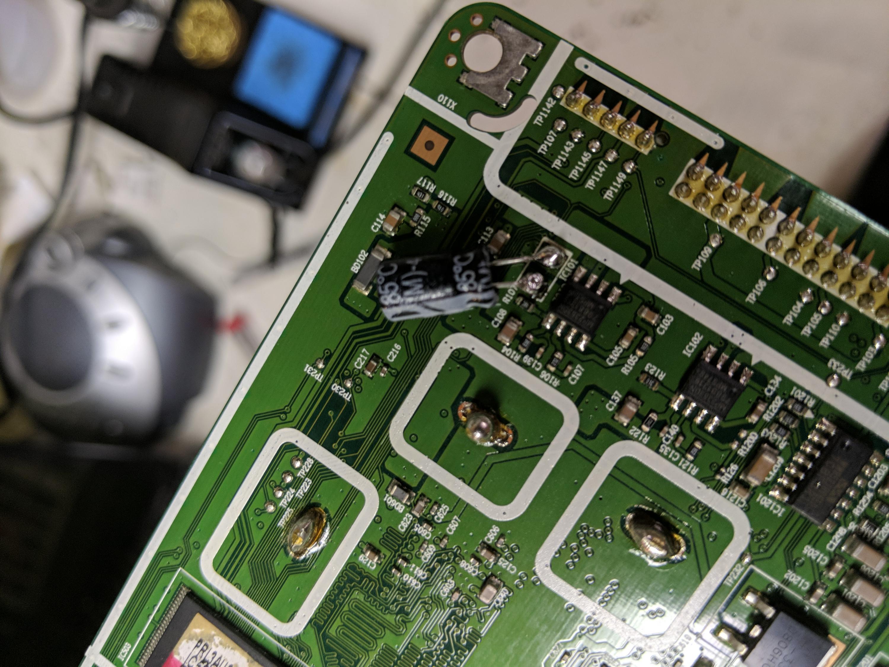

          Thanks for posting about this issue. My Samsung LN46A630 would often screech and have a display full of green vertical lines when you tried to power it on after sitting. I had previously replaced some caps in the power supply a year prior and those were still fine. Since tantalum caps like C102 tend to fail shorted I unsoldered the original part and soldered a replacement to the original pads. TV is working great now!
          When I tested the original capacitor on my Sencore LC103 it shows the value was less than half of what it should be and also failed the ESR test.
          Attached a picture of my repair.
            Forgot to mention that I angled the part on the board to clear another surface mount component and lay flat.

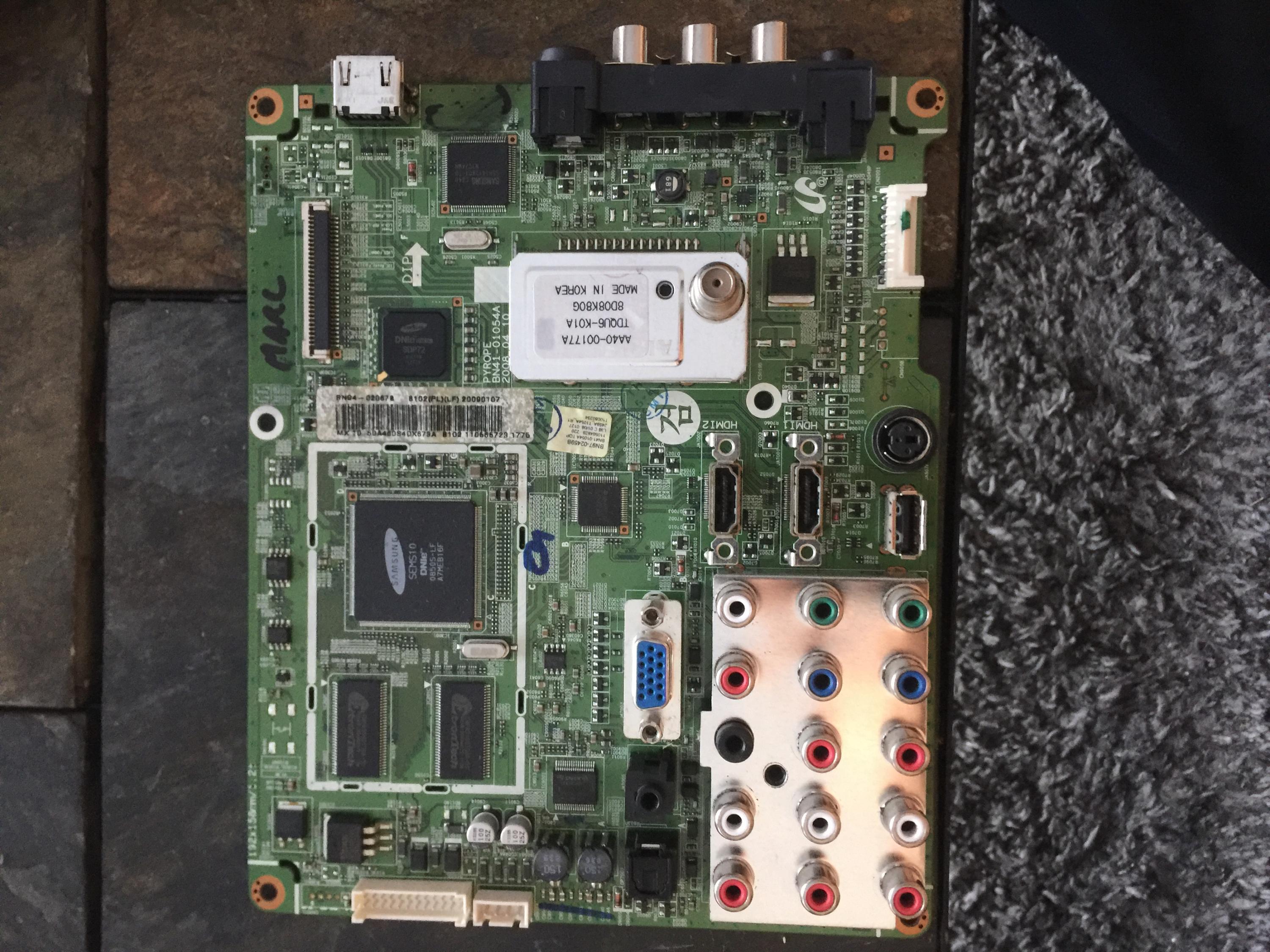

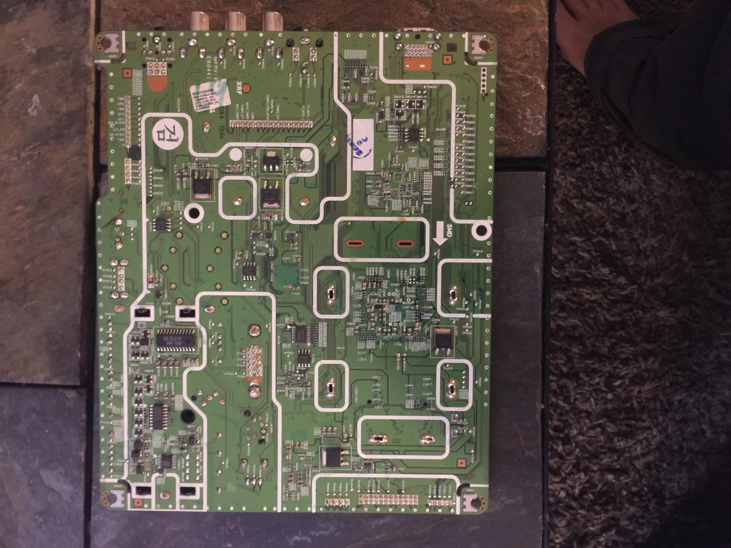

                              Budm, I just repaired a LN50A450 and I had an old mainboard that I used but my board and the one I pulled don't have a C102. The part numbers are BN94-02067A and BN94-02068A. Is there a different spot with that cap problem?
                                pics of back of main bd
                                • dcapper
                                  • Dec 2013
                                  • 496
                                  Here's the board I pulled and it was exactly the same as the one I put in, minus the svideo connector.

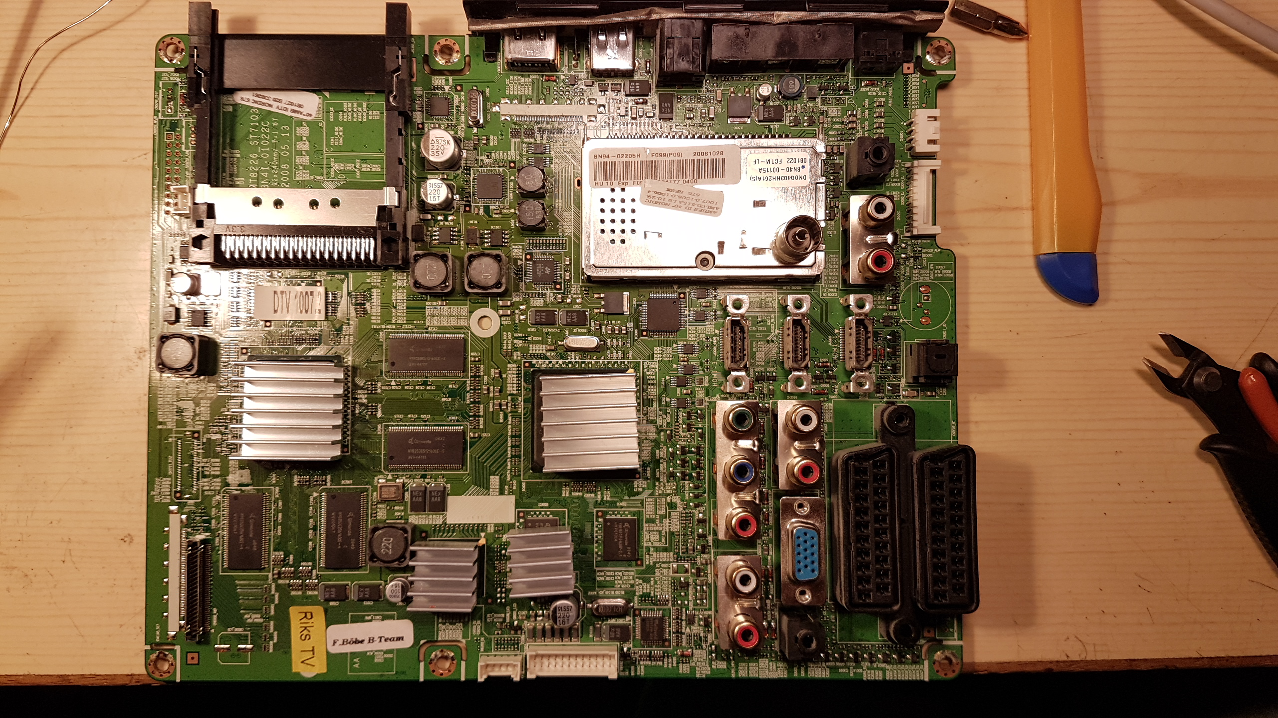

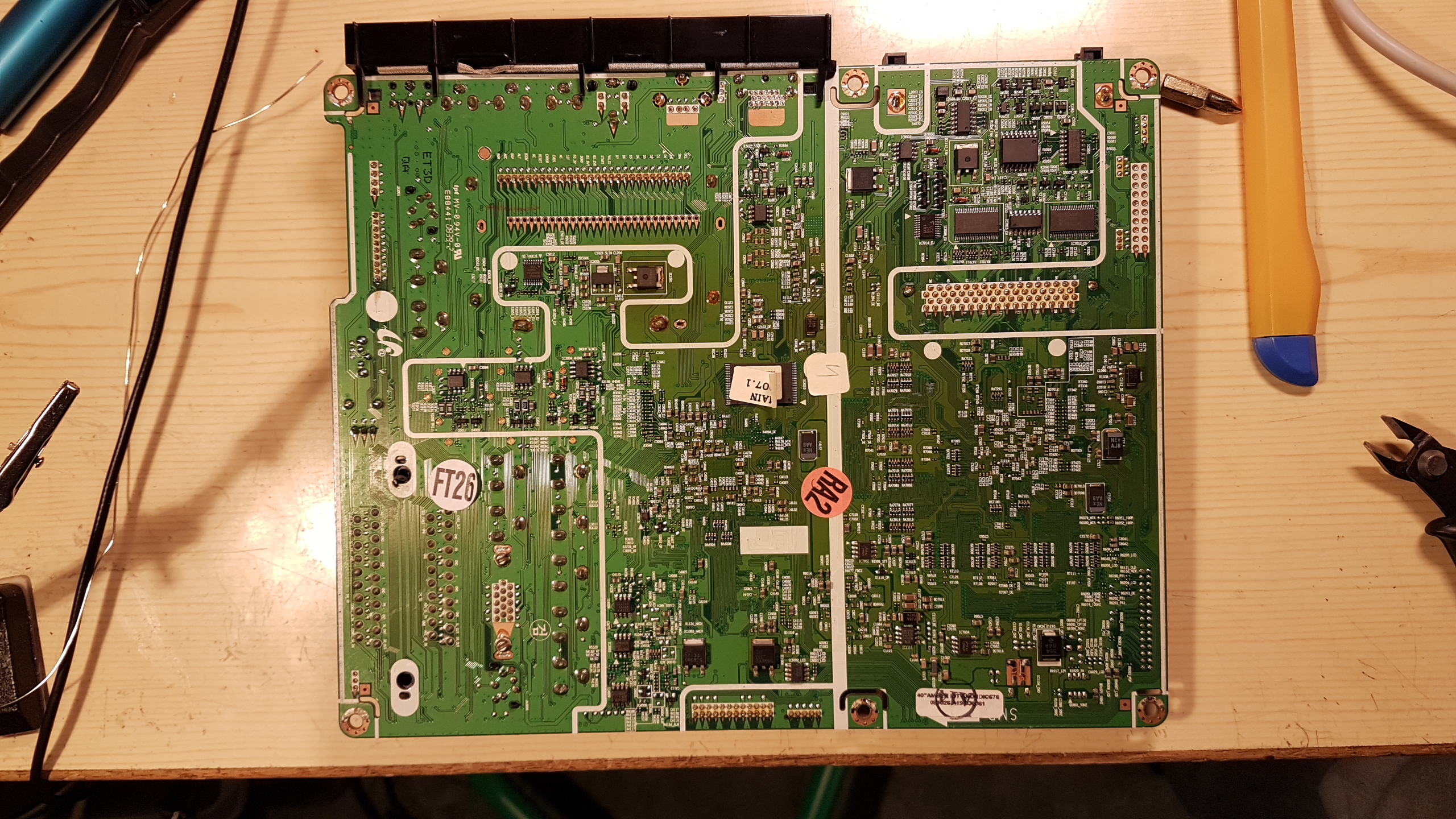

                                    I have a Samsung LE40A676 with exactly the same phenomena.
                                    Blinking red LED and several minutes to start.
                                    I have checked the PSU board and there's no visible bad caps. I have also measured all caps on the PSU board an they all seem to be Ok, just to be shure.
                                    Does any one know if there's a "bad C102" on this main board to replace?
