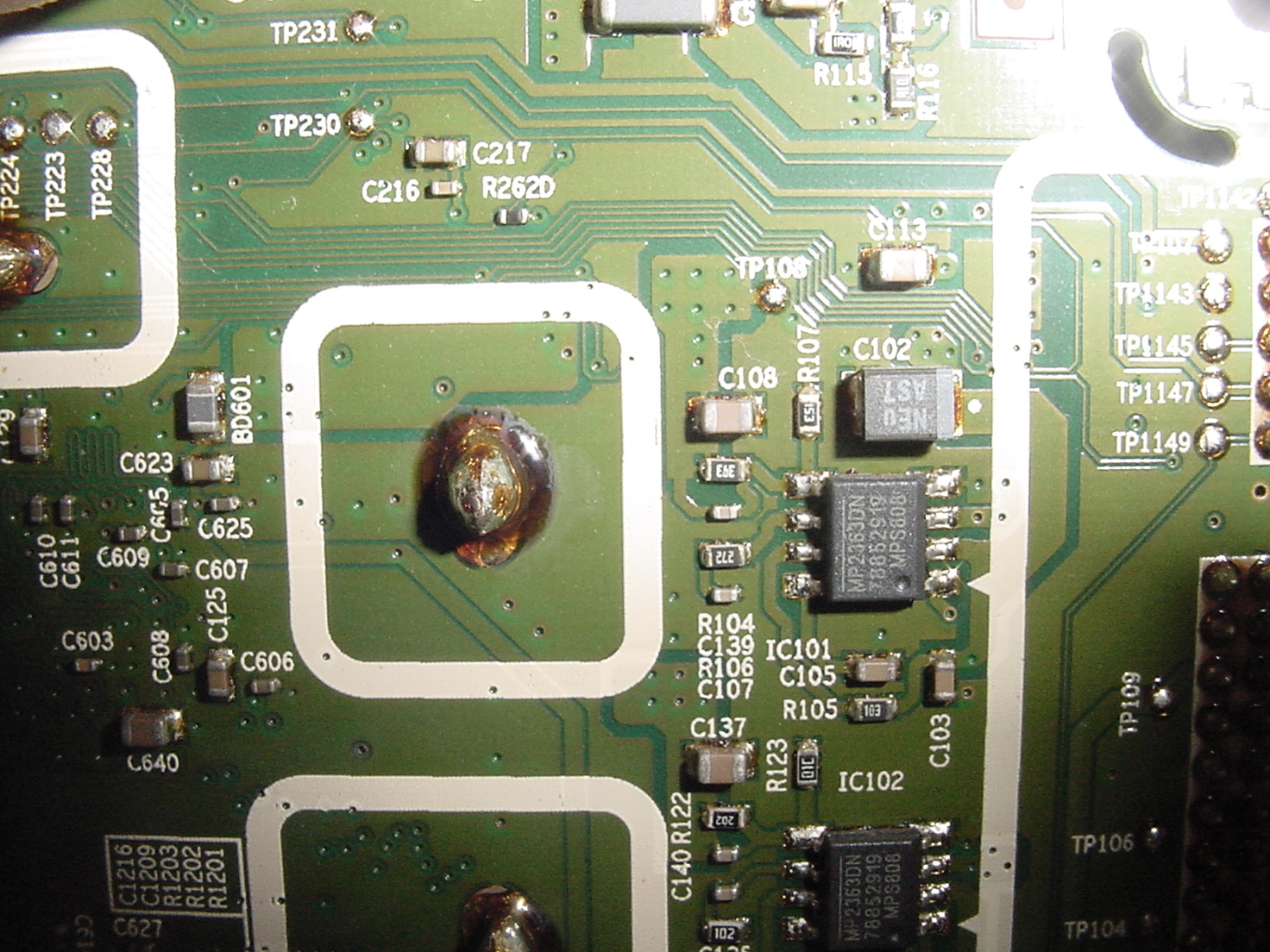

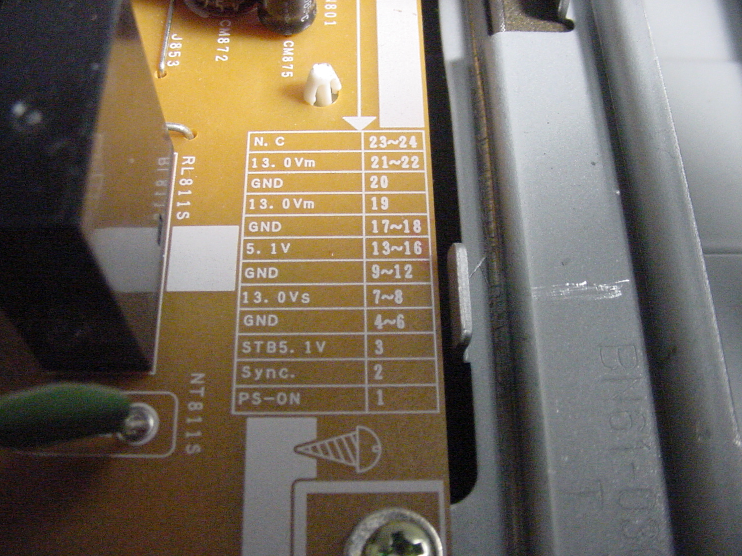

Symptom: blinking red LED, PS-ON OK, BL-ON not present, power relay clicks on.

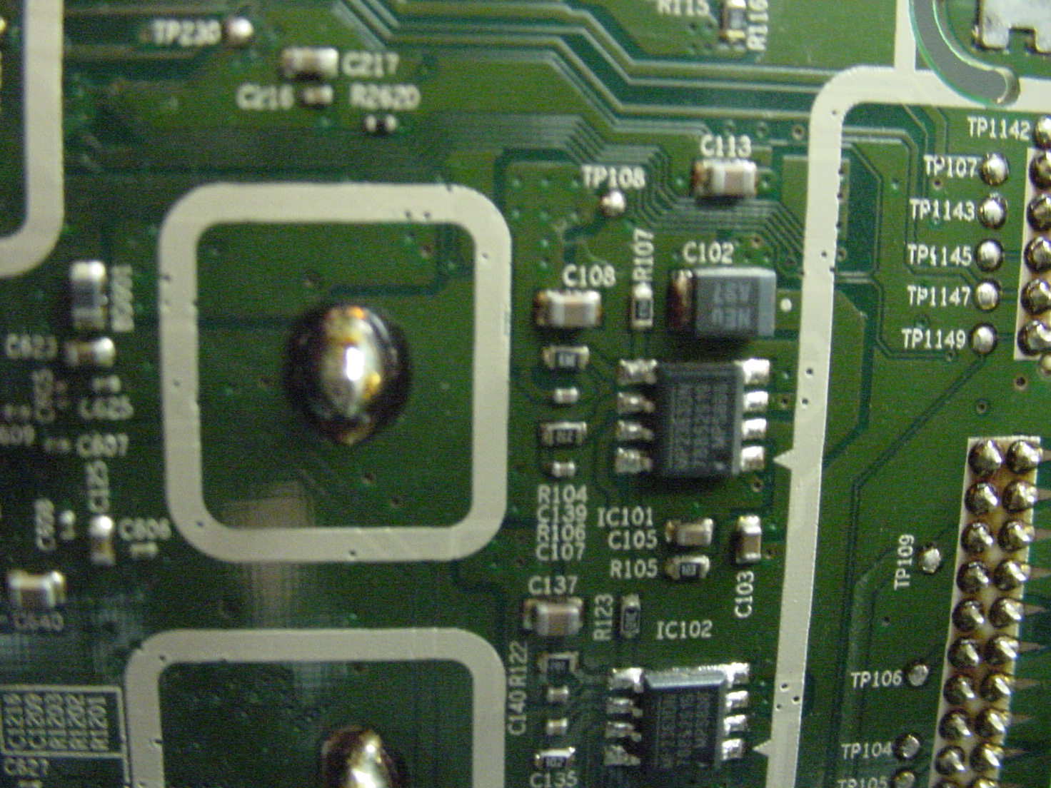

Bad C102 on the main board, solder in 100uF10V low ESR in parallel to fix the problem, easy fix.Never stop learning

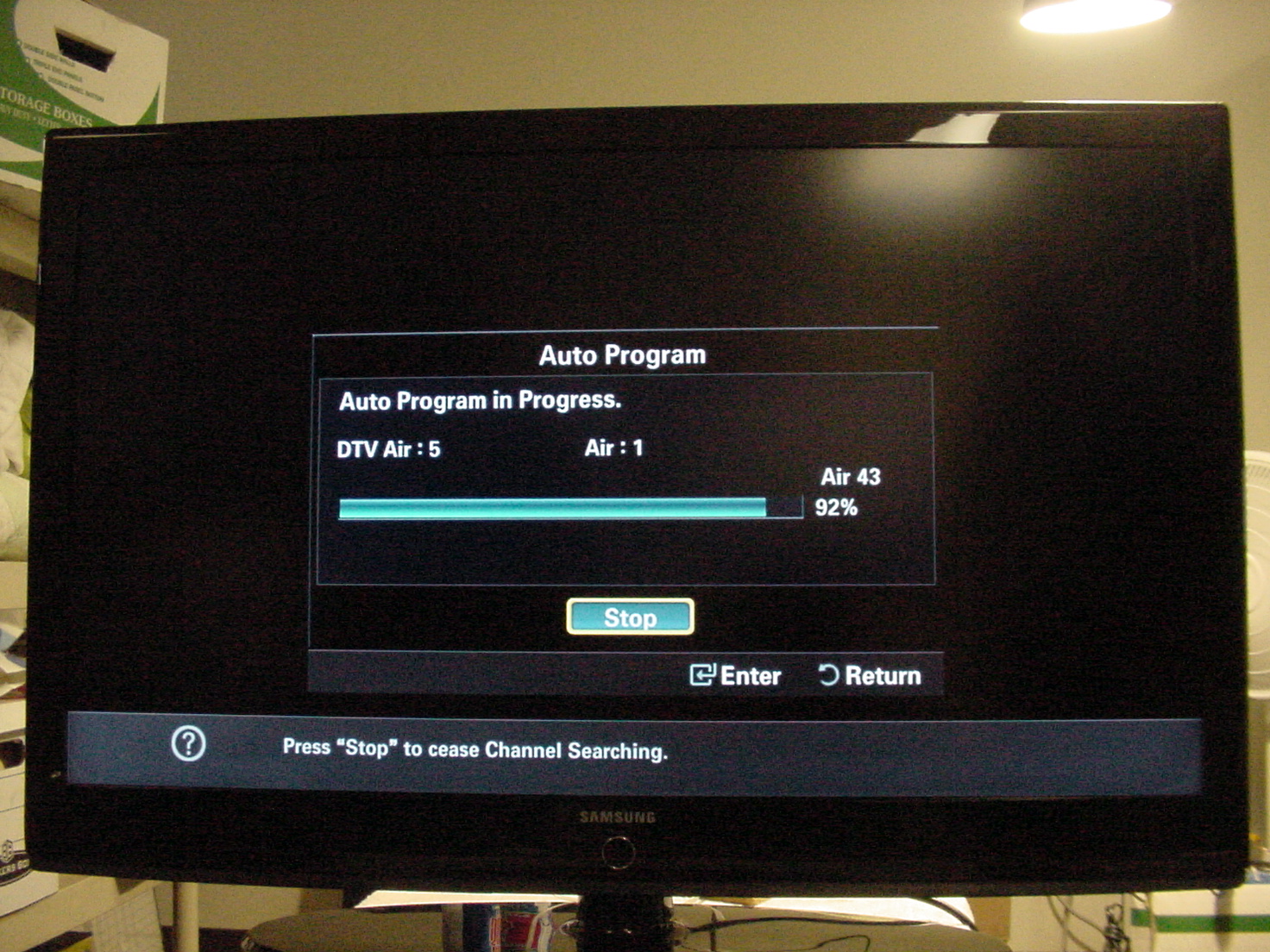

Just to do the experiment to see how long it will last since the original cap did last either, I gave it to the person I know to keep using it and see how long it will last, I did that to one of my TV also about 6 months ago and it still working.Never stop learning

Thanks for posting about this issue. My Samsung LN46A630 would often screech and have a display full of green vertical lines when you tried to power it on after sitting. I had previously replaced some caps in the power supply a year prior and those were still fine. Since tantalum caps like C102 tend to fail shorted I unsoldered the original part and soldered a replacement to the original pads. TV is working great now!
When I tested the original capacitor on my Sencore LC103 it shows the value was less than half of what it should be and also failed the ESR test.
Attached a picture of my repair.

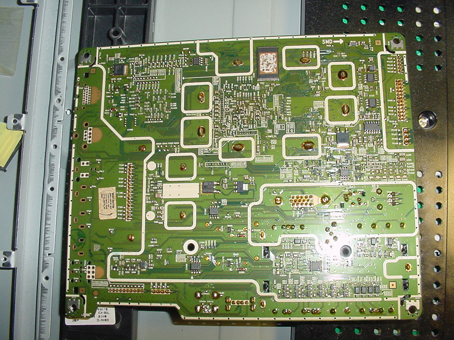

I too replaced C102 with a SMD 100uF 10V CAP and all is working will on my Samsung LN40A630M1F. I was kinda forced into this repair because I purchased a replacement main board only to find out that it was incompatible. Turns out multiple board have the same model# printed on them, i.e. BN41-00975C. But there are other model#'s printed on the board too. Mine had the following:
- BN41-00975C - printed on main board
- BN40-00125A - on coaxle male connector
- BN97-02474A - on sticker on board
The replacement had these:
- BN96-08992B - printed on sticker on coaxle connector
- BN40-00125A - on coaxle connector
- BN96-08992B R-11A sticker on the bottom
- BN94-01723B - Sticker on the bottom
The only visible difference was mine has a 3 pin connector for a fan. The replacement didn't. When I plugged in the replacement, nothing at all happened. I only got the red light but I could not turn on the set. Replaced the CAP at C102 on the original board and it was working fine. So, thanx for positing this fix. I posted the information above for other who would like to replace the board as a warning. Make sure you visually check the board and do some more research on compatibility. I still can't figure out if it's just incompatible or if the board is just DOA. But there was no fan connector.

Thank you to Bud M and others! Replaced the tantalum pad capacitor (unsoldered it from the board) with a 10v 100 uf electrolytic capacitor and the cold start up rebooting issues including noise, and green lines disappeared. No longer have to be looking for a new TV. Thanks again!

Thank you budm! I just tried this repair on a LN52A660P3FXZA and it worked well. I put a 100uF 35V (it was what I had already) capacitor in parallel with C102 by soldering to each end of C102 and it returned to normal startup. Previous symptom was it would take several cycles before it would fully start. I replaced some of the power supply caps many years ago which fixed the problem of not starting at all. I've had this tv since 2008. I plan to use this TV to replace a smaller one in front of my treadmill. If the fix fails in the future I'll circle back to let you know.
