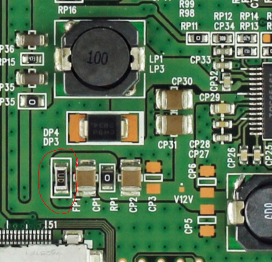

                here is a partial pic of my tcon.
                i have 12v at the VIN pad....and at the V12V pad i have 0v...using the gnd pad for both...how can i rule out a bad tcon causing no image?

                  Check this fuse.

                    #29
                    thanks will check it .not sure how i missed it...guess i was looking for a F lsbel for fuse normally F1 and didnt see it...overlooked it ....i did swap tcons prior and no change...the odds of both boards having blown fuses not likely but is possible..should i have 12v at the v12v test point?.....if fuse is ok then what?
