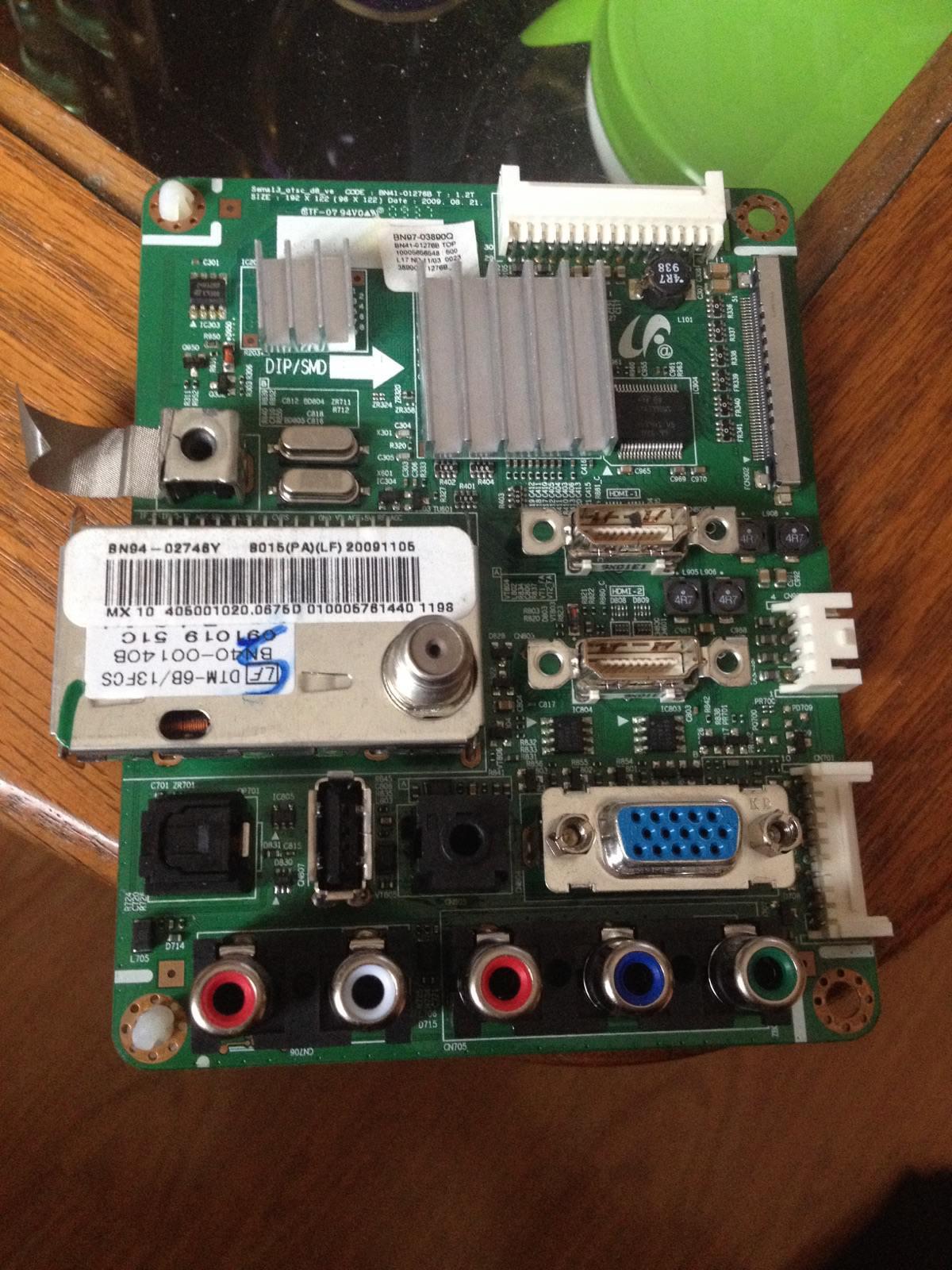

    Hello all,
    I have a Samsung 40 LCD, I bought this thinknig it was a power supply issue, so I changed all the big capacitors,
    What happens is when you plug it in all that happens is the red light turns on you hit the power button on the tv or remote nothing happens, just stays a solid light
    so when i unplug the cord going from the power board to the input board, the screen lights up lcd,
    how do i fix this thanks?

    Re: Samsung LN40B500P3F
    if backlight turns on without the mainboard connected.
    You'll need to repair or replace the mainboard.
        The input board you unplugged.
            yes thats the one is there a sticker with a part number on it?
                it says bn41-01276b in white on the board
                  heres the board i livre in canada wheres the best place to get it?
                    P/N is on the bar code sticker = BN94-02746Y
                        Those boards are quite rare.
