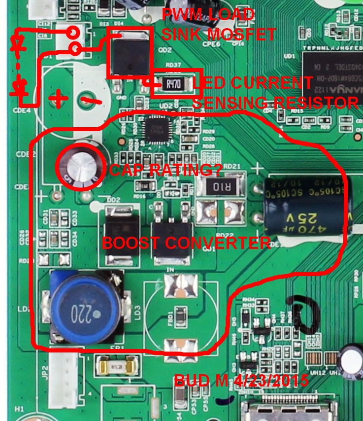

    Considering all I have is the main board and the led strips, no seperate driver, how would one test?
      Re: E320-A0 - Power LED Fades, Sound, Picture (Without Backlight) LED Issue
      The LEDs (I do not see any current limiting resistor on the strips) are connected in the series from what I can see, the return side of the LED (Cathode) is connected the DRAIN pin of the power MOSFET driven by PWM signal, the Source pin is connected to the Current sensing resistor, this junction point is fed to the LED driver IC to monitor the LED current to maintain constant current through the LEDs, another end of the sensing resistor is connected to return GND of the boost converter power supply.
      If the 10 LEDs in series then the total Vf is about 33V.
      BTW, if you have only one strip connected only, do you get any lights action?

        I would think he would have to jumper the output connector of the first strip to make a complete circuit. However if the sensing resistor did not knock down the 33 volts he would have to much current going through the five LED's.
          The Voltage is not really regulated, the current is regulated to maintain constant current (for steady lights) as the LEDs active resistance varies due to for example the temperature, the MOSFET and the sensing resistor and the feedback are used to maintain the current.

                    For current to be maintain at constant, the active element in the circuit has to be constantly adjust due to change in the load resistance so basically the Voltage across the load will varies with the change of the load resistance to maintain constant current, in this case the MOSFET is the active element that is being used to maintain the current and the sensing resistor is being use to measure the current through the circuit.
                    As you can see that when we look at the Voltage output to the LED, the output Voltage is way high due to no load, if it is Voltage regulated, the Voltage would have been constant, so at no load or at high resistance, the output voltage will go up to try to force 100mA or what ever the constant current should be so it max out the output Voltage.
                    For example, lets say that you have 1A constant current power supply with 1 Ohm load, now if the load is changed to 2 Ohms, then the output voltage must go up to 2V., but if the maximum power supply output Voltage is only 10V, so when you put 100 Ohms load on it and it tries to force 1A through 100 Ohms, that will never happen since it can only put out 10V so the output will show only 10V (MAX OUT) and only 0.100A will be flowing through the 100 Ohms.

                      You can connect variable resistor to output of the LED drive to see what range of the current regulation it has, and you will be able to see the relationship between the output voltage and the load, for example, some people will bypass the bad LED in the string, if it is well regulated current source then it should function fine, I will need to do the experiment myself to observe the results.

                          In the parallel situation, the LED driver circuit goes into shutdown if one of the parallel string goes open circuit that is what I have seen in the panel with parallel connection (it is not really directly parallel since each string has its own MOSFET and sensing resistor).
                          You cannot really parallel the LED directly since not all Vf are the same, the one with lower Vf will light up but the one with higher Vf may not light up or barely light up, that is why you use resistor with each string of the LED you are doing simple parallel LEDs connections.
