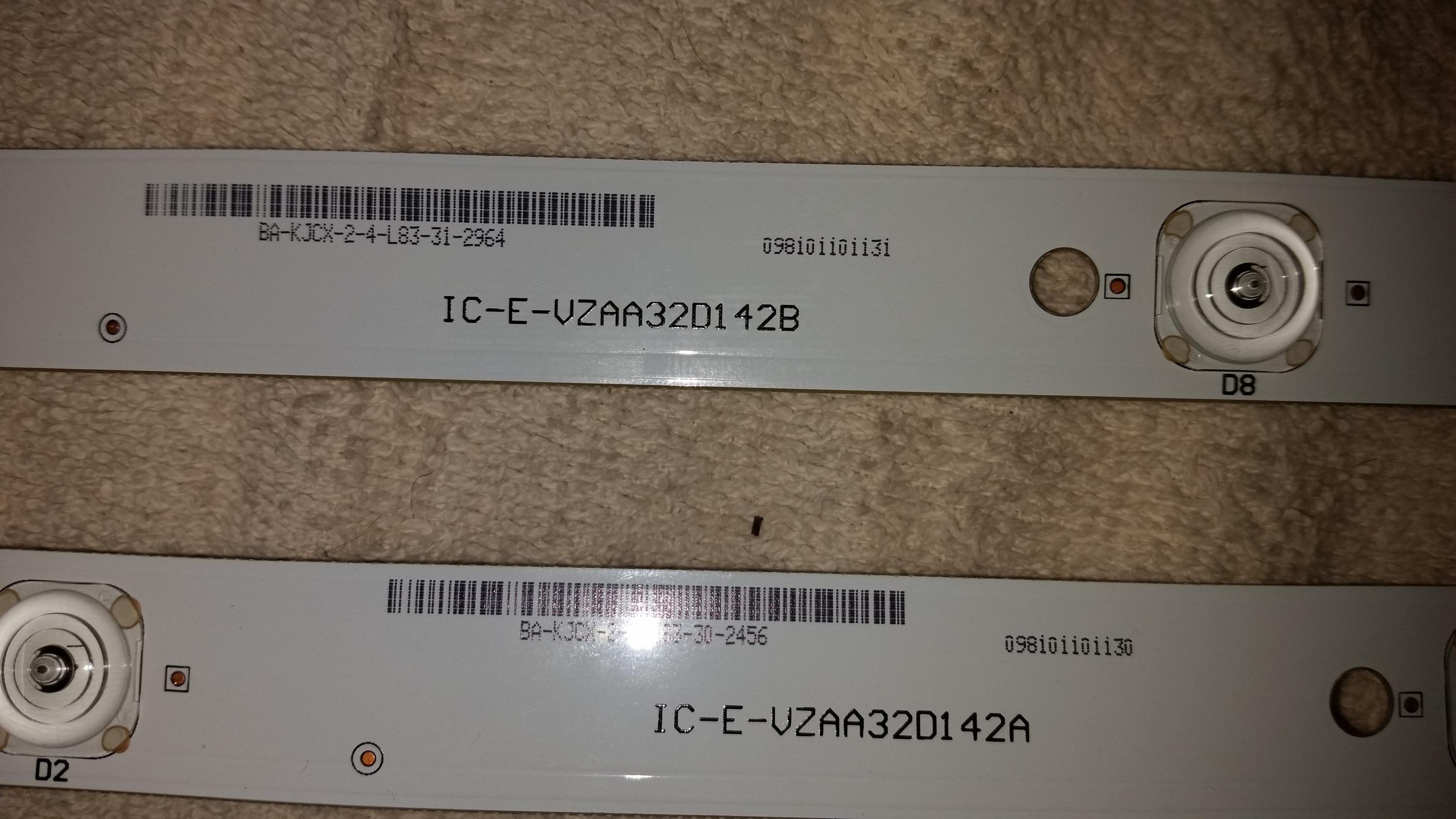

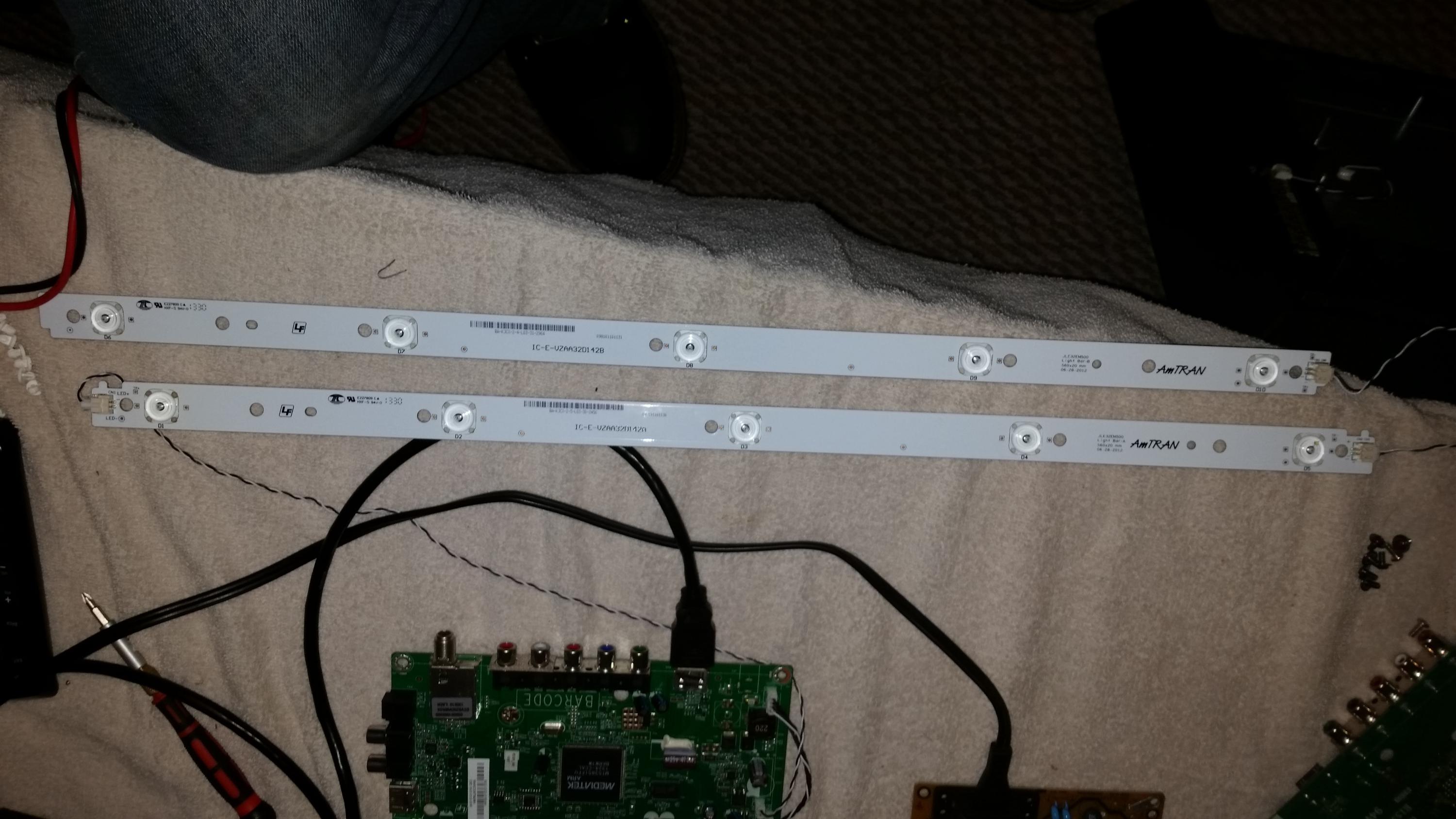

    I have a E320-A0 that I am fairly certain is the backlight strips. All voltages are normal, and getting 33v to LED strips.
    Now, on the main strip, input is 33v goes through 5 LEDs, out at the end is 9v.
    The first strip doesnt even flicker. The second is very faintly flickering.
    I am fairly certain its the LED strips. I can not find replacements anywhere, so is there a way to test this to the individual strips and individual leds?

          Adding pictures.

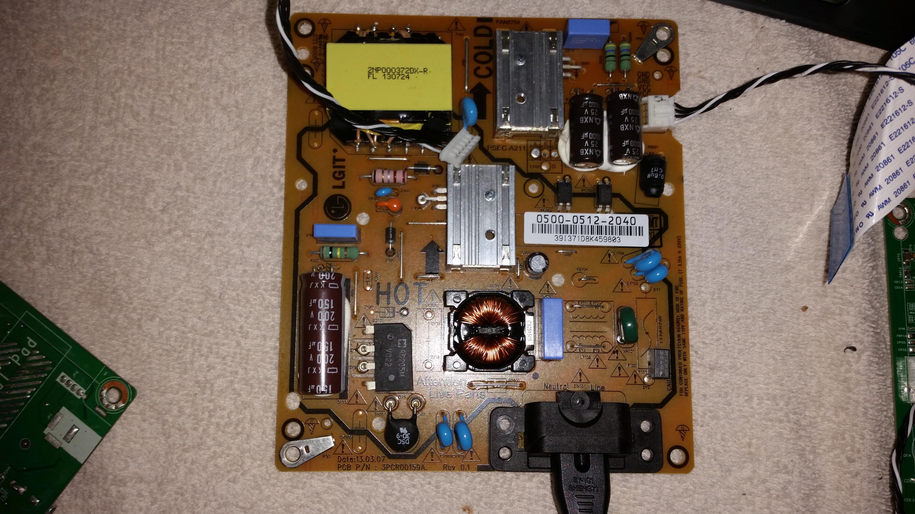

                Re: E320-A0 - Power LED Fades, Sound, Picture (Without Backlight) LED Issue
                Is this the power supply/led driver board you have?
                http://www.shopjimmy.com/vizio-56-04...upply-unit.htm

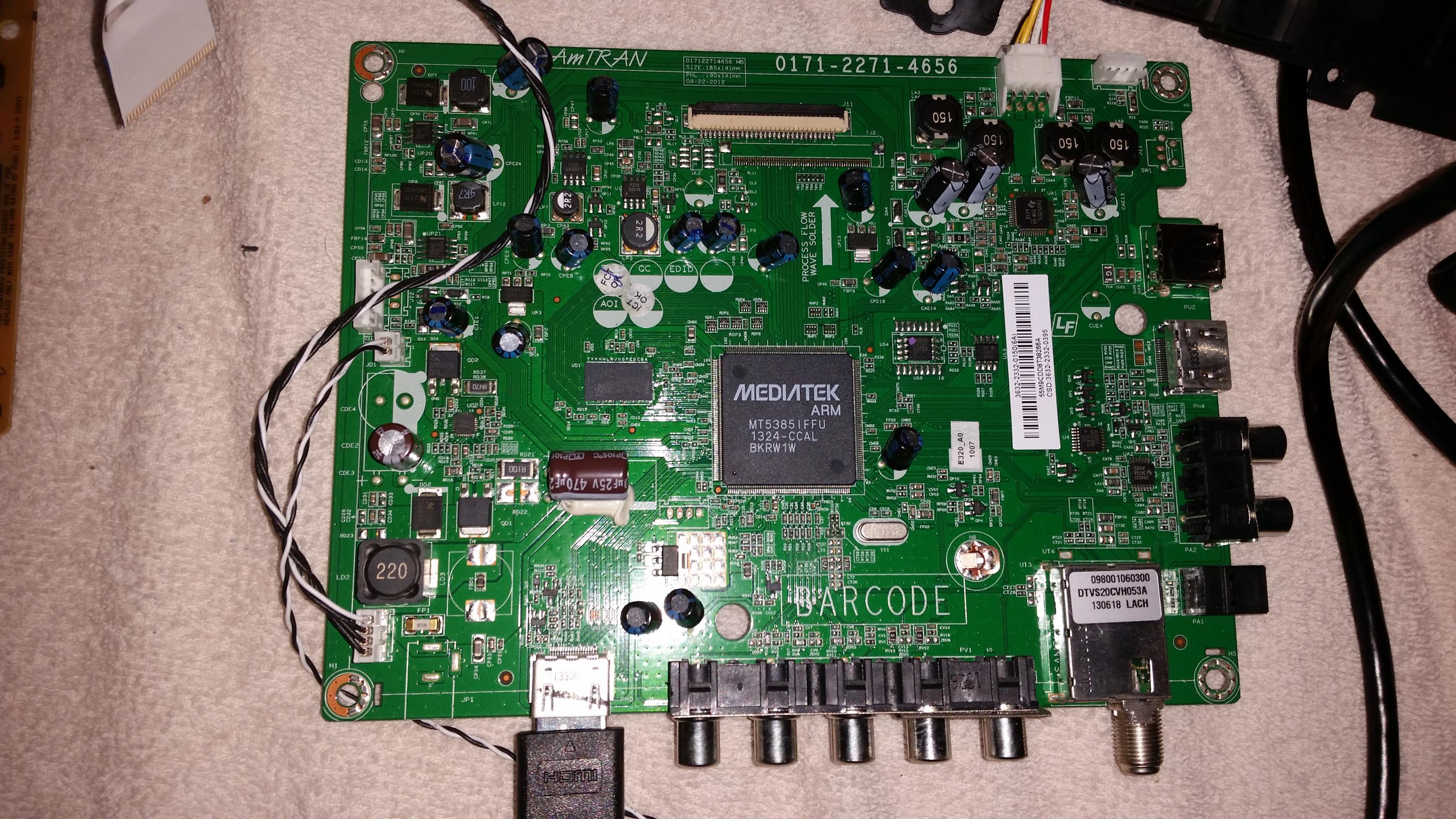

                  No I have this main board and this power board.
                              I cant get any of the leds to light up with 3v 100ohm resistor supplied power
                                You try both direction and are you sure you are making contact with the LED's legs?
                                It can also be dual-LED (two white LEDs connected in series inside) in one body.
                                  I tried all the points on the strip. I can not get below the dome without damaging it.
                                    It looks like in your picture the LEDs are connected in parallel. The power feeding into one strip and at the end of that strip it is jumper-ed to the second strip. It seems also there are test points label. I make out one as TP4. If the cables are disconnected and you take an ohm measurement where the cables plug in are you measuring a short?
                                      To verify the led's on the strip are connected in parallel you could take the first strip that the power goes into and measure from where the black cable would connect to the black cable on the output connector of the same LED strip, the connector that connects that LED strip to the other LED strip through the cable. You can then do the same for the other colored cable, I guess the other cable that is white or gray. This measurement can be done without any cable connected. If they are in parallel you should read a short on both measurements. But first do the previous procedure to make sure that you do not have a short between the two input pins of the first LED strip.
                                        Woke up this morning wondering what was I thinking. They drive these LED strips with voltage even though they are a current driven devise so I take back the parallel and say it must be connected in series. I do not know why they don't connect them in parallel so that if one went out the others could still be working. Anyway, the driver circuit should tell a person how they are connected.
