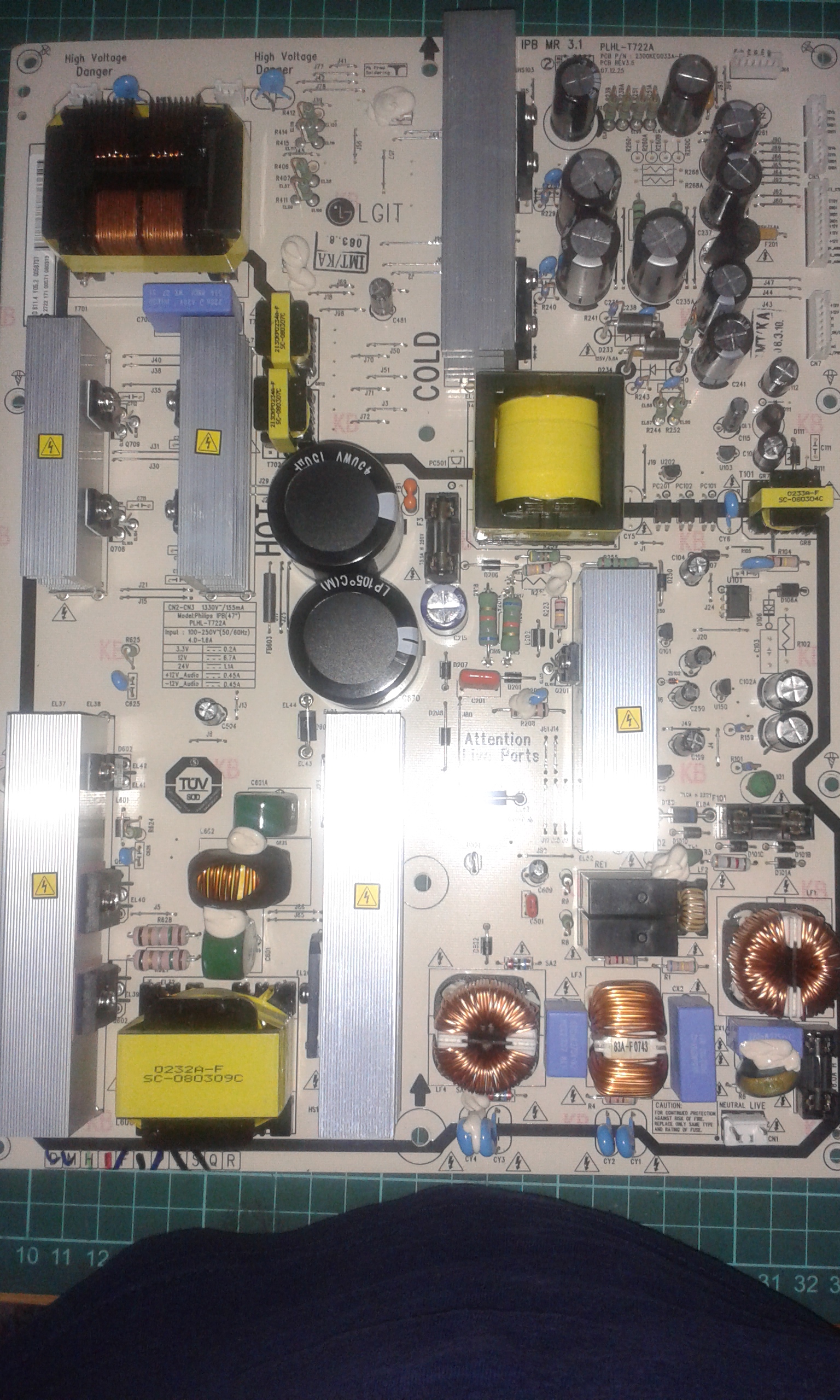

    Hi so Ive checked through a lot of threads regarding the philips make of bad capacitors and checked the power supply board on the tv and have so far not found a bulging or defect capacitor and as a precaution I have already gotten the neccessary repair parts Philips 272217100571 (2300KEG033A-F) Power Supply Component Repair Kit. I have no idea what the problem it might be. Backstory: Got the tv for the equivalence of 7 dollars and I wanted to surprise my grandmother and also wanted to feel somewhat good at electronics although I have only deconstructed vhs players and other misc things to get better at soldering before I jumped into this big project. So the problem at hand the Tv clicks when i put the power cord in and the red standby light flashes 3 times the pauses and repeats indefinitely ,(sorry for bad english too lazy to spell check*) I have pictures of the power supply board because I only guess it is the culprit but can be any other board I dont know. The model is as stated in the title a Philips Lcd 47pfl9603h/10 assembled in what seems to be poland.

    Fuse F101 looks black ( blown ). Replace U101 IC and fuse.
    IC = FSQ510
    Fuse = 1 amp slo-blo
    Then plug-in and try it !

      I am wondering if its the image causing them to look blown, They all look rather black internally from the image.
      Can you check all 3 fuses please

        Can you please remove all fuses, one at a time so you don't forget where they go, taking a picture of them on a white back ground please, best to use sunlight and not the flash on the camera. It is true, they all do look blown so possibly just the way the image has been taken.

          Can leave the one at the mains input as we know that is fine

            Good advice from all ! I should not assume that the fuse is blown until checked.
            Just because it "looks" bad is not proof.
