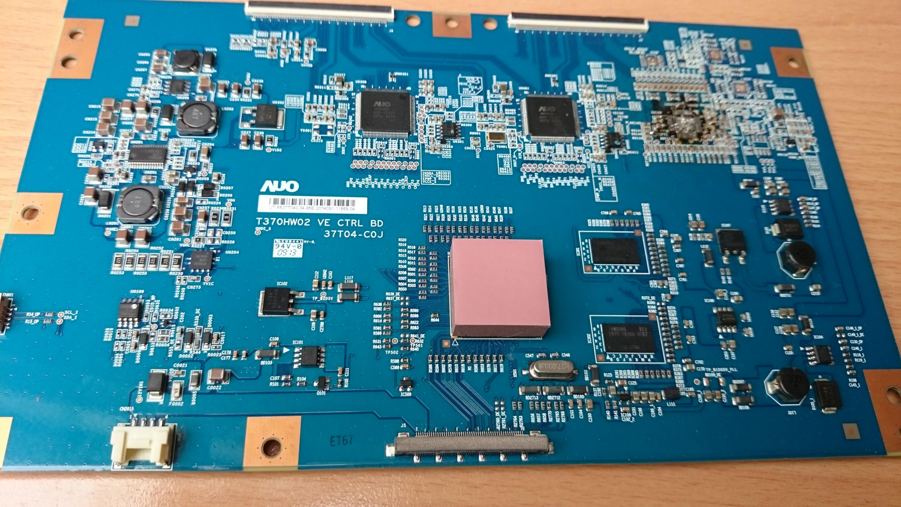

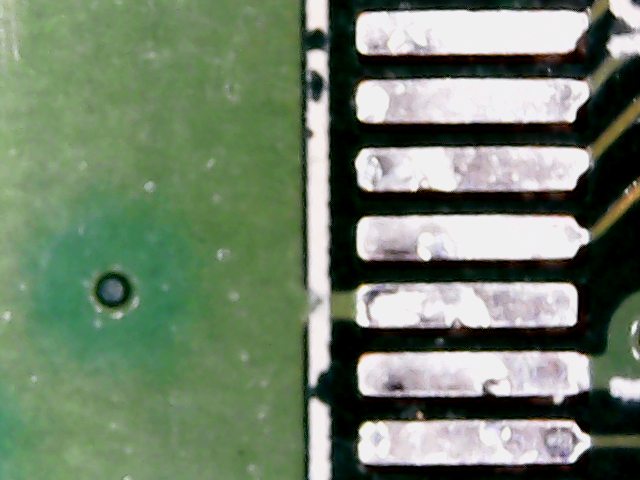

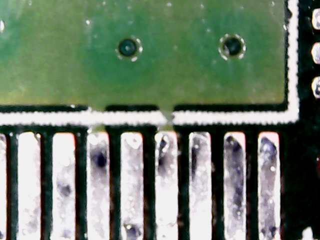

    Hey guys ,
    I got this problem with 2 samsung tvs.
    Both got the same tcon and show the same image on the screen.
    Its either a black screen with just backlight or it shows these green lines.
    I already changed the as15 chip 2 times but still the same issue.

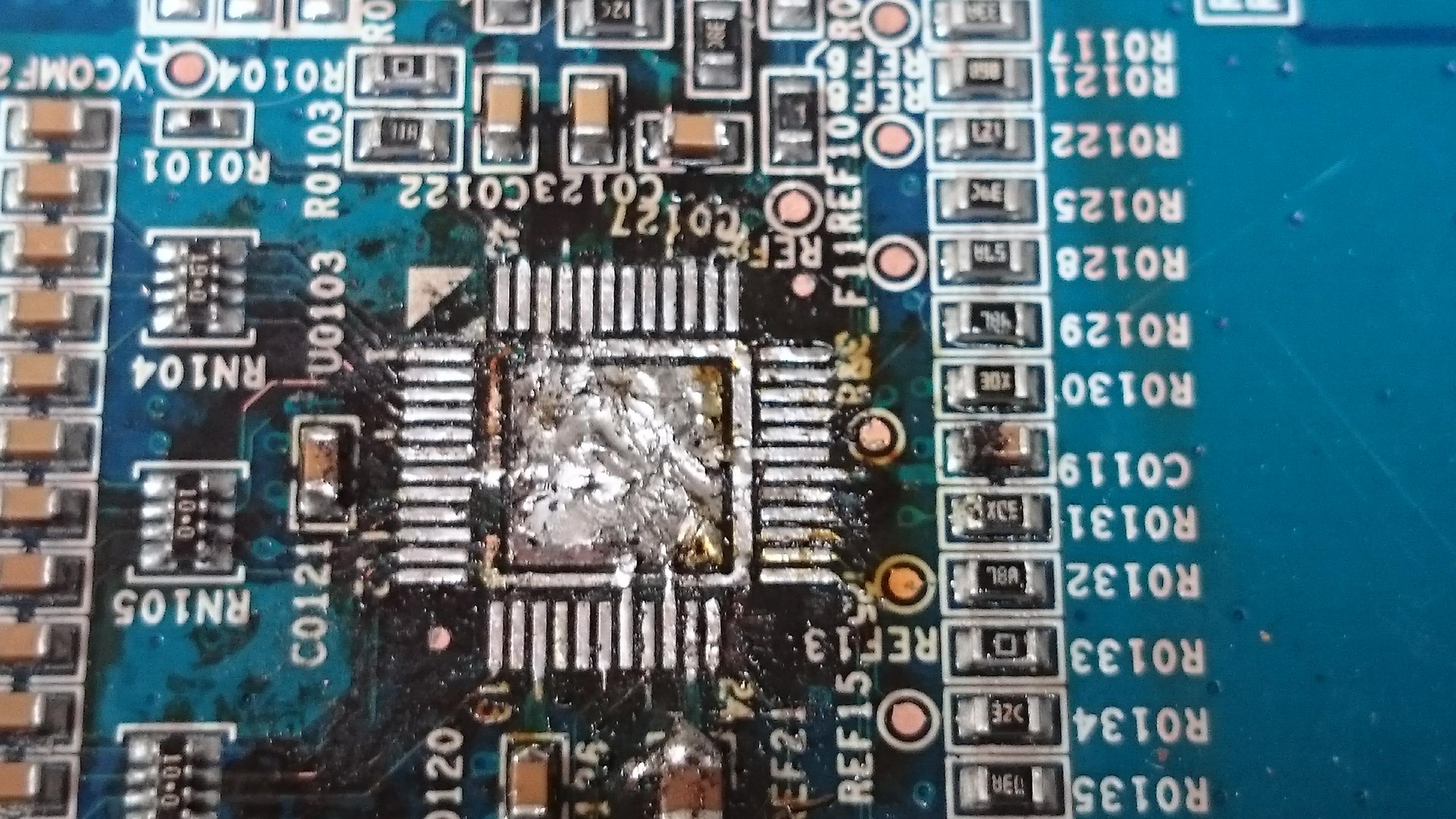

    Problem is the Tcon and my question is , are ANY of the as15 pins connected to eachother? On the picture you see a thin square around the cooling area thats connected to some pins , is that correct?
    *yes i know 1 pin is missing.
    Could someone tell me if the layout as you see on the picture is correct or do i need to remove some solder? Ps , board is not clean yet.

    I'm not sure how you determined that the as15 was at fault, normally when it fails it leaves the image just with no contrast or correct colors, I would suspect the tcon or possibly panel failure causing the lines. It appears you have two ribbons leaving the tcon and going to the panel, have you tried disconnecting one at a time to see if half the panel comes up?

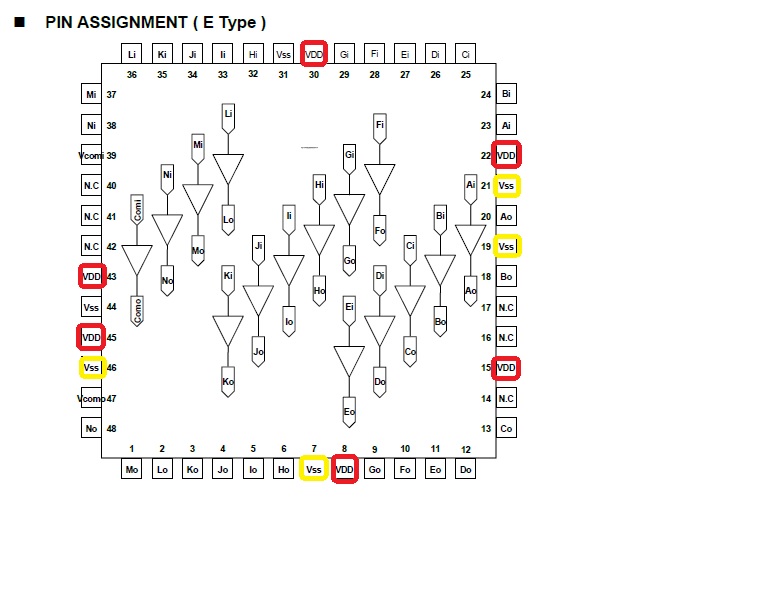

    It could be that those are pins for ground you would have to look over the pinout on the data sheet for the as15

          I think that I'm shorting the pins? Just googled for AS15 and found a picture of a Tcon without the AS15 chip and they are not connected….

            Bad tab bond on the panel can give a similar failure as the as15, the best way to verify is to use the vgma test points and check the voltages. Linked in the pinout for the as15 below, vdd and vss appear in several locations around the chip. Just noticed I missed highlighting one of the vss pins on the left side.

                    on my T-CON there is no ground plane under the square of the AS15 IC, i wonder why yours has one.
