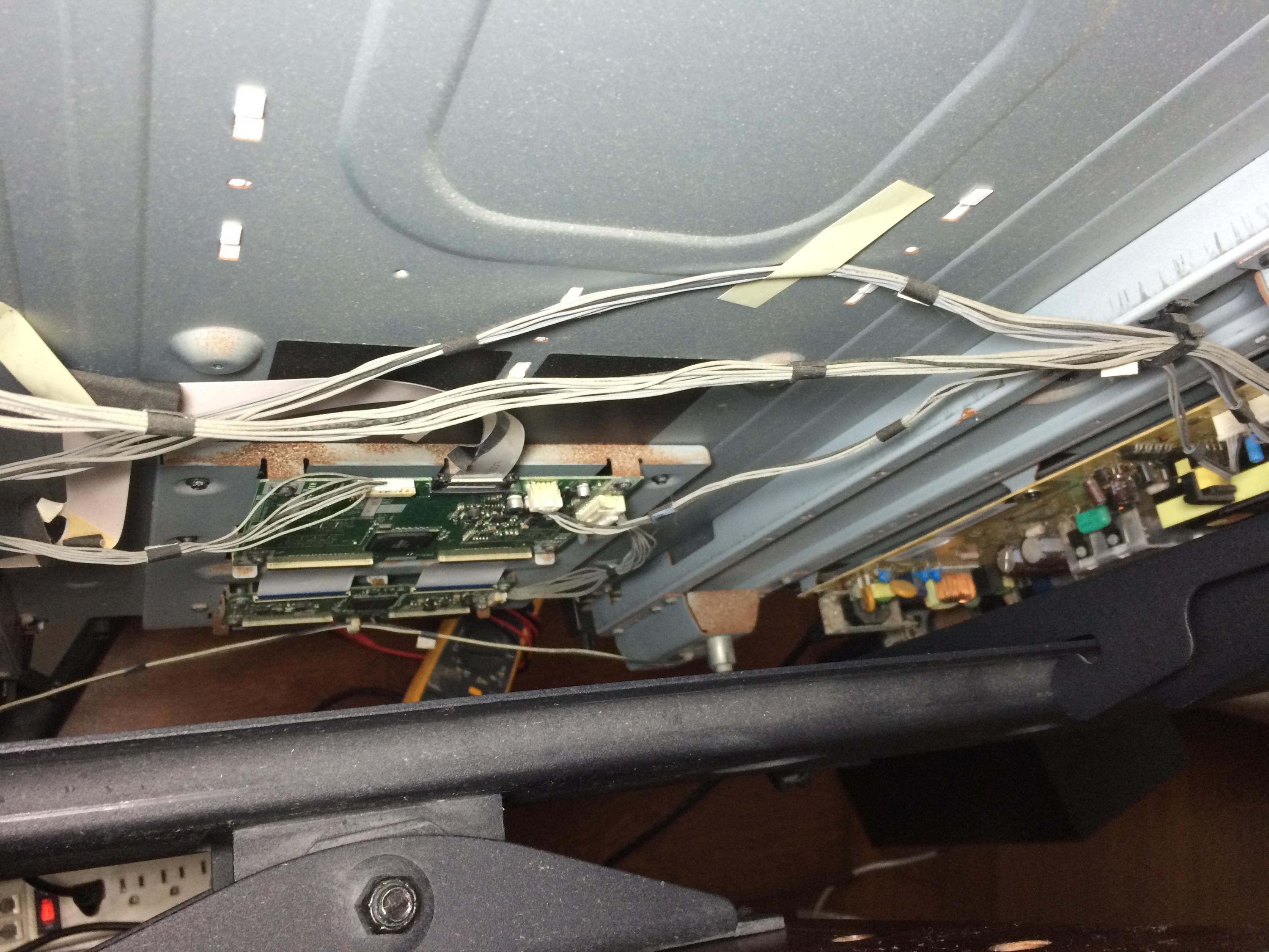

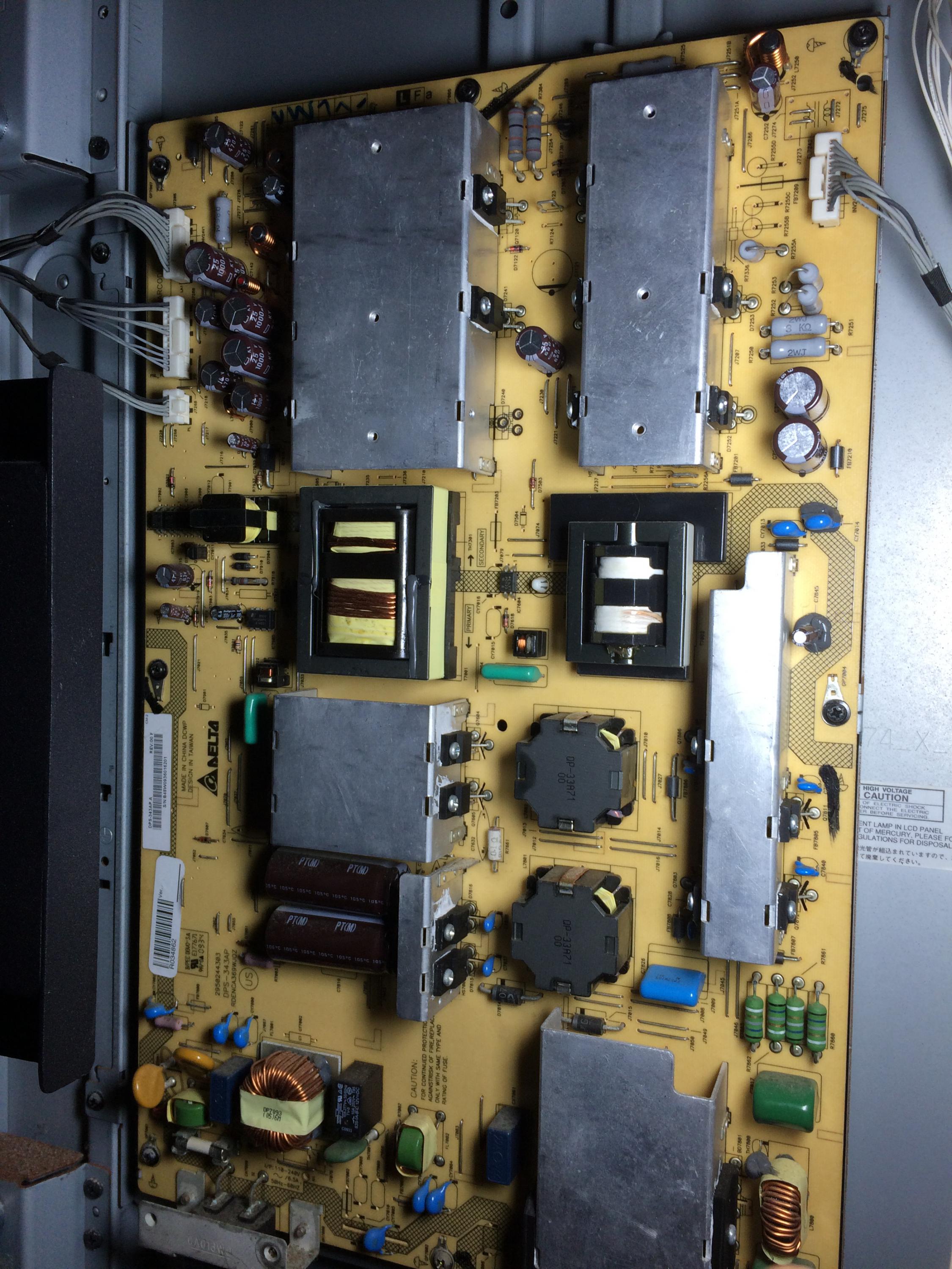

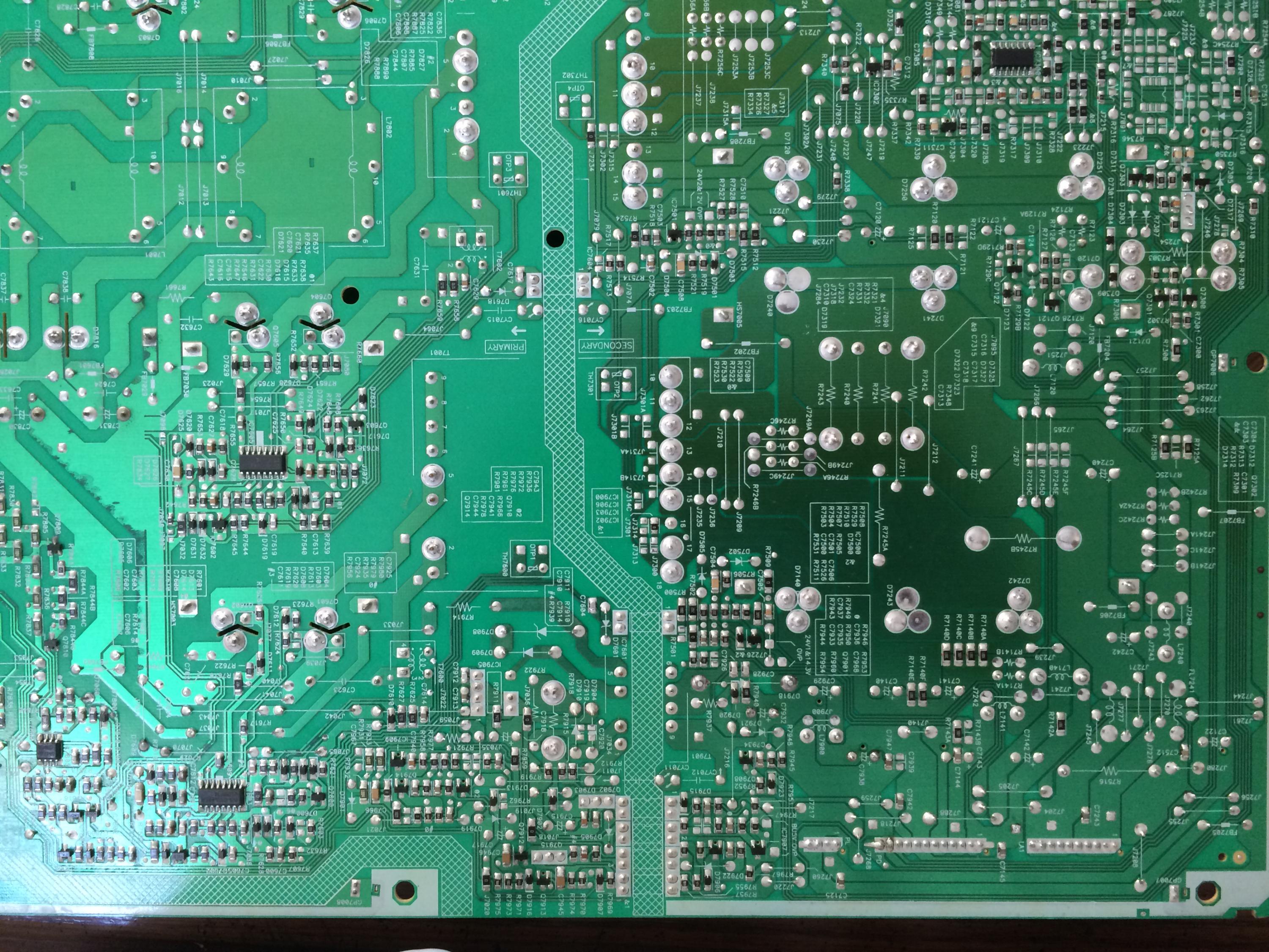

    Can you give us a pic of entire board and one of chasses layout please
      Re: Sharp LC-C6077UN (DPS-343AP) PSU issue DET_15V
      Here you go.
      Since I Have it mounted I took top down photos.
      PSU right side, some board in middle, left side has AV panel etc.
      PSU_ON comes from the board with AV panel on it

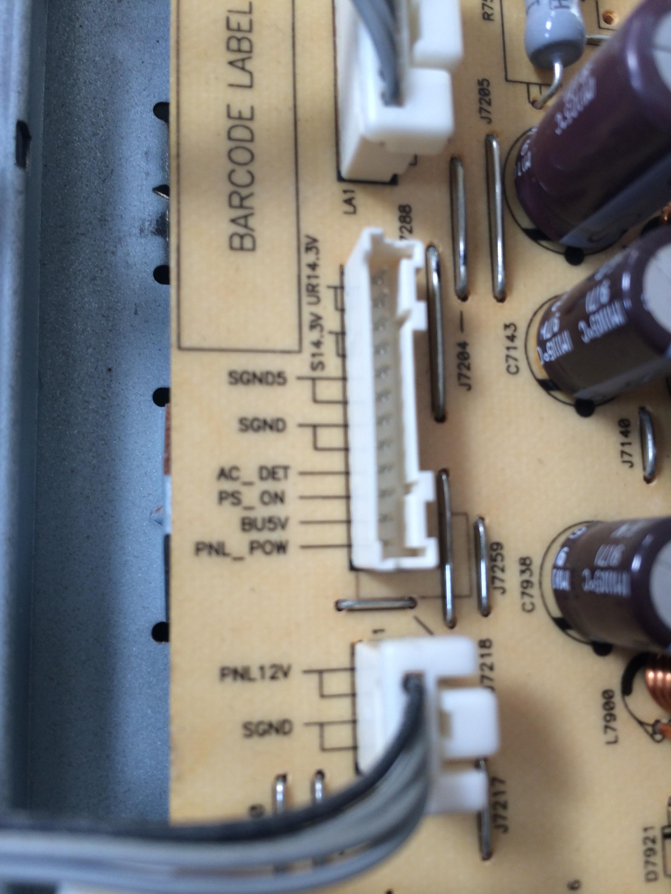

          So when you forced on the power supply board.
          The missing 12V, do you mean the PNL12V? It requires to have PNL-PWR command signal ti turn on this 12V
          The 15V, do mean the UNR14.3V?

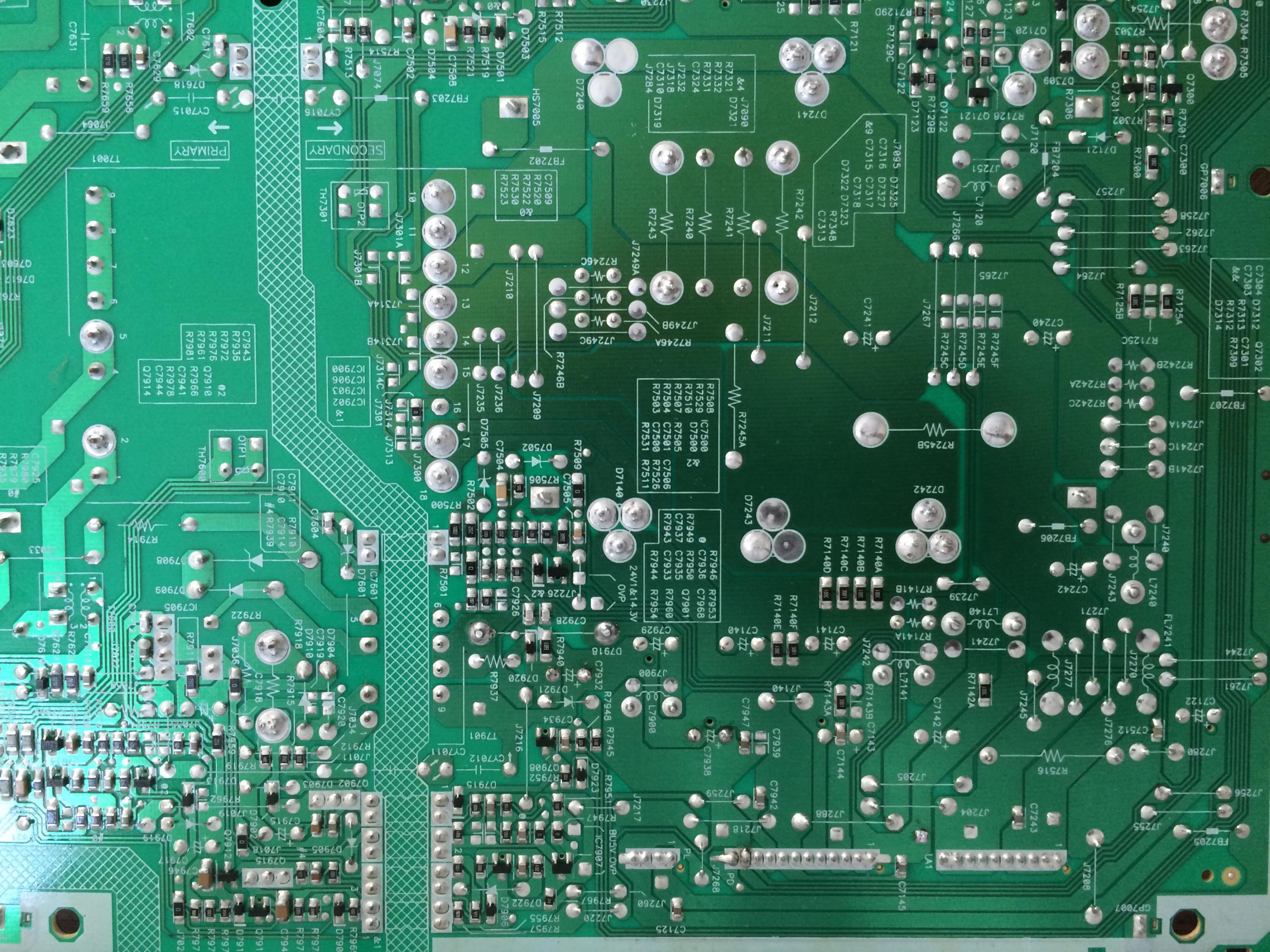

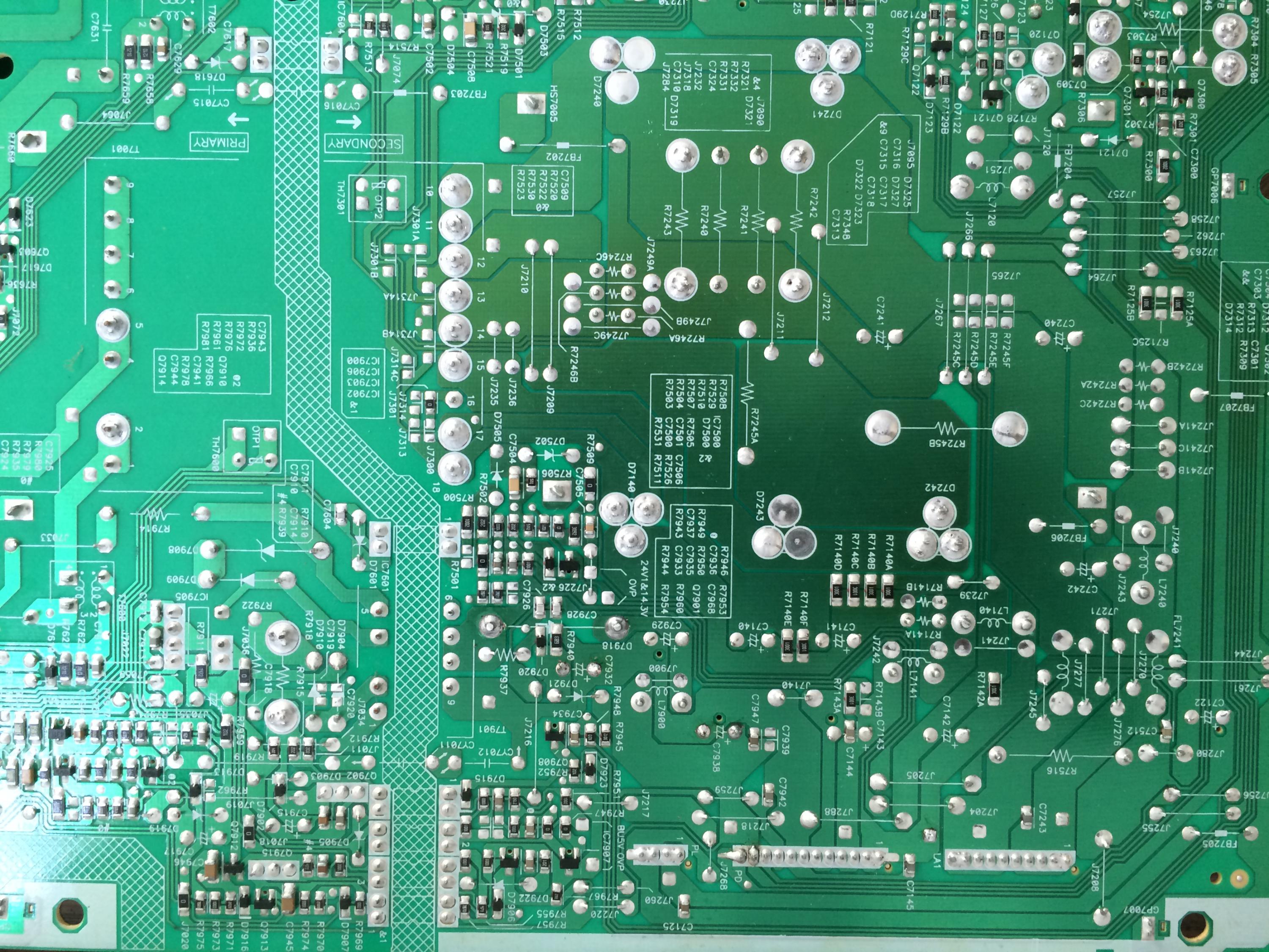

          Shopjimmy does not have pictures for the bottom side of the board so you need to take really good clear pictures of the bottom side of the board, they must be clear enough to trace the connections.
            Ok I did not know that abt the 12V. So I'll throw that out from the loop for now. Yes for 15V I mean UNR14.3V
            I have some updated photos in this post about as good as I could get at the moment.
            Unfortunately, I took the board out to measure a few V back to D7140 and couldn't recreate the issue. I then placed the board back in the TV and could not replicate it. The only thing that comes to mind was a full overnight cool off at 75-76F. I will run it and try to get a measure back to that component. Its accessible from the top so it could be measured in the unit.

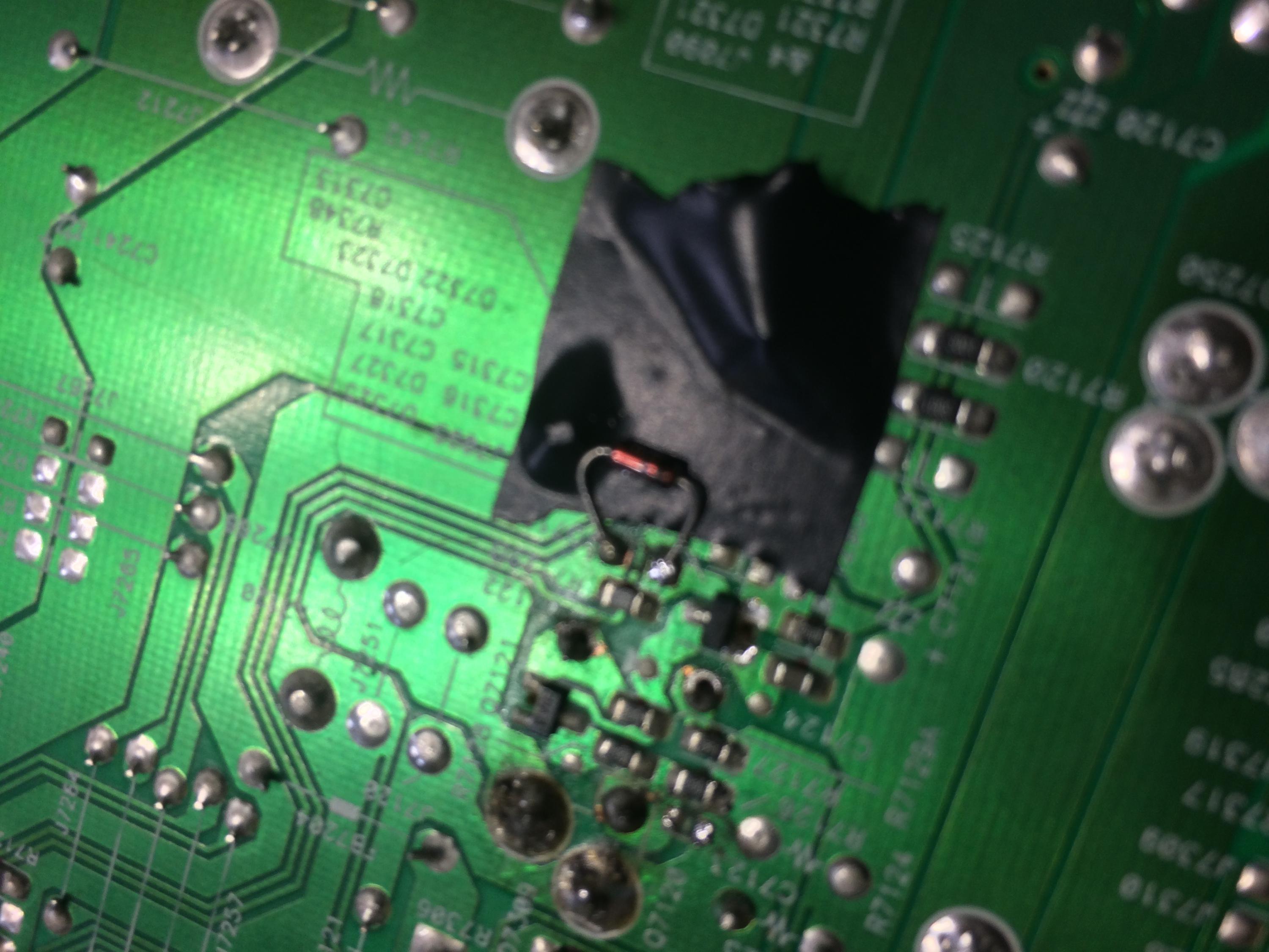

                        So with that info I was able to trace down the issue to one diode.
                        I replace it with a generic diode I had on hand and it works.
                        The 'bad diode' has a 0.7v drop off the board but when on the board it didnt conduct anything- weird for me.
                        I'm also attaching the partial shcematic that I managed to trace out. It might have an error but it gave me enough of a picture to find the issue.
                        D7123 was the problem ~5V on one side, nothing on the other.
                        Attached a photo of the temporary patch. Should I just get any surface mount diode that fit the foot print?

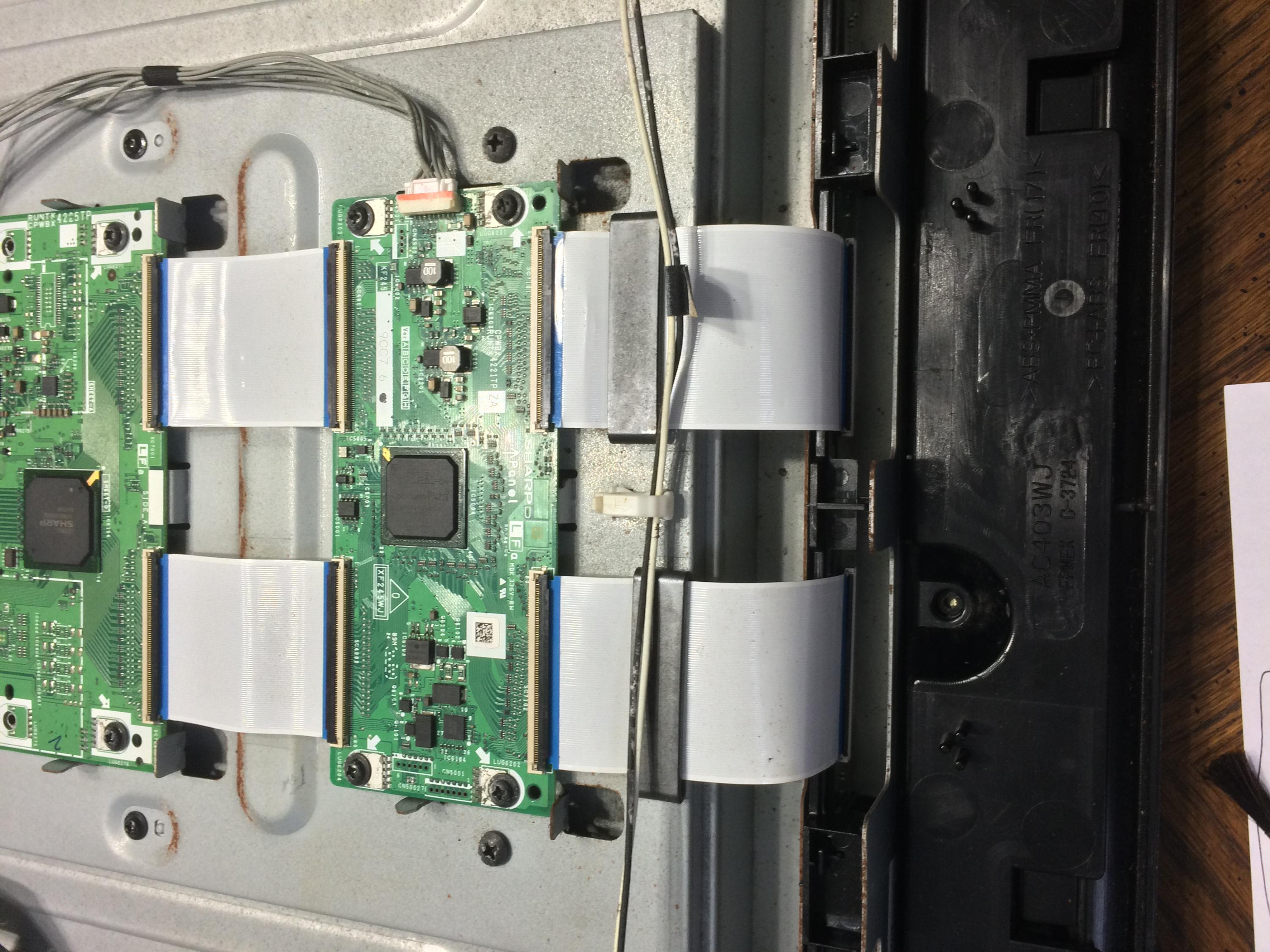

                        I started looking around at the ribbon connectors and found 2 with some damage to the gold contacts. ( I had attempted reseating as a quick first step). I belive they may have been damaged during that process.

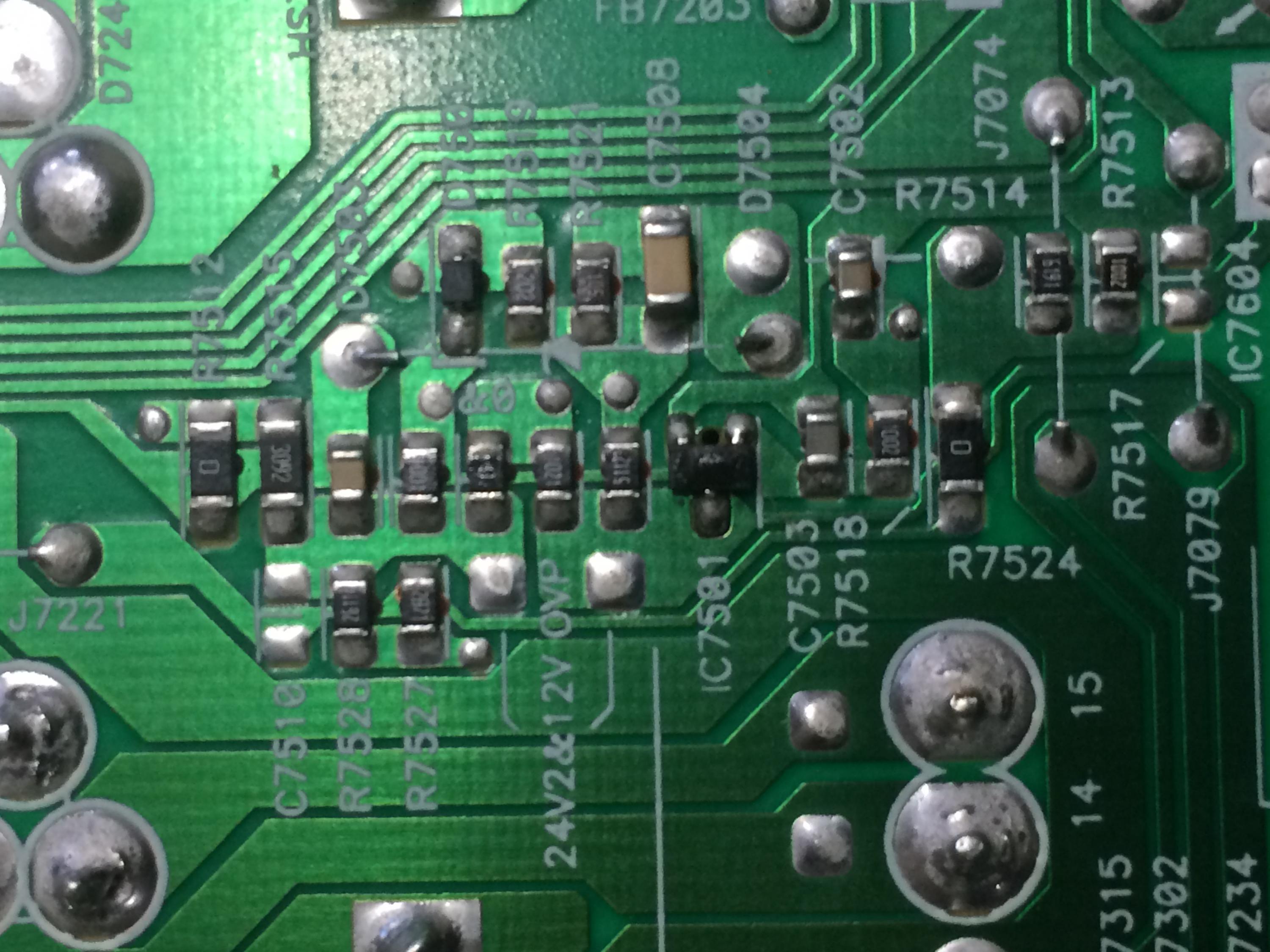

                        Does anyone have any idea what IC7501 is? It's bulging but I cant get a read of any marking on it.

                          After playing with the cables I now have a picture. I am not fully sold on the cable longevity so I will try to get new cables!
                            That would definitely cause the no picture. Sometimes what I've done was to cut the cable back and carefully try to clean the white laminate off of the ribbon and create new connections

                              I'm definitely going to need ribbons. One half of the screen is darker than the other, so its not perfect but at least confidence is high that good ribbons will have me back to normal.
                              Do you have any idea about that bulging IC79xx I mentioned?

                                      All good here now. Grabbed a pair of ribbon with matching 80 pins off ebay and everything is normal now.
