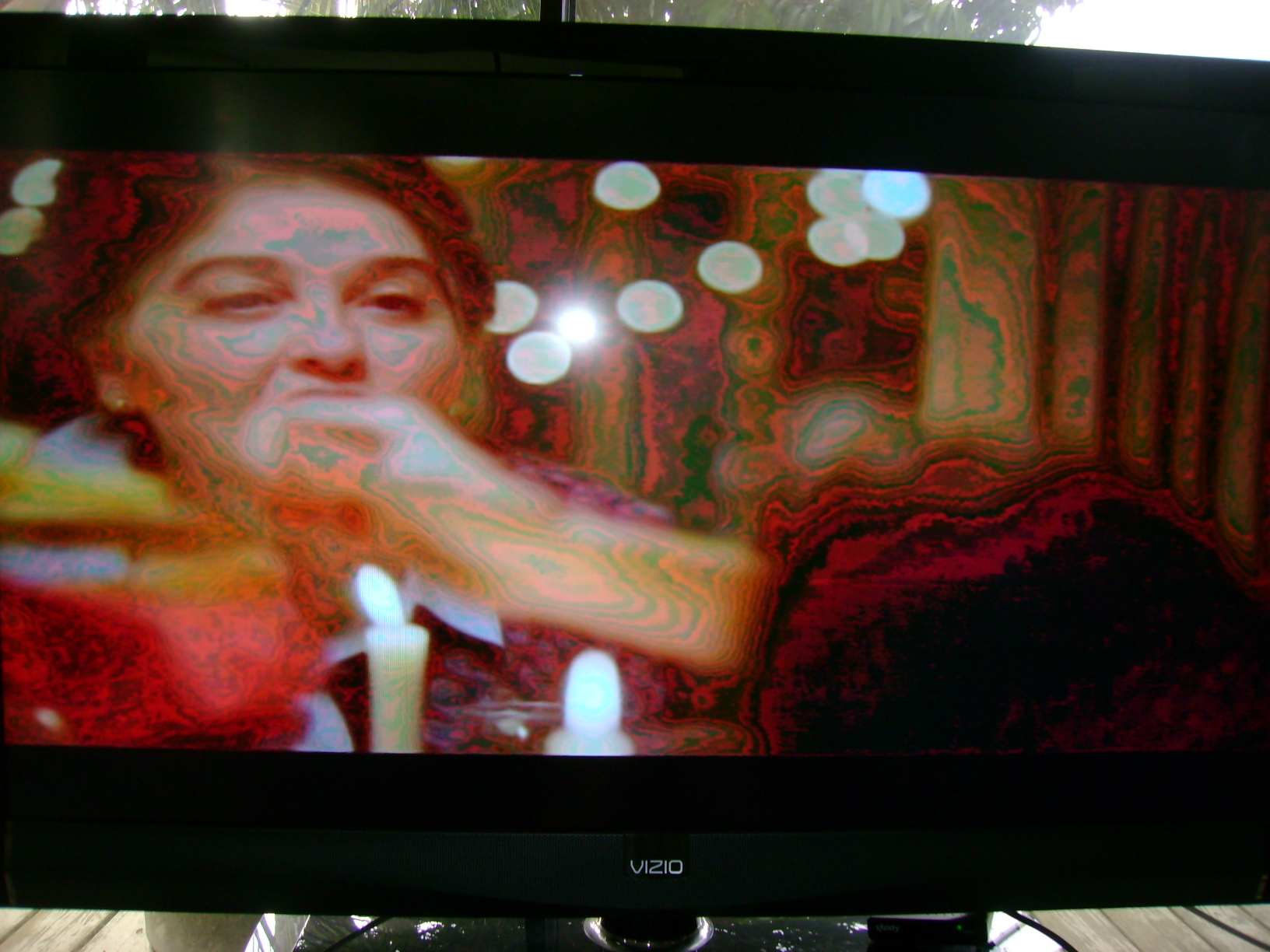

    M421VT LED Screen Color Distortion
    I have a VIZIO M421VT LED TV and it's got what I will call a color display distortion problem. I'm a novice at TV repair and would appreciate some advice with which direction to go with this one...Some times when it's turned on,,the picture is good,,then after about 20 min or so,,it will go to bad. I tried heating up main board,T-Con and PS with no noticeable effects.. Sound is good and all channels work..Any help appreciated..

              I have the TV connected to my PC..This is weird,,when the TV is first turned on the pic is corrupted (as seen in pic first post) after about 5 min the pic clears up very nice and stays good so far for about 2 hrs.

                      I just restarted after a 2 hr cool down and the pic stays bad for about 5 min then clears up.When it's not good,,,the distorted colors pulsate around the objects on screen,,,then it slowly gets less and less becoming perfect

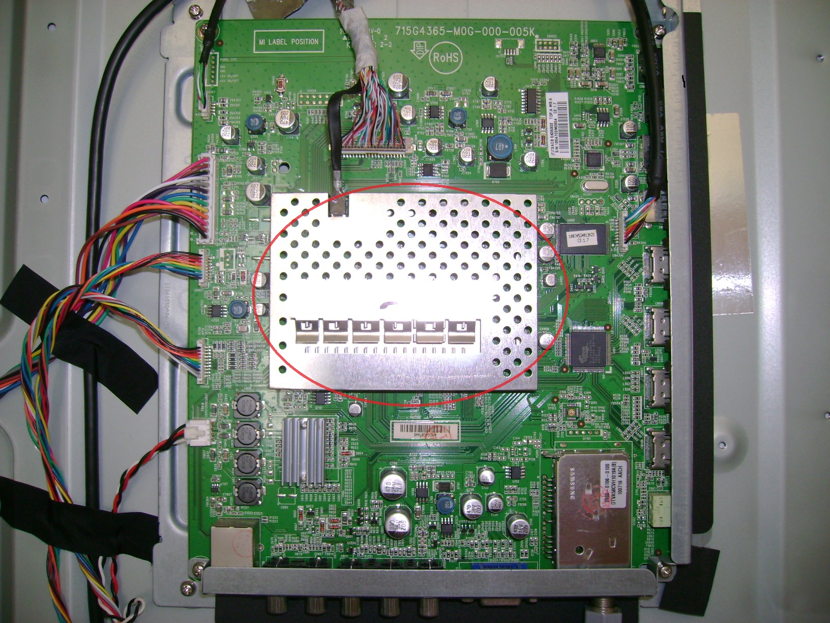

                        Use a hair dryer across mainboard... it should clear quicker.... Next time try directing heat at smaller area using insert of toilet roll or similar... Circle smallest area on a pic for us.... May be able to repair

                            I did some testing with my heat gun and toilet paper roll and came to the conclusion that indeed the main board is the fault. I used compressed air to cool down main board and the picture would go very bad when doing so..If I concentrated the heat on the metal shield,,the pic would clear up in short order.I preformed this test of cooling and heating many times and narrowed it down to what ever is hidden behind the metal shield...So...is there any repair for this board or should I bite the bullet and buy one off the net ?

                              Most likely logic IC under there... from looking at the tracks anyway. Have the equipment to get that shield off?

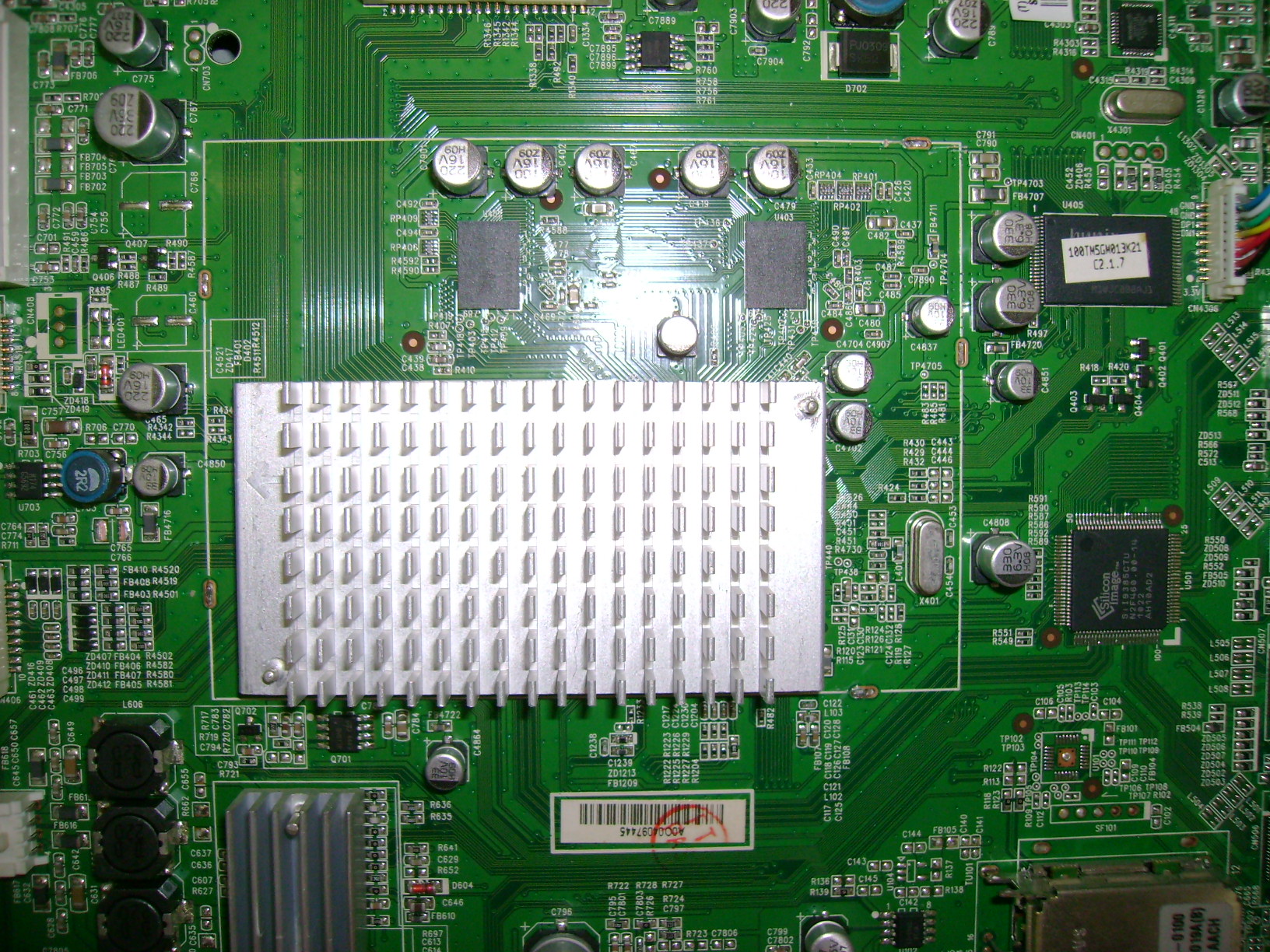

                                Ok,,got the shield off,,big heat sink under it..Remove heat sink ?

                                  Firstly try heat/cold directly at that heatsink
                                  Give is a pic too
