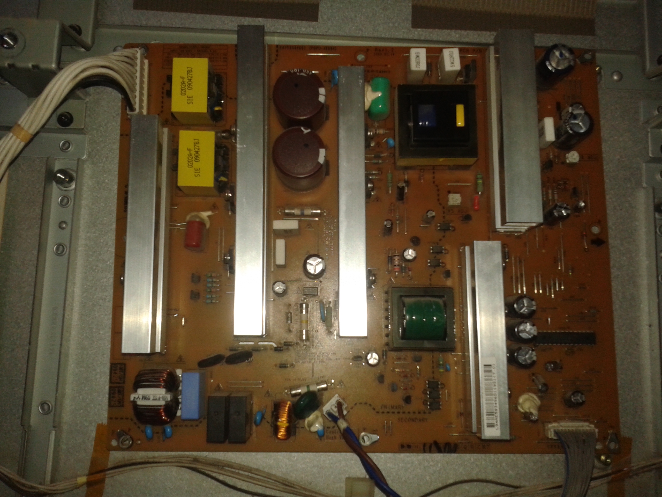

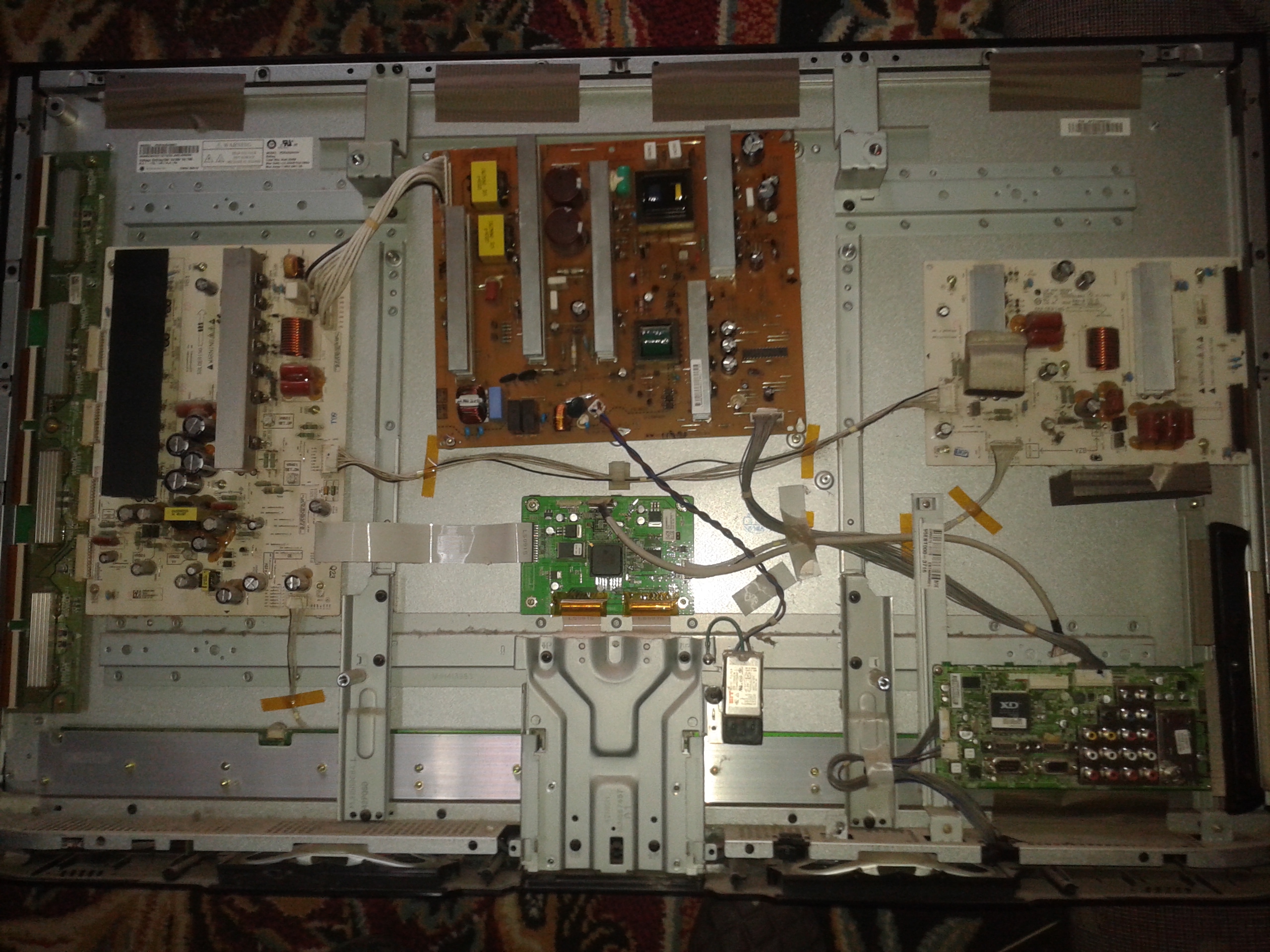

        Re: Lg plasma 42PQ60 Power Problem
        I am following this post , Can u post some picture of your TV , starting with clear picture of the power board back and front , full pic of the whole set so we can see the lay out of each board and a picture of each board close up shot that is visible to read .

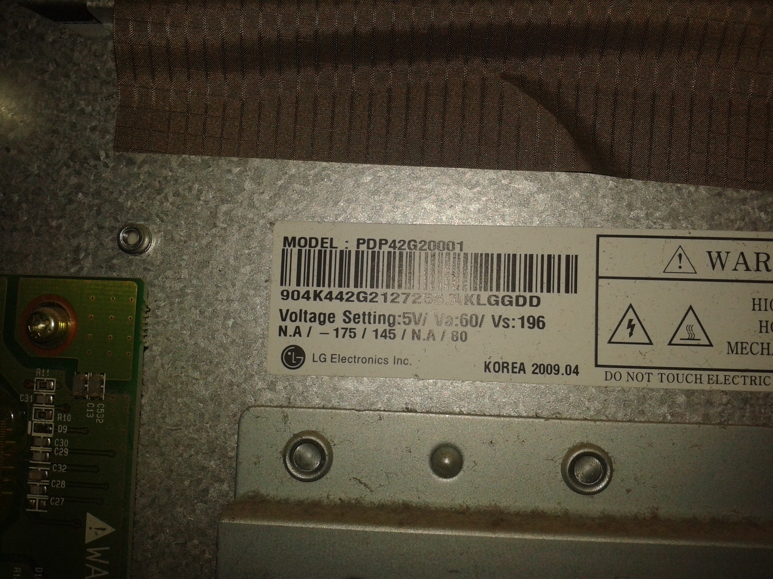

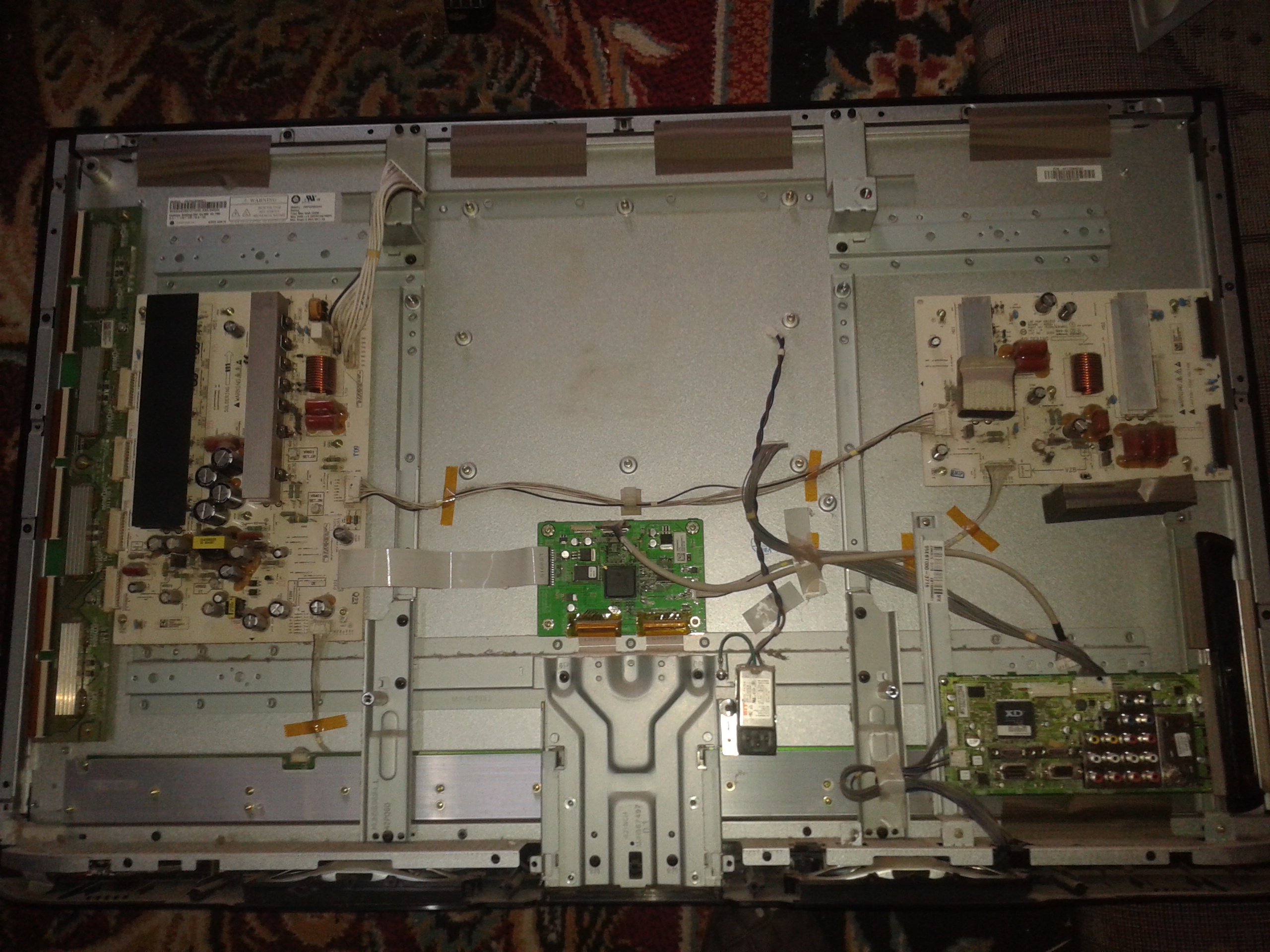

            thanks .
            here is some pictures of Power Supply
