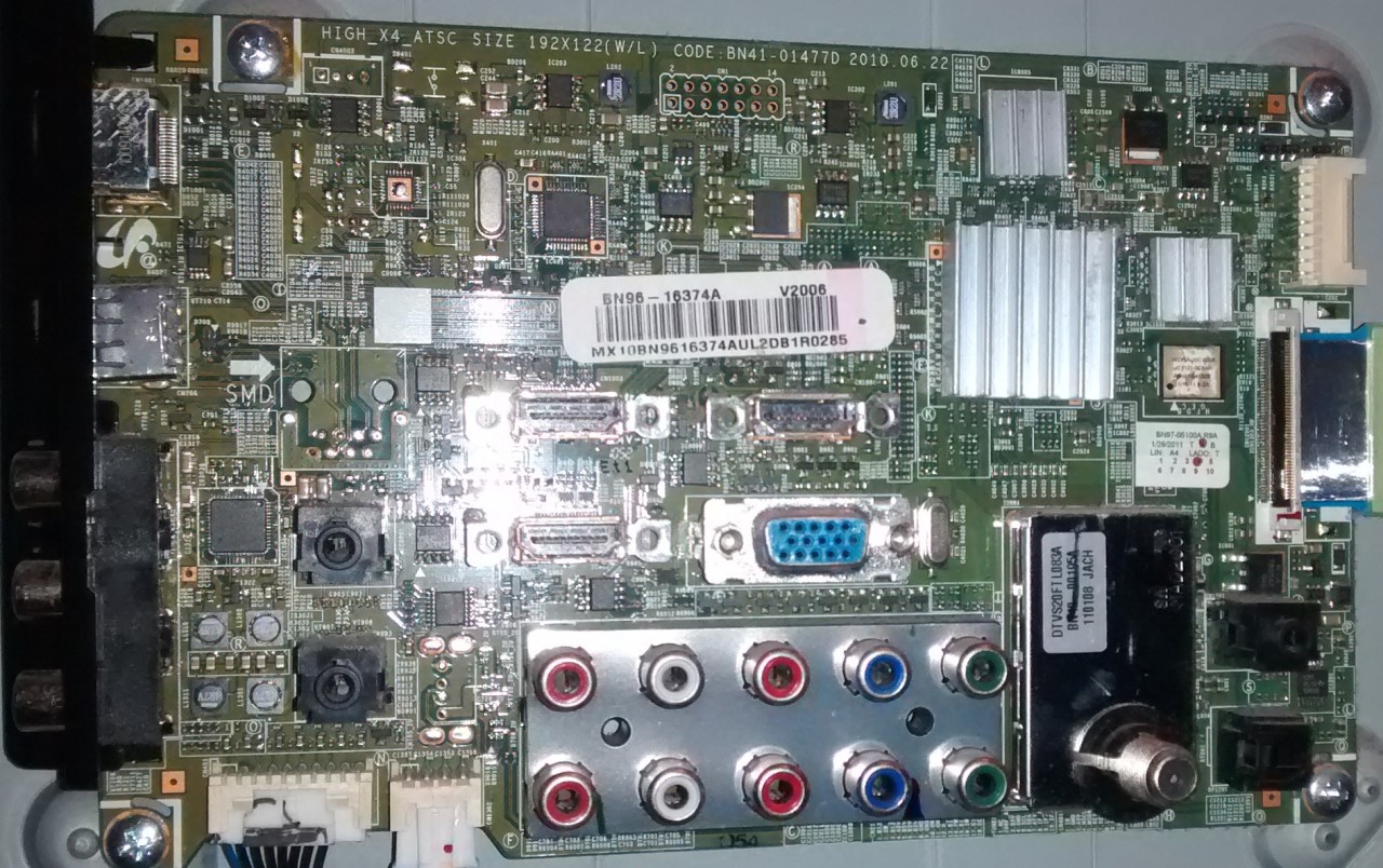

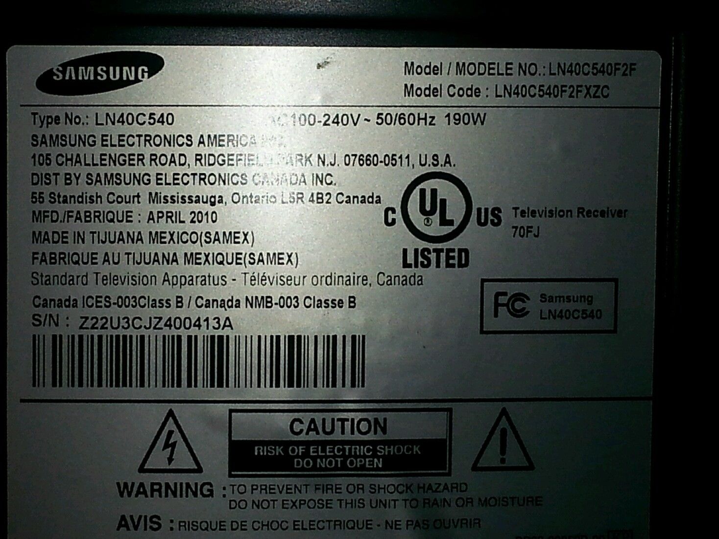

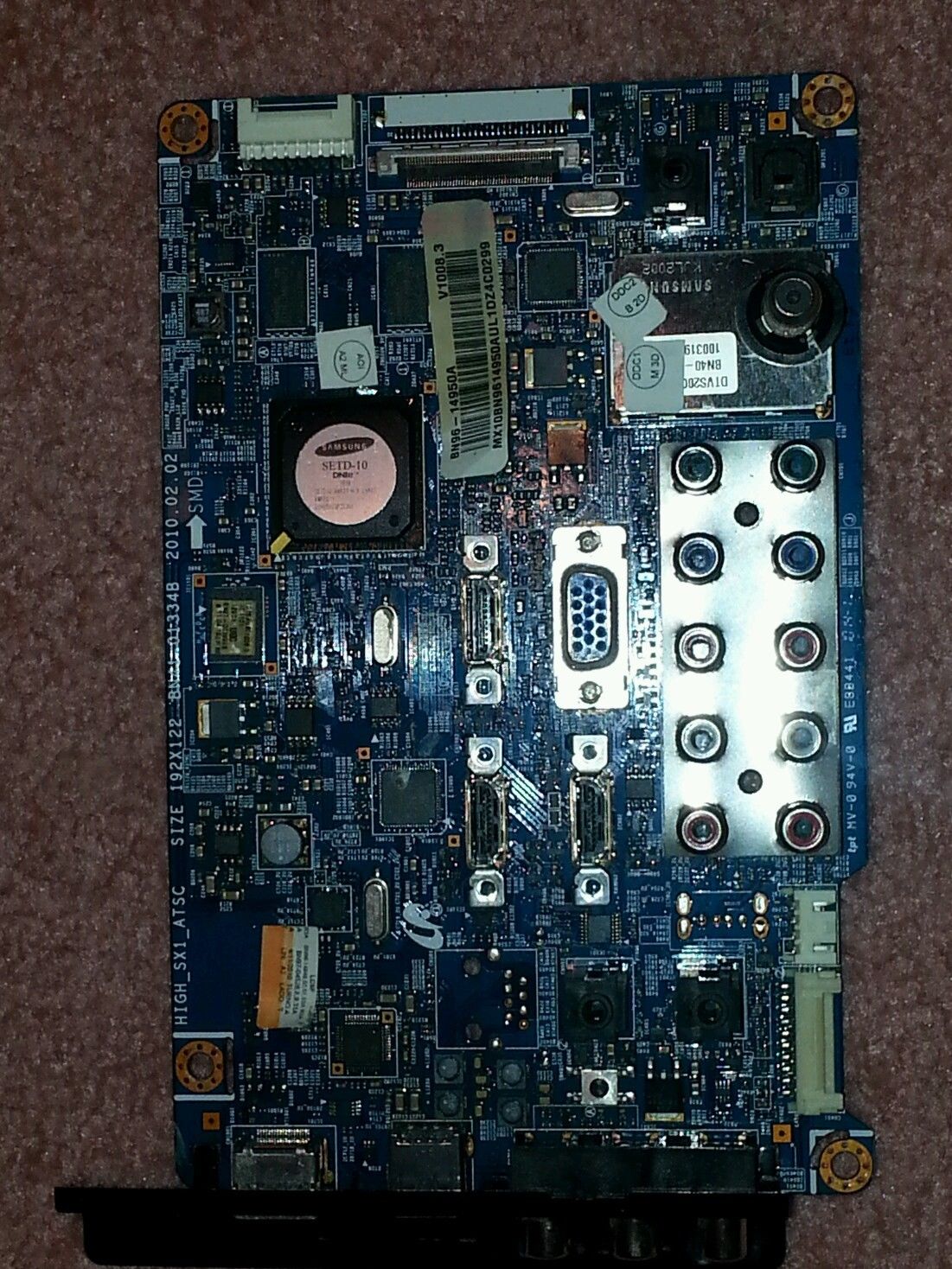

    Is it possibile to swap a main board from a 40" LN40C540F2FXZC TV into my 46 " LN46C540F2FXZC?
    Main Board problem was identified as follows:
    The power led blinks six times when I try to turn the TV on. I disconnected the main board to power supply cable and the backlight goes on. As per this thread, it would indicate that the main board is defective.
    Since this was a model exclusive to Costco and Walmart Canada, I'm having trouble finding parts for it. I've made a special request to Samsung Parts Canada, but judging by the other main boards on their site it will be very expensive. p/n BN96-16374A (Other boards are going for $228 CAD).
    There's an ebay listing for a main board for the same model, but 40" size: Model Code LN40C540F2FXZC. 40" Main board part no. BN96-14950A, for $70 CAD.
    At $228 +shipping +tax (~$273 CAD) I'm not sure it's worth it. $70 all in is worth it, but only if there's a good chance it will work.
    I've attached photos of the Model Labels and their respective main boards for comparison.
    LN46C540F2FXZC - Model Label - TV to be Fixed
    LN46C540F2FXZC - Main Board BN96-16374A - TV to be Fixed
    LN40C540F2FXZC - Model Label - Ebay Listing
    LN40C540F2FXZC - Main Board BN96-14950A - Ebay Listing
    If anyone has any idea if these two boards are compatible, please let me know.

        Re: Samsung LN46C540F2FXZC Main Board Swap?
        Most likely not as the firmware is made to drive a 40" not a 46"
        Possibly be able to swap firmware out mindya.
        Someone who has dealt with doing this should pop on and advise further
