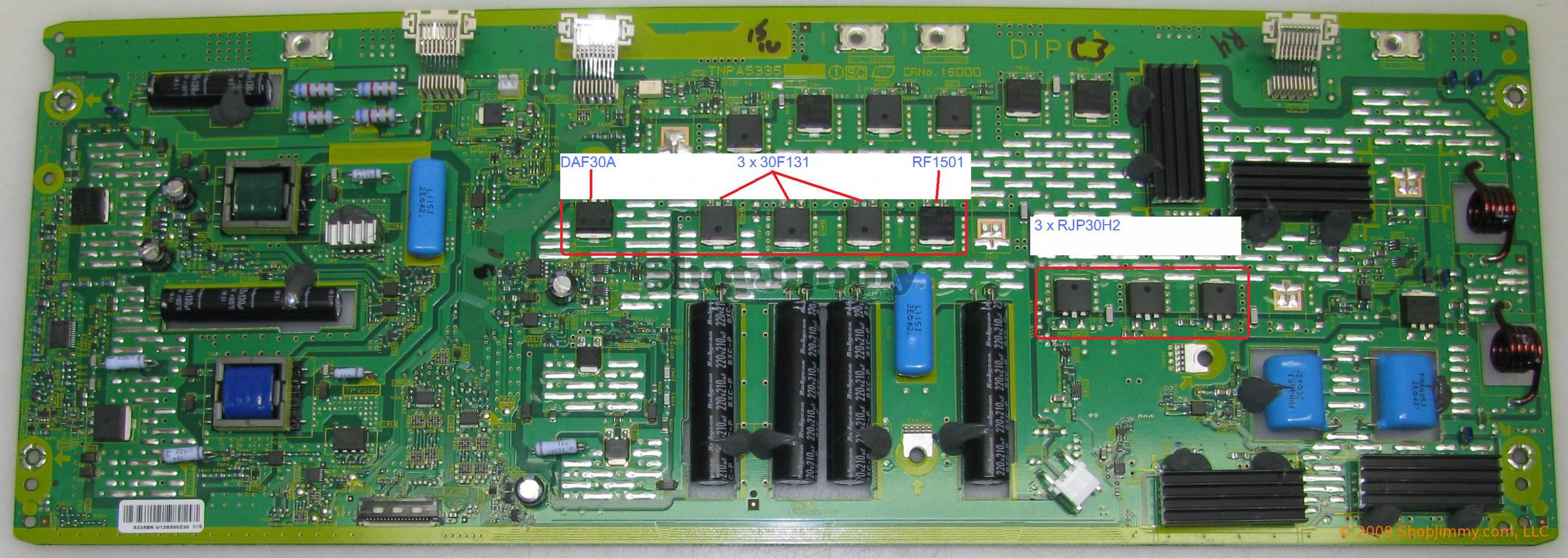

    No pics actual TV sorry. Photos for guide and our St30 appears to be more like GT30 for boards in the US
    7 Blinks, Shorted SC2, SU/SD boards ok(thank god)
    Had the usual loose screws and arc marks on both Sc & SS. replaced thoses and re tightened all others
    On SC board, in cct , 3 x RJP30H2, 3 x 30F131, RF1501, DAF30A all shorted
    After isolating each, 3 x RJP30H2, 1 x 30F131.
    Replaced both banks of 3 (6 in total) with FGDP4536 which are working well in the 50U30A.
    Powered it up, 8 blinks. pretty confident SC was good. Did a quick check of the SMD transistors and diodes, found RCJ330N25 FET short. had nothing exact or SMD so had a STK1820 which is under rated in comparison and TO220, no heatsink.
    powered up and now working, that FET does not even get warm.
    The TV had over 10 000 hrs up.

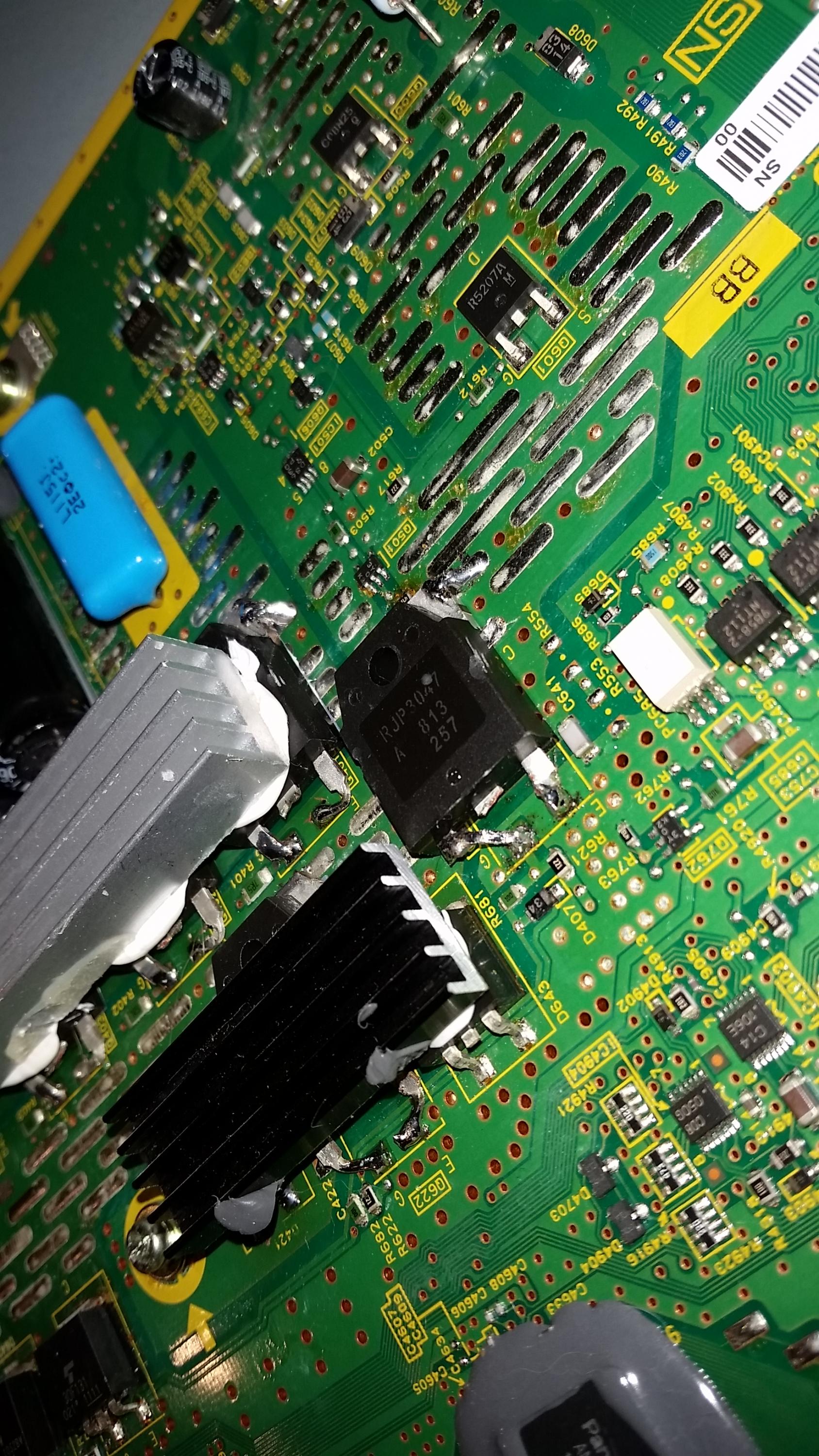

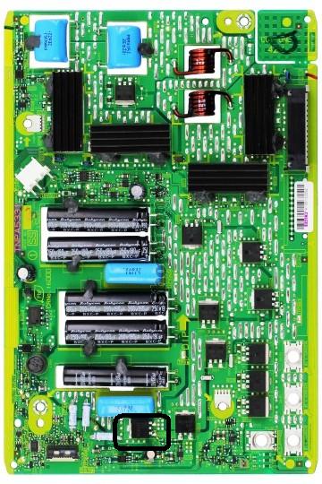

                                        The first picture shows the job I did on a SN board by transplanting an RJP3047 from a spare LG Y-sus (forgot which model number).
                                        Second picture shows the goodies you will find on a spare SS board that may be useful on a SC or SN board.
