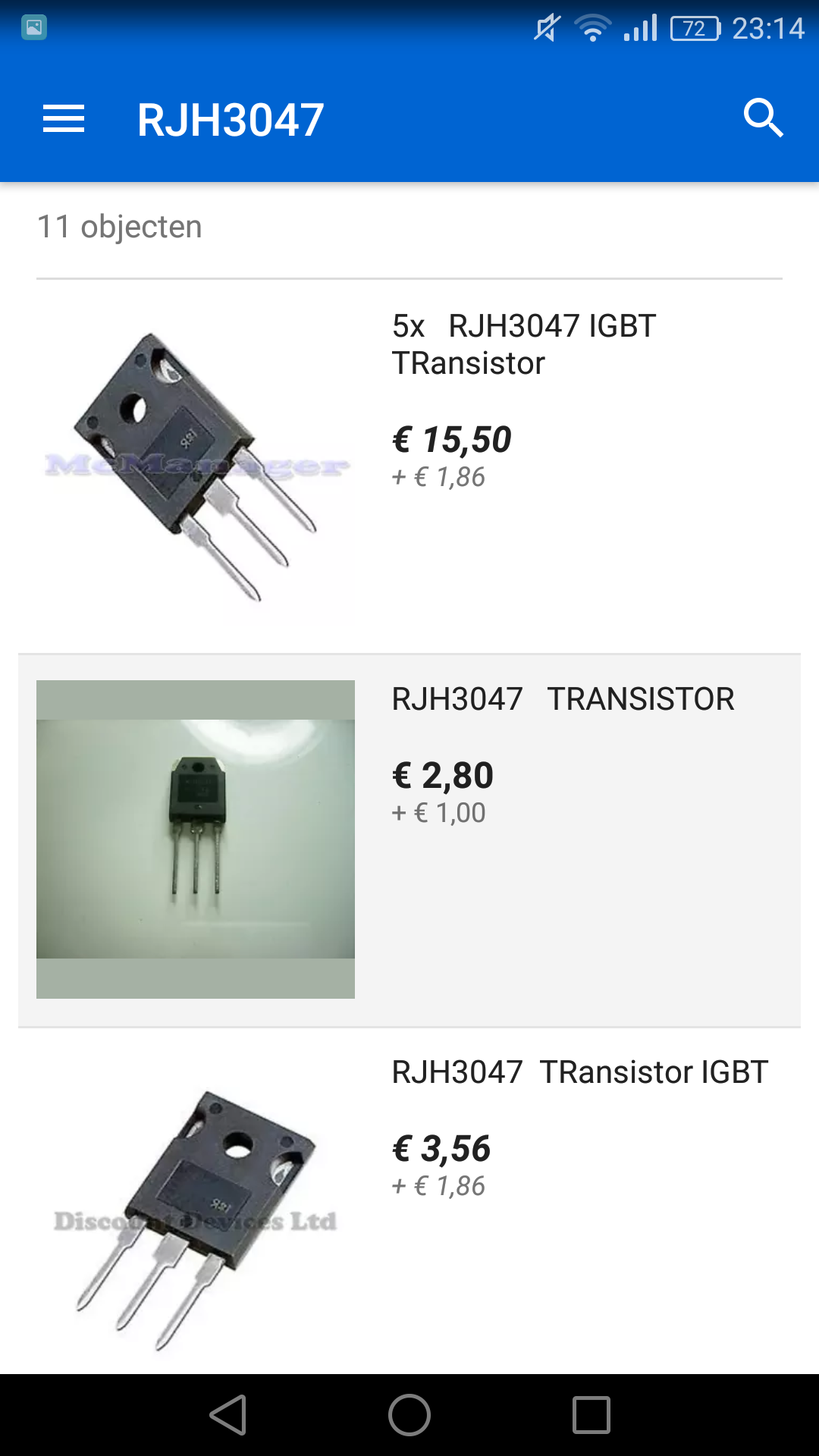

    Thanks for the info!
    I found this on ebay. Are these the same?
    I also ordered the IGBTs that TW2005 used in his ysus repairs ( FGD4536 ) and see how they work on my sc boards.

        I dont recommend ordering them because they are a discontinued product and alot of them that are for sale these days are fake.
        I took originals from old boards. They are like a gold mine!

            I already ordered the parts that TW2005 used , cant go back now haha. Worst thing that can happen is that the board says bang again.
