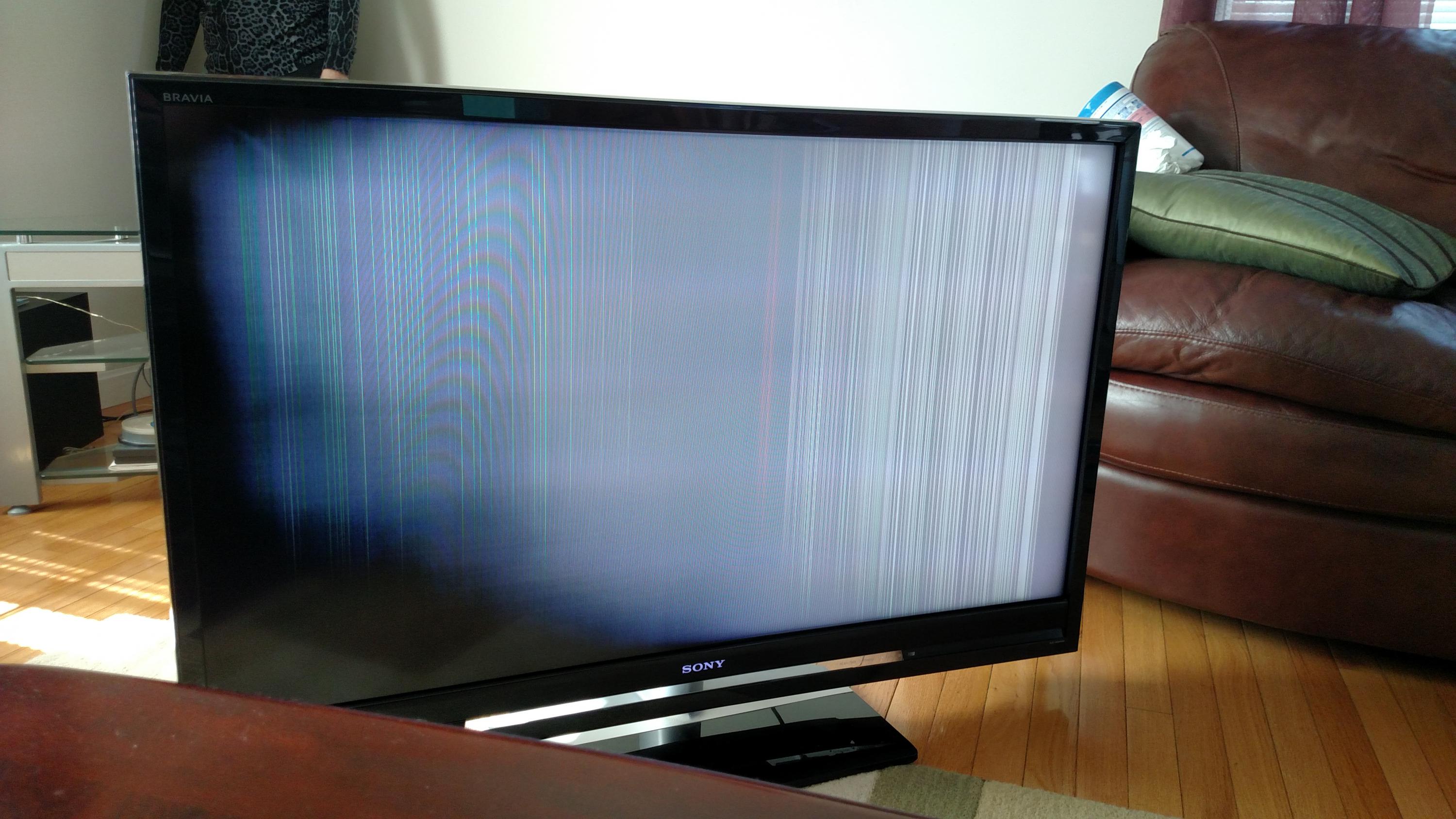

Hello everyone, a week ago we were watching some tv and all of a sudden the screen turned into vertical colored lines. Tried to reset the TV and that did not help at all. When you power on the TV the vertical white lines start on the right side and moves over with colored lines. Not sure if I should be ordering a new T-con or if it may be anything else. Thank you
Sony KDL-46z4100

Can we see the screen shot?Never stop learning

Try having one ribbon between the LCD panel and the T-CON board connected one at a time to see what you get. Looks like bad panel.Never stop learning
