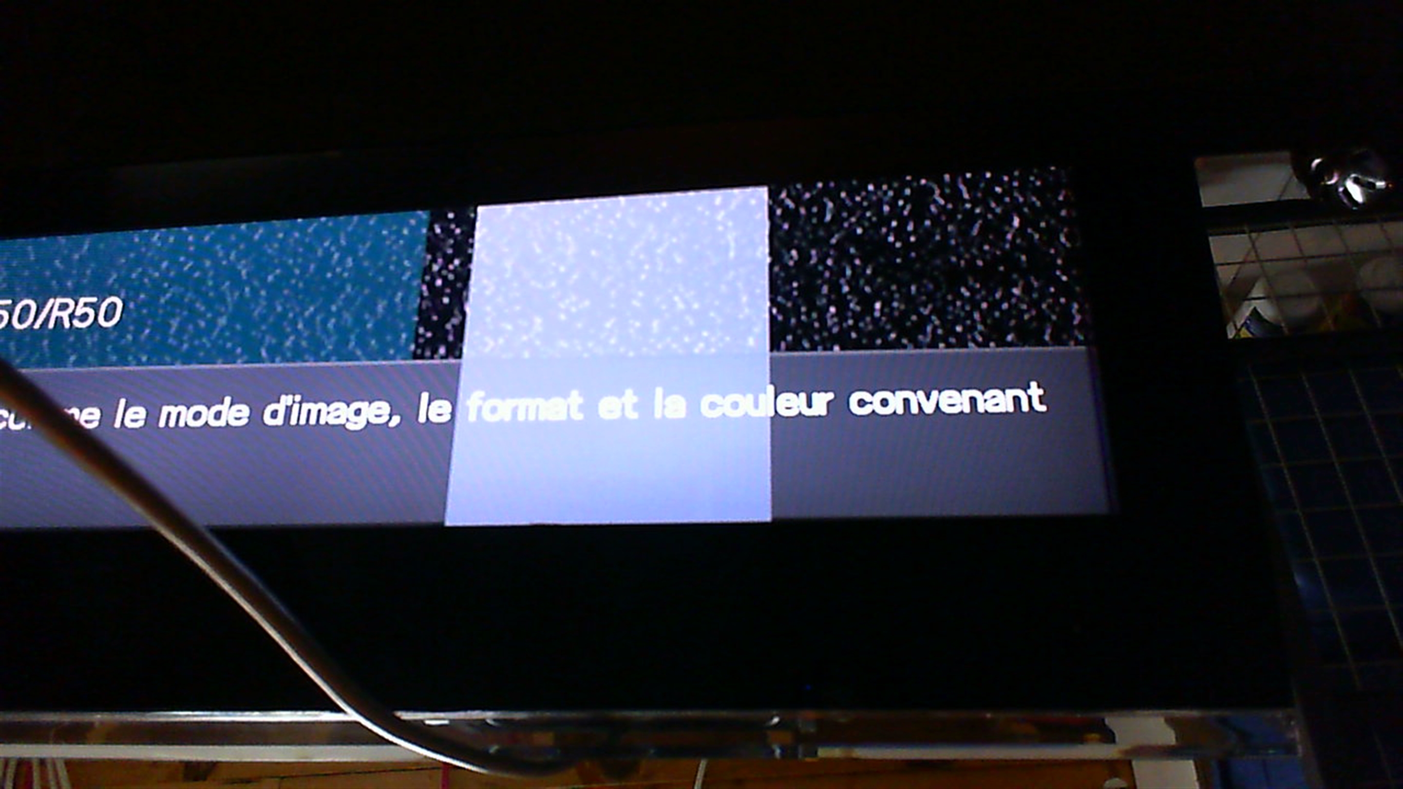

    T-Con or Panel fault? Samsung LN46B530
    Panel sticker says LTF460HA06.
    There is a vertical about 2" wide white band on top of everything (menu and picture) but I can see through it. There is also 1 green vertical line in the middle of the screen. AND there are black horizontal lines appearing in a random fashion, appararently only after the set heats up a bit.
    Neither T-Con nor panel is not sensitive to bending heat or cold. VGMA voltages on t-con are increasing.
    Any suggestions? How can I be sure if it s a panel or t-con fault without buying a new t-con or opening the panel?

    Definitely panel IMHO. The panel is the only part that discriminates between parts of the picture like that -- the t-con processes the image as a whole.

      Re: T-Con or Panel fault? Samsung LN46B530
      Thanks Tom, I was afraid of someone saying that. :-)
