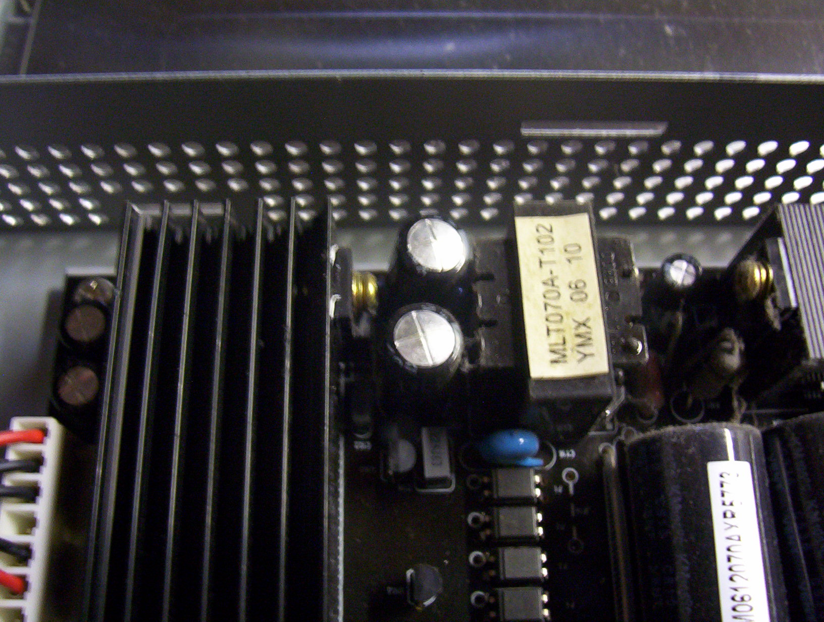

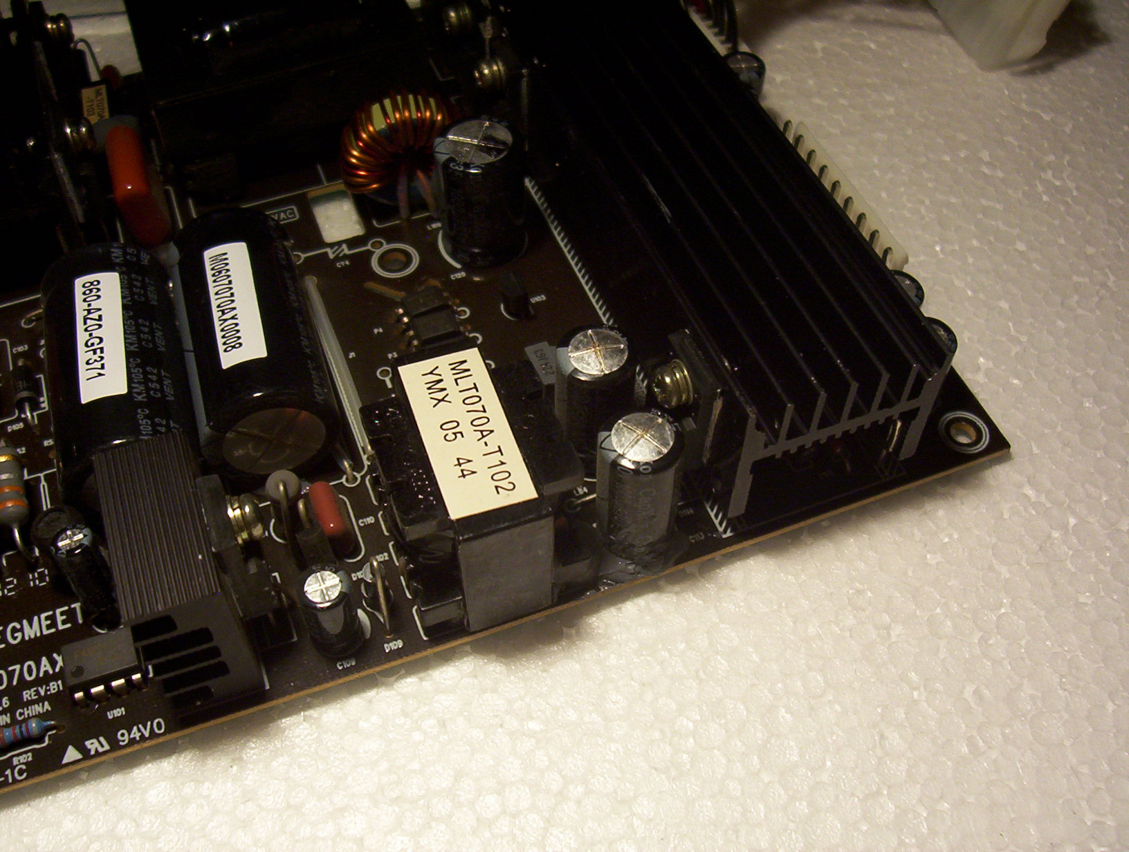

    Hello every one I'm new to this forum and I was hoping that you guys would look at these pics and tell me these cap are indeed bad. (fingers crossed) they are doamed out a bit. I traced the wires from the power plug to this board I am sure its the power supply/amp. The suspected caps read CapXon 1000uf/10v/kf105c. If these caps are bad what would be the best brand to replace them with?
    Thanx for any help

    those are bad.
    i have been using panasonic fc.
    all the other crapxon on the psu output should be replaced too.
    those sets run very hot!
      Re: polaroid lcd tv trouble
      I would recommend Panasonic FC series too. You can get them from Digikey.
      Those caps are so close to that heat sink I'm sure that attributes to their failure as well.
      For future reference whenever caps are bulging even a little bit they are bad and should be replaced. The bulging means that hydrogen gas has been building up inside the sealed can and it will eventally either leak out of the top vent causing a brown crusty solid to form on the vent or it could even explode.

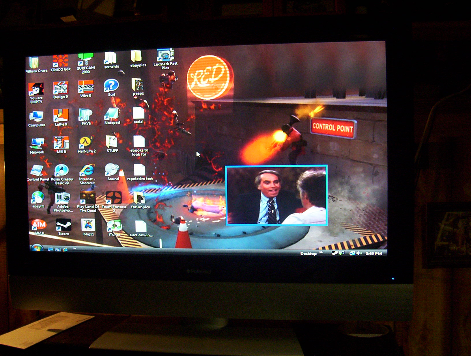

              Hooray!!!! It works I took a chance cause I wasn't sure with the fl series they seem to be working fine pip works just like it did when it was new the whynning and wirzring sounds are gone and my channels change again Now on to the mobo threads.
              thanx guys

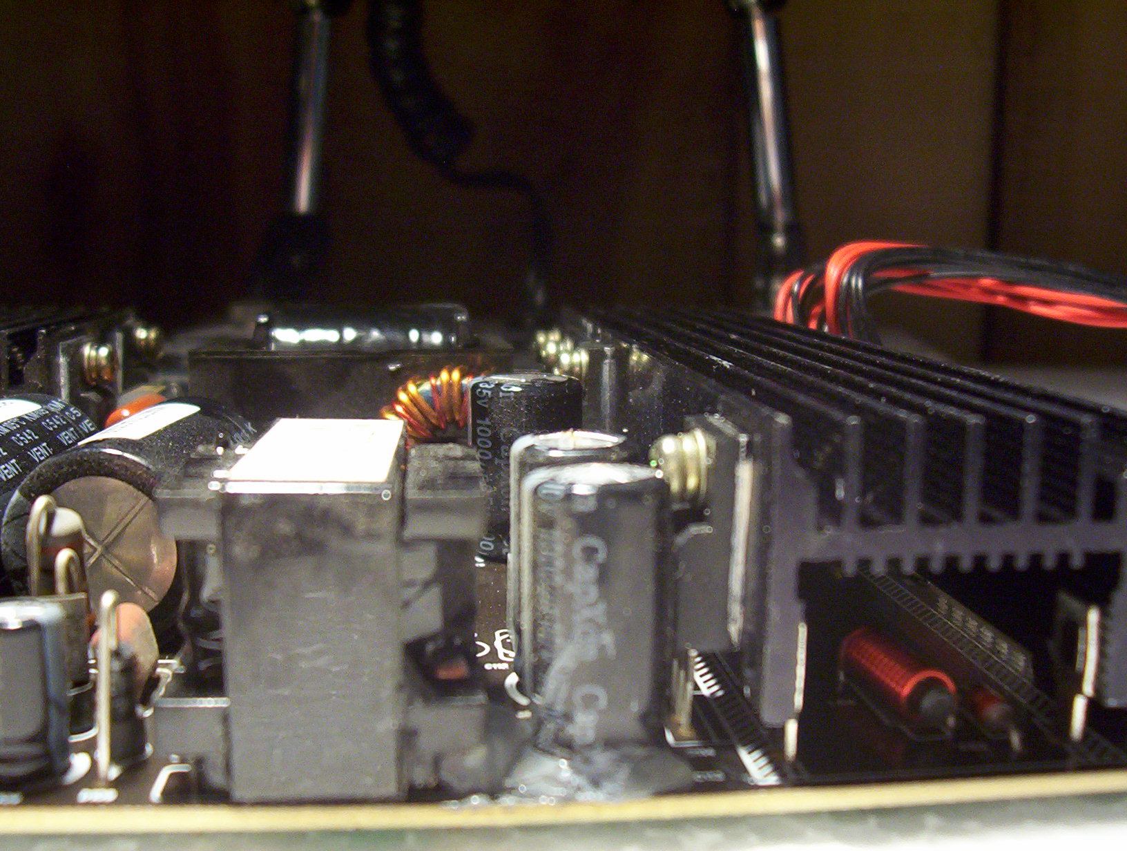

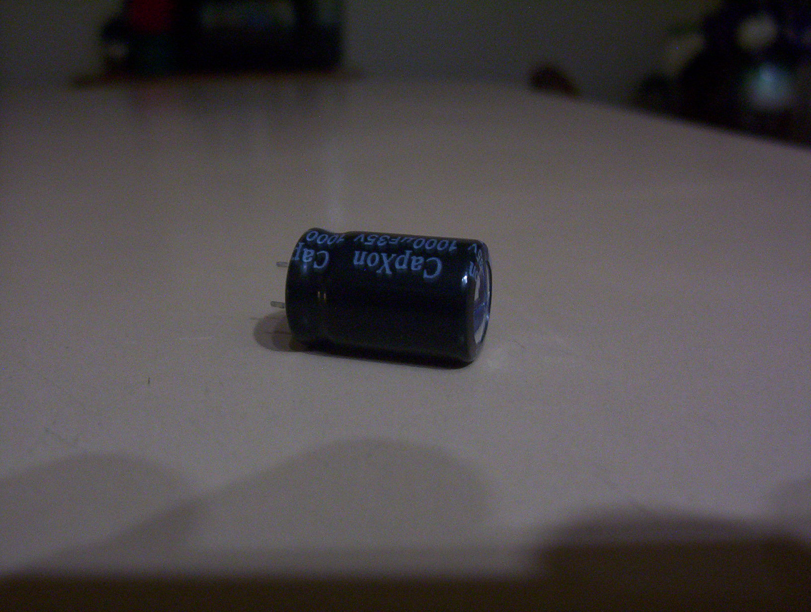

                      So I went to see my daughter today and turns out her Grampa Mike bought her a polaroid from a pawn shop a few months ago just like mine and my brothers. Since then it has stopped working. I brought it home and took it apart guessing it would be the same and sure enough those 2 same caps were bulged out plus 1 more. Blast not as easy as the other 2 sets to fix but mine is a spare set I use for lan parties now. I swapped sets with her and will order a bag of 20 caps from ebay. Its a good thing I saved the box for easy transport.
                      Here are a few pics.
                      crapxon kf 105c 1000uf 35v
