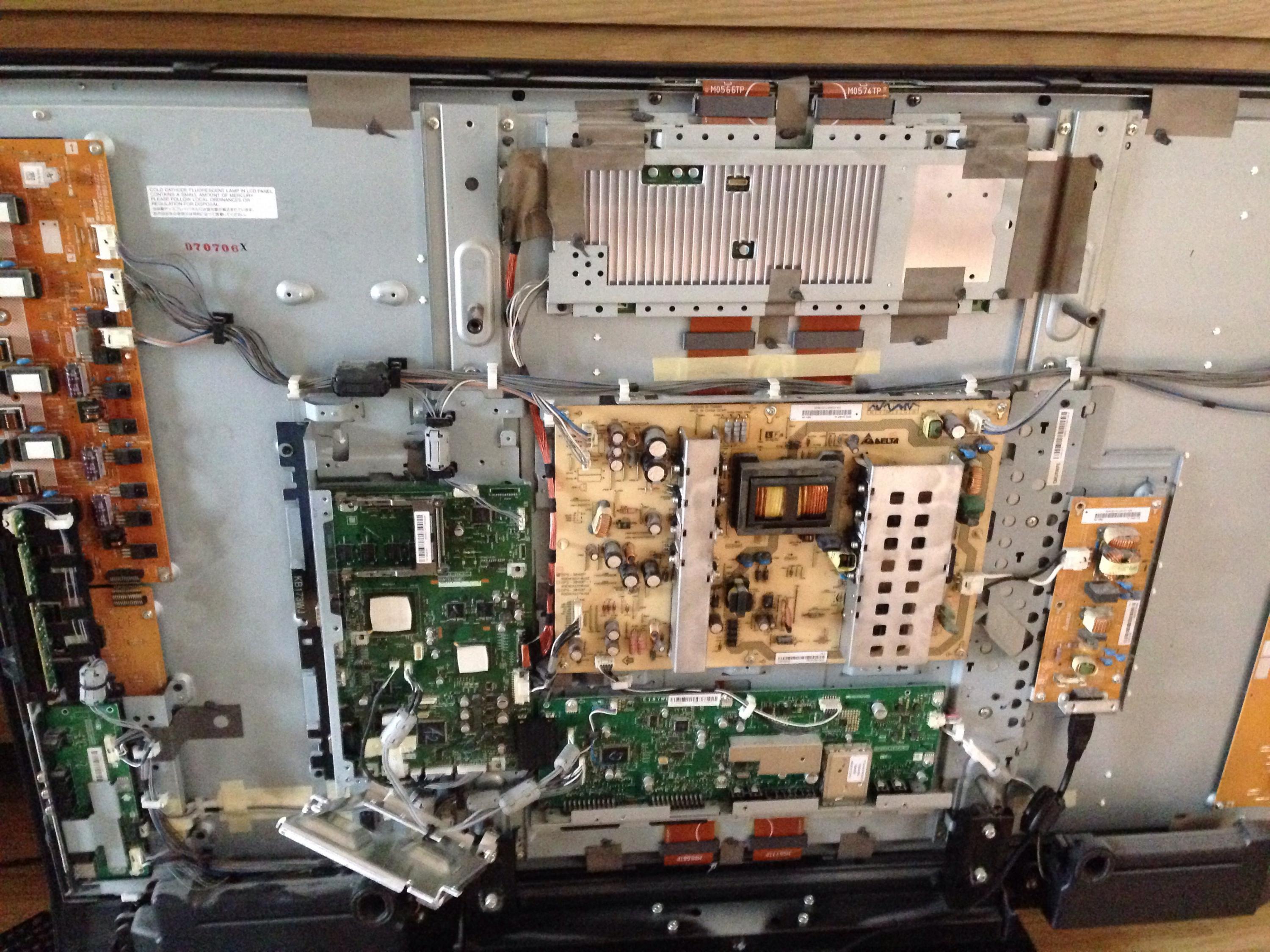

    Anyone know the above fault code?
    2 red blinks and 3 opc green.

    Re: Sharp Aquos LC46XL2E LCD (2 flashing lights red 3opc)
    I've found on here that this is something to do with det_5v failure. I assume this is produced on main board.
    My question is which main board. This Tv has 2. It has one with scarts and tuner and one with hdmi's.
      Chancing it on a main board.
        Tv fixed was backlight inverters.
