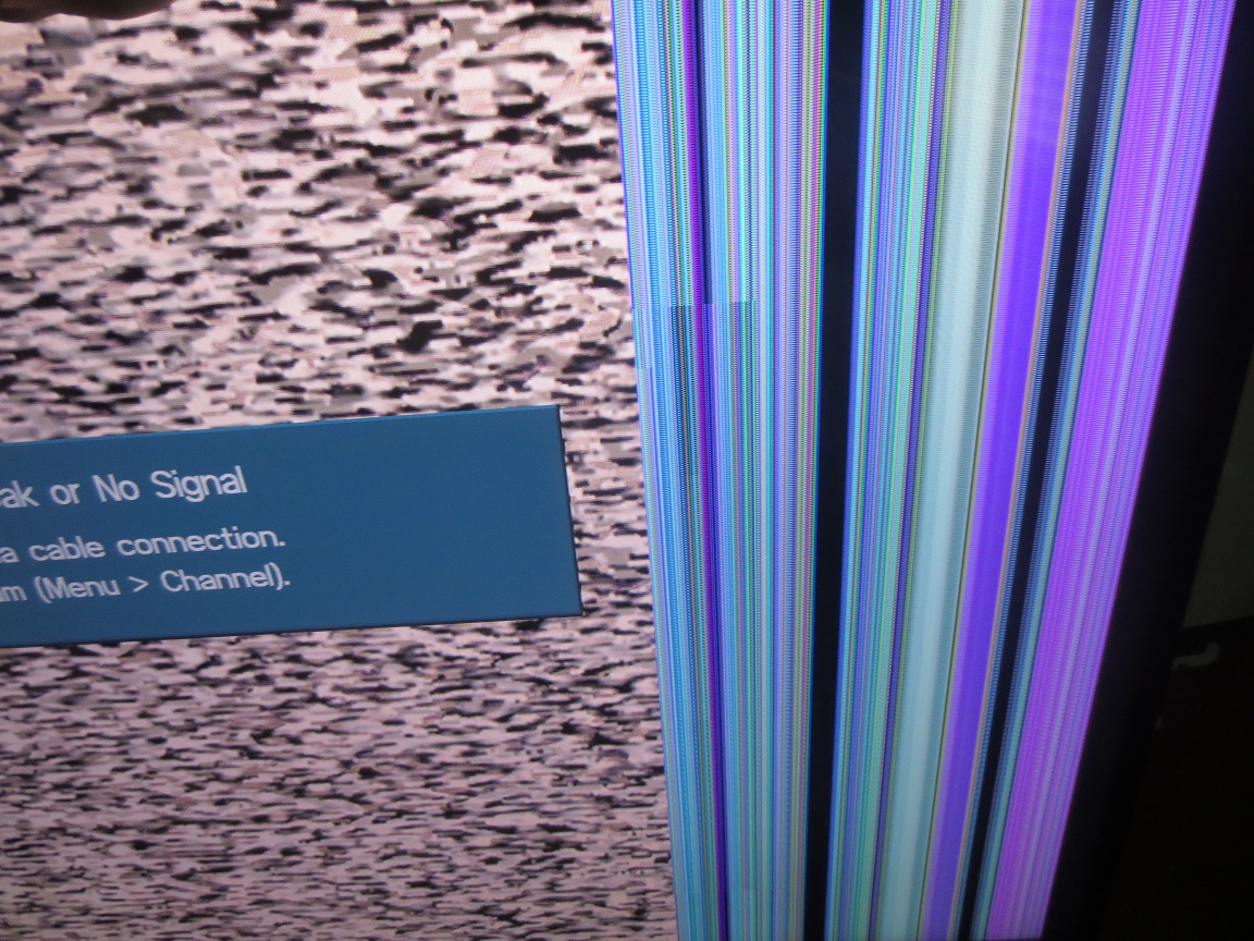

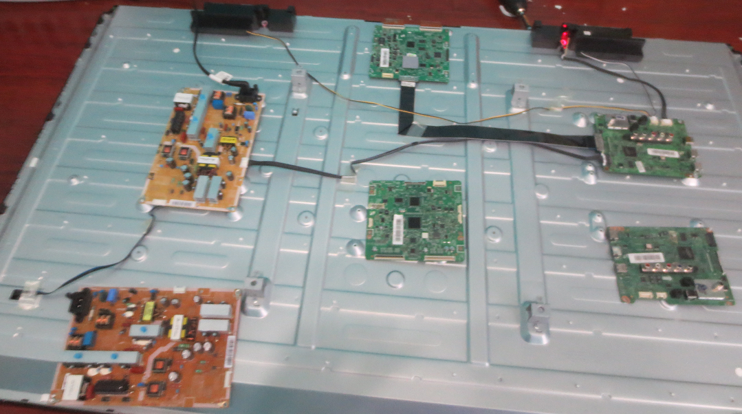

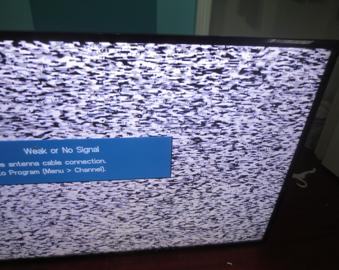

    I had warranty on this tv and a tech came out to take a look at this tv originally with no video, no sound. Screen lit up but it was black. Tech said it was most likely the T-CON board. The T-CON didn't fix the issue. The tech said it was a bad panel and it isn't worth fixing. So the insurance will buy it out and asked me to junk it. I opened up the TV to take a look and I found a small burnt area under a capacitor on the power board. I replaced the power board, still no video, no sound, blackscreen but it was lit. I then replaced the main video board, then I had video and sound but now I have vertical lines on the right side of the screen. I am thinking since the Tech tried a T-CON with a bad powerboard and bad video board, it wasn't going to fix it anyway. any idea if it is a bad panel?

    Re: Samsung UN60EH6000 Vertical Lines bad panel?
    Bad panel I'm afraid.
    Bad tab bondings. You could wedge the connection back again using various methods but not always 100% successful

            the tech took the good T-CON and left all the bad parts. He replaced nothing. He filed with insurance that TV needed to be replaced. They paid me for the TV and told me to throw it away. so I replaced power board, i still had no video , no audio. I then changed video board, i have video and audio, but i ahve the vertical lines. what is left now is to change to T-CON. I think i had a power surge and it fried the power board, video board, and possibly T-CON.

                the distortion is in the same area, but sometimes the colors of the vertical lines change as i flick through the different patterns. I also noticed another test: T-CON download Failure.

                          i definitely did that, I also swapped the two ribbon cables to verify and the issue remains the same. I think since I had a surge, and the surge fried the power board, and video board, most likely the T-CON went bad as well. I ordered it and hopefully that fixes it. if it doesn't work then I will try the LVDS last and that will be end of the line.

                            If all test patterns are showing fault, then it cannot be LVDS. (As some test pattern modes generate image on T-con side, ignoring LVDS.)

                                1) 1st issue was lit background and nothing else, auto turn on, no video no sound (bad power board and video board)
                                2) 2nd issue were the vertical lines caused by the T-CON and not the panel
                                the issue was caused due to a surge which i could see a small burnt area by one of the capacitor legs. looks like the surge completely damaged the video board as well and partial damage on the T-CON
                                Thankfully the Insurance Tech got it completely wrong, thought it was the panel while it was the three boards. So i get the full price of tv and the cost of this repair , 75$ in total for all three boards from ebay.
                                I got the power board for 20$, video board for 15$ and T-CON for 40$ all used , compatible parts , not original to the model.

                                  thanks for your help. TV fixed

                                    thanks for your help and the documents. TV is fixed.
                                      I'm glad you fixed the set, you got pretty lucky tbh because that fault is rarely a T-con problem. Not too bad for a 60" set then.
