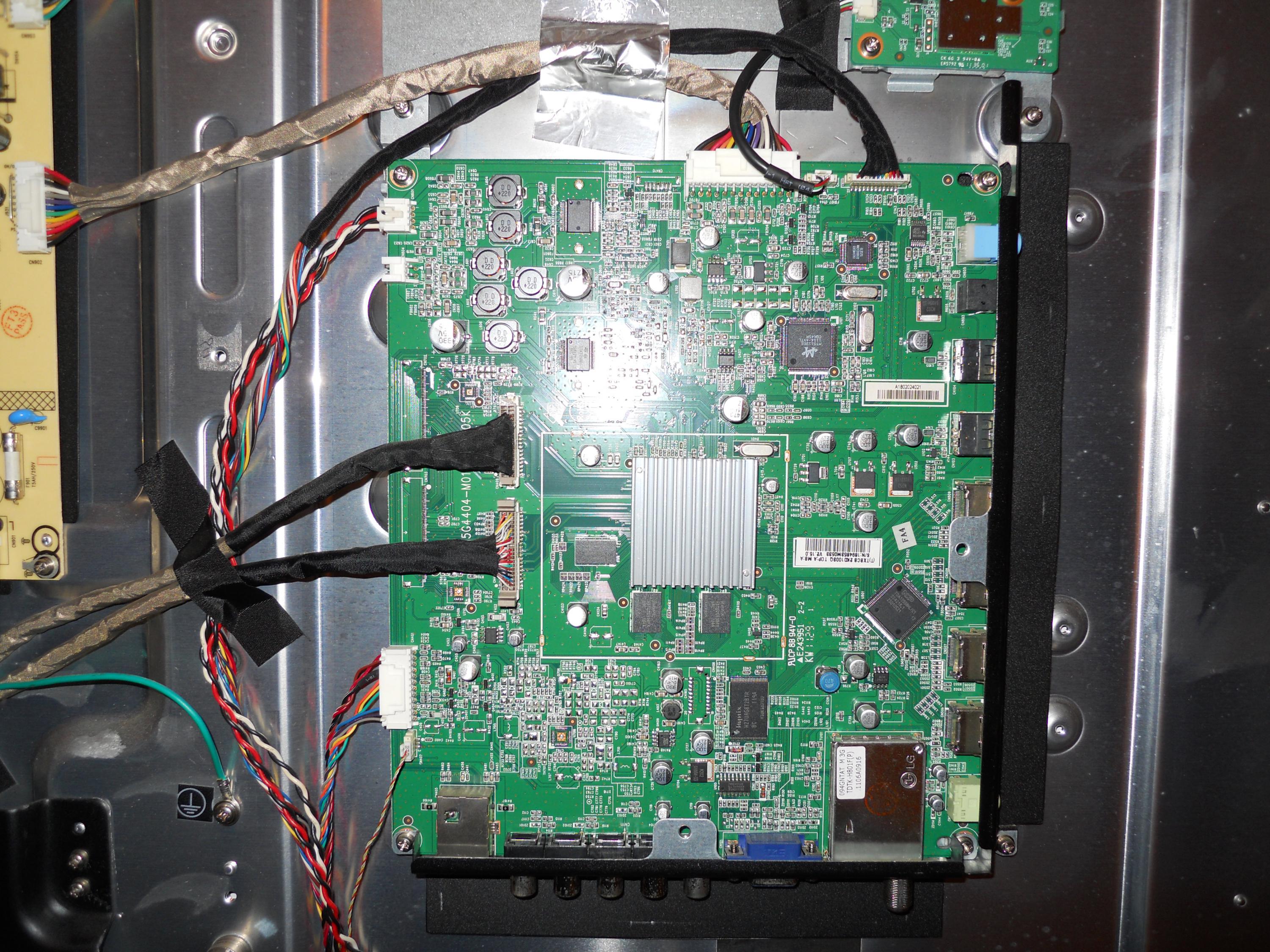

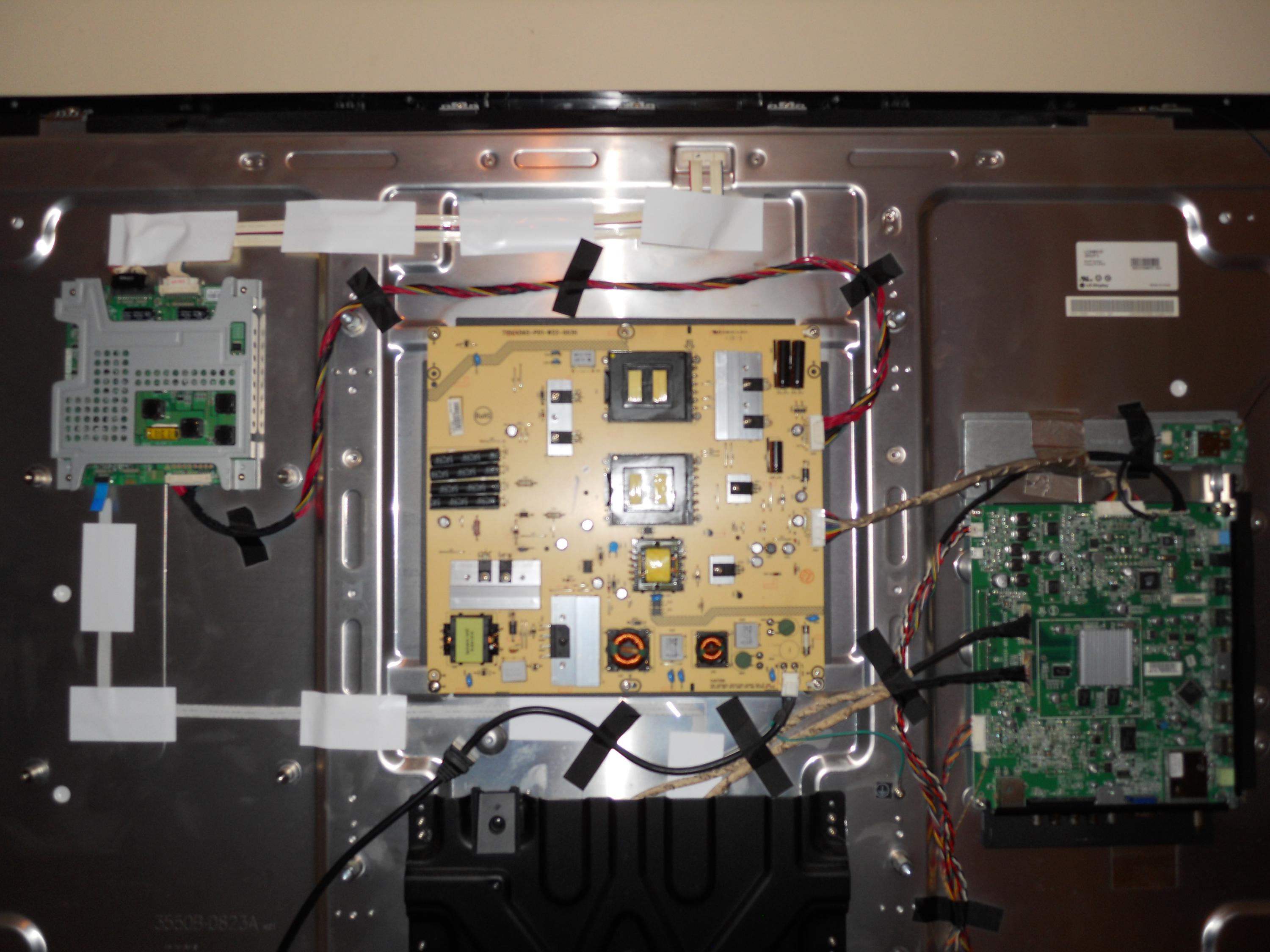

    Recently picked up this Vizio M3D550SR for free and figured I'd have a go at trying to get it working. The problem is, this TV has me a little confused. The Vizio light on the front is on, the TV output's sound and when a flashlight is held to the screen, you can see that the lcd is working, but for some reason the LED's aren't turning on.

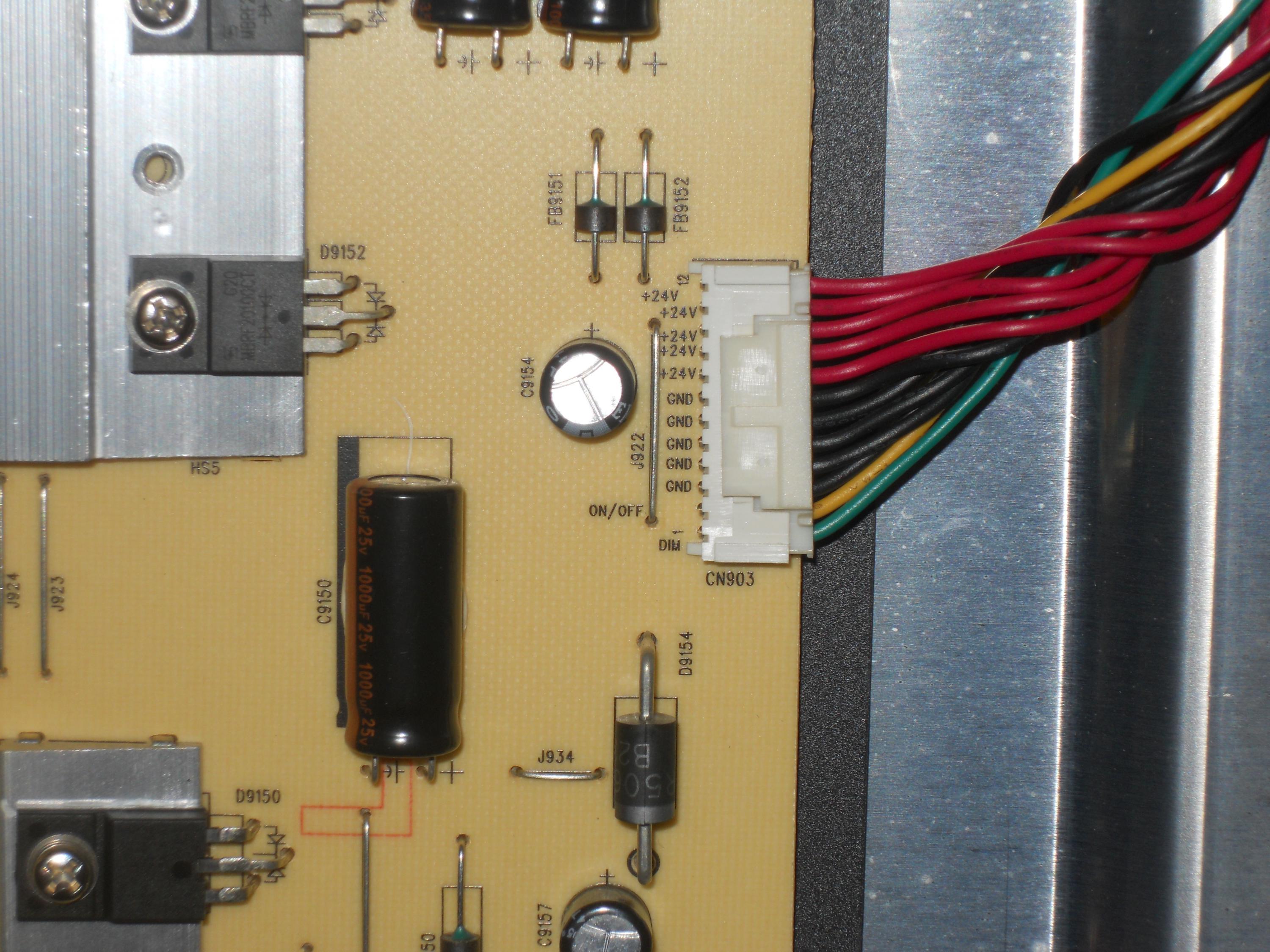

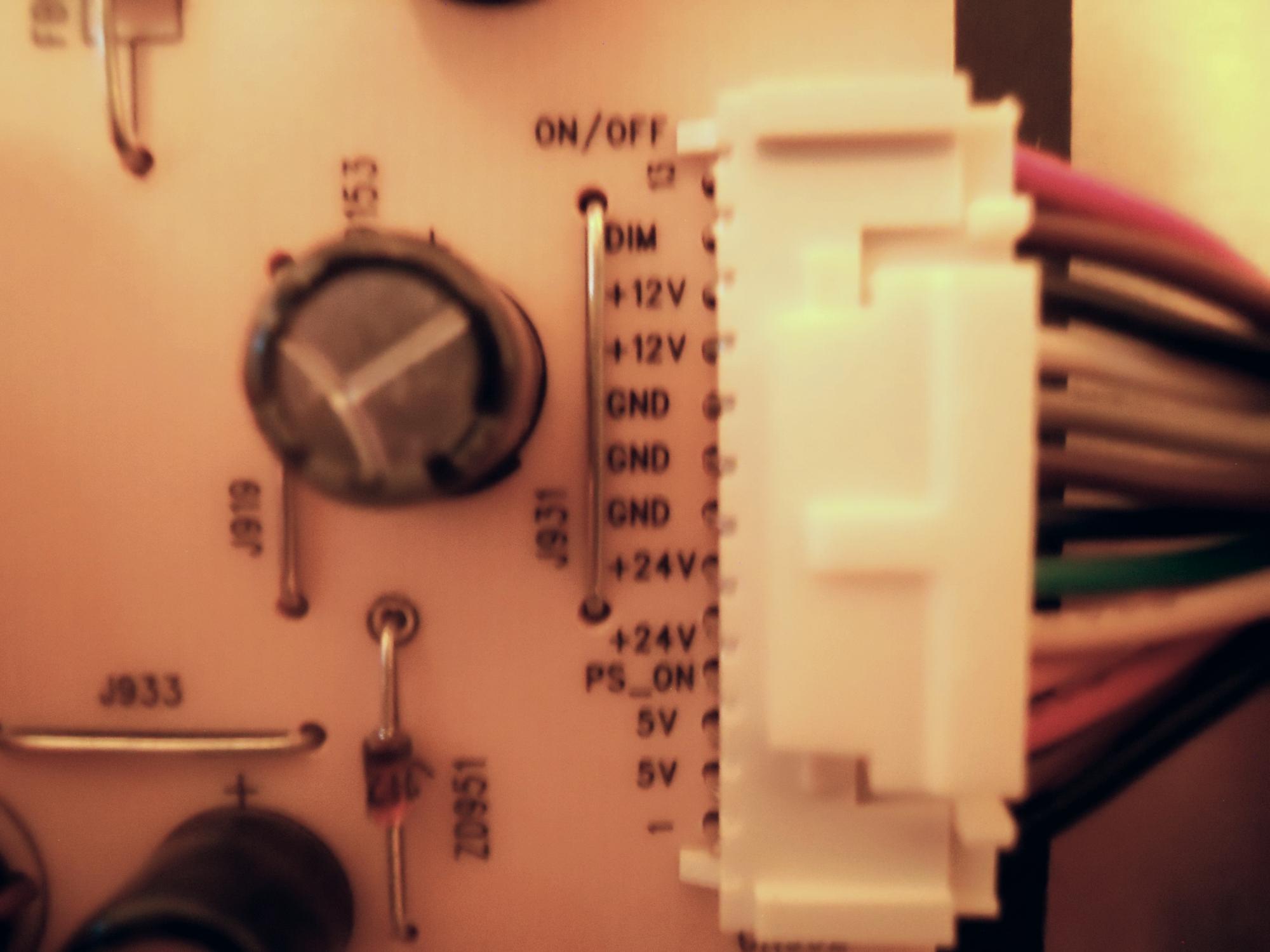

    So I starting checking voltage's going from the power supply to the LED driver board, these are the voltages I got:
    24v-23.6v
    24v-23.6v
    24v-23.6v
    24v-23.6v
    24v-23.6v
    GND
    GND
    GND
    GND
    GND
    on/off-3.2v
    DIM-no voltage

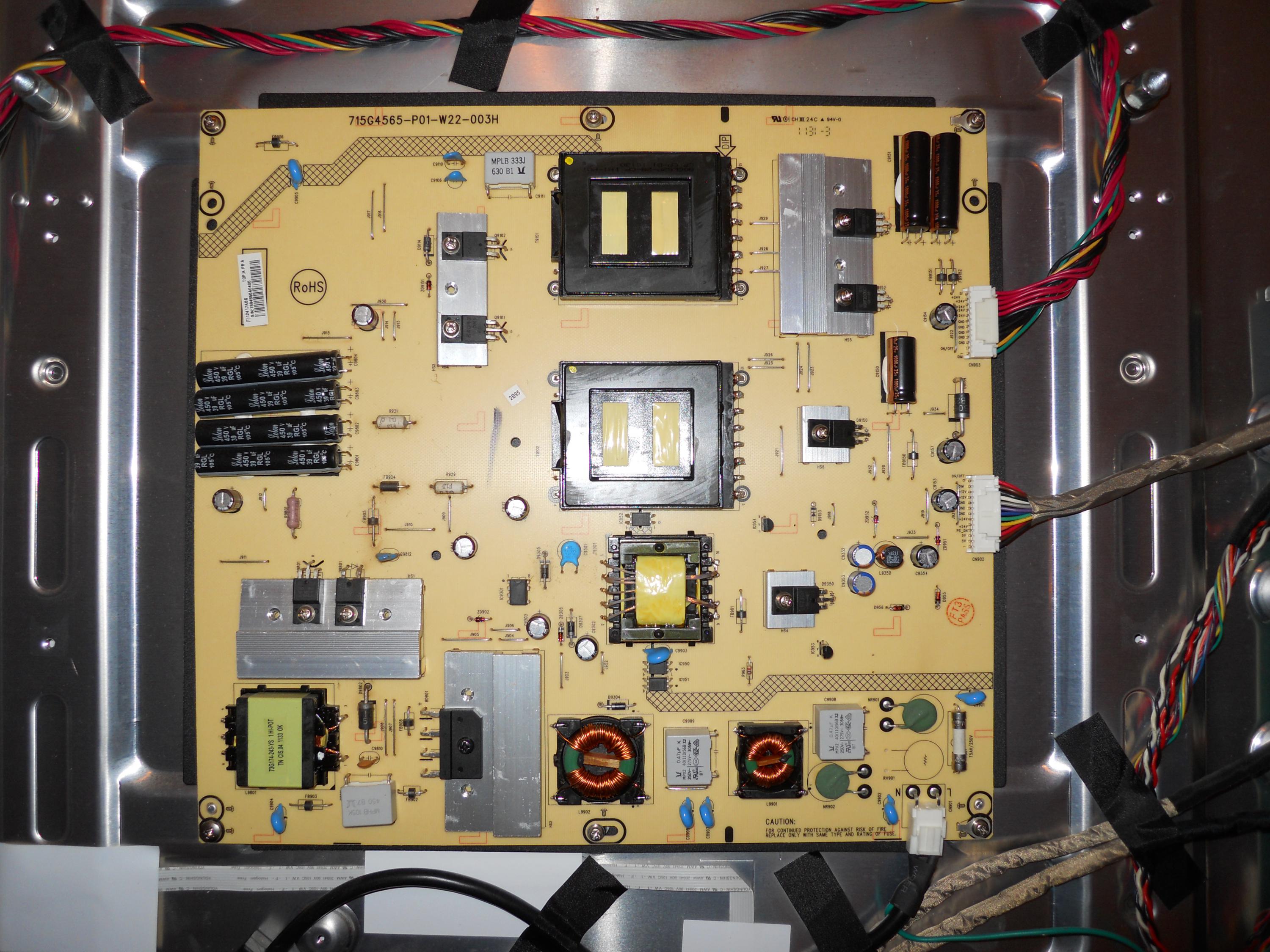

    All of those readings seem to be within the range shown on the power supply. So I checked the voltage going from the power supply to the mainboard, this is what I got:
    on/off-3.2v
    DIM-no voltage
    12v-11.7v
    12v-11.7v
    GND
    GND
    GND
    24v-23.3v
    24v-23.3v
    PS-ON-1.7v
    5v-5v
    5v-5v
    GND
    Again all those seem to be near the range shown on the power supply. Since the power supply is putting out the correct voltage for both the LED driver and the mainboard, I'm guessing I can rule that out? And since the mainboard is putting out sound and a faint picture, is it possible I can rule that out as well?
    Another set of voltages I tested were those coming out of the LED driver. The LED driver was showing voltage going out, but since there is nothing printed on the board, I don't have a reference for what these voltages should be. I can post the voltages I got out of it if someone here knows what the voltage coming out of the LED driver is suppose to be.
    Sorry about the long post, just wanted to be thorough. Any help on this would be appreciated.

    Start with this:
    https://www.badcaps.net/forum/showthread.php?t=39740
    It looks like all the Voltages and signals are there with an exception of the Dimm control line.

      Couldn't find the edit button in my original post to post these. Battery died on my camera, so I wasn't able to get a picture of the LED driver board and the T-CON board, I'll post those when the camera charges. Sorry if the quality isn't great, not the best with camera's. If better pictures or something specific is needed, I'll try to get it.
      Also want to correct a mistake on my original post. The DIM going to the mainboard is reading 5.1v. I get no voltage on the DIM going from the power supply to the led driver.

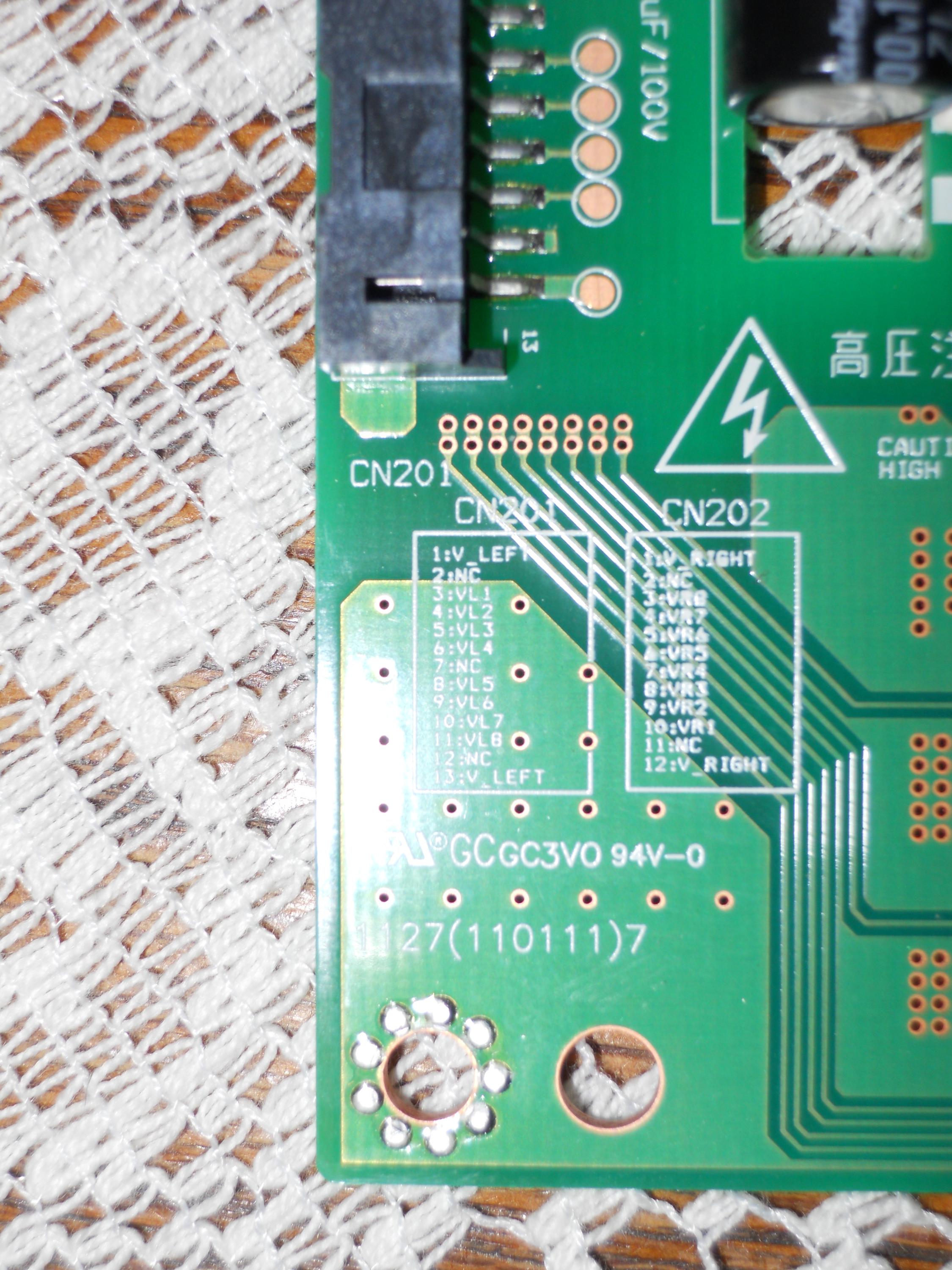

          I want to say the LED driver board is the problem, but testing the connector's at the top of the LED board, it is showing voltage going out to the LED.'s Though I'm unsure of what the correct voltage for those connectors is suppose to be. Here is the voltage readings I got out of the led board top connectors:
          Left connector
          pin1-50.2v
          pin2-11.3v
          pin3-8v
          pin4-9.1v
          pin5-8.1v
          pin6-8v
          pin7-8.1v
          pin8-9.3v
          pin9-8.4v
          pin10-50.2v
          Right connector
          pin1-50.1v
          pin2-8.7v
          pin3-8.1v
          pin4-8.4v
          pin5-8.6v
          pin6-7.8v
          pin7-8.3v
          pin8-7.8v
          pin9-9.2v
          pin10-50.1v
          No idea if any of those voltages are off or not. Hoping someone here can someone here can tell me if they see something off with those number's.

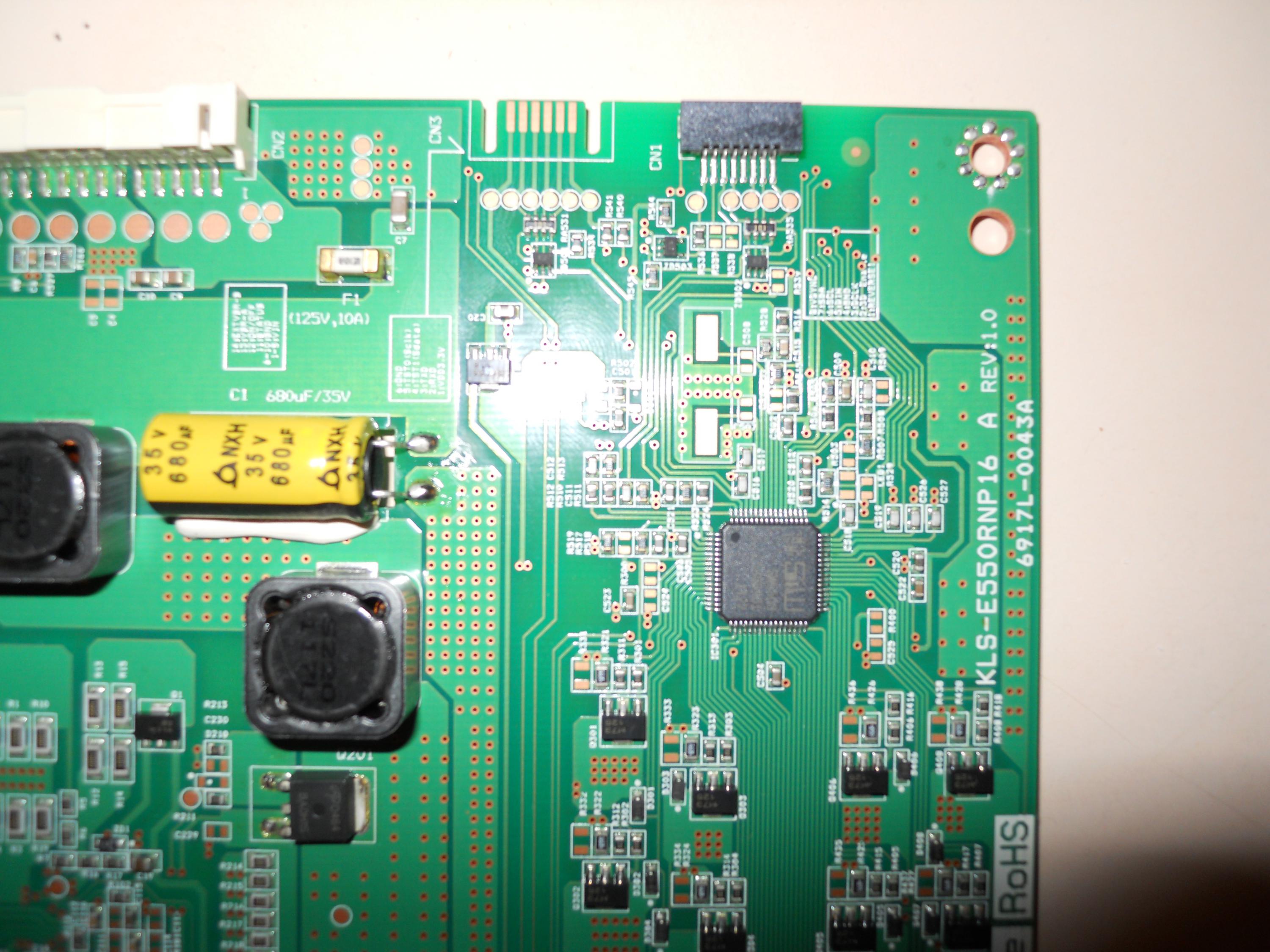

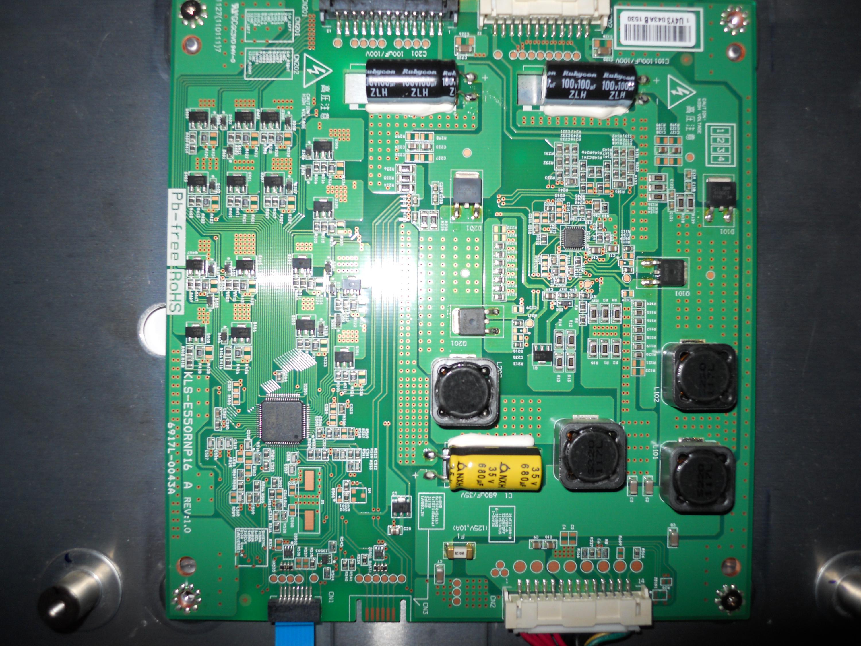

            Re: VIZIO M3D550SR sound and faint picture

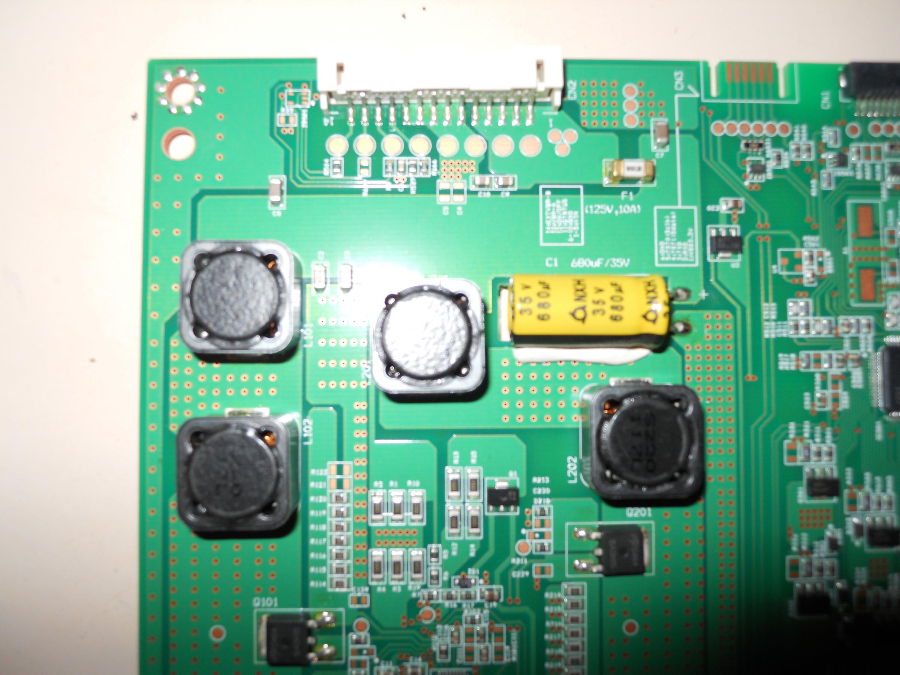

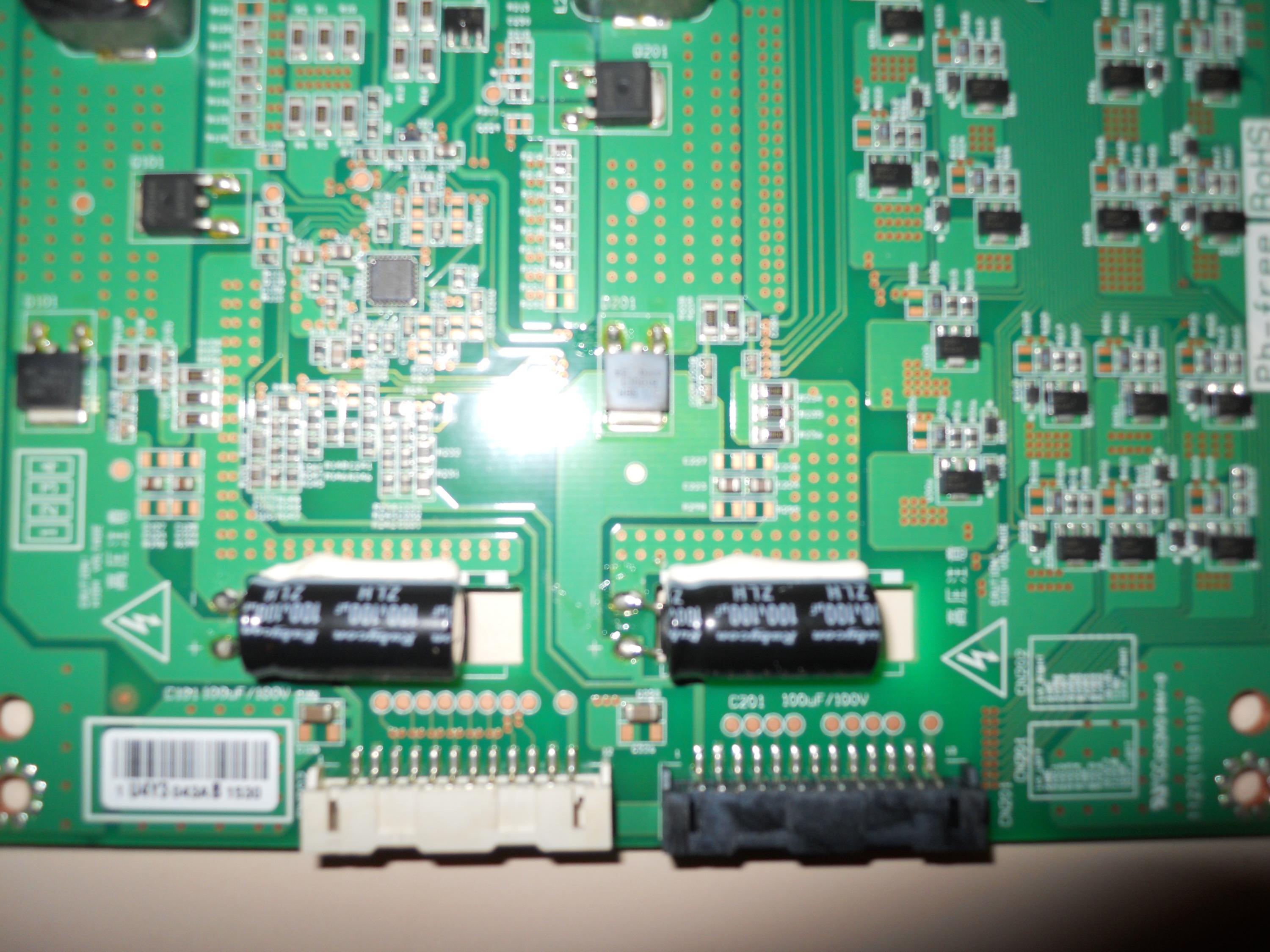

            Please upload good clear pictures of the LED driver top and bottom sides without the shield.
            I need you to check the DCV on the Voltage boost converter filter caps for the LED stings.
            Any labeling of the pins on those connectors to the LED strings?
            • hellride
              • Oct 2013
              • 13
              • united states
              After taking the shield off, I did find label's for the left and right connectors, which is shown in one picture. Left filter cap read 50.2v and the right read 50.1v.

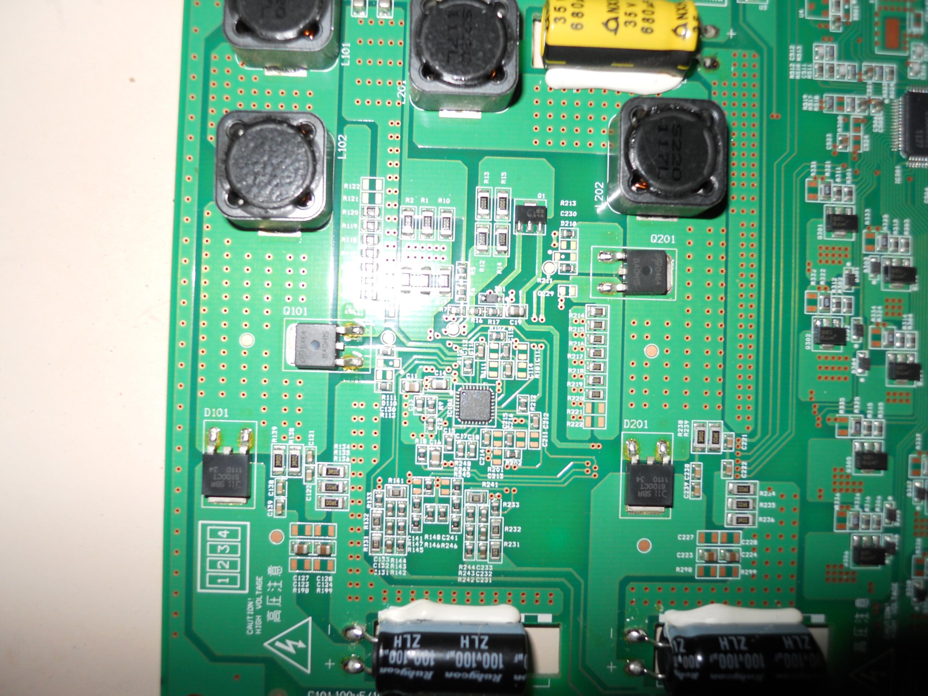

                It looks like it has two boost converter circuits, L102, Q101, D101 and L202, Q201, D201.
                Both are producing the same Voltages, you may have to measure each cap one at at time to see if it does jump up higher than 50V and then settle down to 50V or not.
                If the LED string has open LED, the output will jump up real high and then the protection circuit will kick in.
                Then also take the reading without the LEC connectors in place to see if the Voltage also jumps up and then settle down to 50V or not.
                  Tested both filter caps when turning the TV on. The left filter cap jumped up to 71.2v and slowly dropped down to 50.2v. The right cap jumped to 71.1v and slowly dropped down to 50.1v
                  Disconnected the connector's and tested again. Left cap jumped to 74.2v and slowly dropped to 50.2v. Right cap jumped to 74.1v and slowly dropped to 50.1v.
                    OK, that's sound like the LED has open connections or open circuits due to bad LED.

                              budm, thinking about what you said about the DIM voltage not being present, I tested it again using a lower setting on my DMM. It was showing voltage, only 0.19v though which still seemed way to low to me. So just for the sake of experimenting, I disconnected the DIM line going to the LED driver, plugged the TV in, pressed the power button, and it powered right up!!
                              Question is though, would this be a power supply or mainboard problem? And would it be safe to just run the TV with the DIM line disconnected?

                                If I remember, I did fix one of those by change ( LG 6917L-0043A (KLS-E550RNP16 A) LED Driver)board.
                                would u please test Q201 and Q101 see if shooted?

                                  Dim control line is just for adjusting how bright the LED backlights will be, I usually run my backights brightness at 80%.
                                  I do not know if your dim control line is PWM (10% pulse width = min brightness, 90% = Max) or analog 0~5V type.
                                  Dim disconnect will probably drive the LED at max brightness.
