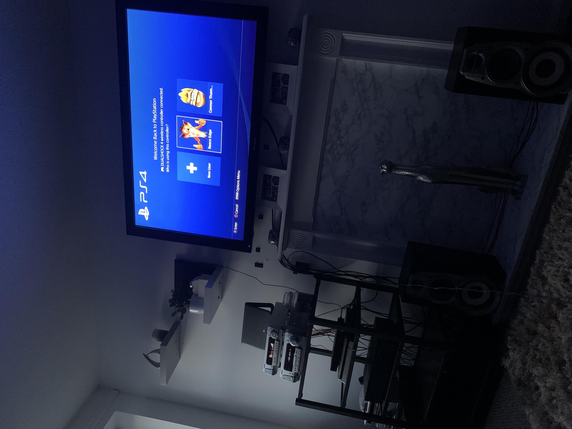

                                  Hey Tom thought I’d let you know, still have this Kuro up and running. It’s been used and abused daily for years, moved house 3 times and still looks good to the eye! It does need calibrating but I’ll seek help and learn it myself when it starts getting really worn out
