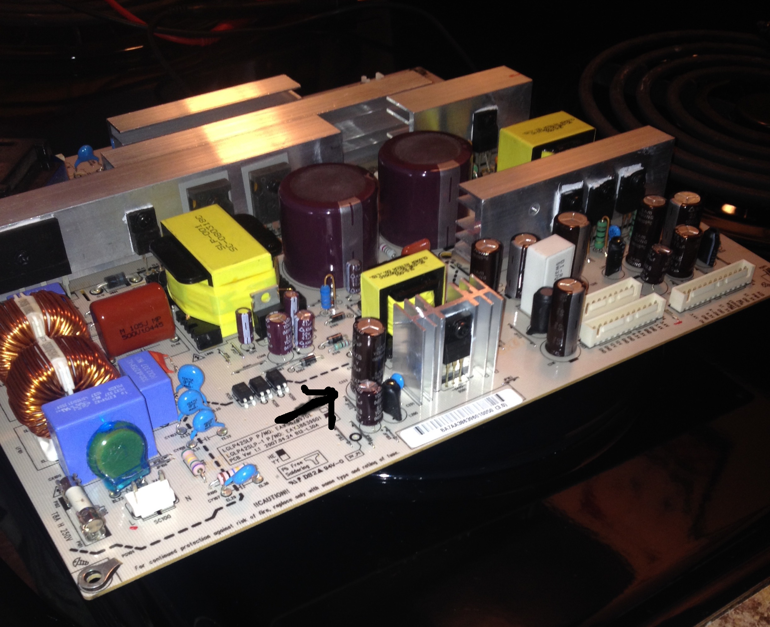

    Working on a lg 42lc7d will not power up, no backlights,main board shuts down after 5 seconds. All voltages are good on ps except for the 5v standby is only 3.2. I have checked all caps with esr meter and all are good except for two measure bad in circuit and fine out of circuit. My picture editor is not working right now, the 2 caps showing short are to left of lower heat sink in first picture towards the bottom edge. Im stumped on this one.

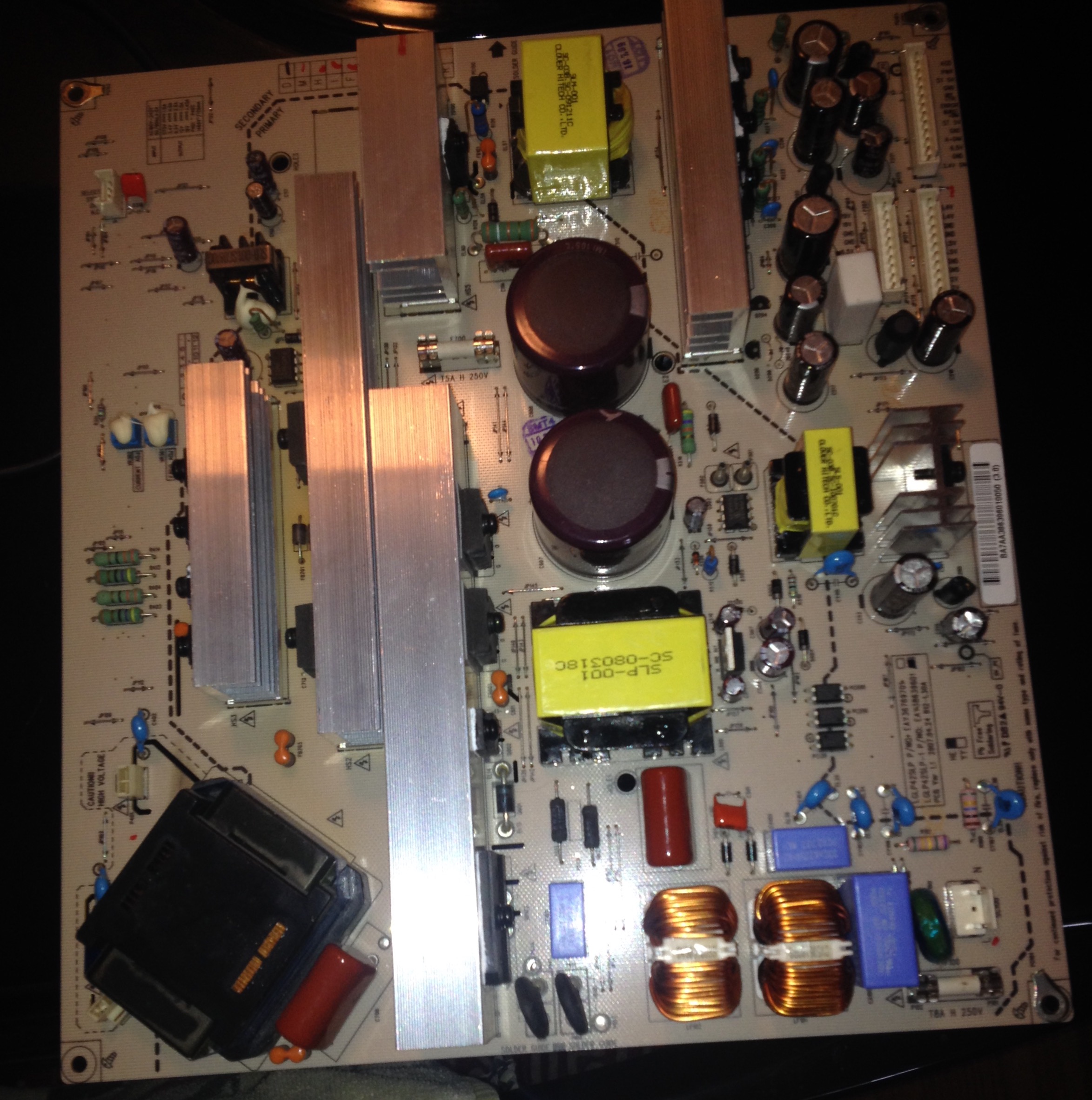

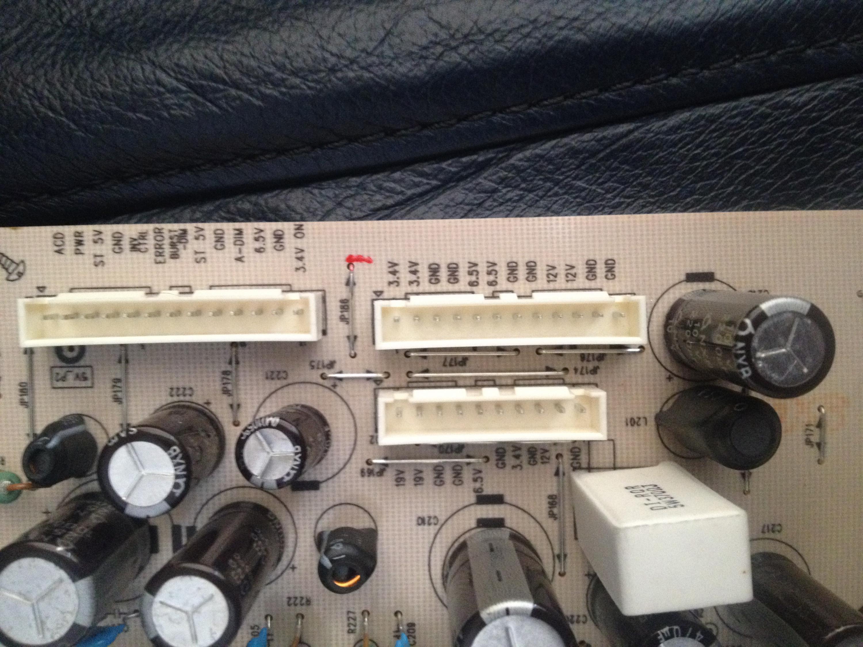

      "All voltages are good on ps except for the 5v standby is only 3.2." Are you saying that all the output voltages are the same as shown on the pin labels?
      Can you list the pin names of the connector, the pictures are not clear enough to see all the labels for the pins?

        I'm sorry I read wrong pin. Ps on is supposed to be 3.4 but only reading 2.4 on meter. Main board is confirmed good on another set. Standby voltage is good.

            Re: LG 42lc7d low standy voltage
            ACD 5v
            Pwr 1.9v
            standby 5.12v
            inv cont 3.3v
            error 12mv
            burst dim 50mv
            standby 5.12v
            a-dim 63mv
            3.4v on 2.4v
              I believe PWR is the PS-ON.
              Are you getting >360VDC on the two legs of the main filter caps? I f you do then PS-ON is OK.
              Burst dim and a-dim do not look right either.

                        arrow pointing to both caps on lower side of heat sink
                          Those two caps are the filter caps look to be for the 5V standby power supply, if they are shorted out you will not have STBY Voltage.
                          What kind of resistance, reading do you get measuring right at the two legs of the caps? <1 Ohms?

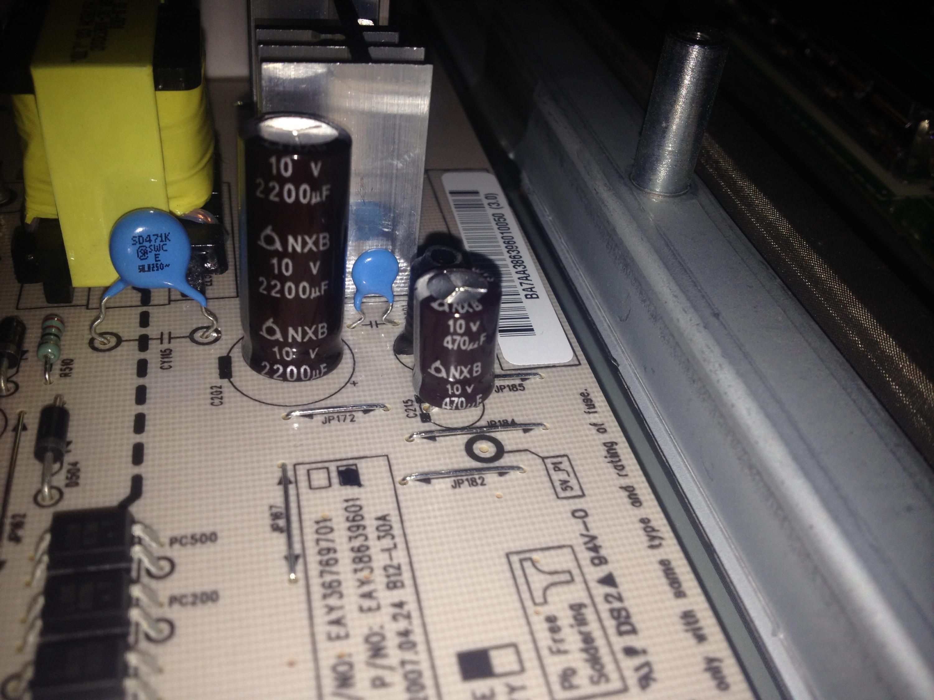

                            The bigger cap is all over the place up to 2k ohms, smaller one is at 5 ohm.

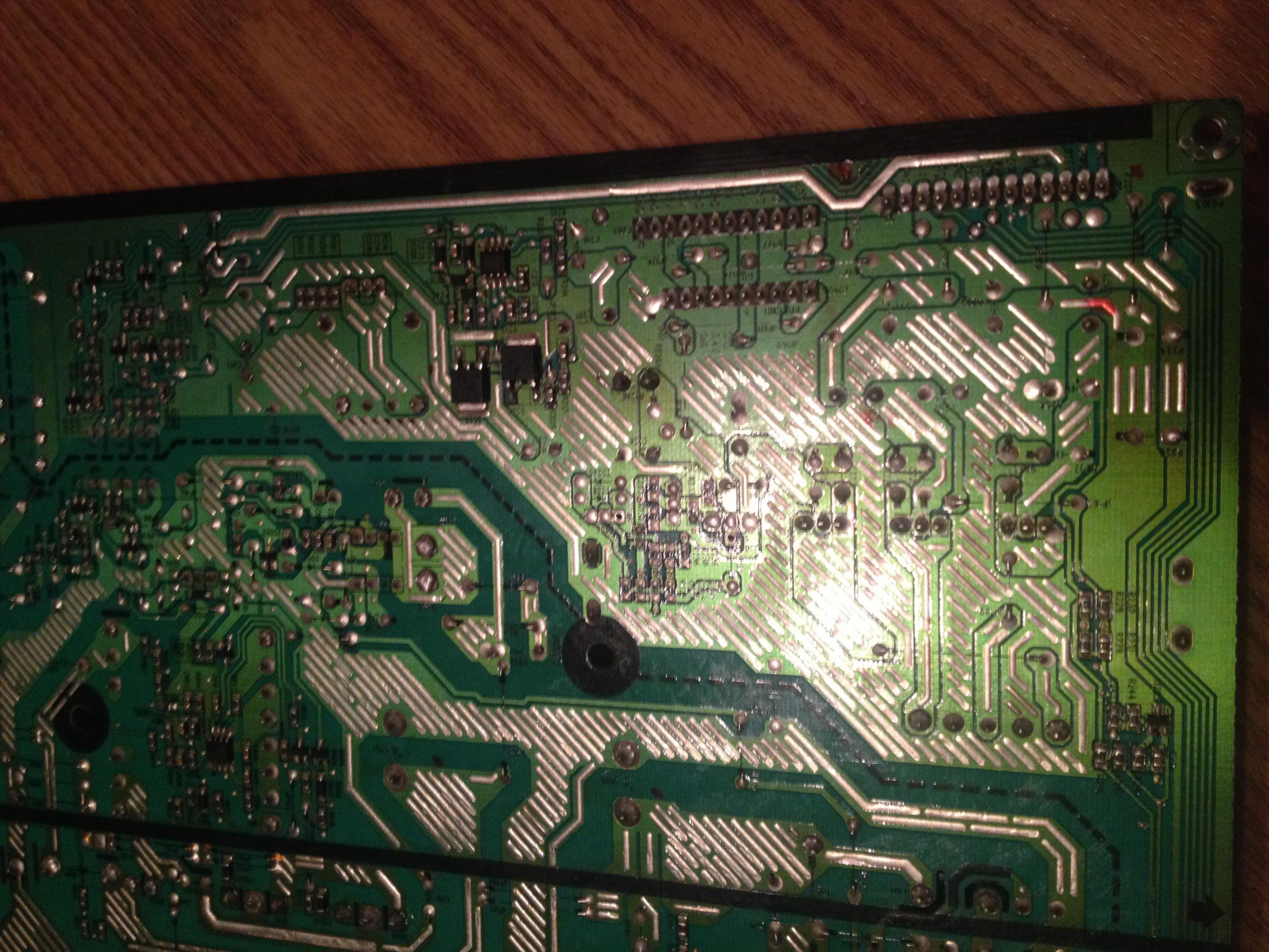

                              "smaller one is at 5 ohm." Can you please good clear pictures of the bottom side around that area?
                              Does it still show 5 Ohms if the cable between the power supply board and the main board is removed?
                                  How about the pictures of the bottom side of the board so I can see how the caps are connected. I still have a big doubt about that 5 Ohms reading since you are getting 5VSTBY OK at 5V, so @5 Ohms = 1A and about 5Watts of power dissipation, some thing will get quite hot in that area which I do not see any brown spot in that section at all.

                                    After I posted that picture I wondered the same thing, my batteries were on there way out on my meter. Im getting 2500 ohms now that meter is working properly. Sorry bout that.
                                        Well... that's a better reading from the DMM. Most DMMs don't correctly if the battery is getting low. Looks like the cap is o.k. then. At 5 Ohms, that cap would have been glowing hot and it should have dragged the output voltage down.
                                        Something still doesn't add up.
