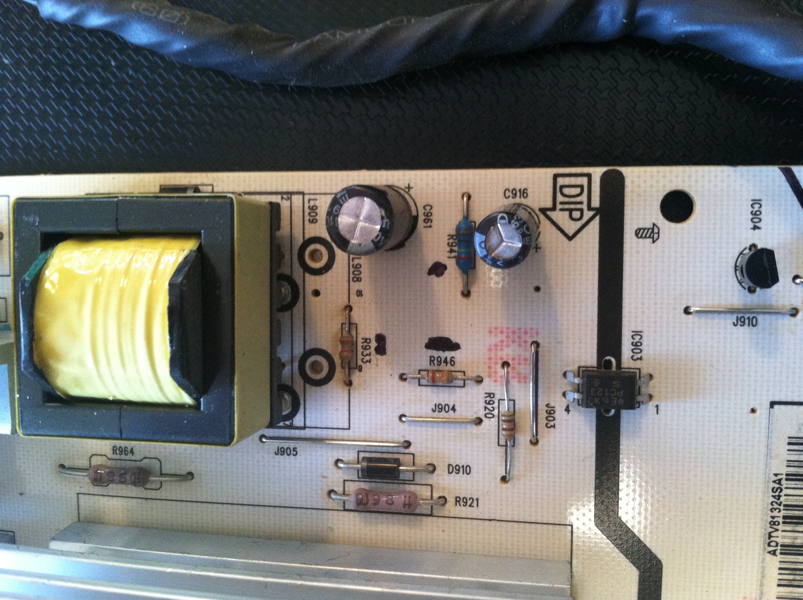

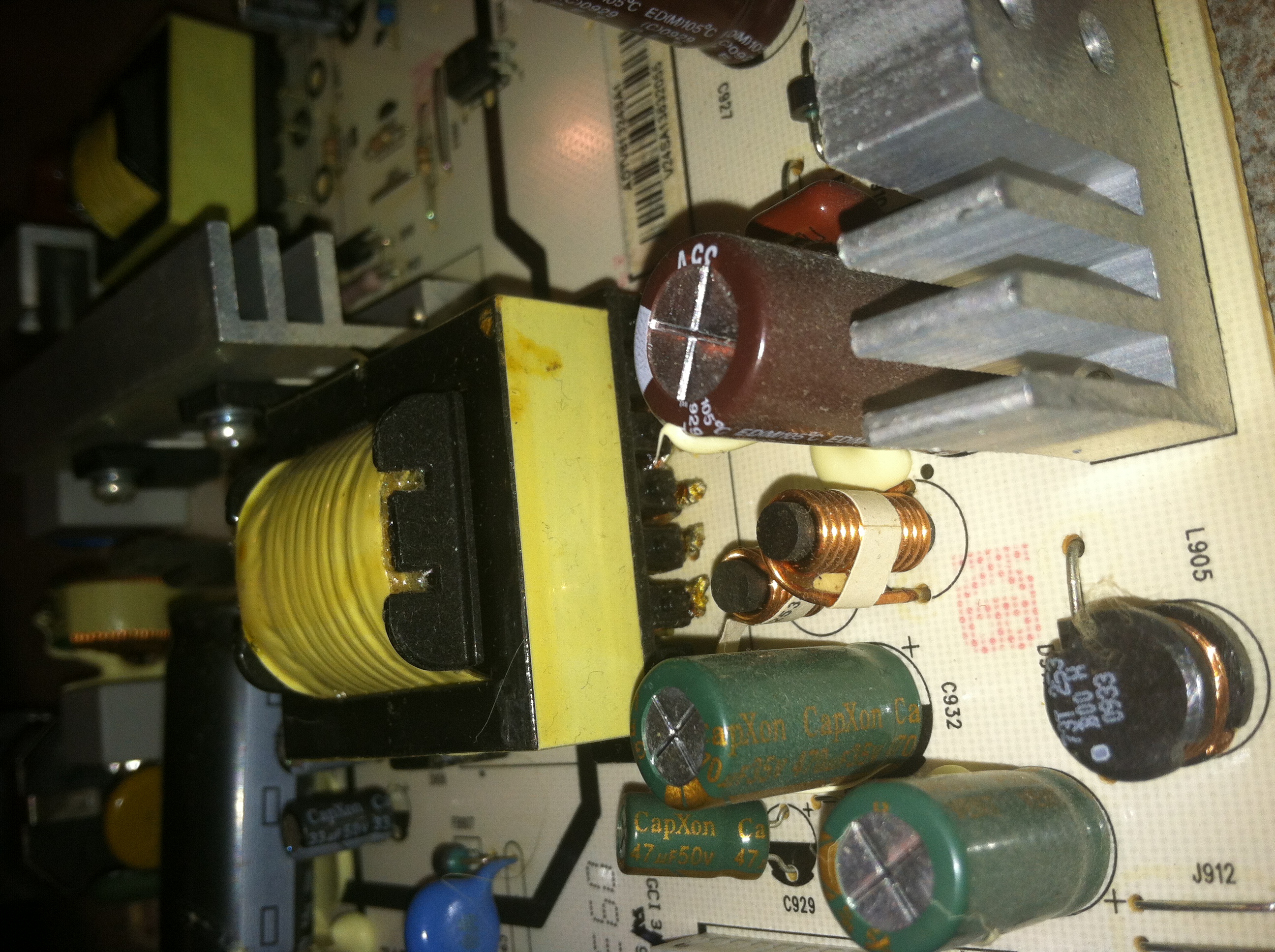

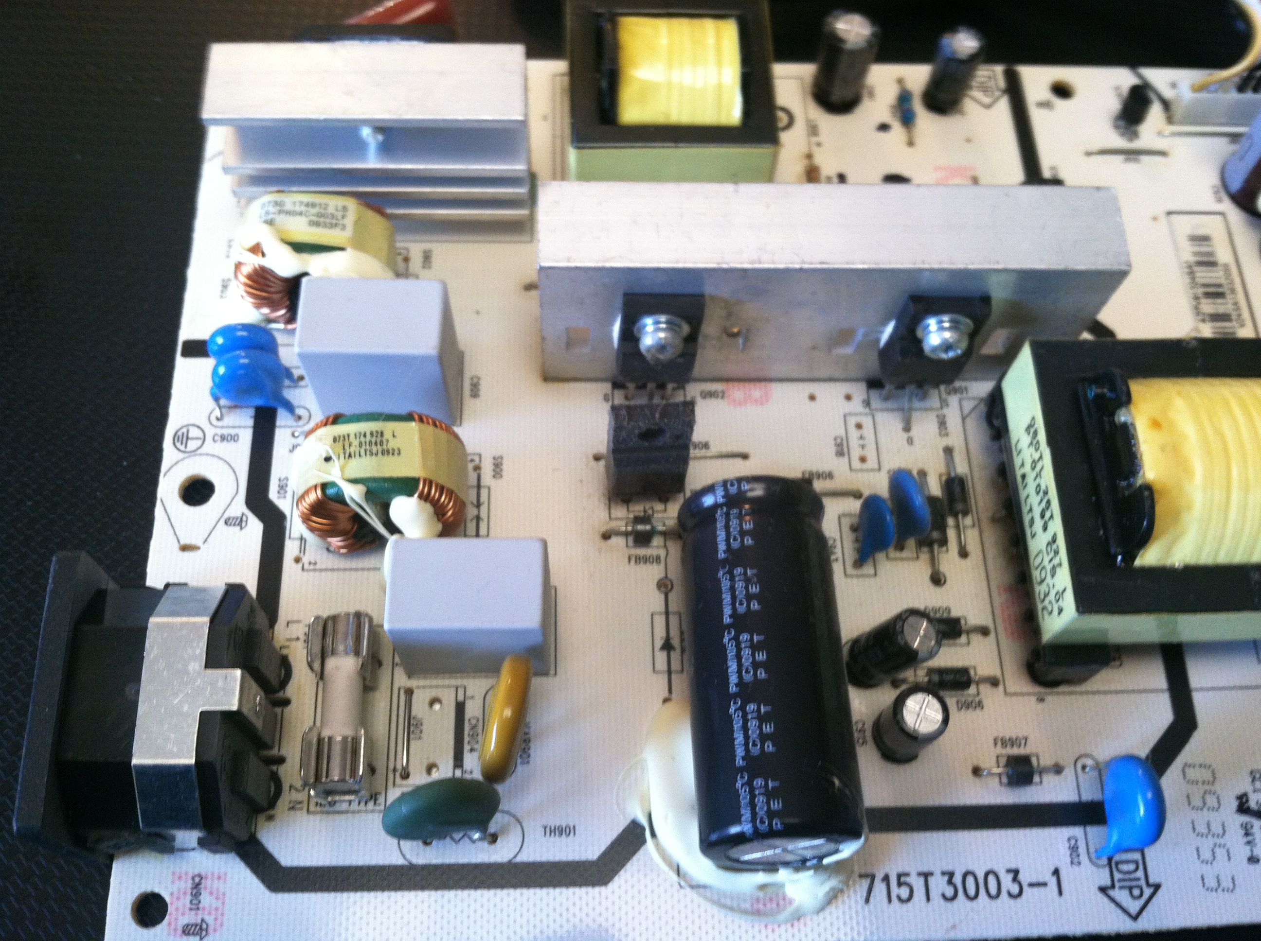

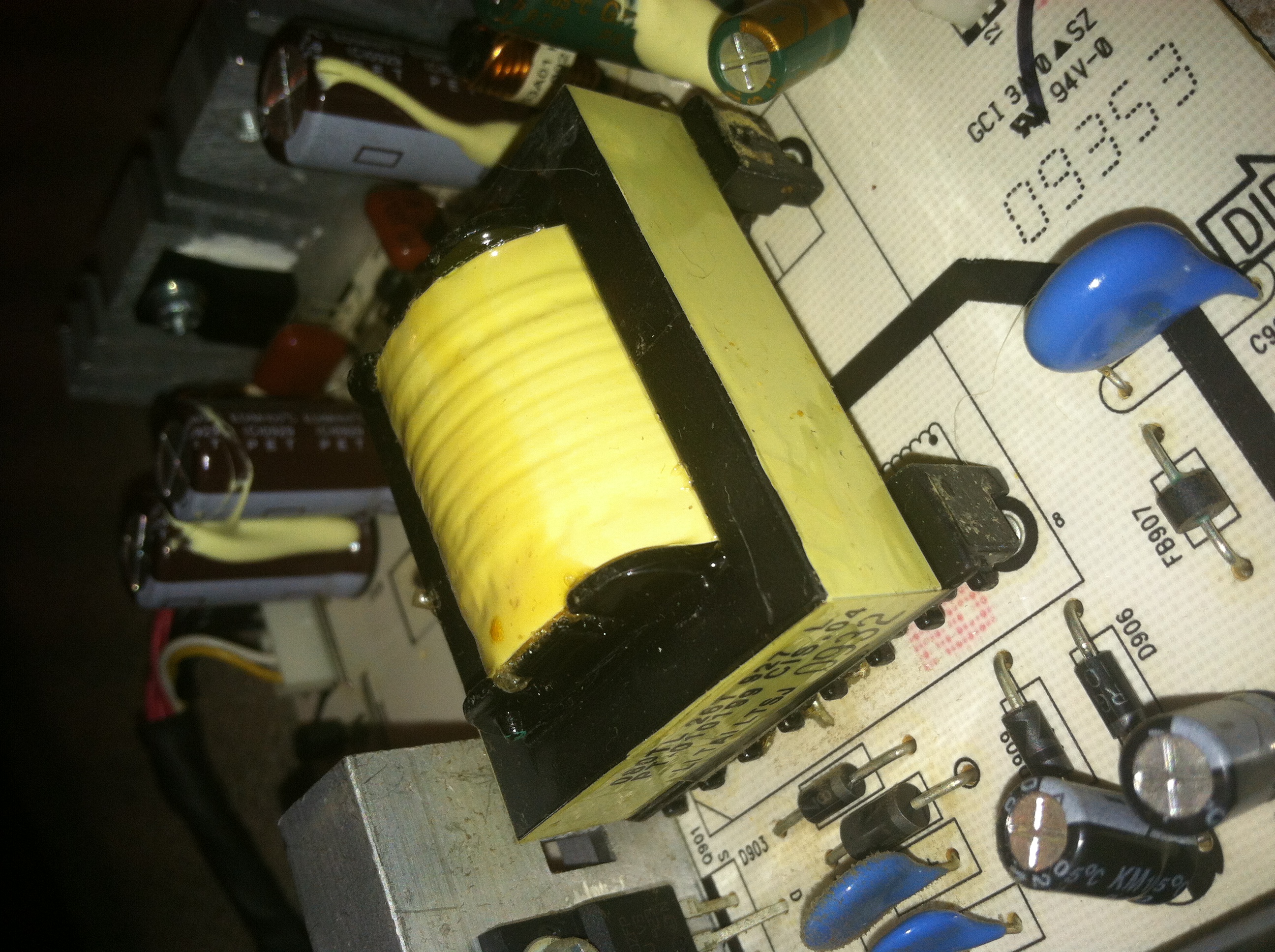

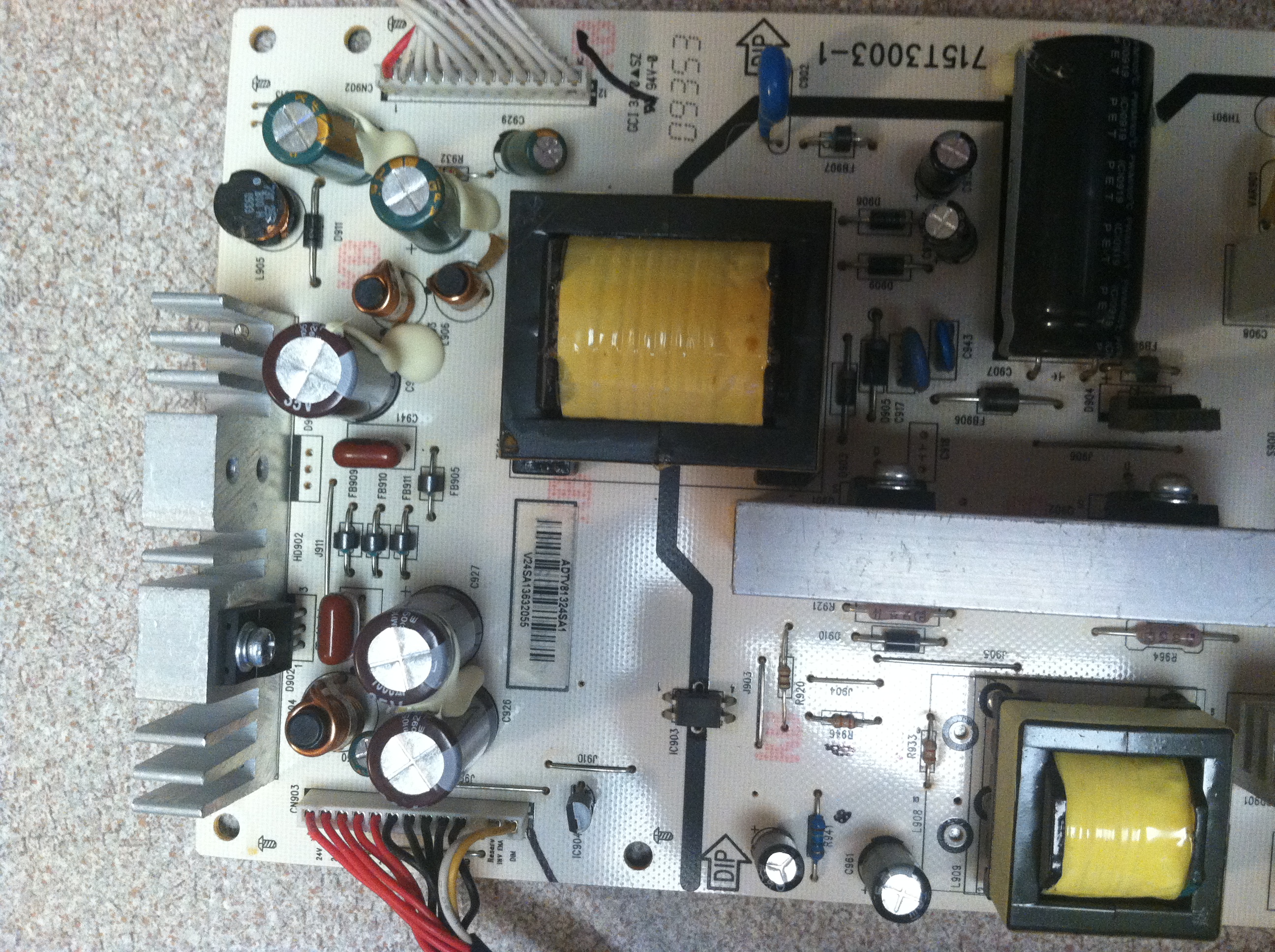

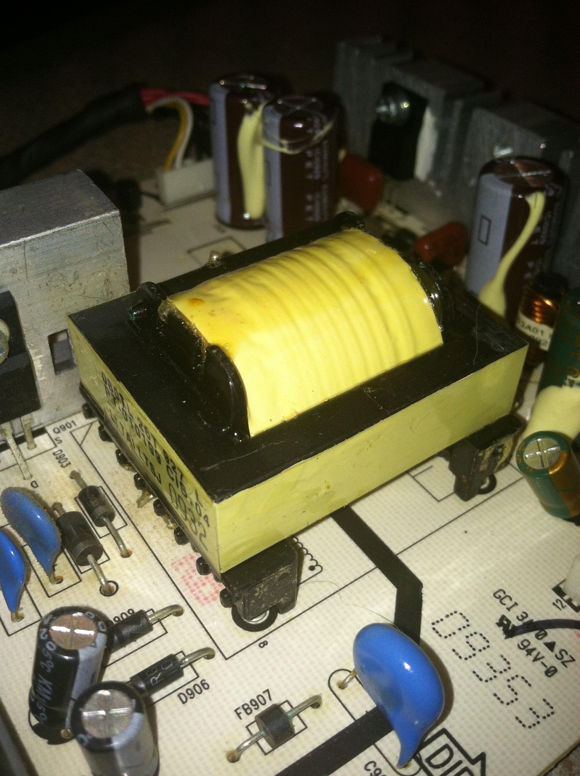

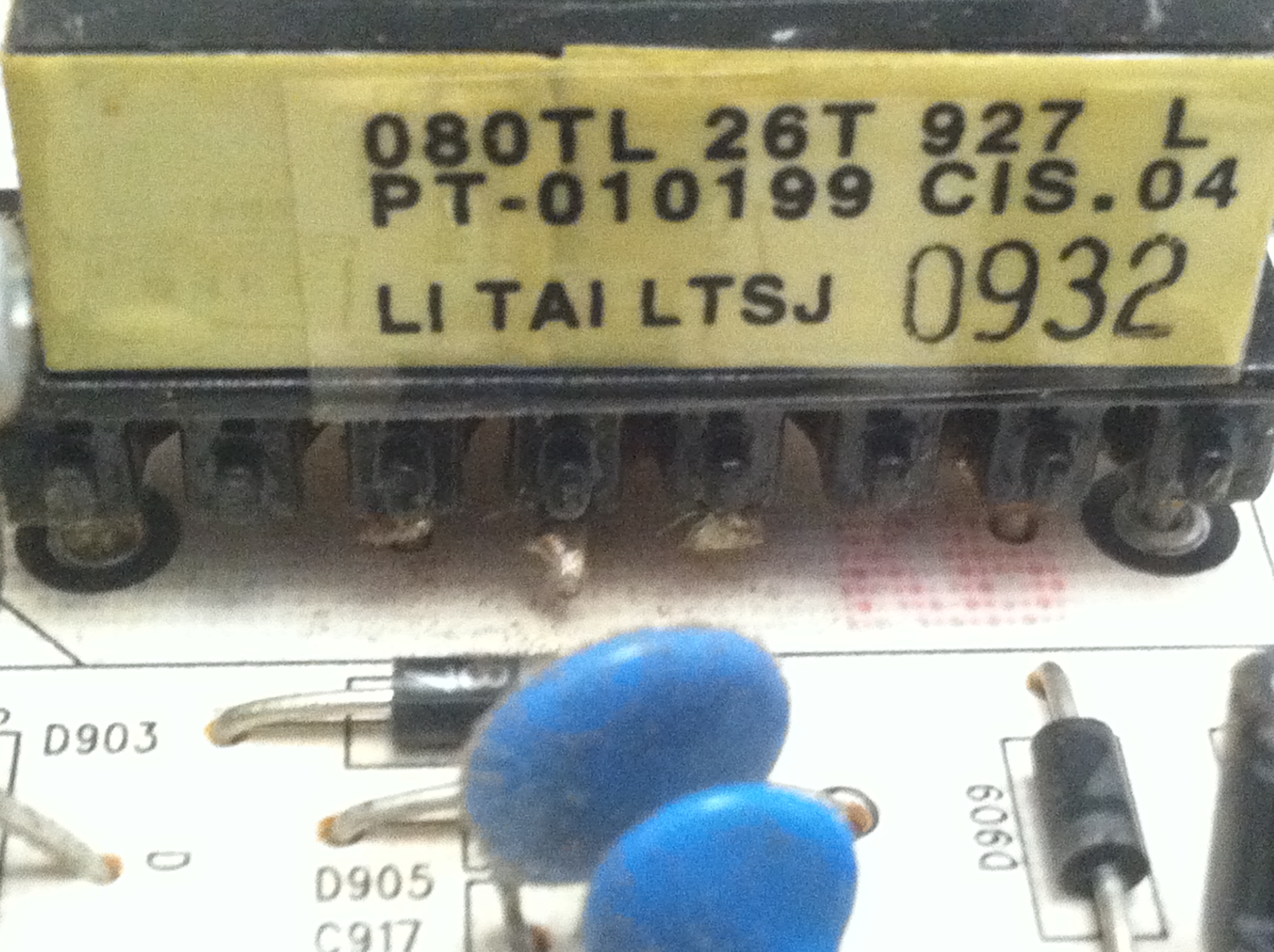

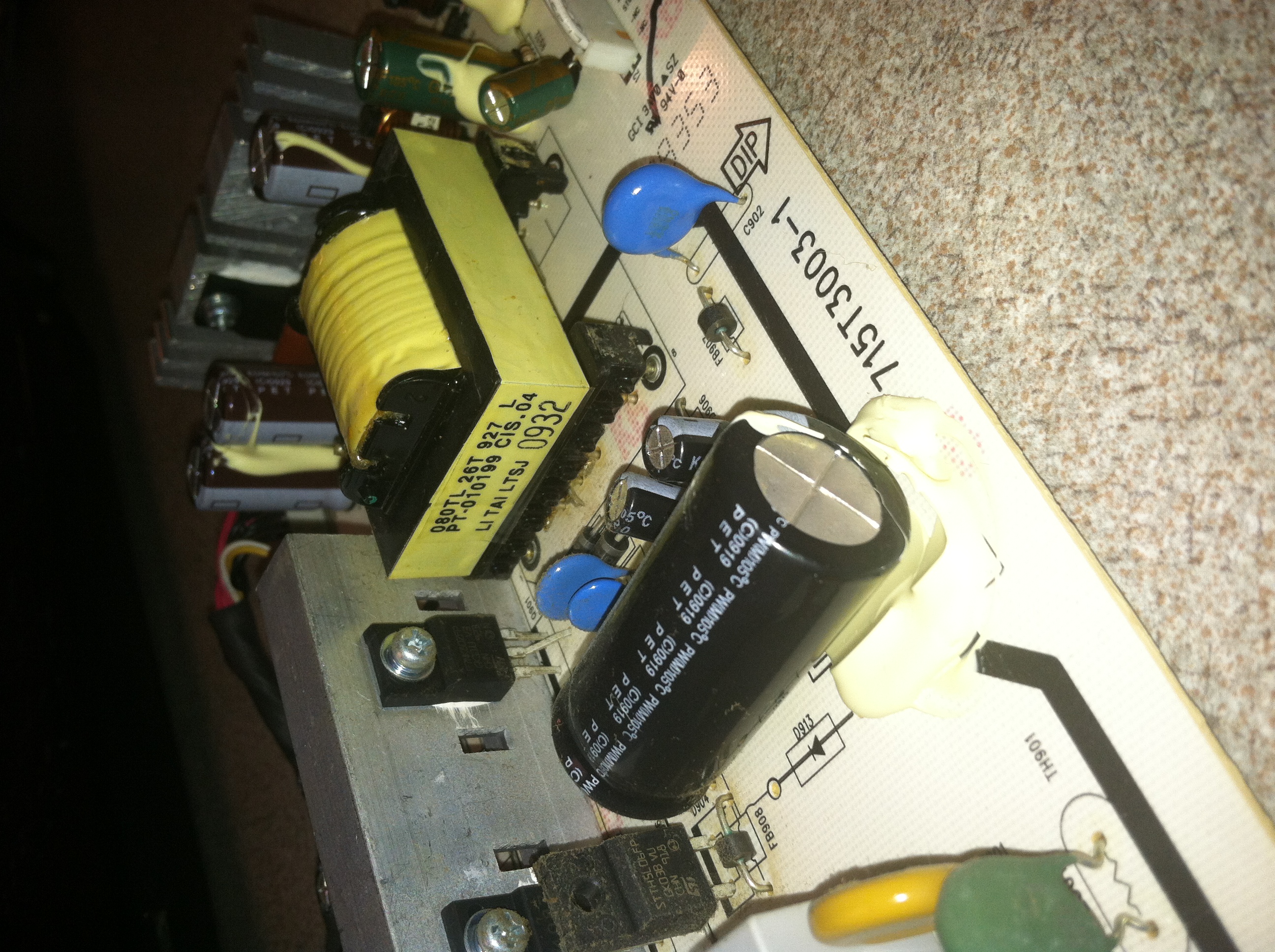

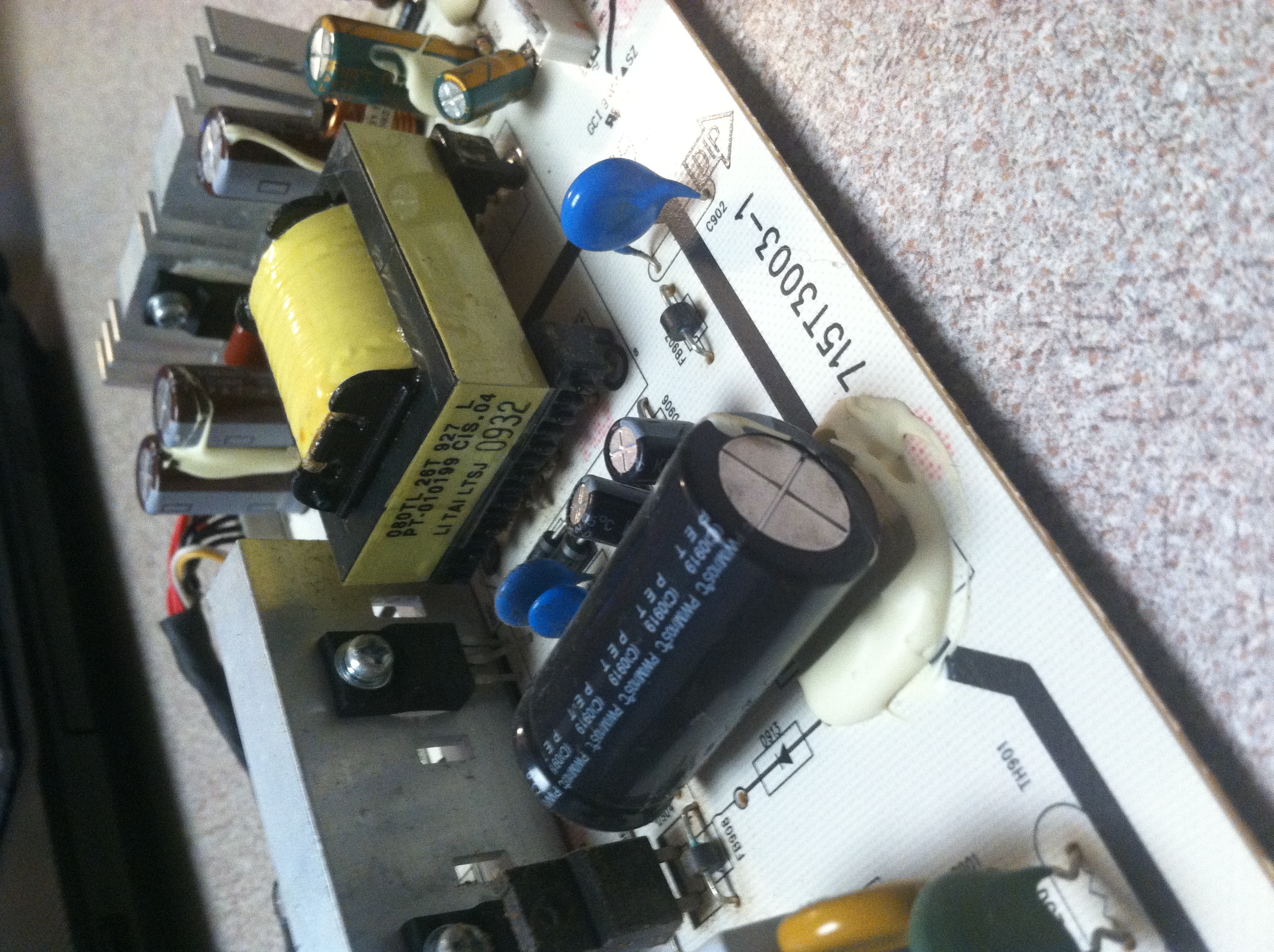

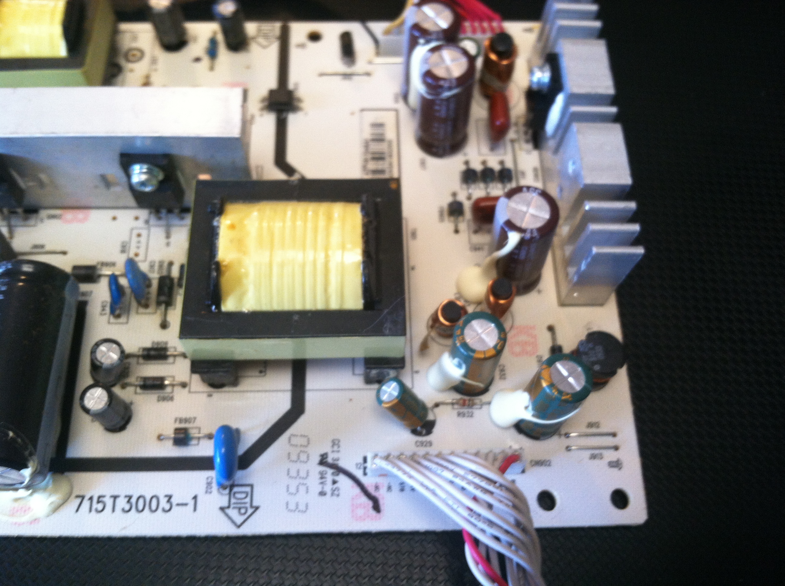

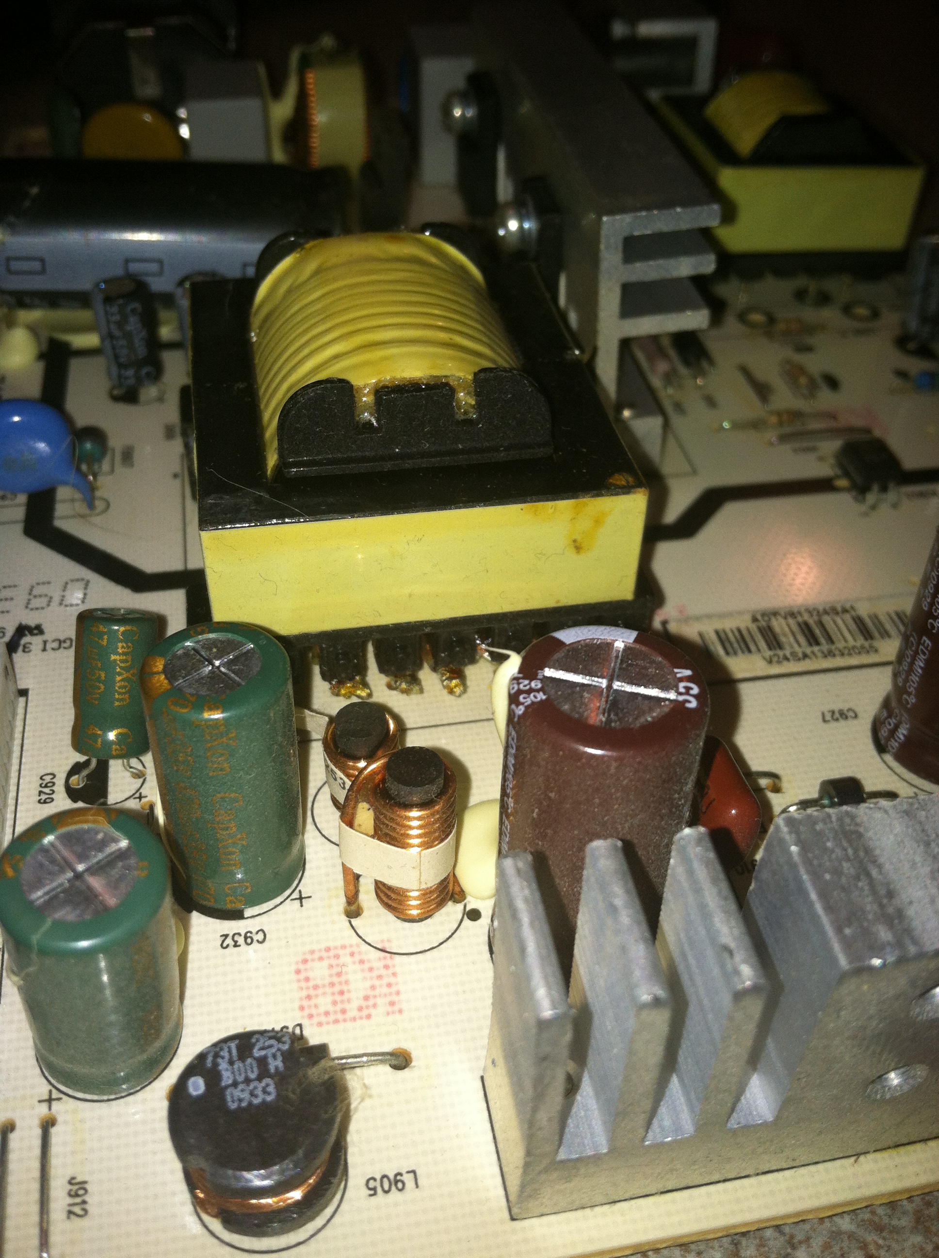

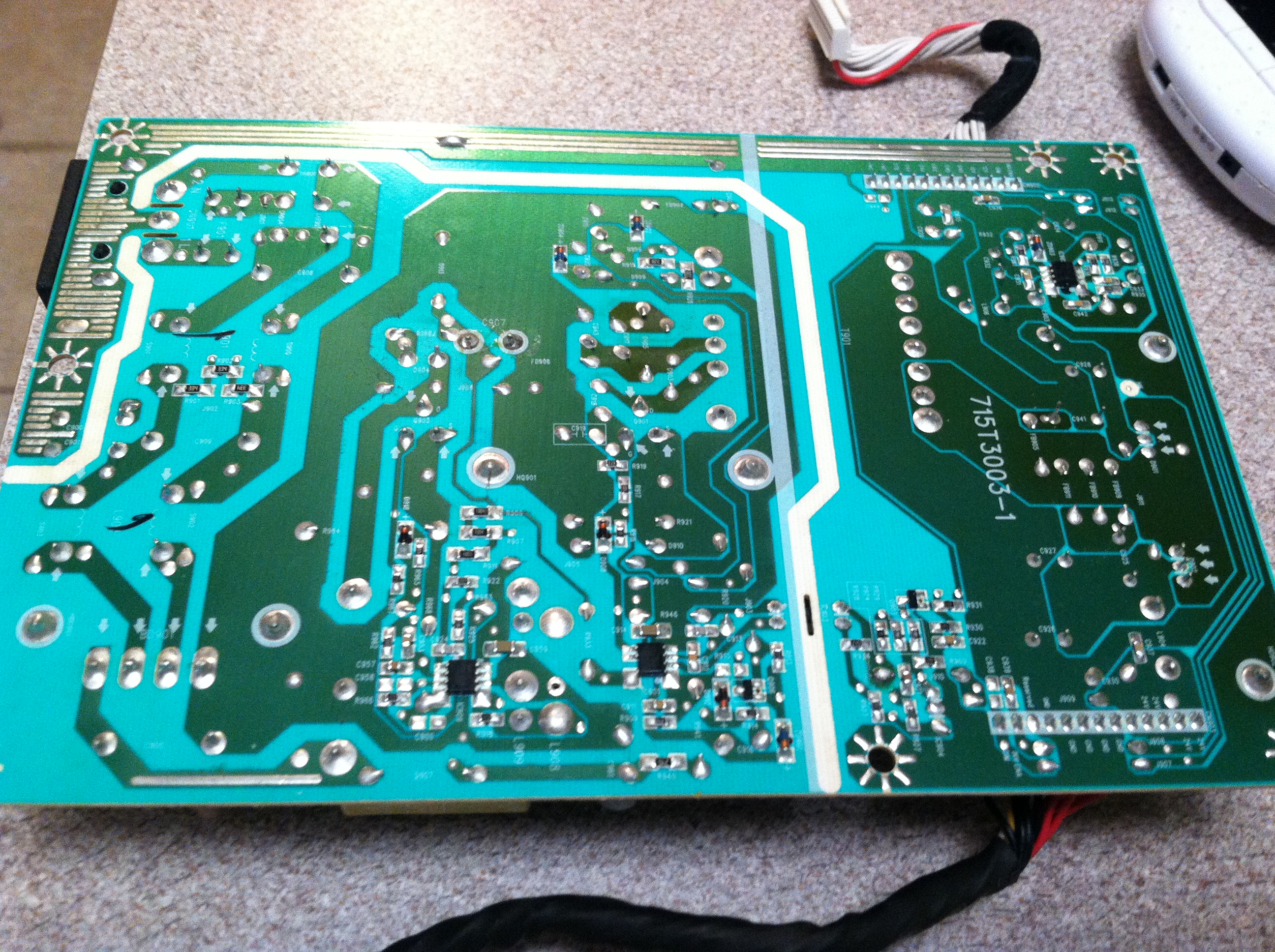

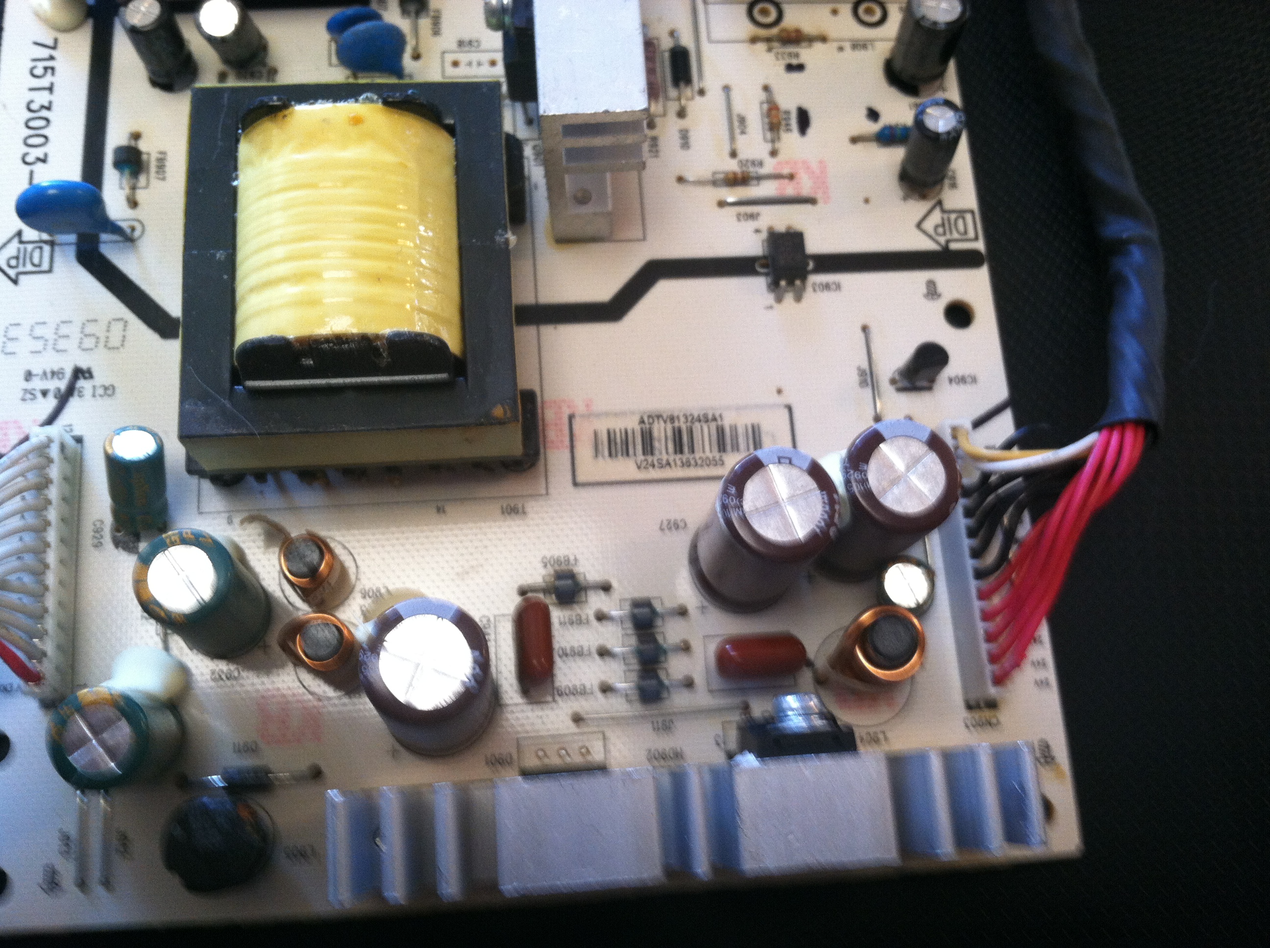

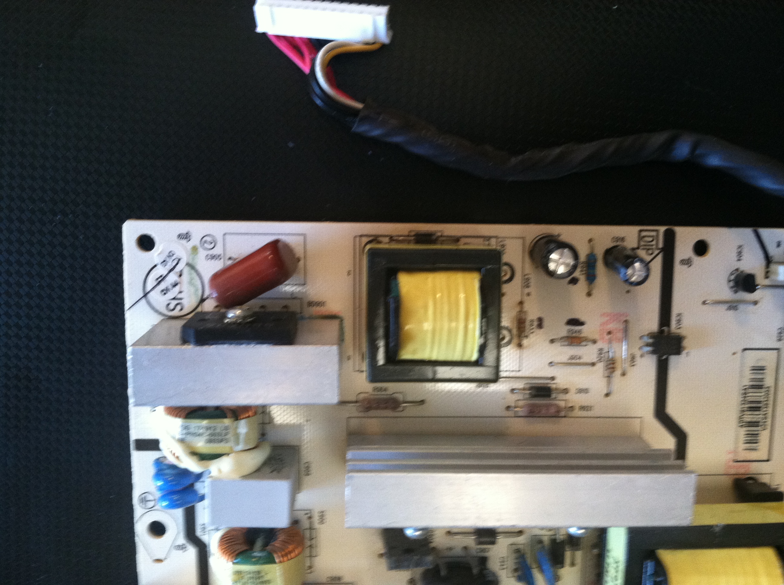

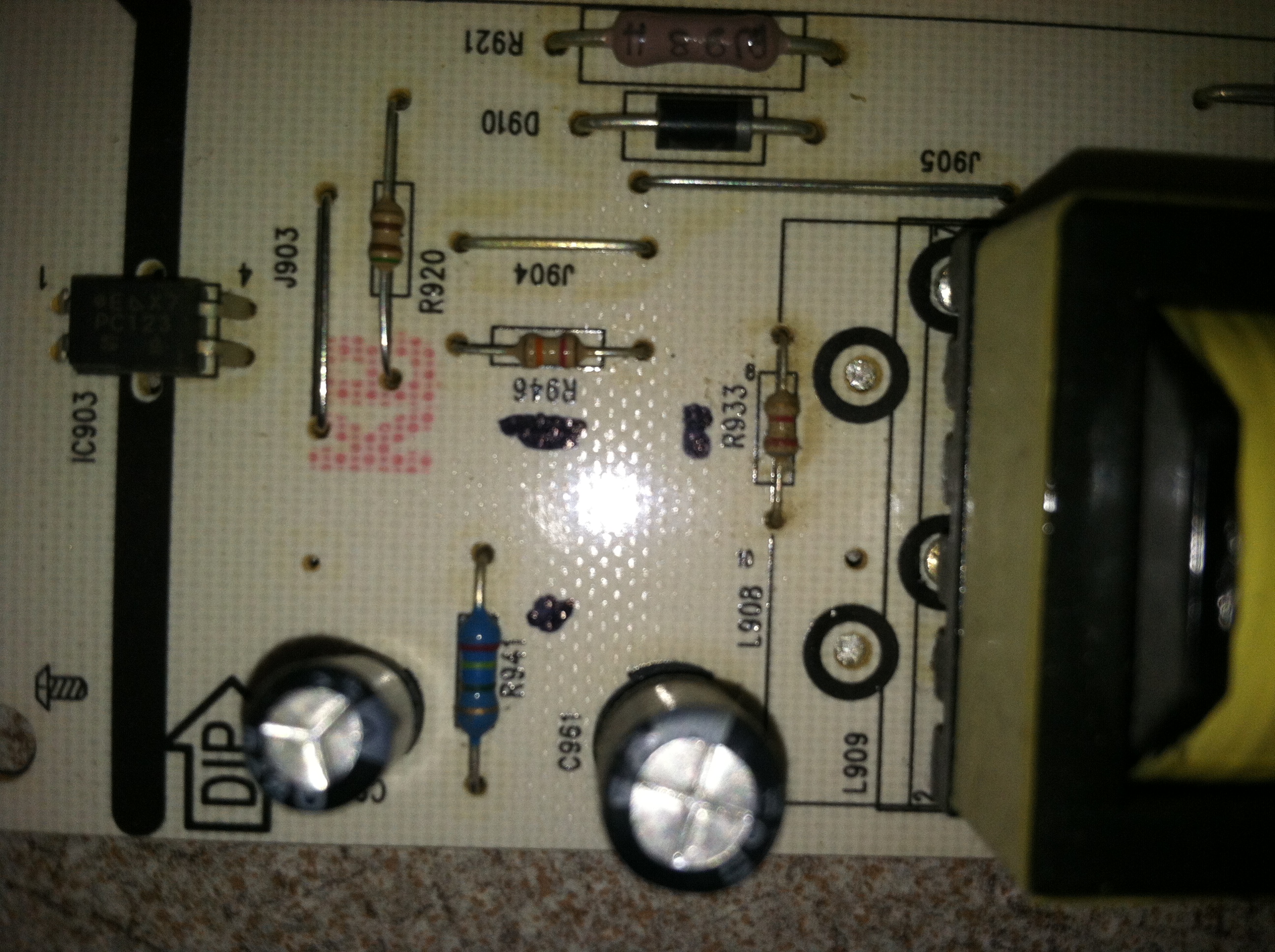

I'm looking for help on a Vizio VSA26LHDTV10T. Had power surge and now just the front light comes on nothing else. I did a quick test on the power board. On the printed board by the pins/ribbon cable on each side it says 24v on pins (each side). With the board plugged in, all 8 - 24v contacts measure 12.8v. I'm kinda new to this, any ideas on where or what to do next? Thank you for any help. None of the caps are visually bulging. The solder points on the underside of the board on the biggest cap look a little burnt. It's lifted off the 'glue'. The big transformer looks like it got heated up, like it leaked grease. If look at the pics, you can tell heat went through the board. Thanks much for any help

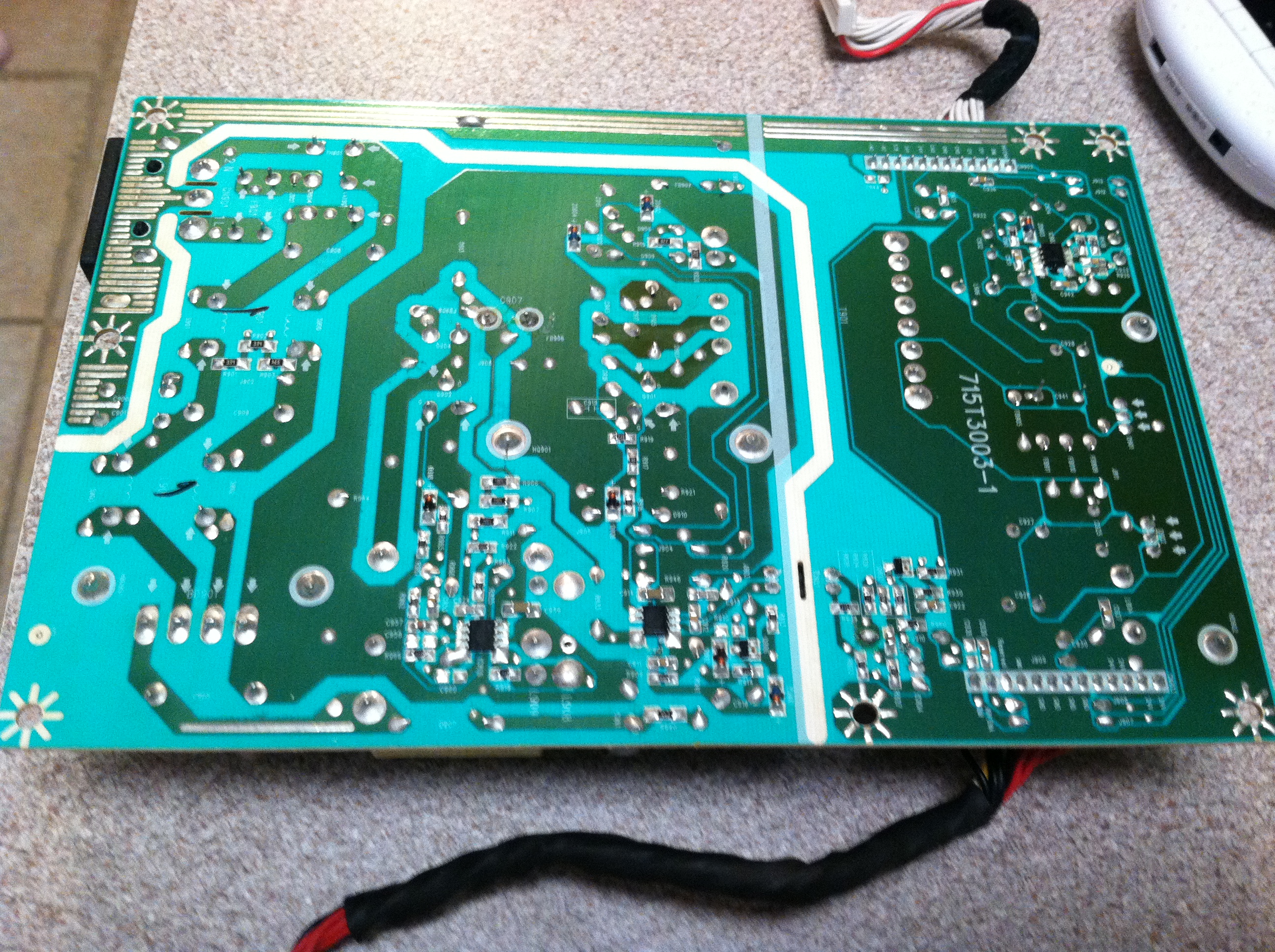

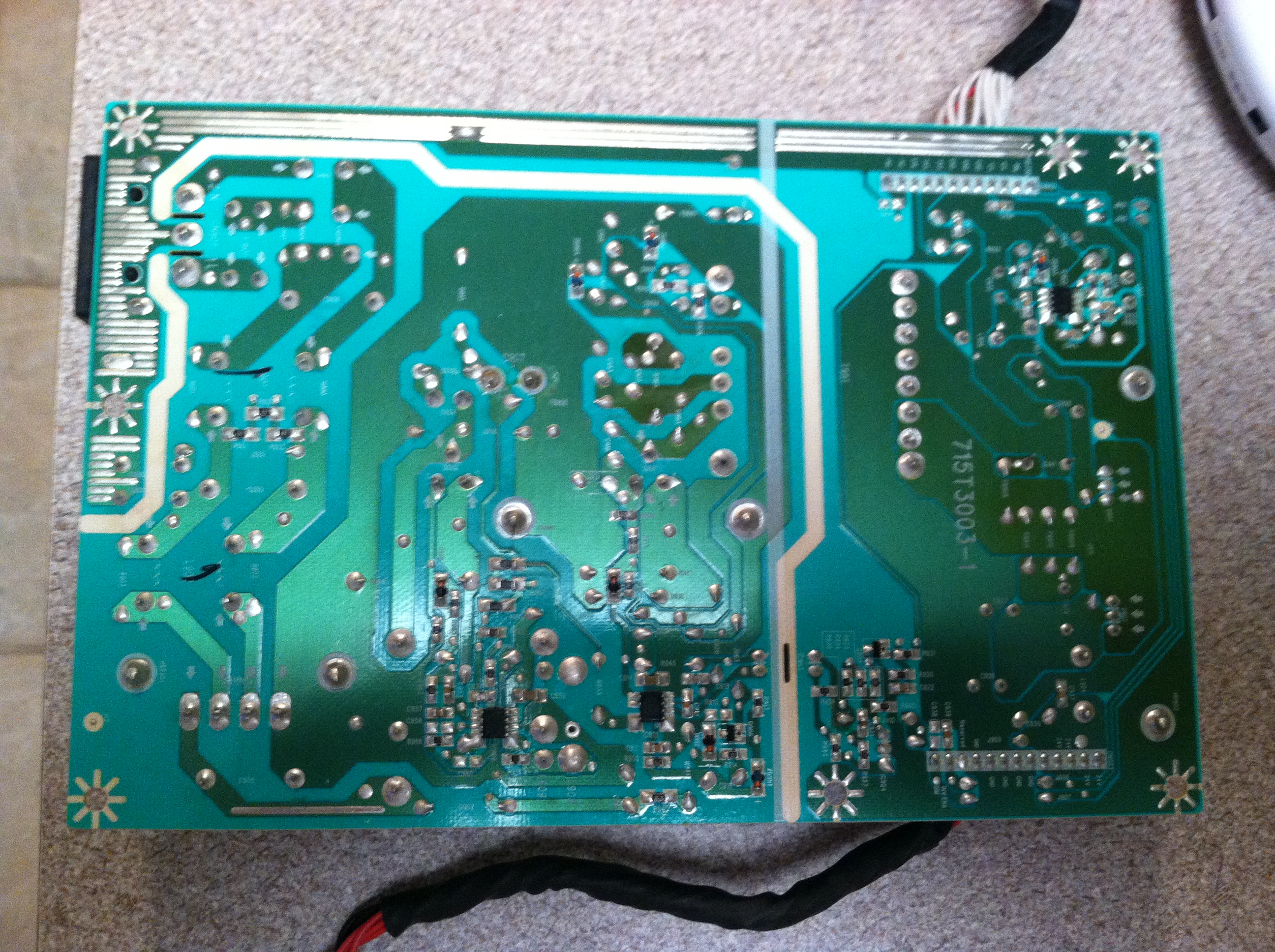

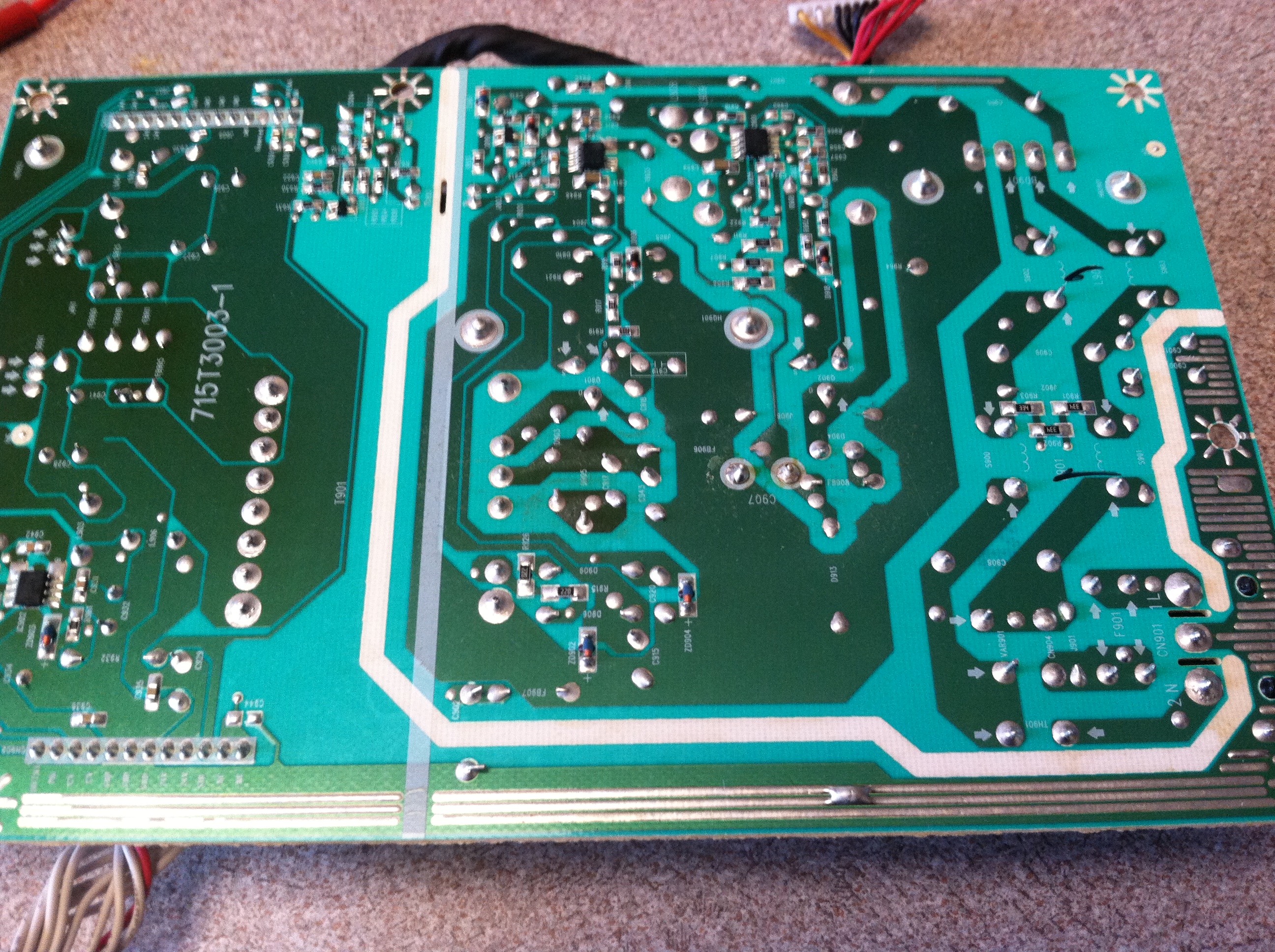

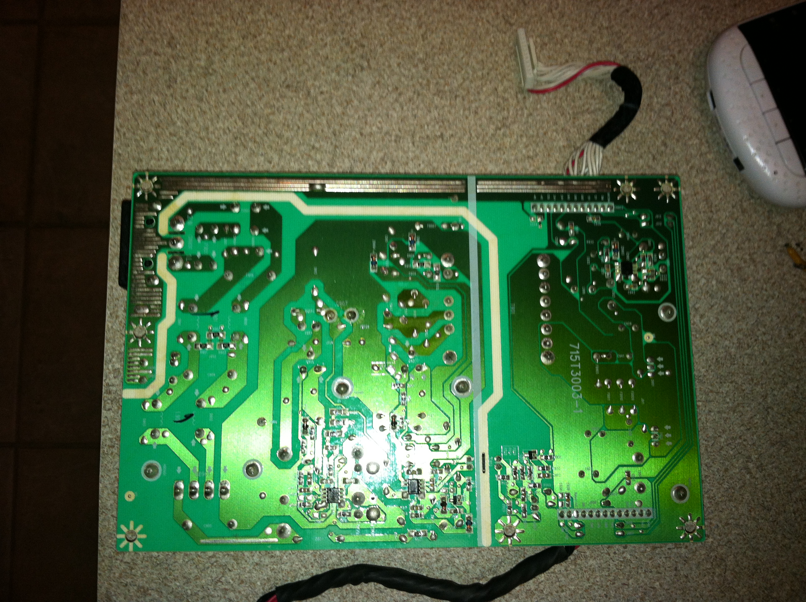

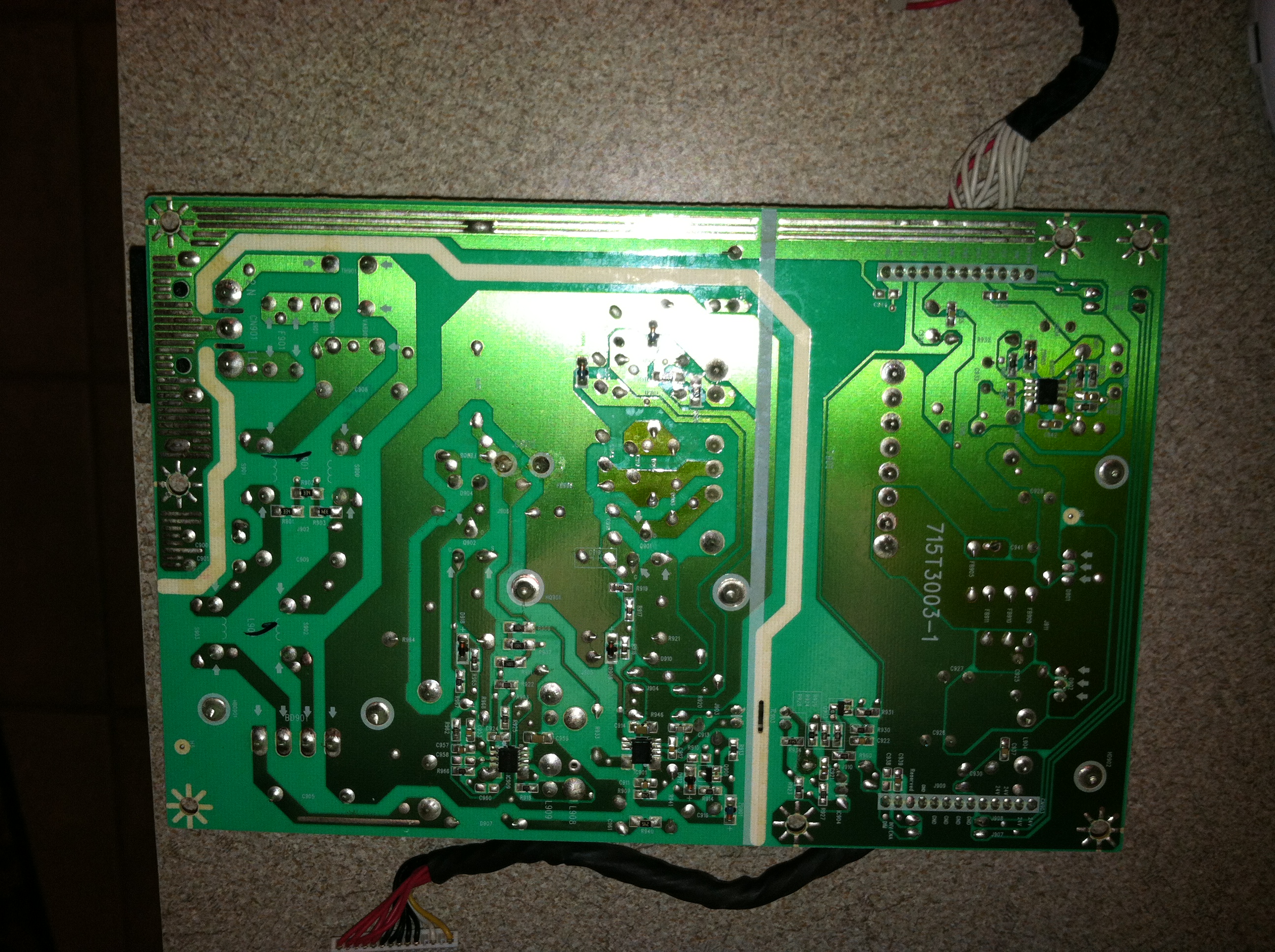

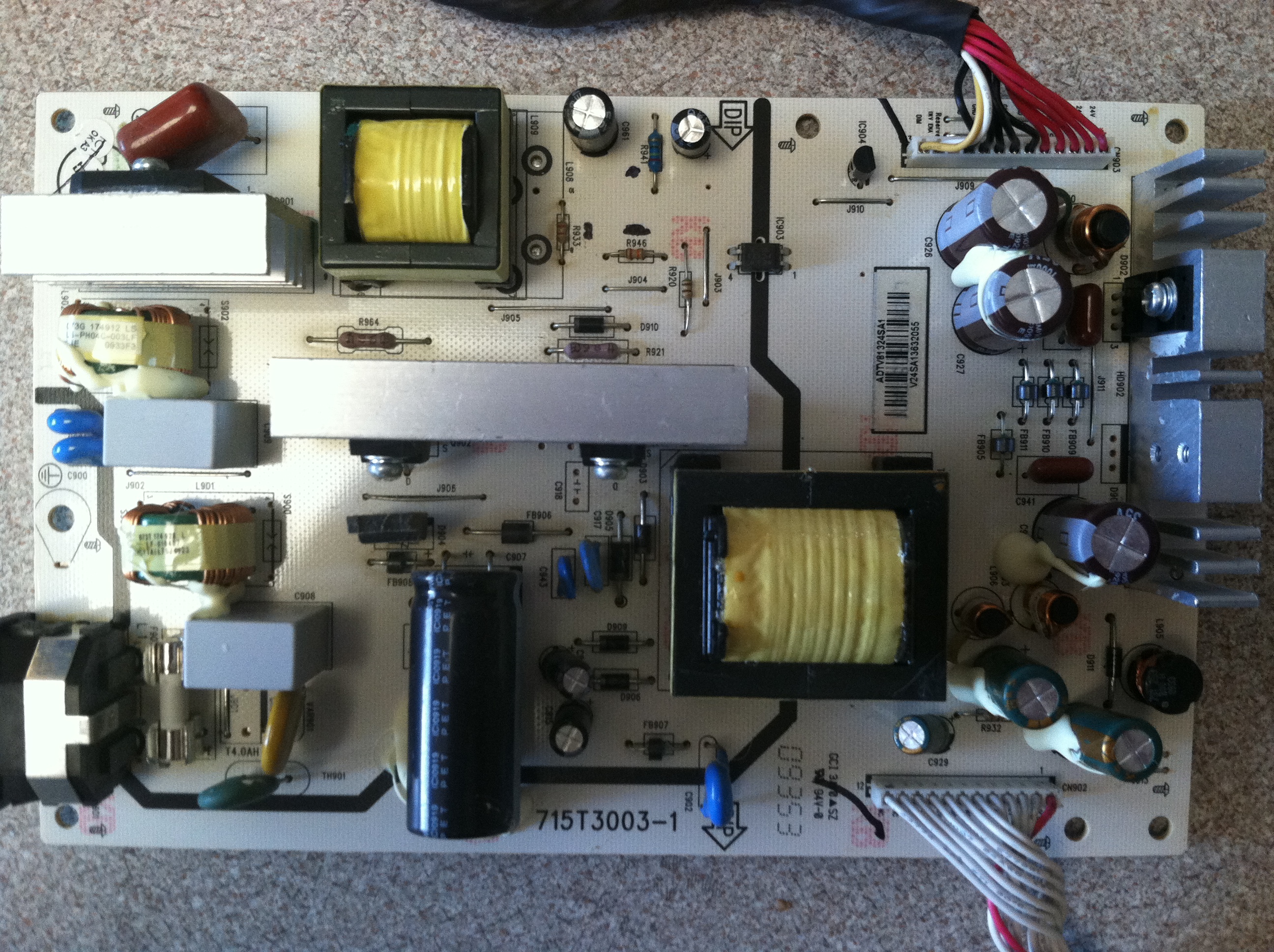

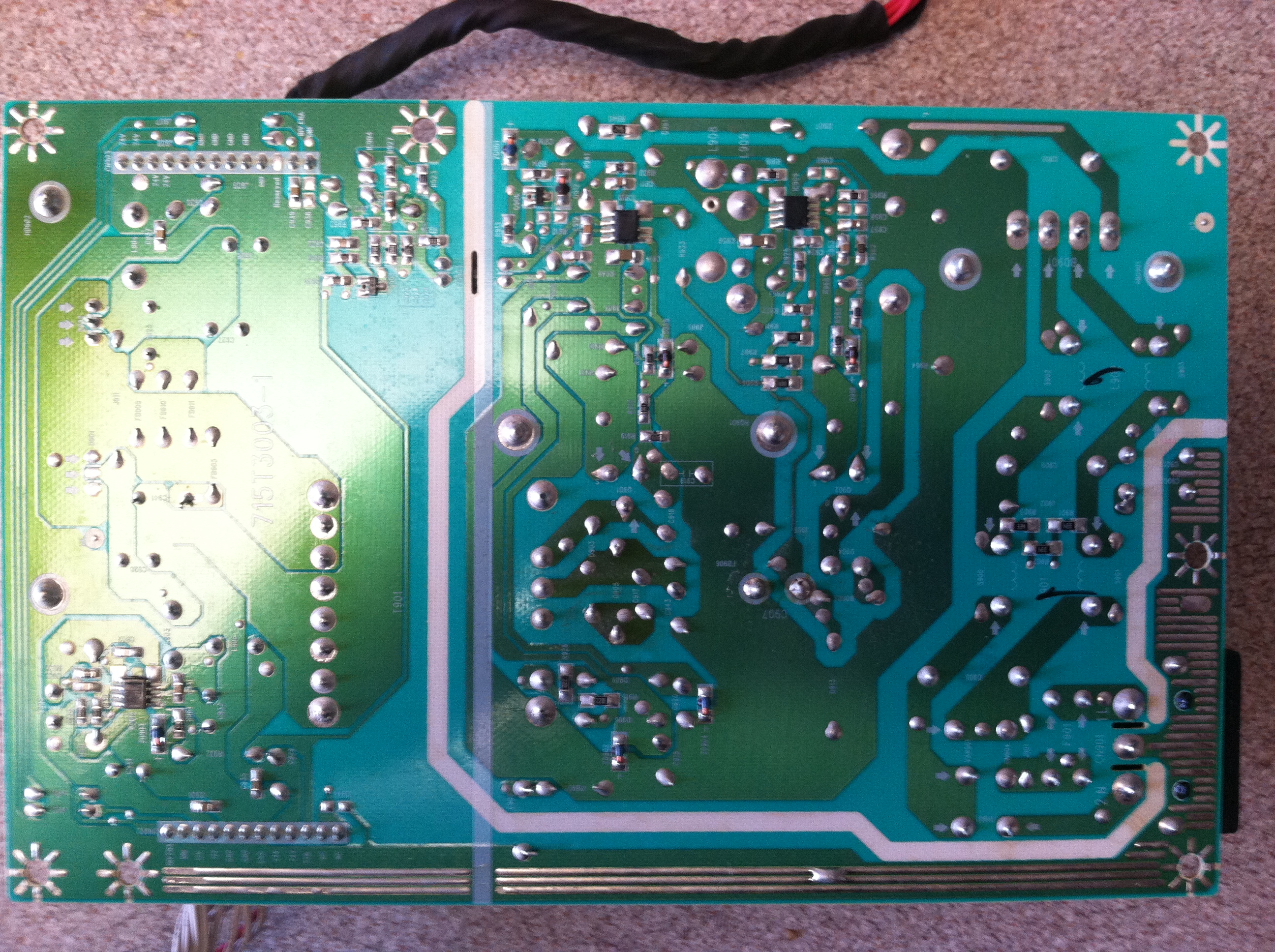

 Can I get the picture that show the whole board, top and bottom side?
 Is it also Vizio VSA26LHDTV10T, not VA26LHDTV10T?

 It looks like this power supply ?
 http://www.shopjimmy.com/vizio-adtv8...upply-unit.htm
 If it is, then you need to find out if you do have >360VDC on the TWO LEGS of the main filter cap when PS-ON is present.Last edited by budm; 02-28-2015, 01:07 AM.Never stop learning
 http://www.badcaps.net/forum/showthread.php?t=24809Comment

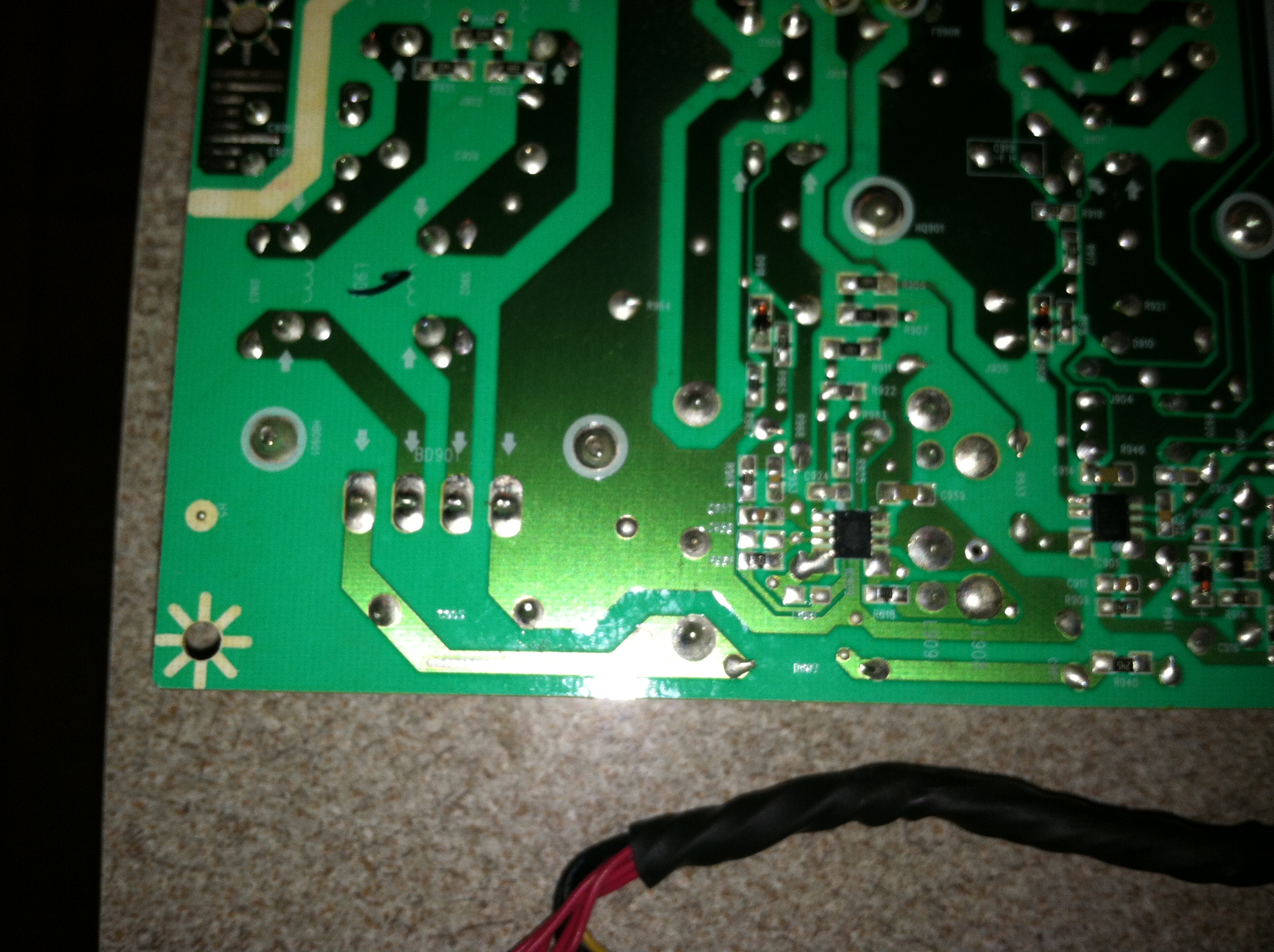

 I still need the WHOLE picture of the bottom side of the board to locate the PFC Controller IC so you can get the P/N for the IC to locate and test the VCC pin of the PFC Controller IC, or buy a new power supply board since are going to be dealing with SMD soldering and de-soldering.
 Not only that the power supply is damaged, you may find out later after getting the power supply working first just to find out that the main board and other board may also be damaged.
 You are not going to find the diagram for this power supply board unless you are willing to spend days tracing out the board.Last edited by budm; 03-01-2015, 05:56 PM.Never stop learning

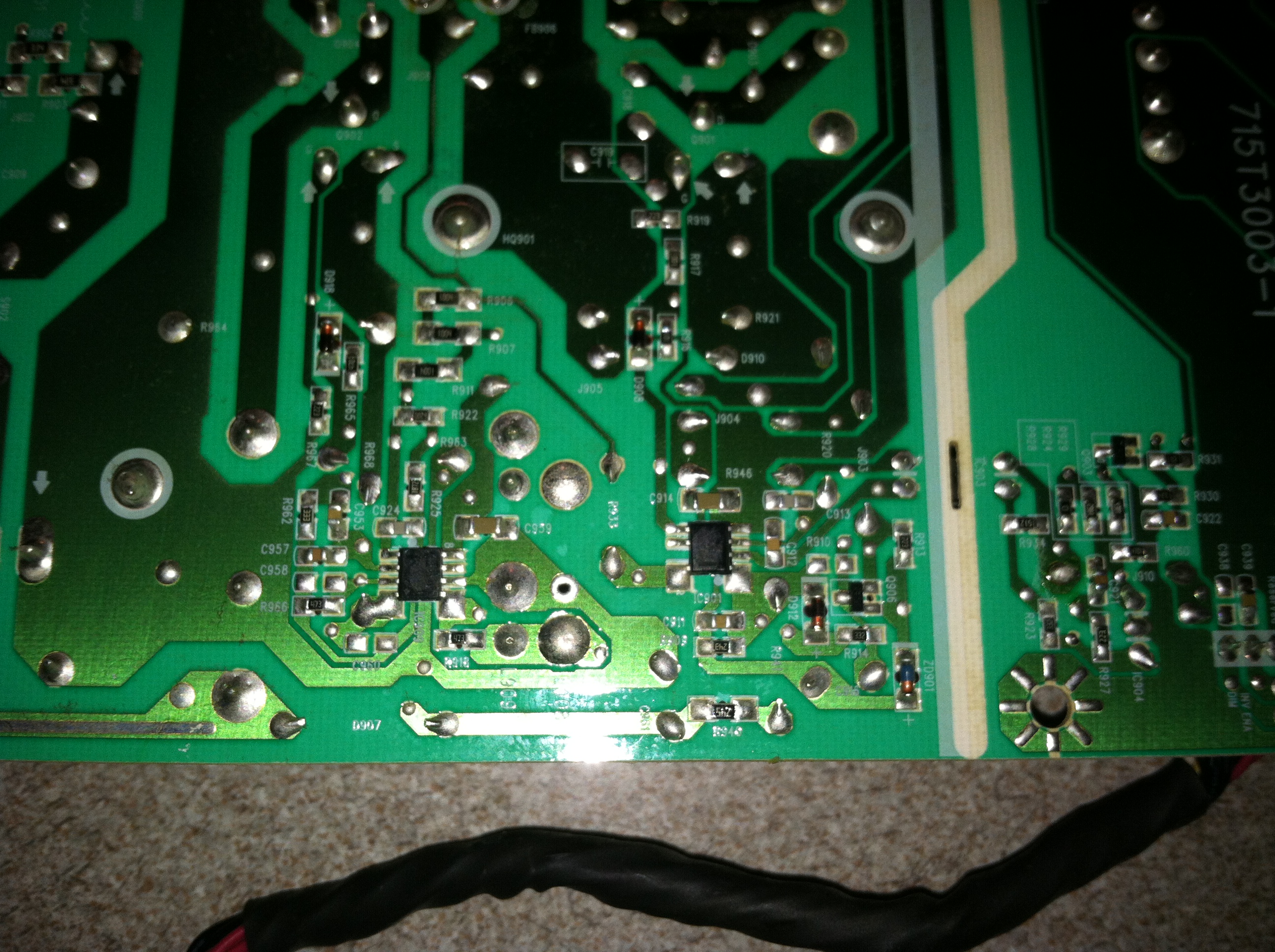

 Re: Vizio VSA26LHDTV10T. Had power surge ....
 https://www.badcaps.net/forum/attach...6&d=1425256403
 OK, the 8-pin SMD IC 909? (cannot clearly the number) should be the PFC IC. The 7-Pin IC901 is the SMPS IC.
 So get the P/N of that PFC IC.
 Check PFC diode D904 also.Last edited by budm; 03-01-2015, 06:47 PM.Never stop learning
 There are two 8 pin.
 The one on the backside of the board by the cables (opposite the power cord input) says:
 5430
 TI 95H
 ZKW9G4
 The 2nd one, (VERY HARD TO READ)
 SG6961SZ
 B1AM5063925Y
 7 pin says
 P1337
 PFC Diode
 STTH5L06FP
 GK03B VU
 CHN 918Comment

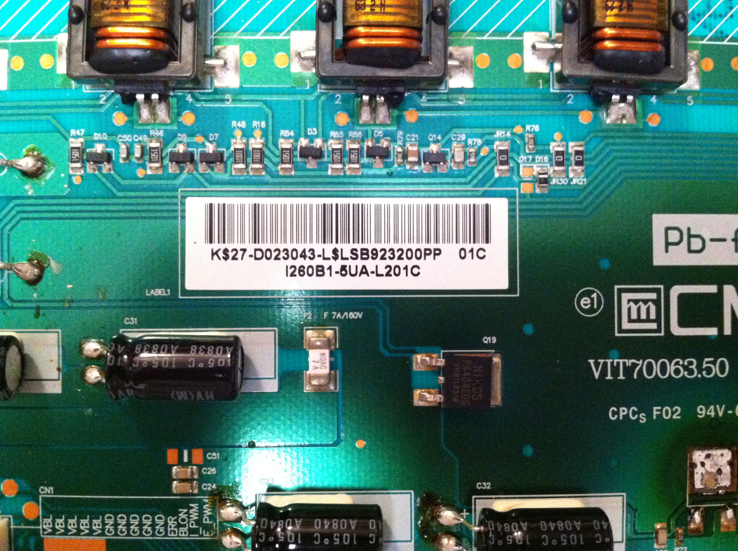

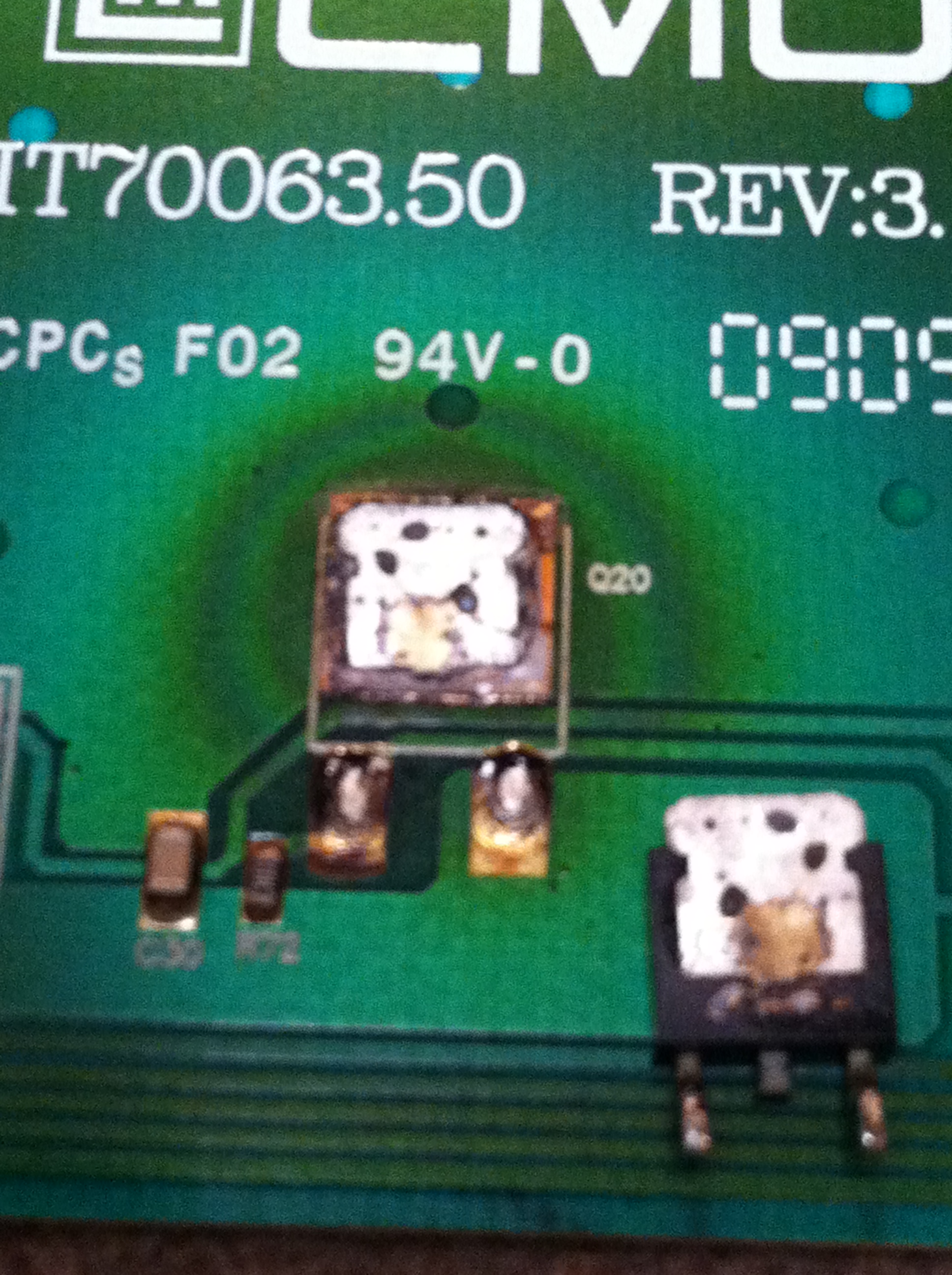

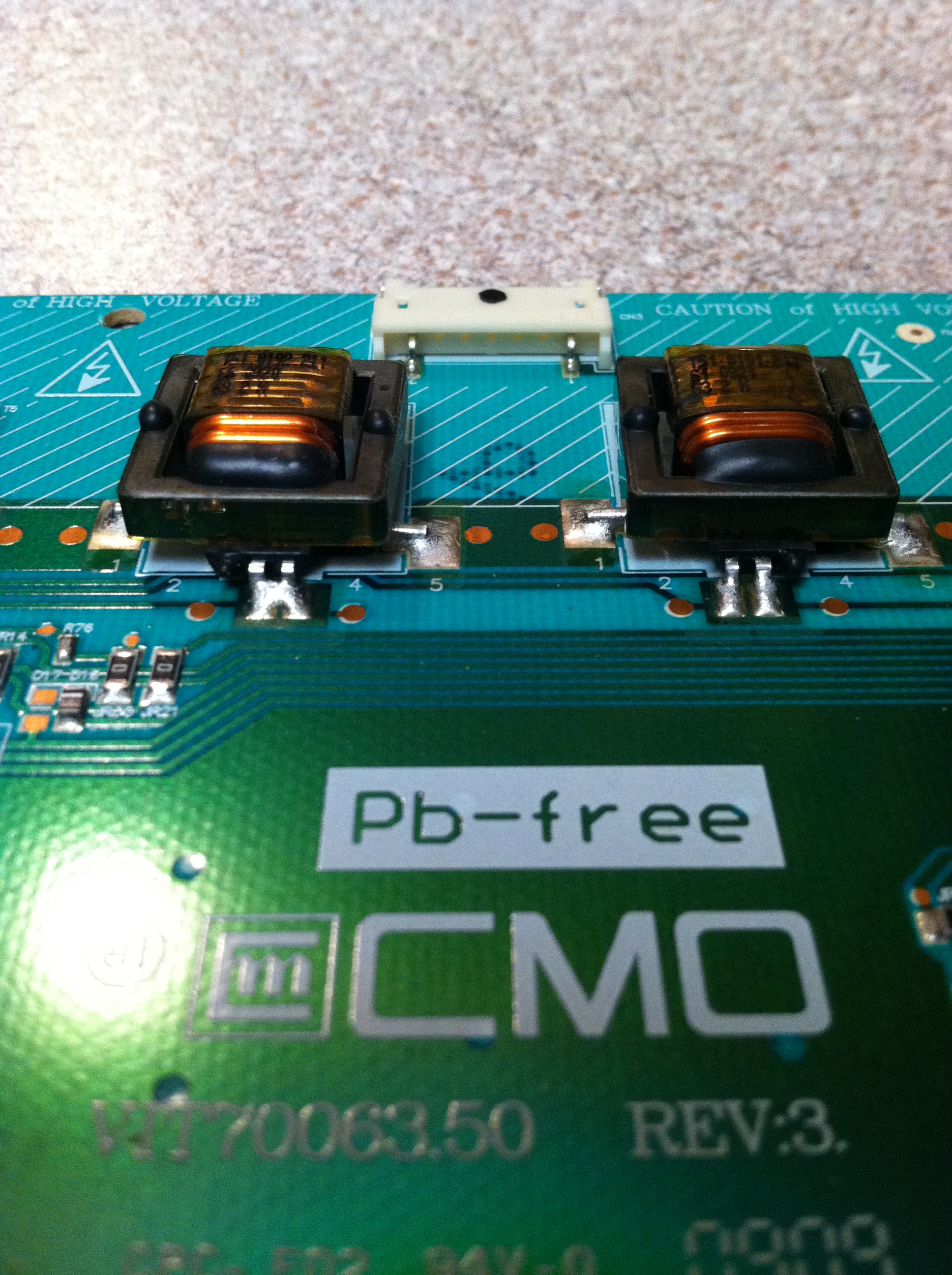

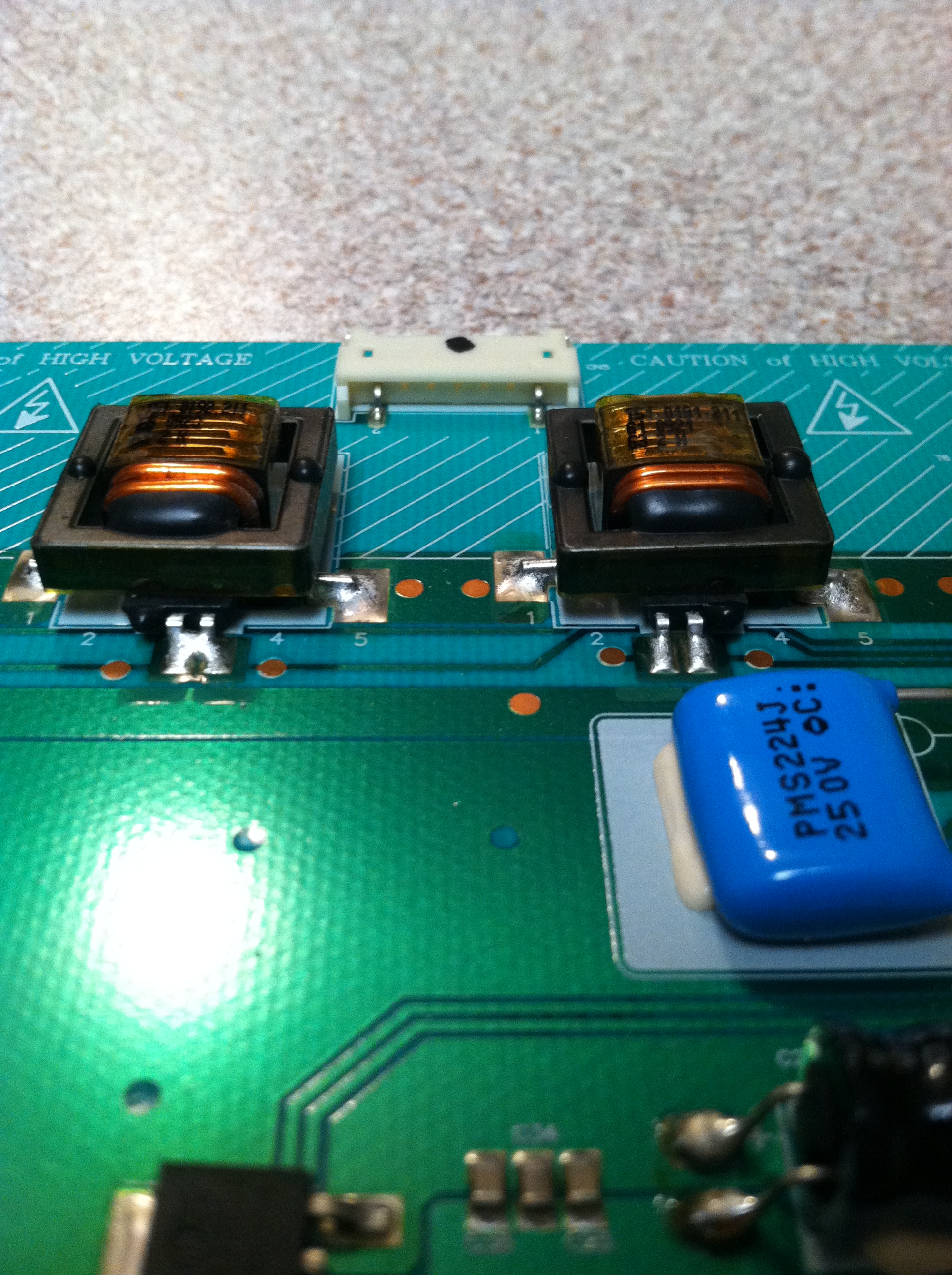

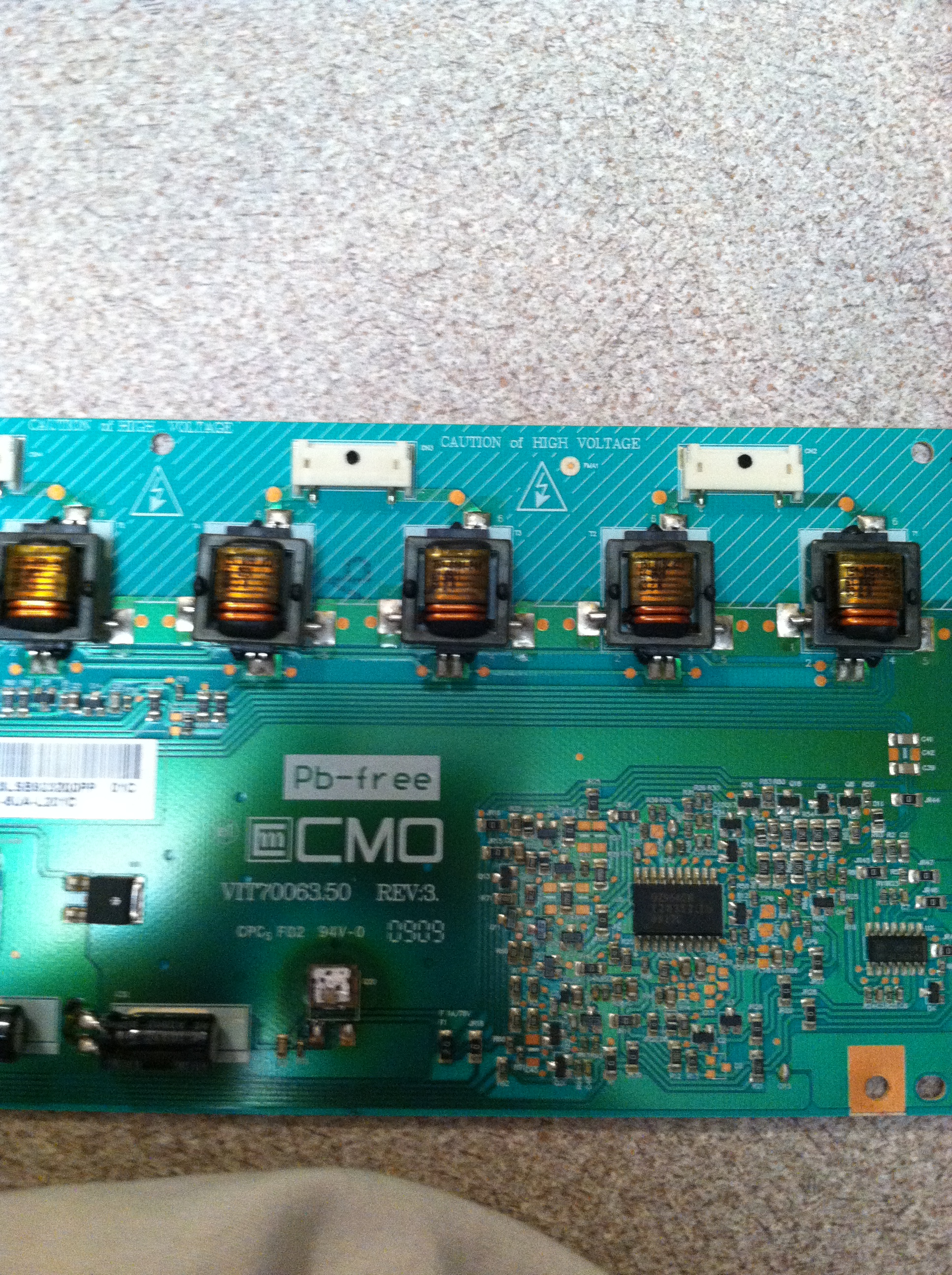

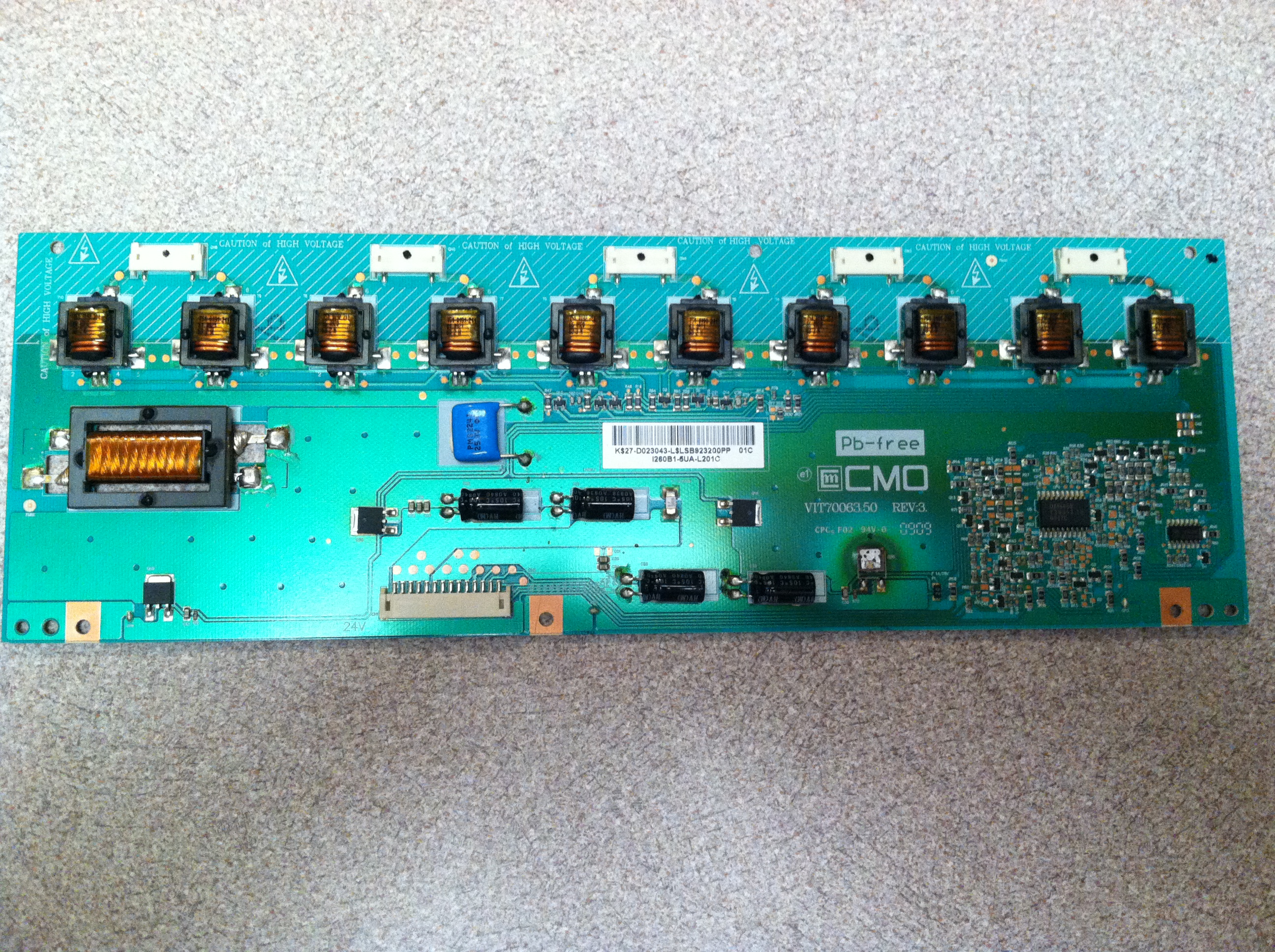

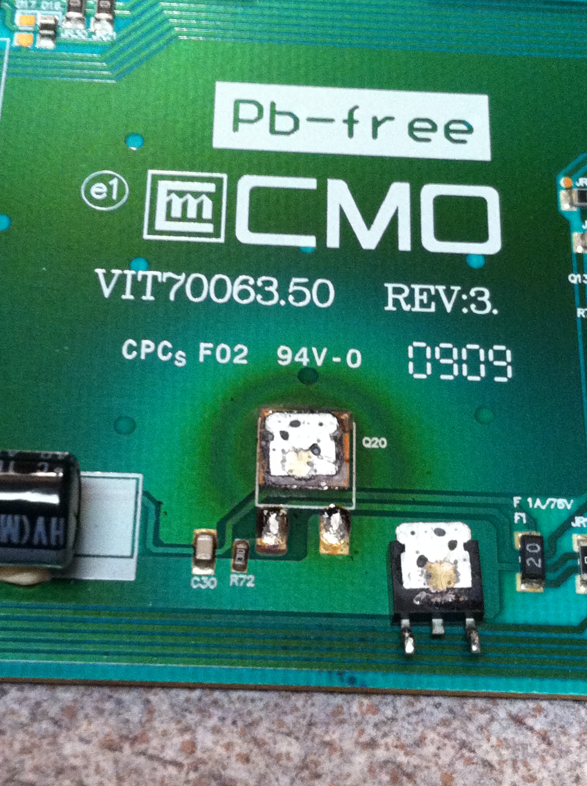

 Well I found the culprit on the back lite inverter board. Please see attached photos.
 Just need some quick info. How would you guys (the pros) go about it?
 I was just going to order a new transistor, try to clean up the crap burnt on the connection and hope it works. However I did test continuity with the transistor off the board and it was good.
 Any thoughts or ideas? How would you clean the burnt stuff off?
 Would you buy a new transistor?
 Thanks for any inputComment
 Burnt out power MOSFET like that should have blown the fuse on the inverter board also.
 And you do not have the cables from the power supply board to the inverter board connected, do you get >360VDC on the filter cap?
 Also show the picture of the whole inverter board.
 It looks like this one:
 http://www.shopjimmy.com/cmo-vit7006...t-inverter.htmLast edited by budm; 03-07-2015, 10:10 PM.Never stop learning
 OK, so now you do have >360VDC which I thought you have indicated that it stays at 160VDC.
 So fuse F2 on the inverter board is OK?Never stop learning

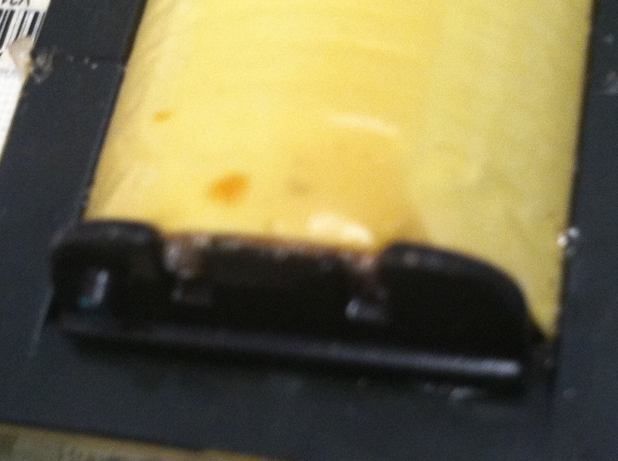

 Please read 1st response, I noticed something else but I don't want you to miss my last reply.
 Please take a look at these pictures. All but 2 of the 'transformers' solder connections the 2 prongs are separated. As you can see 2 of them are now soldered into one connection. I noticed it because one of the transformers looks like it was turned 5deg.
 Should I unsolder and re-solder with prongs separate right?Comment
 pin 2 and pin 4 are tied together by that big copper pad so that solder bridge on pin 2 and 4 do not matter.Never stop learning
 Well I finally got a new transistor and fuse in the mail. Only fuses I could order were 6.3a 160v. Original fuse was 7.0a 160v. I plugged in the tv, front light came on right away same as before. I turned the power on, front light changed colors, same as before.
 Still no picture, no backlight, no sound, nothing. Fuse is dead again. Power board is good, 24v at all connections. Something on the inverter board has to be spiking/blowing the fuse. Any ideas on where to look next?Comment
