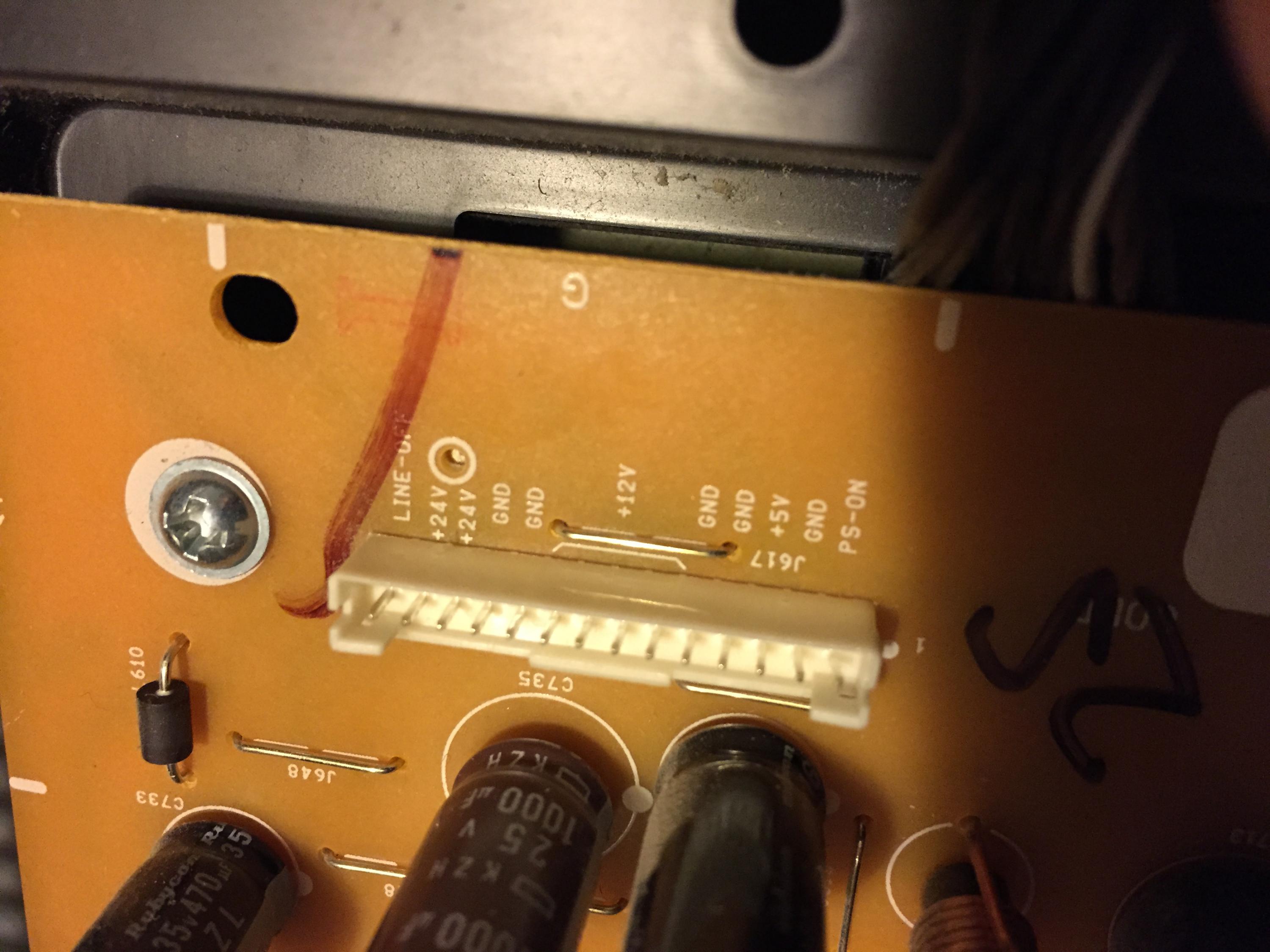

    Disconnect everything from the PSU and force it on. See what you get on the output rails.
    • johnboy1313
      • Nov 2012
      • 1959
      Re: Sanyo DP47460 On Then Back Off
      I tried that. It just clicks on and off over and over with no backlights. I'm not even sure I'm doing it right. I have a resistor between PS_ON and 5V. I don't see BL_ON on this PSU.
        I wouldn't frig with the main board until I can force on the power supply and it stays on. Do any of the outputs come up for a split second, or are they just 0V? Did you check IC602, the fets and diodes?
        • johnboy1313
          • Nov 2012
          • 1959
          With the main connected, all voltages other than 5V come up and then die. With the main disconnected, I get all voltages on the connector J617 for a second and nothing on the connector to the inverter.

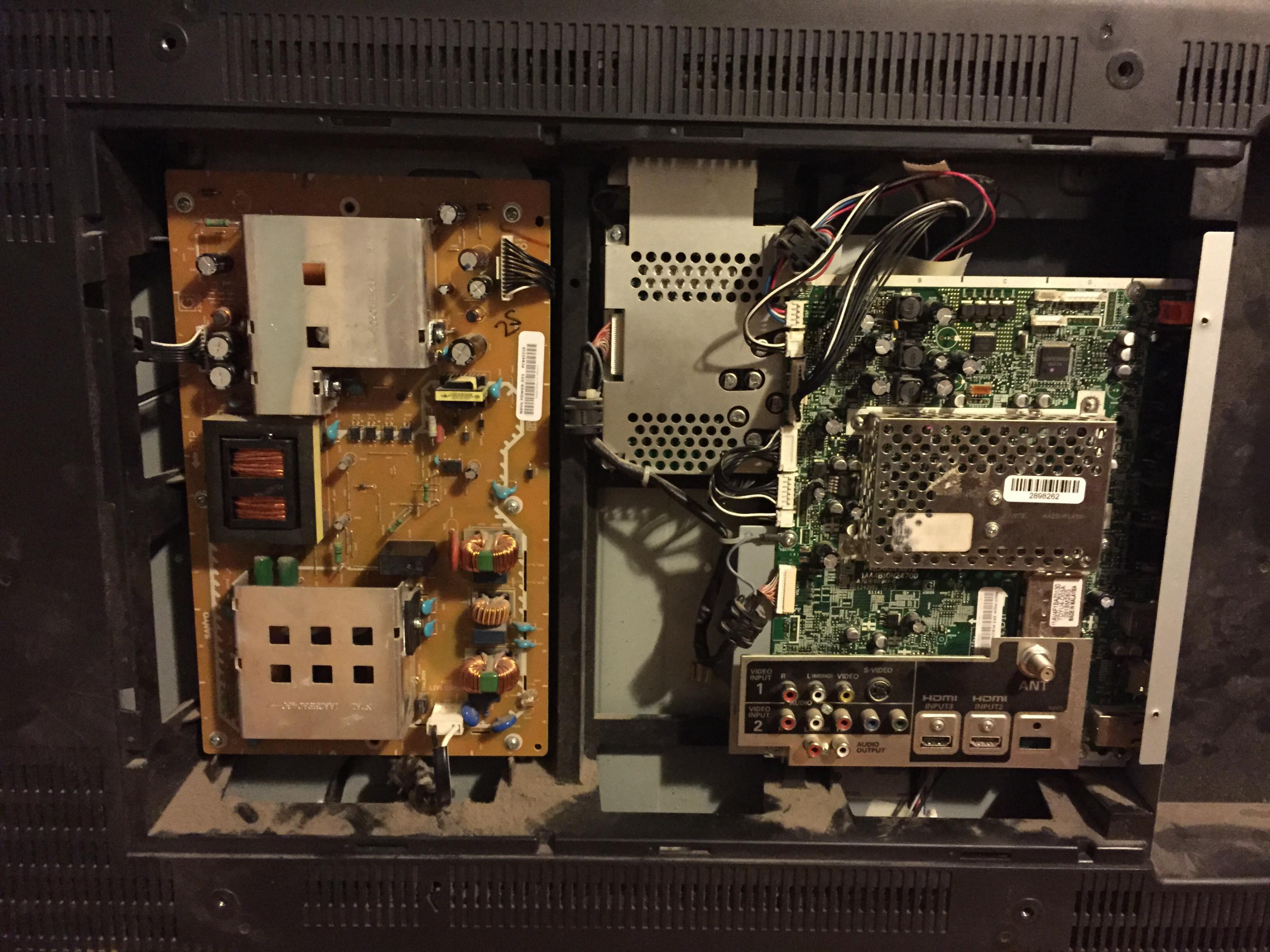

            Can we see a pic of the back of the TV with all board connected?
            • johnboy1313
              • Nov 2012
              • 1959
              Here you go.
                I guess it is one of these weird made TVs where is no BLon on the PSU itself. Here it comes from the main board. So... by right's if you force the PSU on, the 24V rail should be up as well, but the BL itself should stay off. So there must be another switch on the inverter that gets the BLon command from the main board. Uff. That is complicated. I am not sure yet, what that Line OFF pin does.
                With the main board connected, you said all the voltages but not the 5V rail came up. There is a power failure circuit. When the unit sees something not fit, it will shut down. I would poke around there and see if that is true.

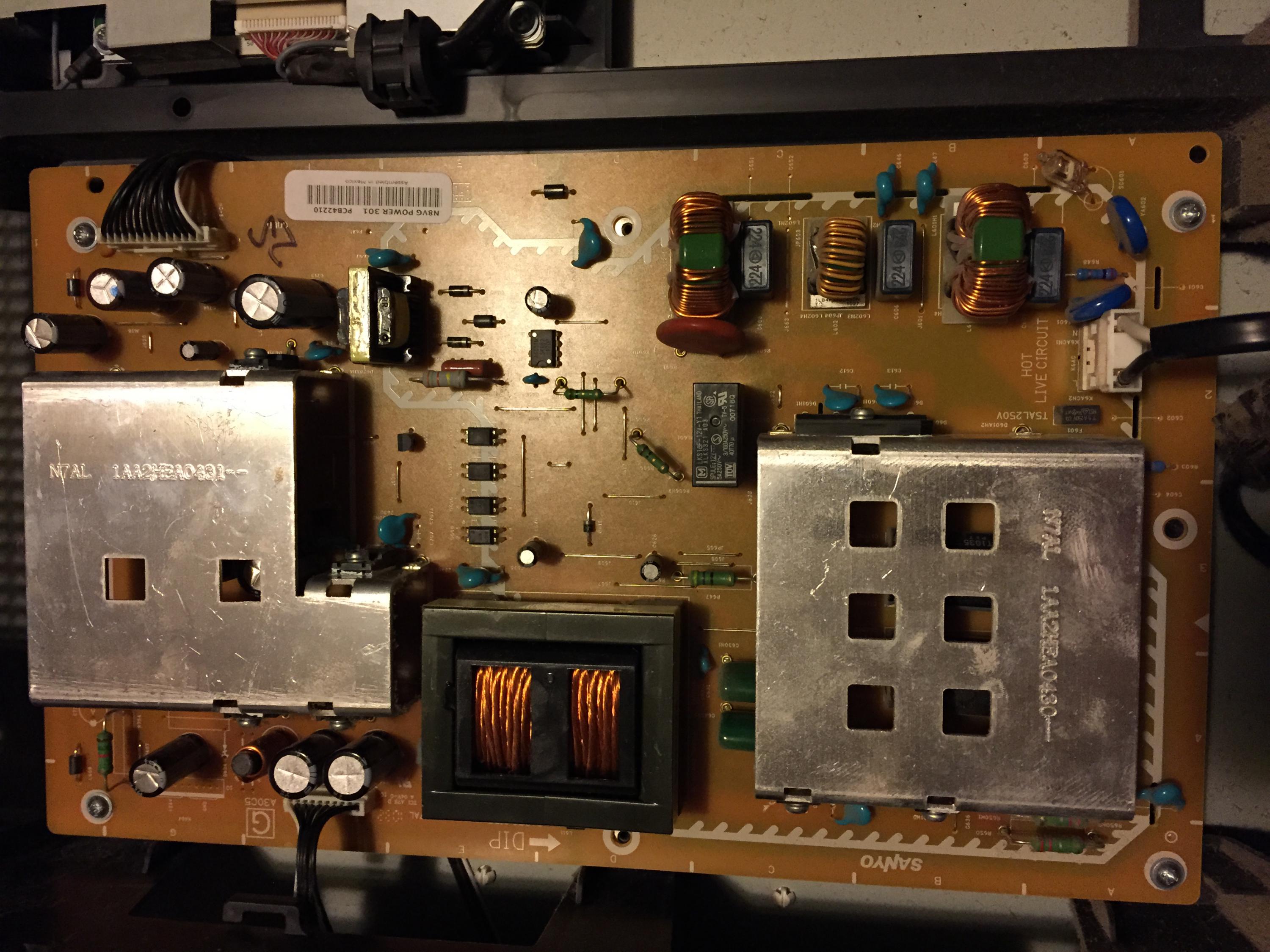

                    Have you checked all the diodes on the output, primary fets, and the pfc are all running ?
                    Also could you take pictures of the Ic that you replaced ?

                      No, I haven't checked any diodes or FETs yet. PFC seems to be working. Main cap jumps from 170 to 390 while it's on. I didn't replace the IC, I removed it and reinstalled it once I found that the fault continued.

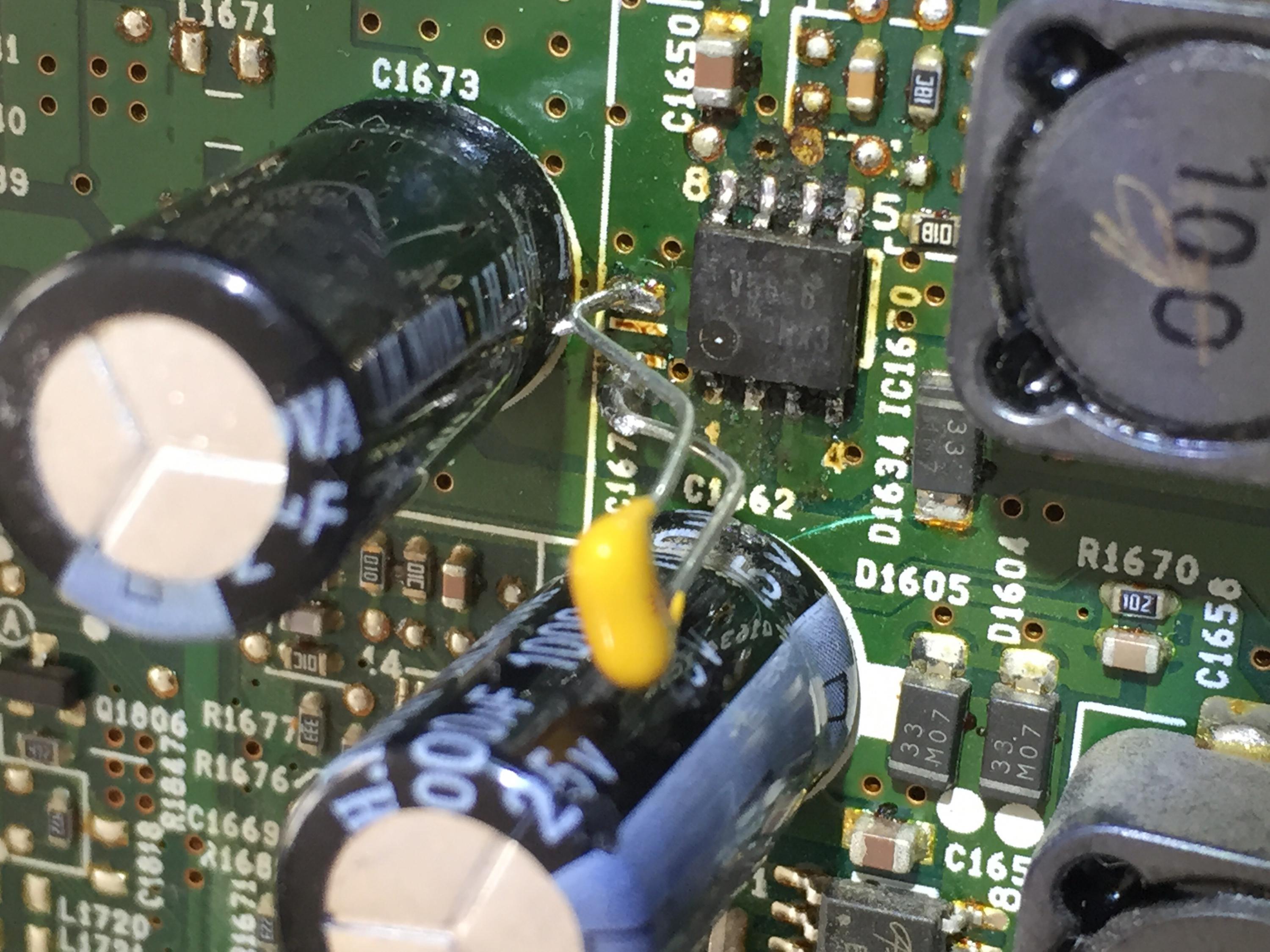

                                    So now the backlights aren't coming up at all anymore and the PFC is not working anymore. The relay clicks just like it did before. Then it clicks off, just like it did before but no PFC or backlights.
                                    Here's that pic of IC1670. The 1uf 50v cap at C1676 came off when I used hot air on the chip. I didn't see it come off. I replaced it with an extra I had from the last Panasonic I fixed.

                                        So non of the voltages still dont come up, just check the soldering on that chip no offence but it looks a little rough.
