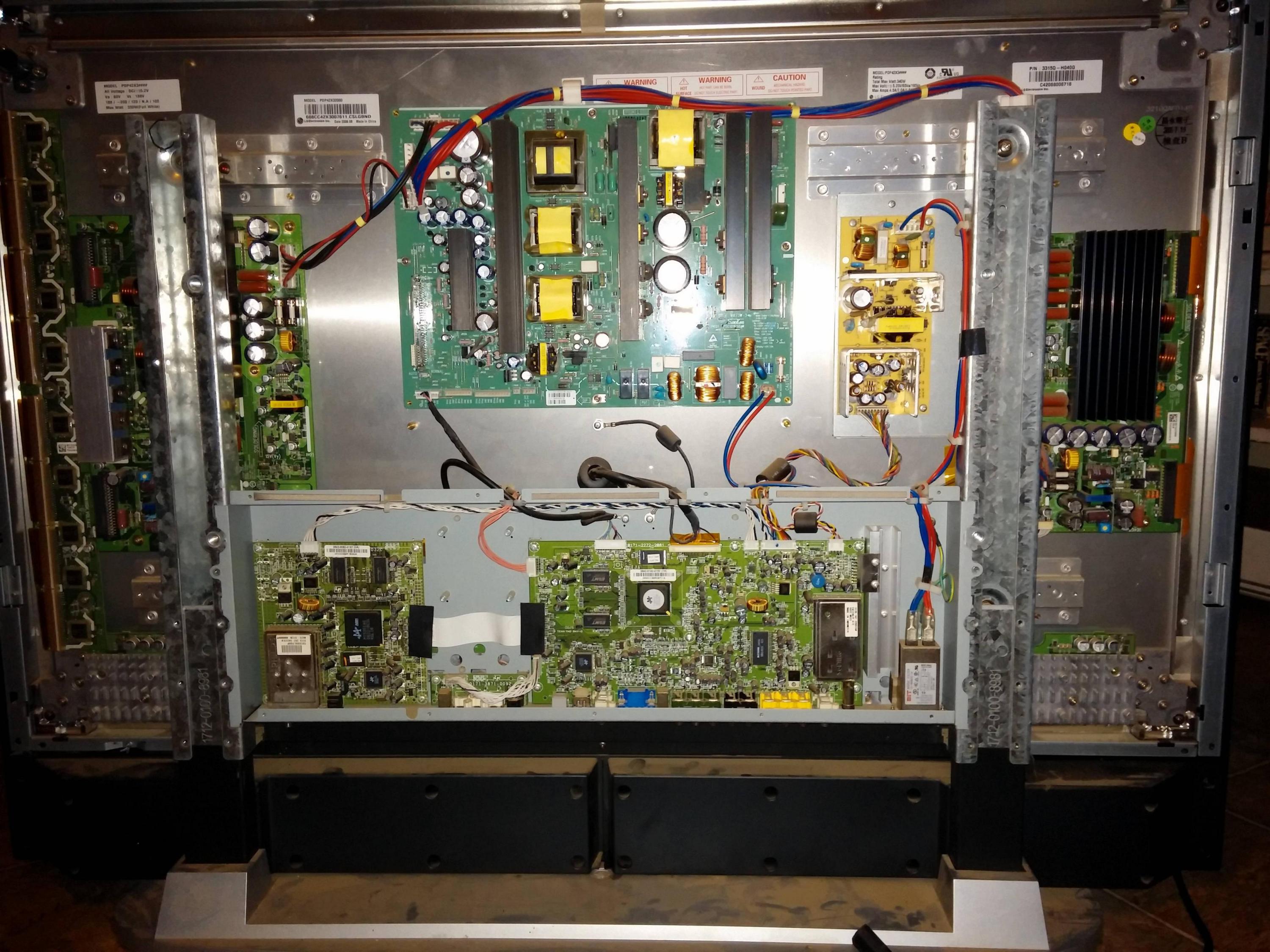

                Unplug all power wires from PSU to X & Y boards, leave all others plugged in. Try to turn on and see if VS will stay on at listed volts on panel sticker. If it does then plug X board in and turn on to see if it stays on.
                If it stays on X should be good, do the same for Y.
                Without Pics of your setup it will be difficult to help you diagnose.

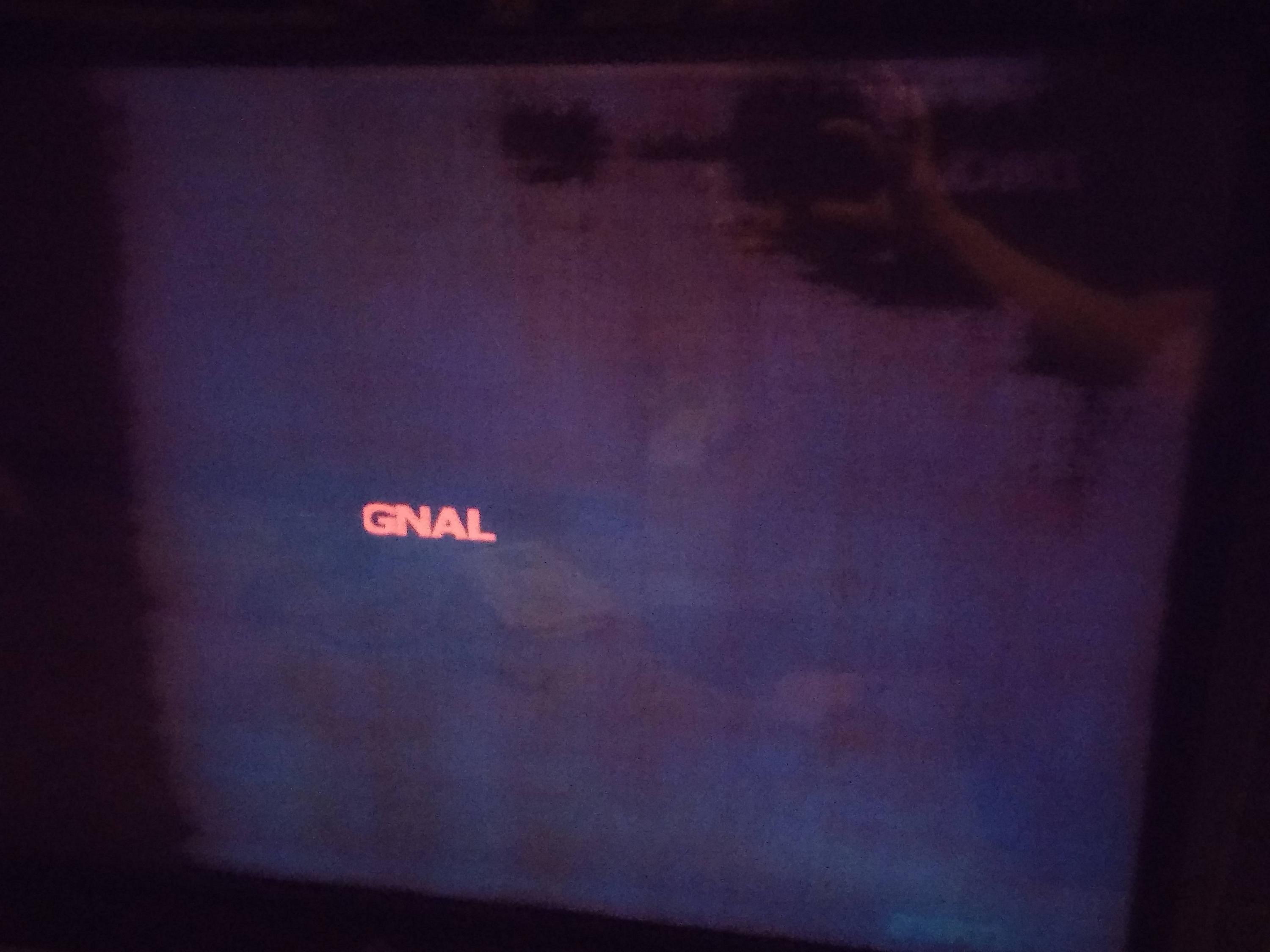

                  Re: Vizio P42HDTV10a power no screen
                  I got a picture without the right board plugged in, i believe it's the Z-sus board. Screen came on and said GNAL in the middle.

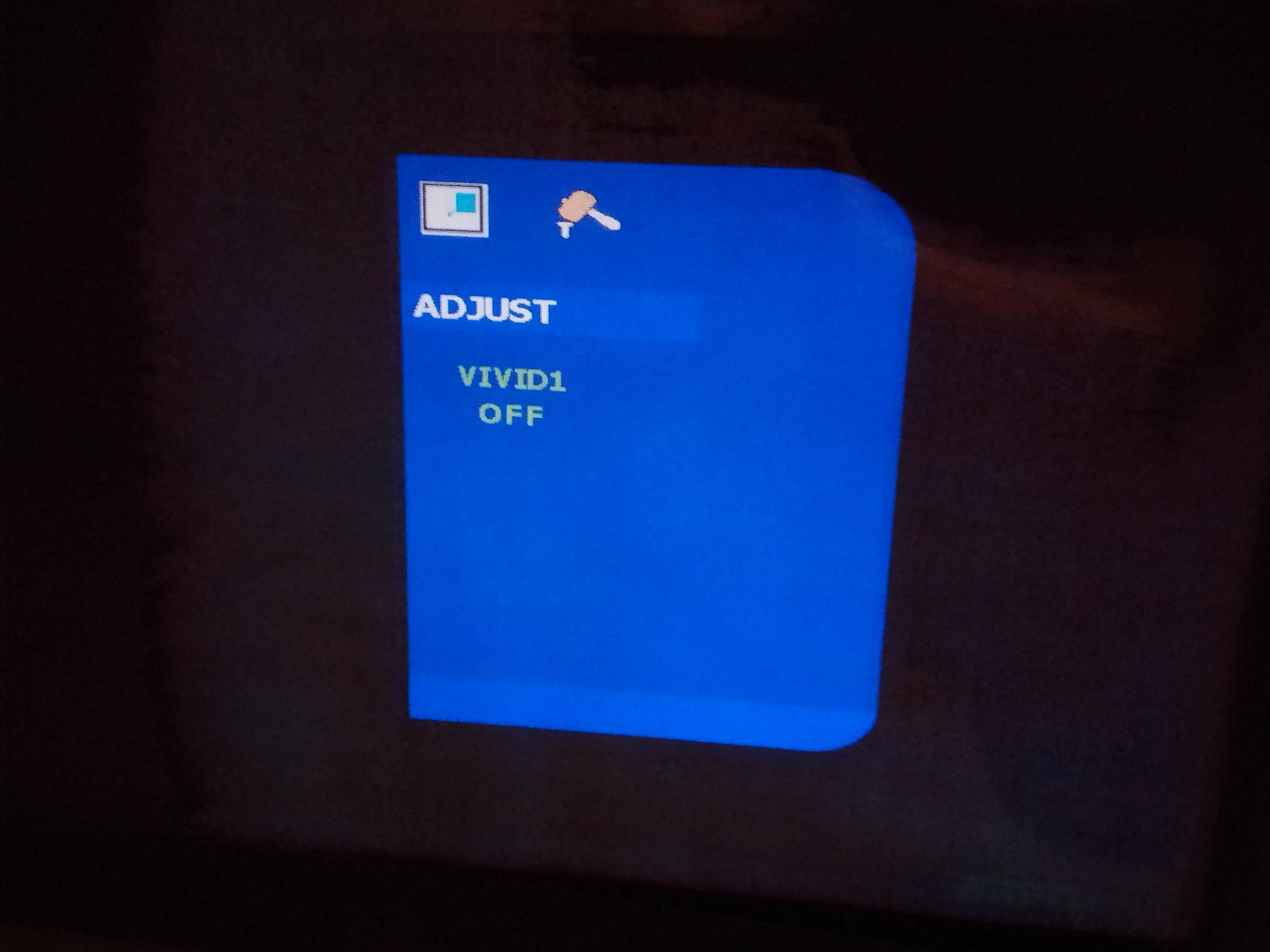

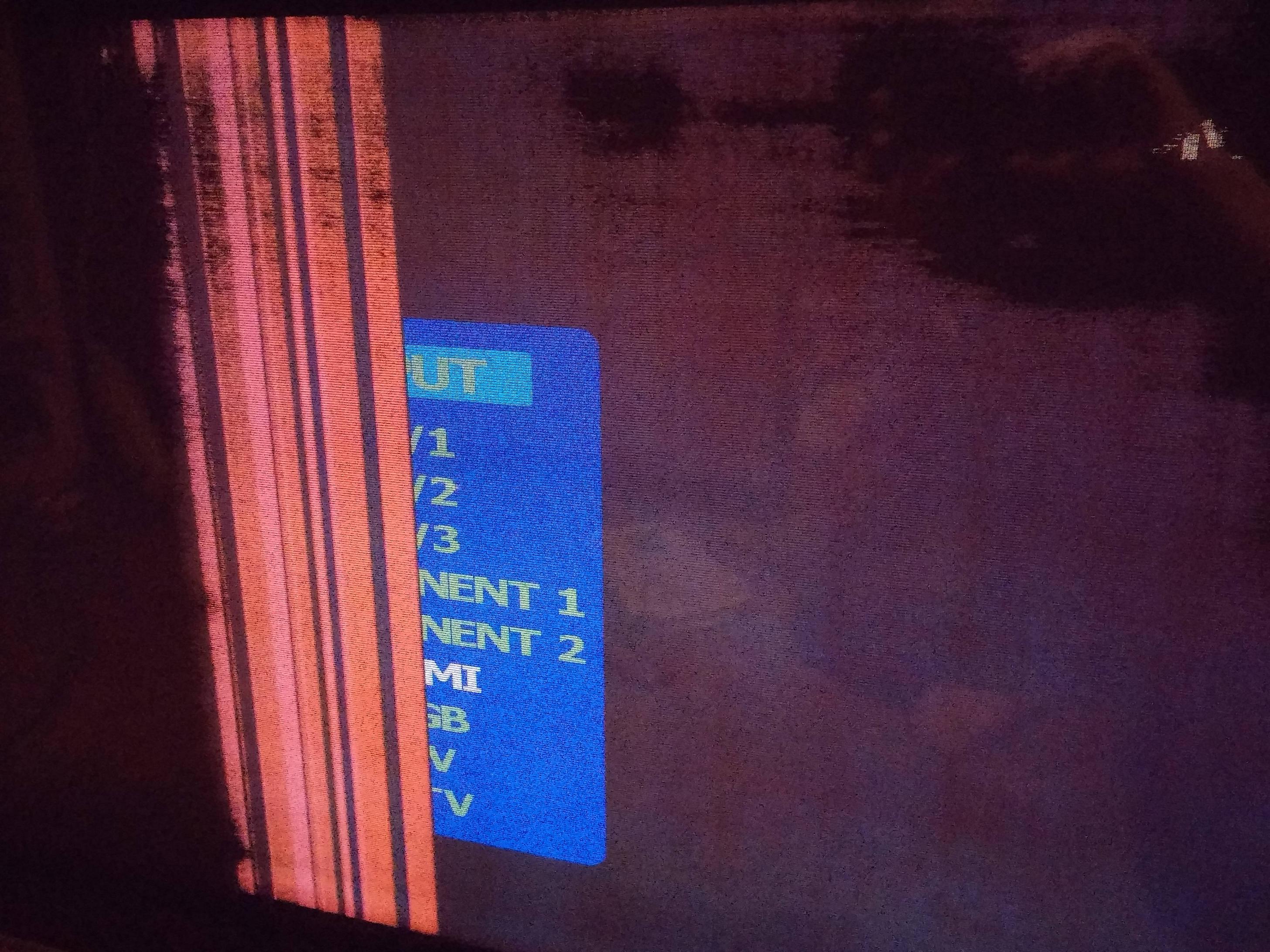

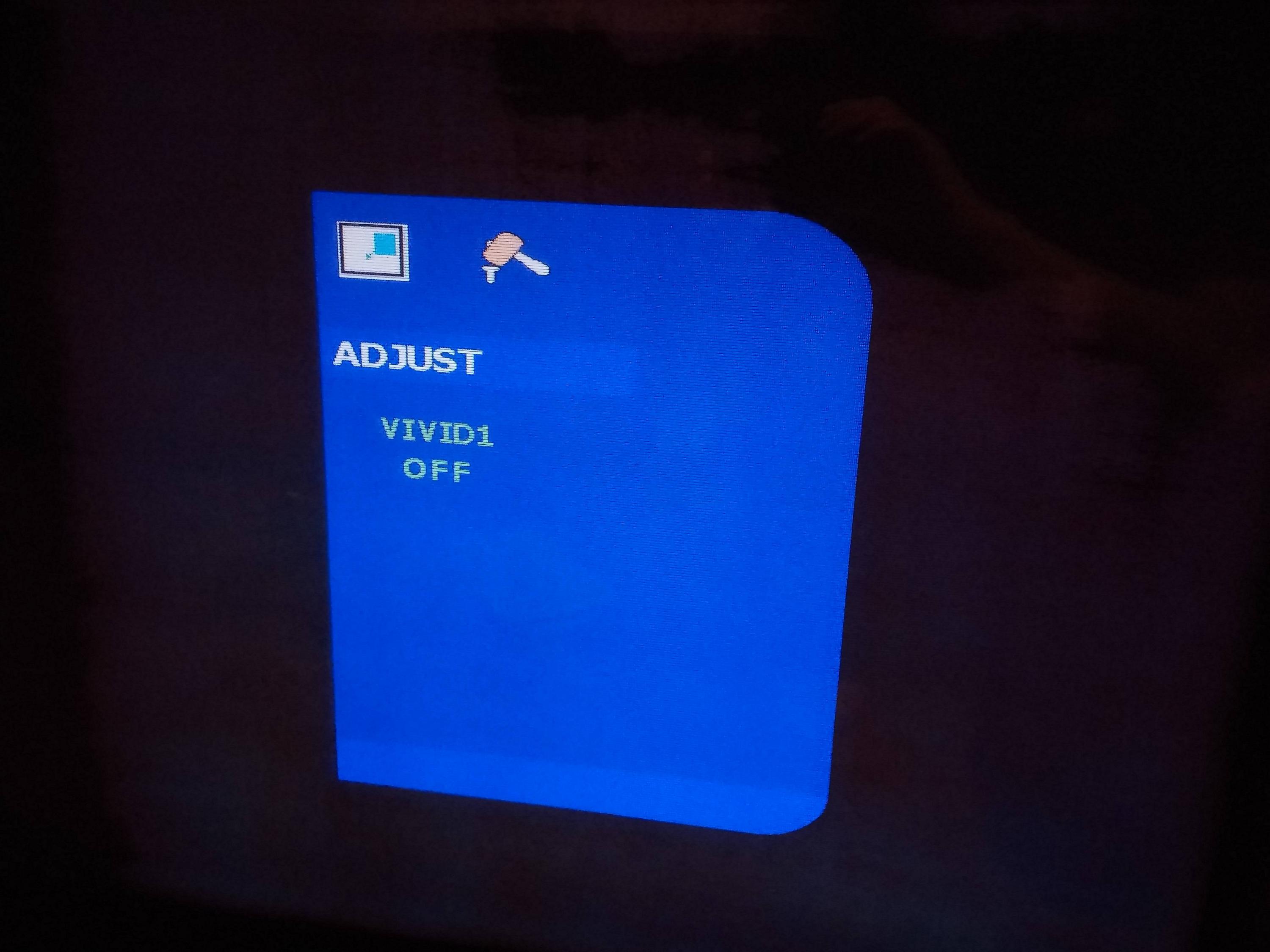

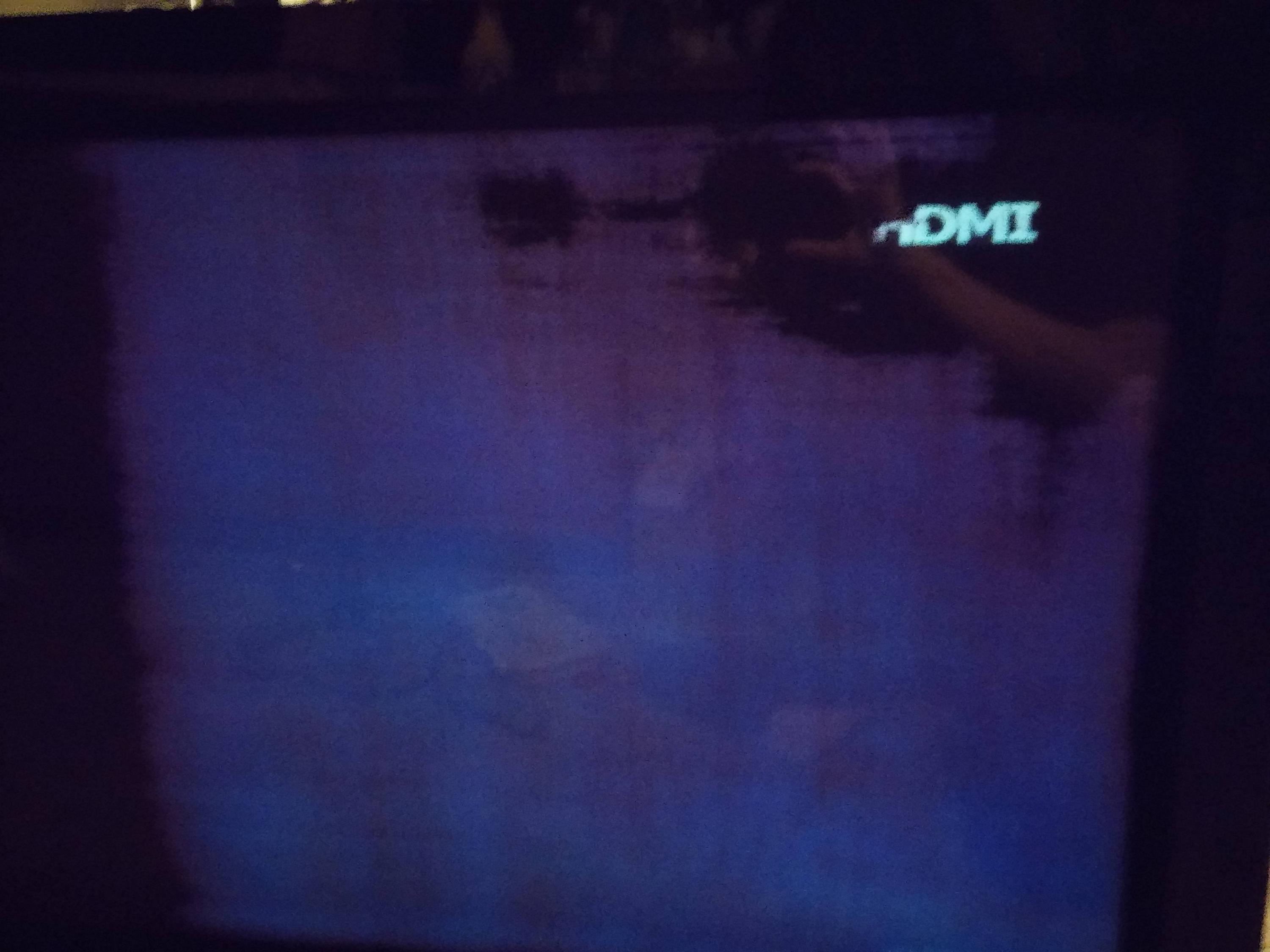

                        Can you post pics of the TV's picture?
                        LG Plasma Mal-Discharge Correction Service
                          Here are several pictures. I hope these help! The longer I leave the TV on the more Red lines appear!
                            So it will stay on with X board disconnected. Something is wrong with X or buffers. If reconnected it will not show a picture?
                            Looks like an IPM might be bad. Take X out and check the power pins to ground to see if it's shorted.

                              I'm told that's the Zsus but yes it turns on and stay on with the board disconnected. Reconnect the board and nothing, it tries to turn on then some sort of failsafe kicks in and nothing.

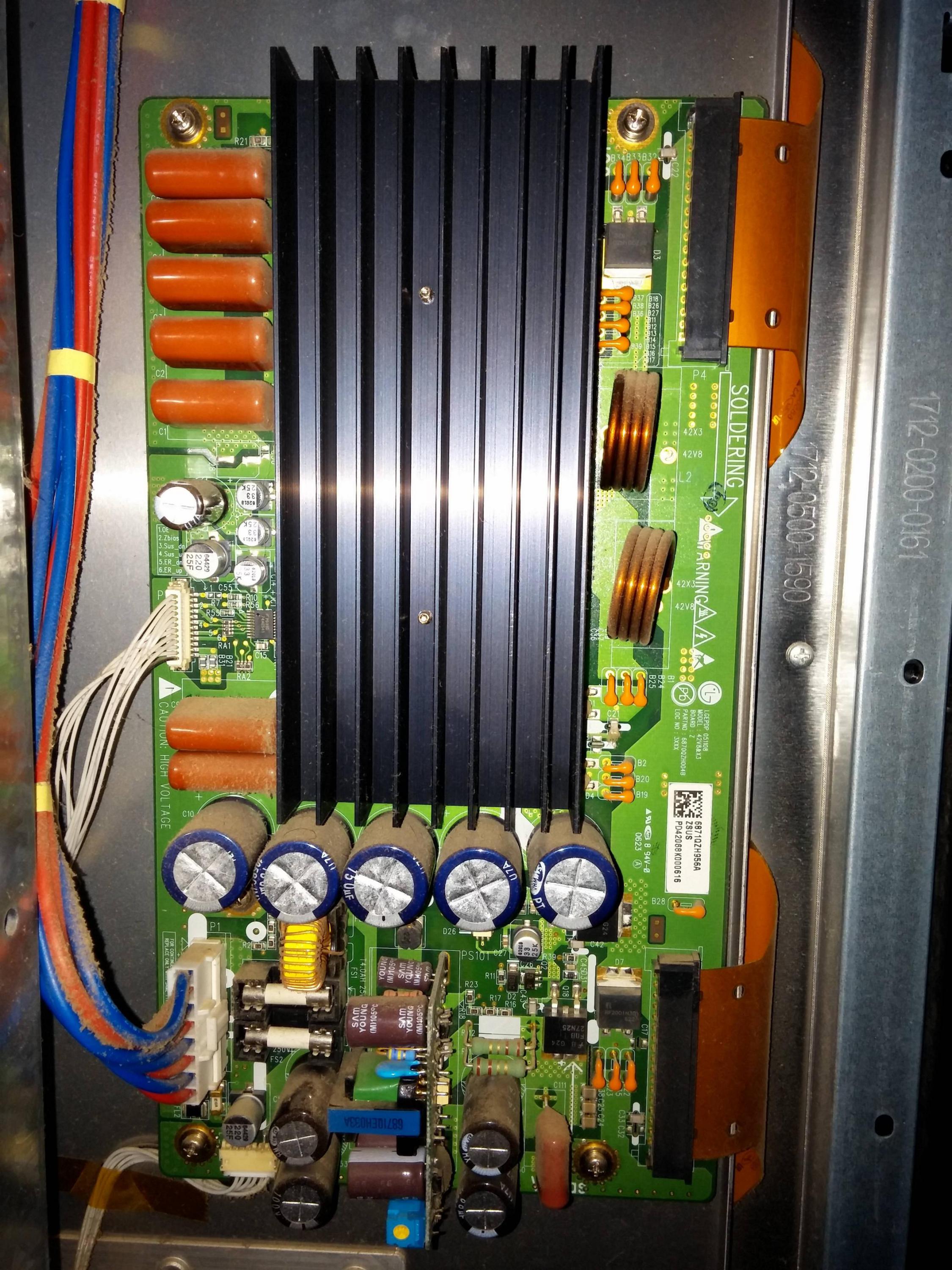

                                Yes, the board on the right is the ZSus. "X" or "X-main" is the equivalent in Samsung plasma TVs. Some people use the terms interchangeably, which can be confusing, since there are horizontal X-buffer boards in LG plasmas.
                                On the ZSus, you can check for shorts to ground on the IPM. Example: http://blog.coppelltvrepair.com/2011...m-for.html?m=1

                                  Ok, I couldn't figure out how to take the heatsink off. Tomorrow I will desolder the whole IC and test that way but i tested it on the board from the backside and got the following results:
                                  VS - GND is open
                                  VS - SUS_OUT is open
                                  VS - ER_UP_OUT and ER_DN_OUT are both open
                                  GND - SUS_OUT is shorted
                                  GND - ER_DN_OUT and ER_UP_OUT both shorted.
                                  SUS_OUT - ER_DN_OUT and ER_UP_OUT are both shorted

                                    Be careful removing the IC if you don't have a desoldering gun. In any case, I'd add a little fresh solder to the pins first.

                                      Can't figure out how to get the darn thing off without a desoldering gun lol. I can't find my copper mesh stuff that takes the solder off =( My heat gun gets the solder soft but i still cant seem to get the darn thing to move!
                                        You can't remove it without sucking up the solder - too many pins to heat. Also, the solder is bonded to the front side of the board.
