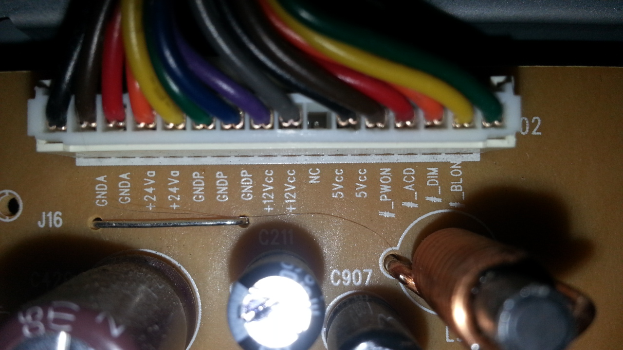

    Ok this set has had intermittent shut down with squealing sound and then not able to turn back on for a period of time but was working when I sorta dropped it a little No damage but I notice now the power supply will not turn on.
    I have working 5v Standby. Voltage at main filter cap is 170v. When I feed 5v to #pson there is no change.
    Should there not be 5v on the #acd (ac-detect?) pin as I have nothing there.

    Ok I'm pretty sure I should have 5v at #acd so how/where does that get generated ?

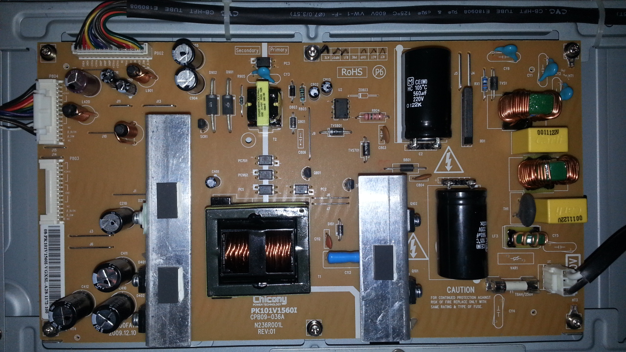

                    http://assets.shopjimmy.com/media/ca...1-bottom_1.jpg
                    Cehck the DC Voltage right at the two legs of C105 which is the filte cap for the VCC feeding the SMPS IC U101 for the 12V/24V.
                    The ACD sinal is used by the main board only, so you should be able to force on the power supply by itself to get the 12v/24v to run.
                    Please also get the P/N of U101.
                    The two main filter caps should have about 160VDC on each one of them, it is setup as the Voltage doubler.

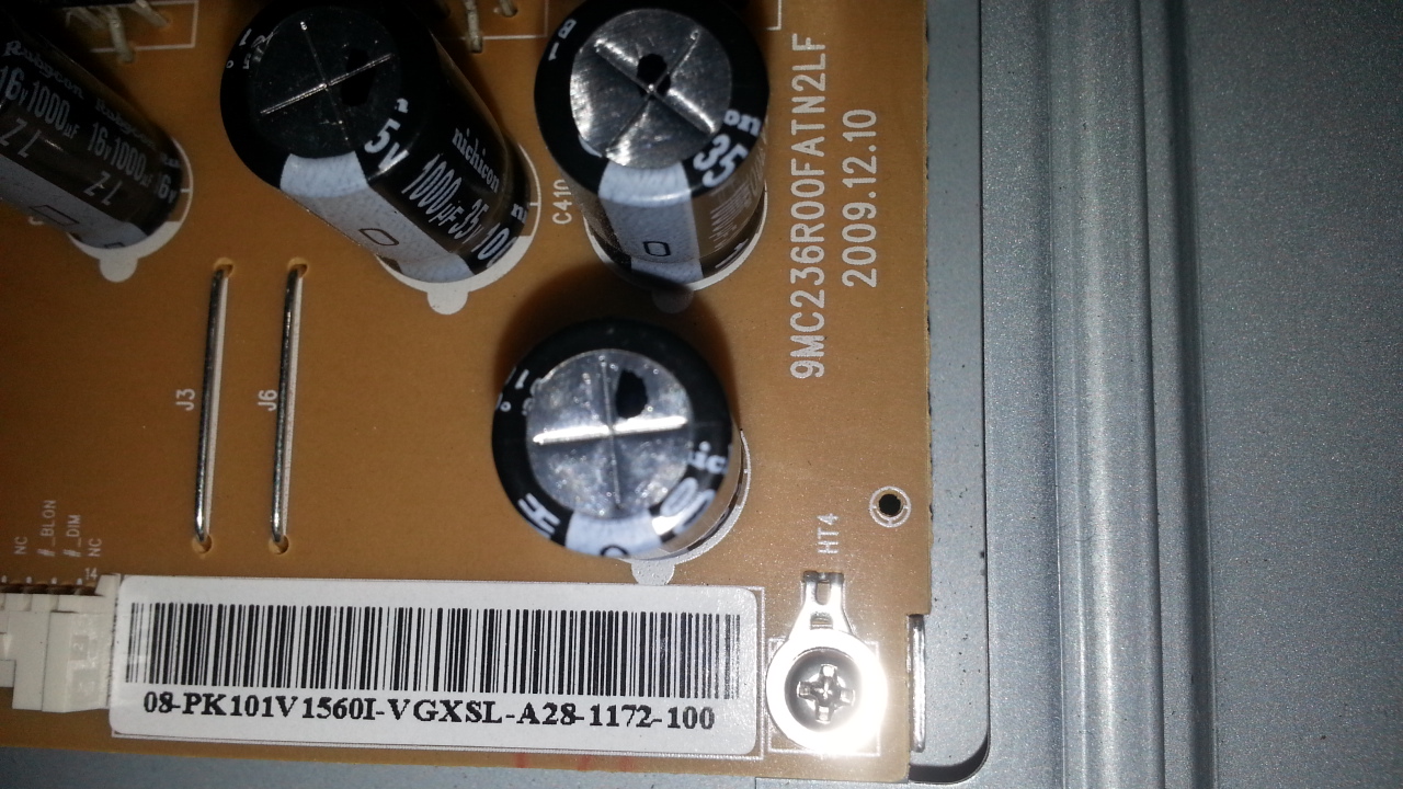

                        Hi bud, that is not my board.
                        My power ic is at U2, STR-A069. I have about 170v at both main filter caps.

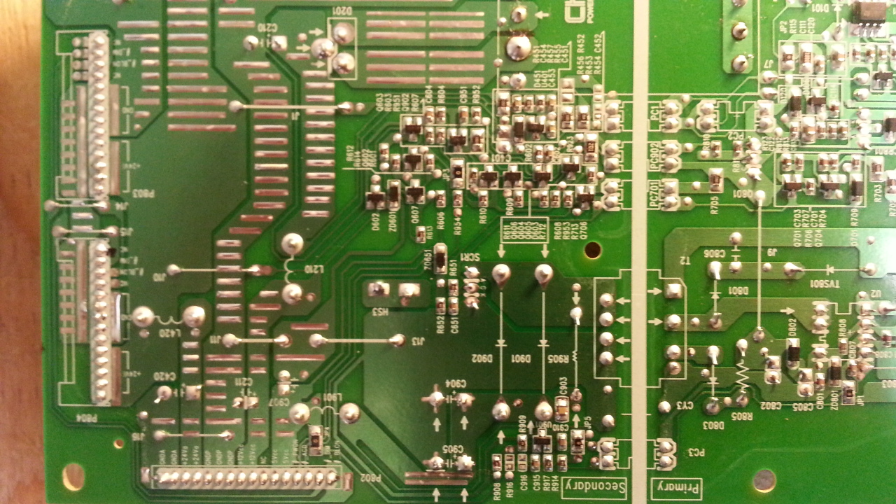

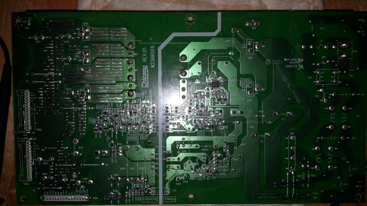

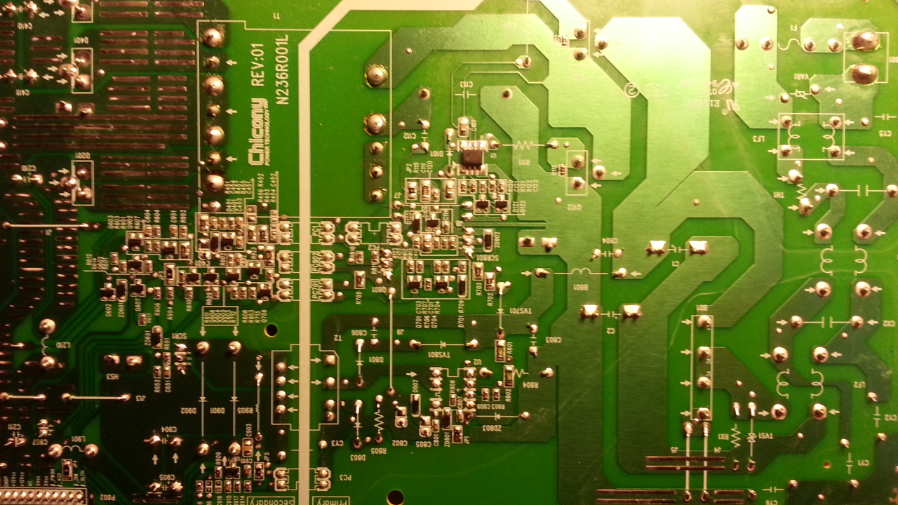

                          Here's a couple pics of the underside.
                            Re: Toshiba 40E200U1 Power Supply Not Turning On
                            Can I see the whole bottom side of the board?
                            It is funny that I typed in your board numbers PK101V1506I in SJ, the pictures do not match your board.
                              Ya I saw that too, maybe a different revision ??
                              Not at home now. I took a couple but they are not too good. I will post - maybe you can see something in them.

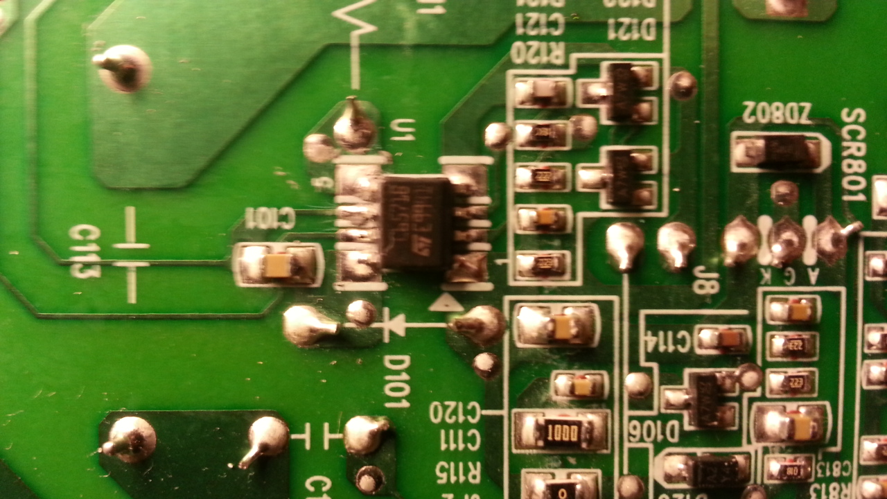

                                OK, we need to get the P/N of that SMPS IC (8-PIN) so we can check the VCC pin Voltage reading.
                                    L6571
                                    E9941
                                    Made by ST
                                      Freak you were %100 correct. Perhaps the #acd pin is an "ok" from the inverter because the backlights are on and secondary voltages are present by jumping #blon.
                                      And since you were right about that I suspect you are right about the bga on the main board. Will investigate.
