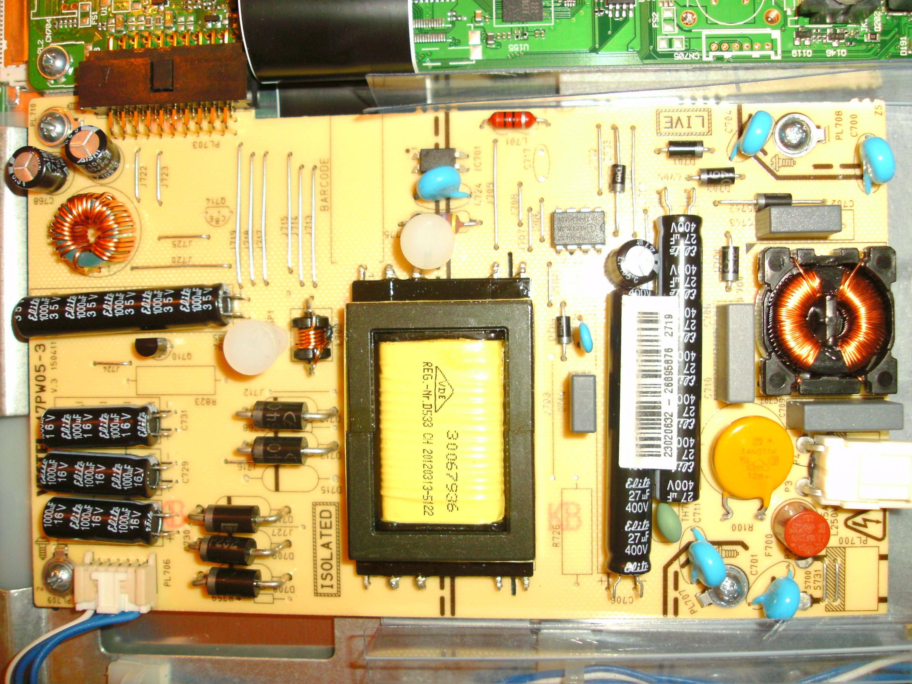

Will a SR506 diode work in place of an SB5100 diode? (Vestel 17PW05-3)
  • Dang
    • Aug 2013
    • 440
    As above, only thing I can see that's different is the peak voltage capability, the SB5100 is part of a series of three in parallel on a Toshiba power supply, thanks.
    Re: Will a SR506 diode work in place of an SB5100 diode?
    No good. Only 60V rated.
    Use: MUR460, HER308G, UF5408 as substitutes.
    (Must replace >600V, bad Vestel design exceeds diode PIV on startup leading to failure)

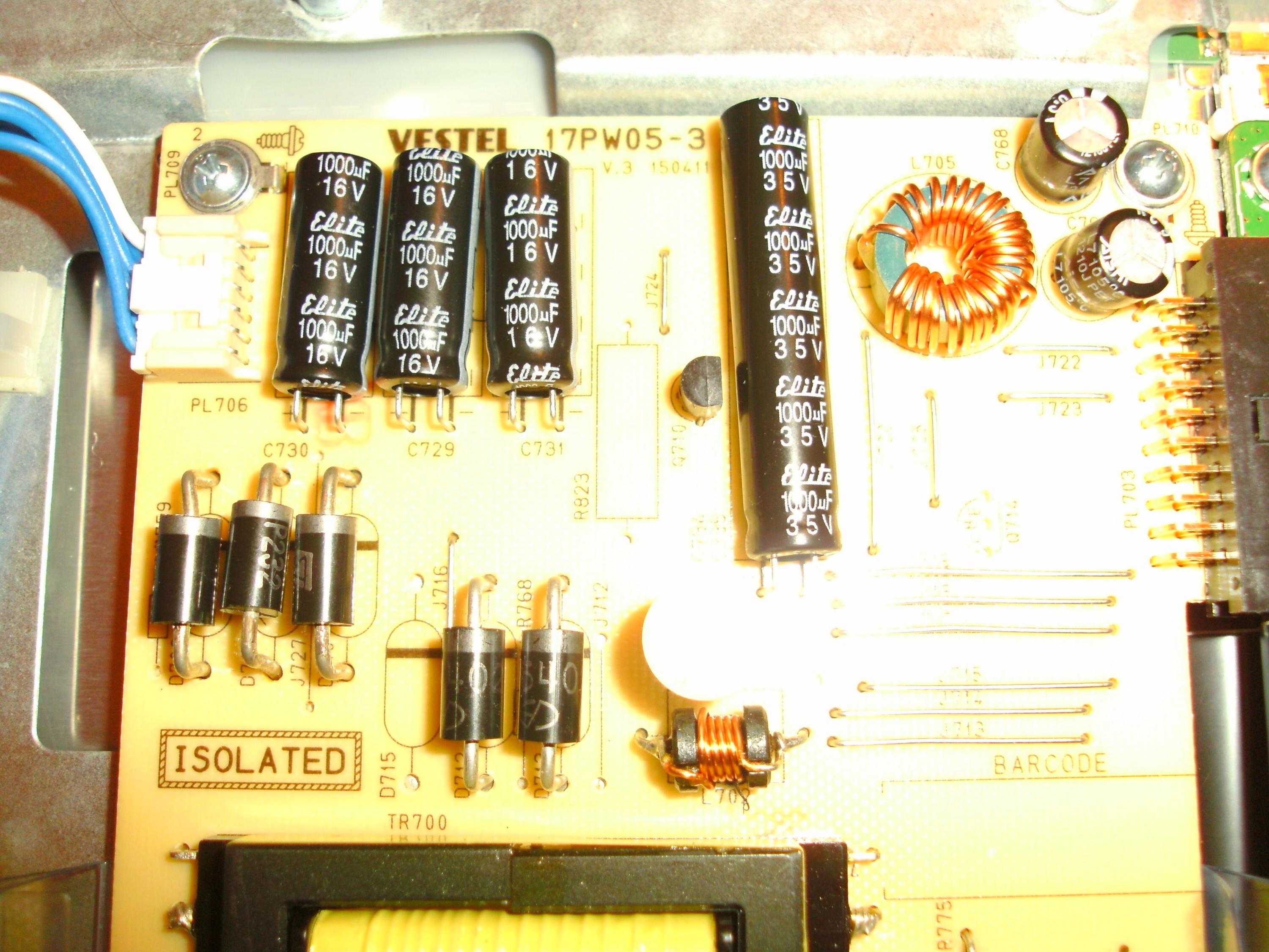

        One more question, the existing diodes have a 5 amp rating, I see most of what your suggesting are around the 3 amp rating, does this matter?
        I have three STTH302'S at hand, would these be OK considering the 3 amp rating?
          5 amp rating is Vestel's lame attempt to reduce power dissipation, realistically the current per diode is low (less than 1 amp typical), what's killing the ones on this set is poor voltage rating. So 5 amp or 3 amp or 4 amp should not matter.
              Well, it needed replacing and I now have a very small voltage going to the three corresponding capacitors, problem is it's 0.2 of a volt, just way to low. I have measured fluctuating voltages from various places on the board, especially in the HOT areas, problem is I just haven't got a clue as to what might be causing it, I'll get some photos up later with the voltages I see.

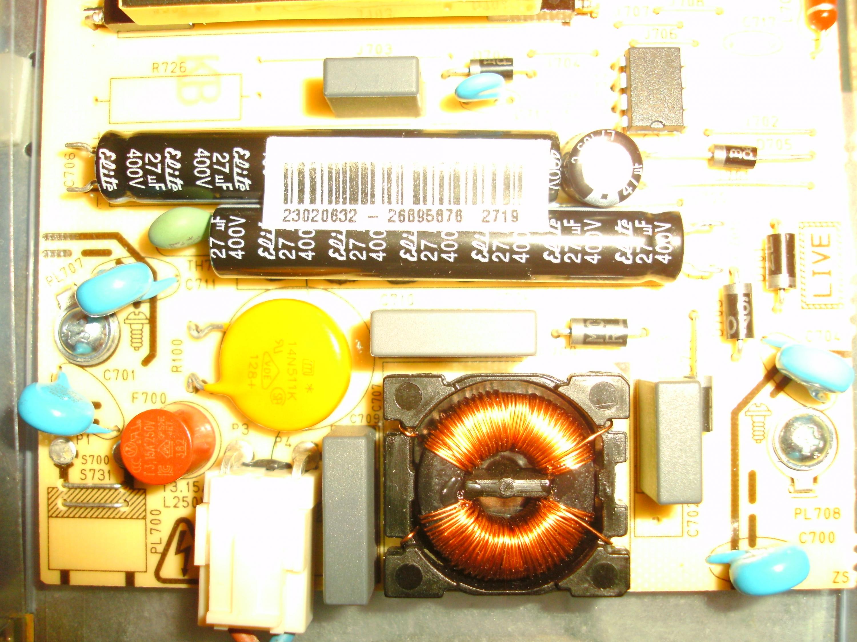

                  Here's a few photos I've taken, there's nothing obviously wrong with it that I can see although I have been looking on the net and a repair kit can be had for this failure, I just can't source any information as to what these components are???
                  I've found a thread where you(Tom66) express an issue you had with an Hitachi, problem sounds similar to mine, did you ever find out what the cause was?
                    Any ideas on what's in this kit as I'm stuck with this one? I guess I'm going to have to start pulling off components and testing them that way.
                      I only know of shorted diodes being a problem. Who knows, could be bad standby controller, startup cap, or something else entirely, you'd have to test.

                            I seem to have got to the bottom of the problem, at least very close, I can get the Tv to power up but only if I leave out the screws and lift the PSU up slightly, seems it's something to do with the screw hole very near the Varistor, I did test the PSU out of the Tv completely and found all voltages were there, it's only when screwed down that it shows no power, so my guess is it's an earthing issue, seems to short it out some how, does anyone have any ideas on why that may be?
                              I would suggest cold joint - you are flexing the board.
