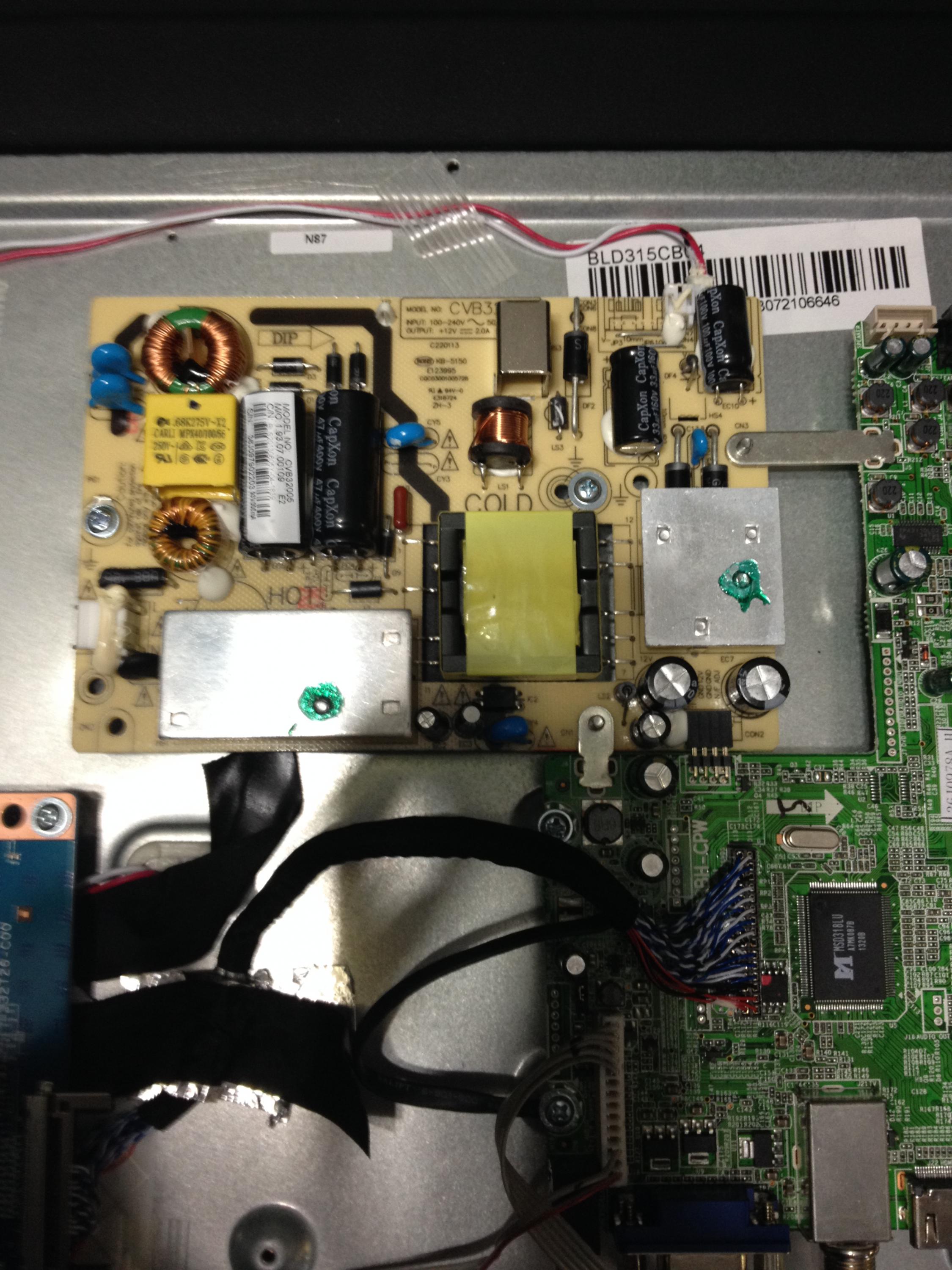

    Got this TV from an appliance store with five others. This one is a lot different from what I am used to board wise. Pretty cheap looking. Anyway I think the LED's have a problem so before I rip apart, just wanted to get another opinion.
    Got Red led on front when plugged in and blue when power pushed and voltages come up but don't know what voltage should be going to LED's. I am getting 69.7 volts out to LED'S and panel appears good I can see the "no signal" display when I shine flashlight on screen.
    Never been into the led area and it appears the tab bonds are on the bottom and it looks like the tab boards are stuck to back of TV shell with double sided tape? No screws any where. Anybody else been into one of these? Thanks

    Re: Seiki SE32fy22 no backlight
    There is a separate thread about this the leds themselves would have failed unfortunately, common issue with these panels.

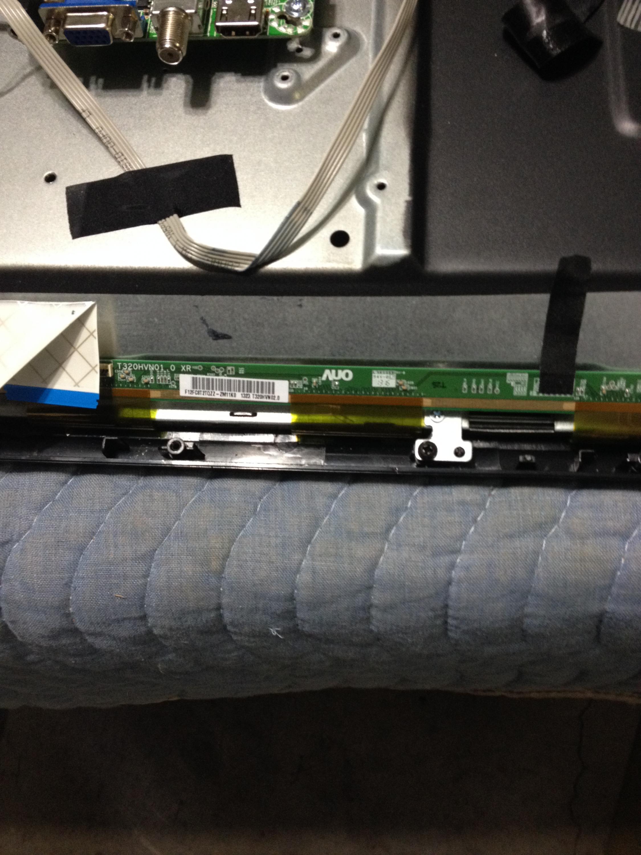

          yes the boards with tab bonds were just stuck with double sided tape so here we go.
            Your welcome, use a heat gun and heat the case so that the tape loosens and you can pull the case away with out damaging the tabs.

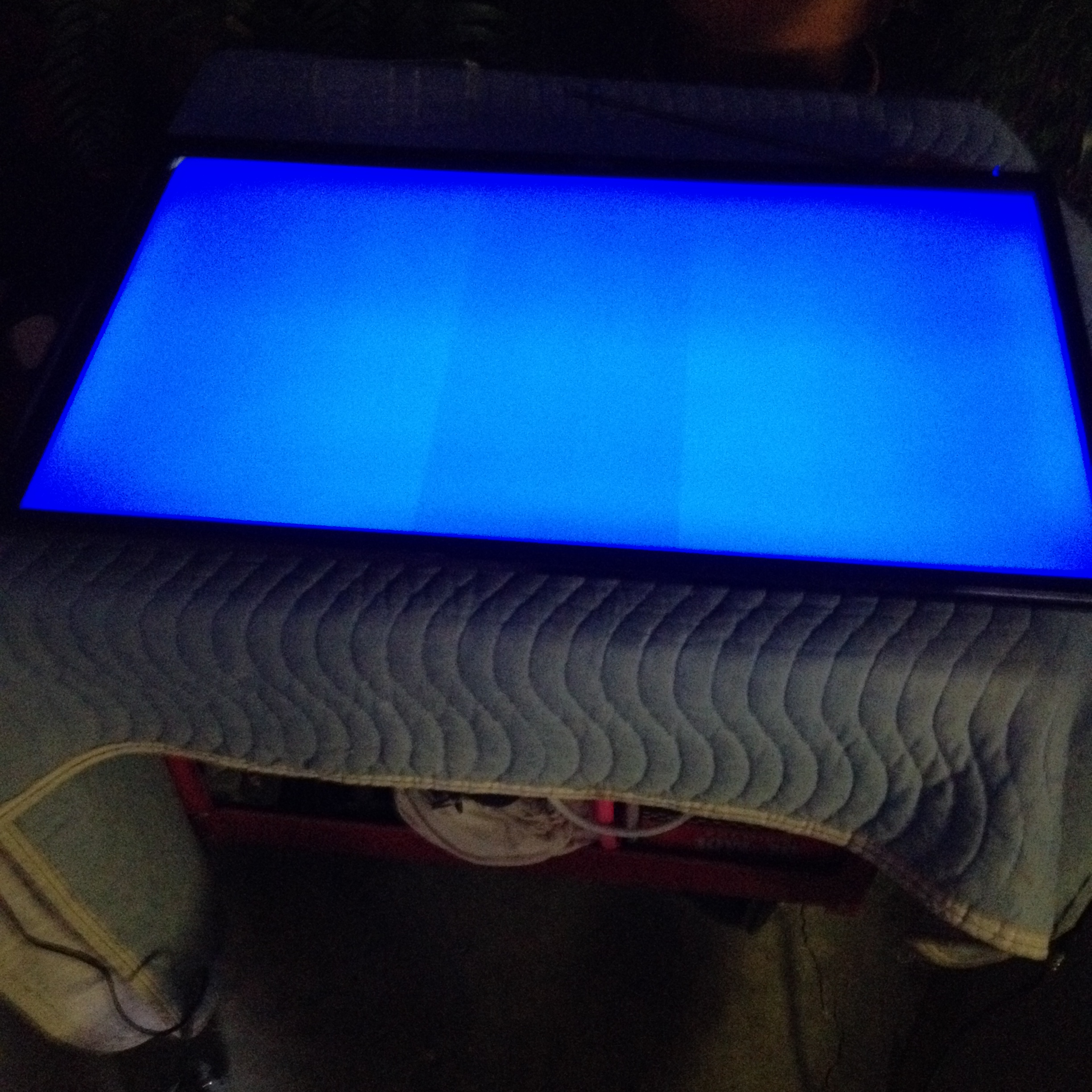

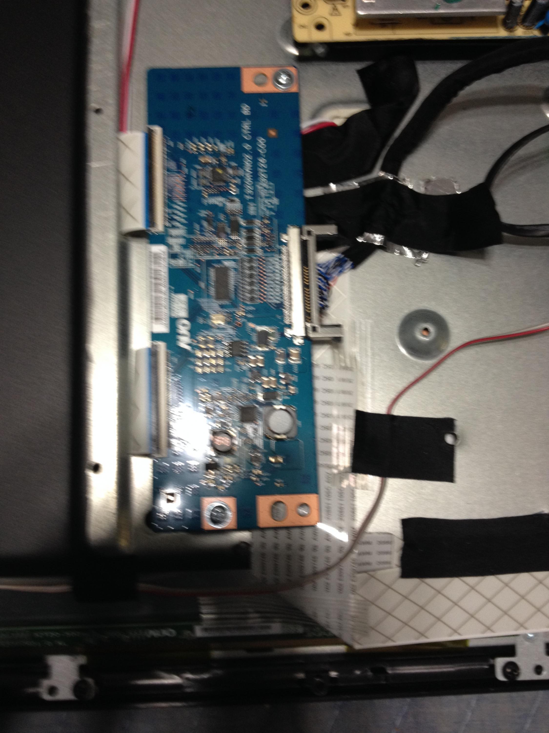

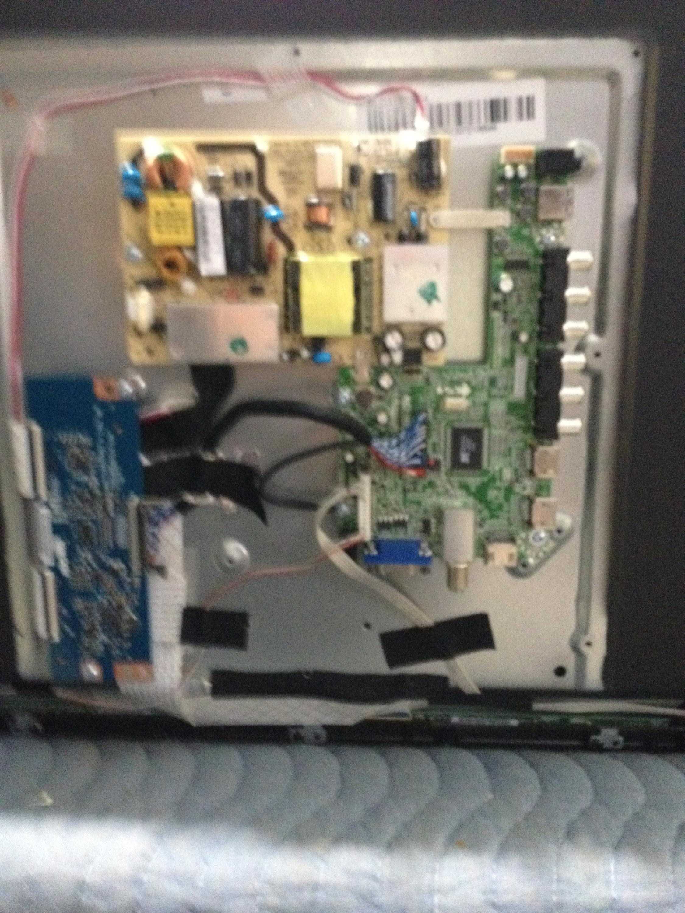

              well, I guess I screwed the pooch! Found the problem and was very careful with panel and tabs, but I guess not careful enough.
              Got down to the LED's and it was loose connection on bottom strip.
              Went back as careful as could be and now this is what I have? Double checked T-con connections, etc.
                Hmm looks like a bad panel or tab issue, maybe it got damaged when you took it out unfortunately
                Have you got a remote you can try doing a factory reset, or if you have another mainboard try swapping them around to be sure.

                  Took front bezel off and found bottom right corner has chip in panel so it is toast.. Will be more careful in the future. Terrible it was a new TV with just a loose connection on led string. Thanks for the help.
