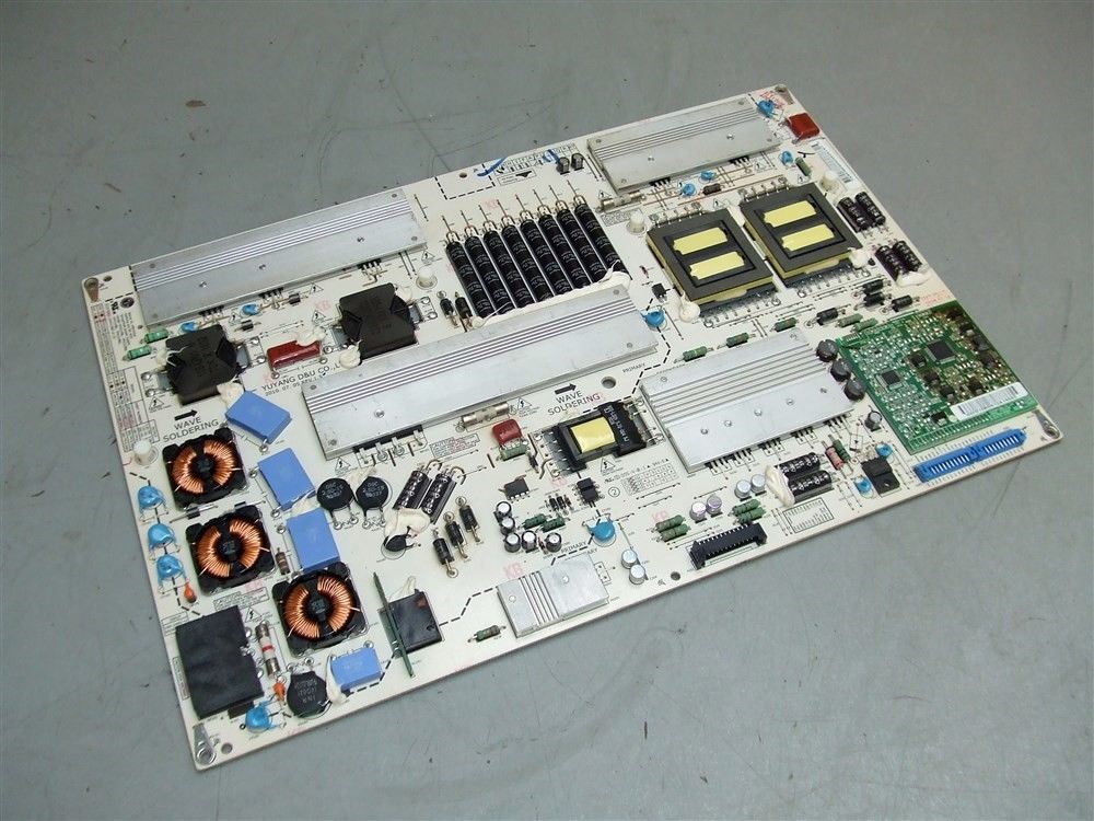

    LG 42LE4500, Int No Backlights...
    Seems to be a common fault with these sets, Backlights failing after a few minutes, then after a while, 2 sec to black....
    Ive one of these sets, and have traced the fault to the LED Backlight Driver-board, which sits on the main PSU board--Its the small green one.....
    It appears the controller IC on that board is faulty.
    As a test--I pulled that green board off the PSU and checked to see if the main LED supply was still present--It was, although low at 79V
    For a larf, I rigged this low supply direct to the LED strings.
    The set works!--BUT has a dimmish lack-luster picture.....
    --IF I could now alter the feedback loop to get the voltage to 100V (The correct value) we be in business!

      It looks as though the LED Driver feeds back to the LED main PSU on the PSU mother-board, and depending on that signal, adjusts the voltage supplied out to the LED driver board.
      Maybe its possible to fool the thing into giving a more appropriate supply to run the LED's closer to the correct brightness,--and to hell with that complicated and daft unreliable LED Driver....
      Early testing indicated that the LED strings have 100V across them--when the set was actually working as intended, although the notation on the board indicates only 89V at 900mA
      --It all seems WAY overly complicated to effectively just light up a string of LED's--My Christmas-Tree lights ain't complicated--why should this heap of junk be!!
      Unfortunately--As with all LG sets, the PSU schematics aint available, so its a case of fiddle and see, thankfully the LED PSU seems fairly simple, and is a sorta duplicate of the other multi-rail supply on the board, the chip looks the same so should be able to do summit....

            Re: LG 42LE4500, Int No Backlights...
            I hear ya Tom--But!
            This set uses an entirely different stage/transformer for the 'small' supplies, and a separate regulator/switcher/double MOSFET and transformer from the 300V reservoir lytic...
            Basically, There's two independent stages, one for everything else and one for the LED supply.
            I think messing with only the LED one shouldnt affect (As its not in any way connected to as far as I can see) the other supplies....
            --Still need to get back to it, maybe later today.....
                Absolutely Certain!
                The 100V LED rail is generated by a tiny--sorta surface-mount type transformer, having Mylar print coils, that sits in a hole cut in the board and has a full wave bridge-rec on its output.--Gets damned hot too--even when the set is 'normal'
                --The Other transformer--for what its actually doing (Supplying everything else)--is huge!
                I tried in vain 'frigging' the feedback to the controller chip, no matter What I did around it and the two Opto's all I could ever get was 73V--or no function of that stage at all.
                I changed tack and re-fitted the original LED Driver-board, but left the Output side thats connected to the LED strings disconnected and retained my additional wiring on the earthy ends of the strings attached to the neg of the 100V LED de-coupler caps/bridge-rec.
                I also disconnected the 'Err' pin from that LED Controller board and the 'FB' pin that seems to go via some trannies etc to the opto's.
                This left the set driving the LED's at 105V when first initialises then 73V after 5 seconds the 'FB' pin going to from 0 to 2.5V at the same time.
                Through a 100 ohm, I attached the 'FB' print on the mother-board part of the PSU to deck.
                --This gave 105V continuous to the LED strings which didn't drop.--105V is Too Much, so I used a 12K resistor from the 'FB' print to deck, which gave 85V dead on and a nice bright picture. PSU 'nominal' on this rail is 89V so I'm happy leaving at 85V
                So--Conclusion--to Potch one of these terrible PSU's with this daft LED Controller, is reasonably easy-
                Disconnect ALL the pins on the Output side.
                Wire the LED strings in parallel, and connect direct to the LED Bridge-rec. (Neg leads to neg of Bridge)
                Disconnect the pins (dry off the joints) on the 'ERR' pin and the 'FB' pin of that sub-board, --if you can --remove those pins from the LED Controller-board completely.
                Put a 12K on print side of the PSU board, from the 'FB' print to convenient earth on board. This sets the drive voltage to the LED chains to 85V Using a 10K the voltage is 87V. I settled on 85V as this gave excellent brightness and less apparent temperature of the LED strings.
                Set has now been working for an hour or two, no problems at all,--although obviously the Backlight in the set's settings is not adjustable.
                    Sorry--I boxed the set up ready to go back.....
                    Cant miss the control-chip, Its on the sub-board, and connected to an array of 16 transistors that go to the LED plugs.
                    BUT IF your set hasn't the same PSU then its sure to be completely different!
                    Here's the board that I had--
                    http://www.ebay.co.uk/itm/TV-Part-EA...item58be37e46b
                    --There's two different versions of PSU for this set for instance--with different sub-boards!
                                And another Poxy L.G. 42LE4500 damned idiot LED PSU sub-board Controller causes troubles.
                                Yet Another controller to chuck over the hedge.....
                                This one is from Brother-in law, was apparently dead.
                                The larger of the two wire-ended fuses of the PSU was O/C. Checks on the PSU indicated the two MOSFETS that drive the LED SMPS Transformer were short, and a tiny hole in the controller-chip.
                                The similar stage that runs the 'everything else' SMPS Transformer (12V and 20V supplies to mainboard) appeared all OK, but both these supplies run from a common fuse.
                                New chips and MOSFETS were ordered--which came in today.
                                I replaced the chip and the two MOSFETS in the LED SMPS stage and also their 4.7 ohm and 100 ohm gate resistors that were also O/C. A check of the resistance across the two caps that supply the raw LED supply indicated a 400 odd ohm leak. I removed that abortion LED Controller sub-board, the short disappeared....
                                Hmm--No real surprise there!
                                I also wired the LED plug-strips to the LED Raw supply caps as I had done on the one above.
                                I did not refit this LED Controller due to the short, but modded the set as above.
                                I replaced the wired in 3.15A fuse that supplies both the LED and the 'everything' stage and fired the set up....
                                Still dead--but now at least we have a relay click--but not much else!
                                A check across the group of 4, 22uF 450V caps indicated 390V, so the PFC was running, as well as the small Standby 3.3V supply.
                                A check of the 'PSU-On' pin indicated 3.3v when turned on and relay clicked, then dropped to '0' when std-by button pressed again--but takes a few seconds to go to standby and relay drop out.
                                After lots of potching and waste time, I then replaced the Other SMPS Controller-chip that runs 'everything else' (20v and 12V rails to mainboard) and then we have life!
                                --Its MOSFETS and gate-resistors checked out fine so were left as is.
                                Again I added a resistor to increase the 72V LED supply to 85V as done above, and we all working OK--(This set had a AUO LED backlit panel designed for average of 89V LED supply, I set the supply to 85V as before using a 12K, but cant recall that first set's panel type.)
                                --It seems, that a fault in the LED Driver sub-board can not only kill the LED SMPS stage, it can also--as in the first set, cause intermittent backlight....
                                When the LED SMPS stage failed, it must of somehow spiked the rail and killed the 'everything else' controller-chip too...
                                Damned Fool LG Crap PSU's.....
                                      This is the PSU I've been working on....
                                      This picture clearly shows the DREADED GREEN TURD that is the LED Controller Sub-Board--That I totally deleted in two sets!
