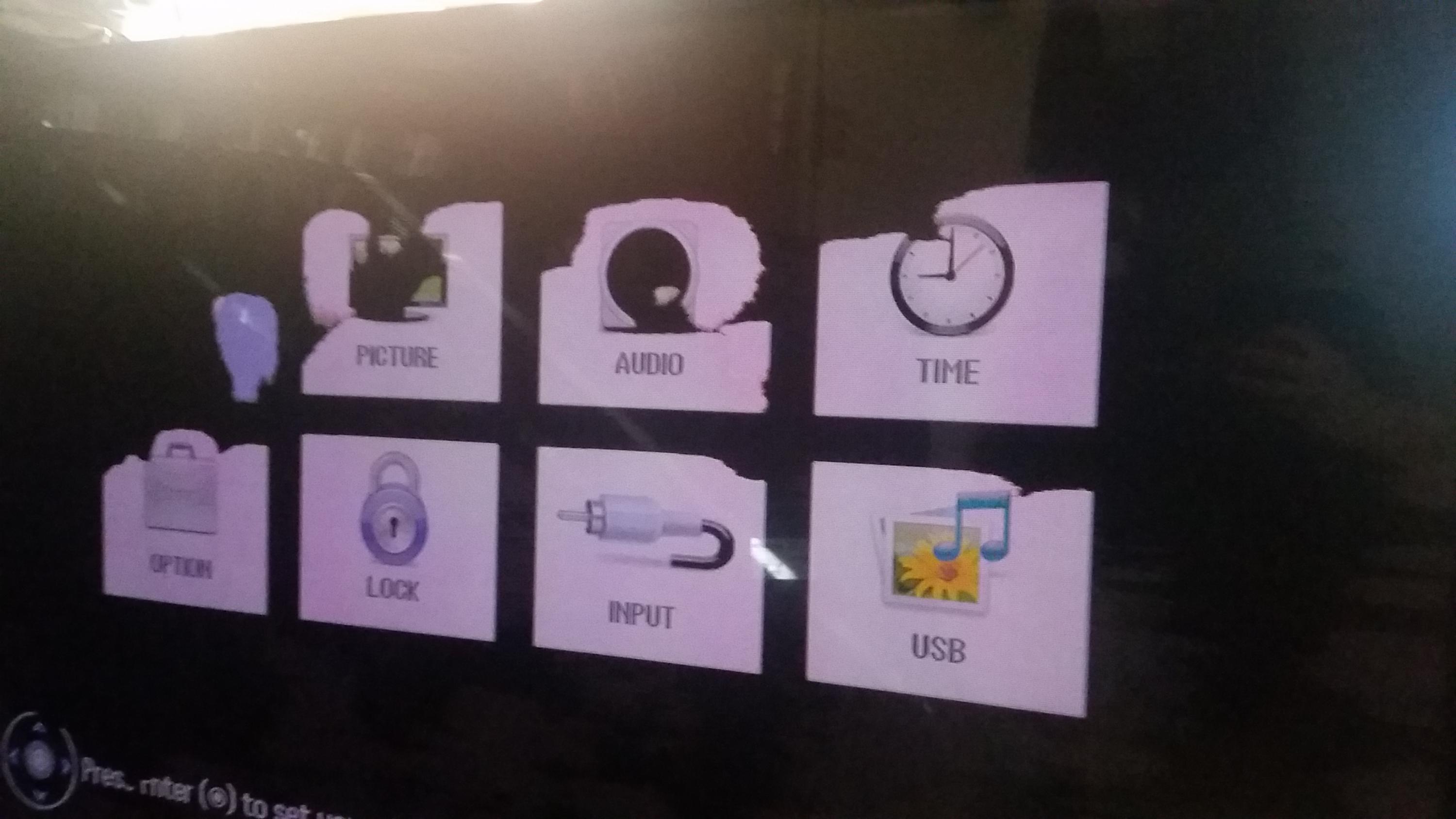

    I plugged back in the YSUS board and unplugged the ZSUS board from the power board and the TV powered up. The image is visible but looks almost burned, I attached a photo.

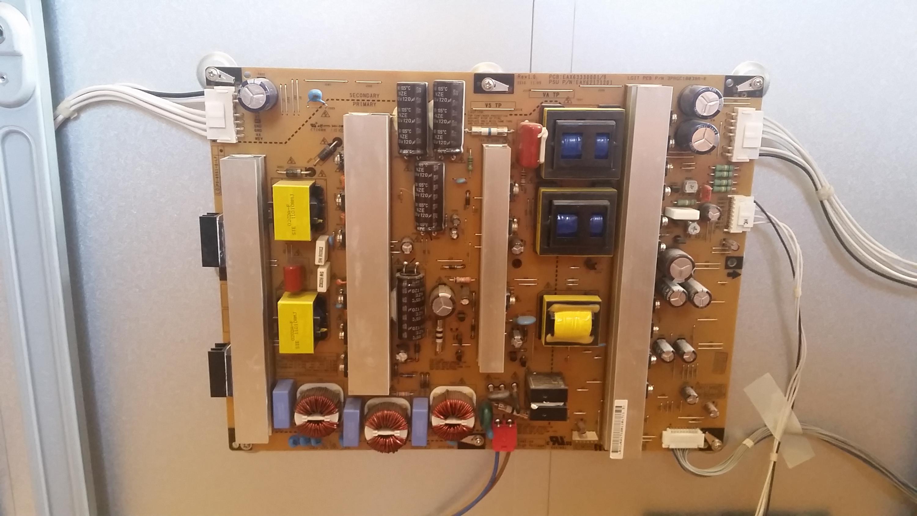

    Since the tv stayed on with the ZSUS board unplugged I checked the voltages I could which are:
    VS TP - 202v (listed - 201v)
    VA TP - 55v (listed - 55v)
    VSC - 148v
    I suspect this is all normal because the ZSUS board is unplugged.

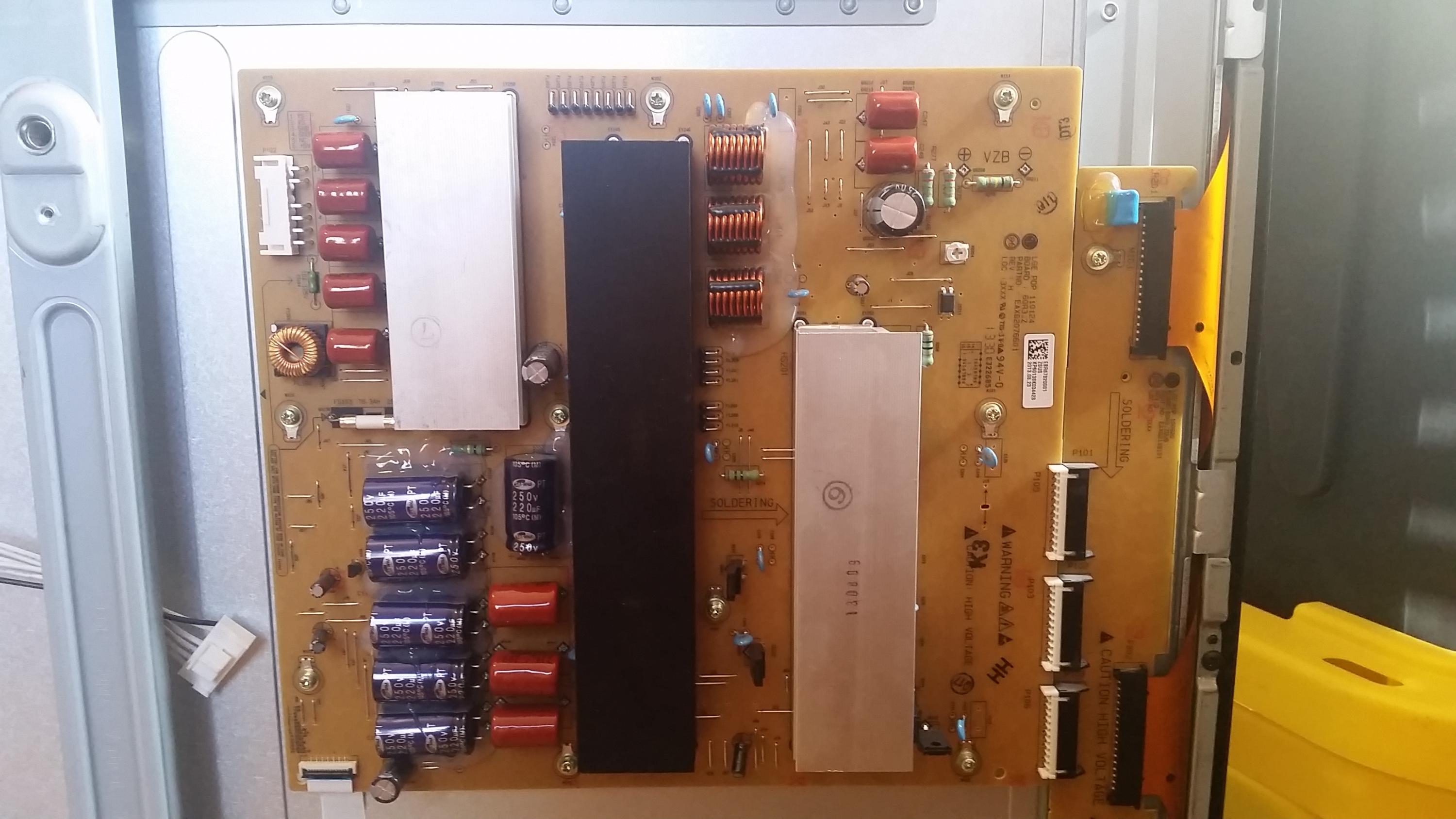

    On the ZSUS board which came with the TV there was a bit of burning on one of the copper coils so I bought a new ZSUS board but the symptoms are the same.

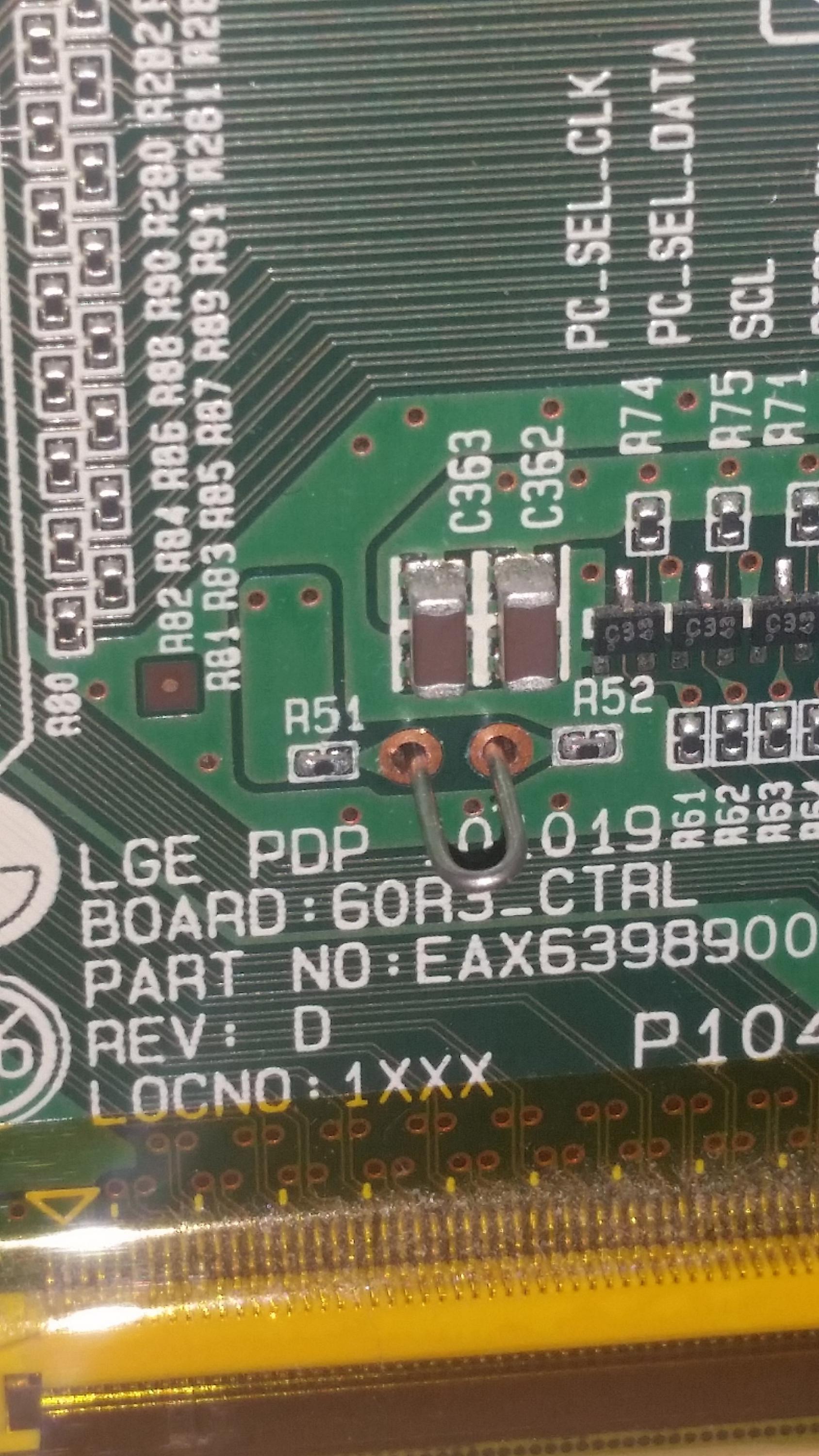

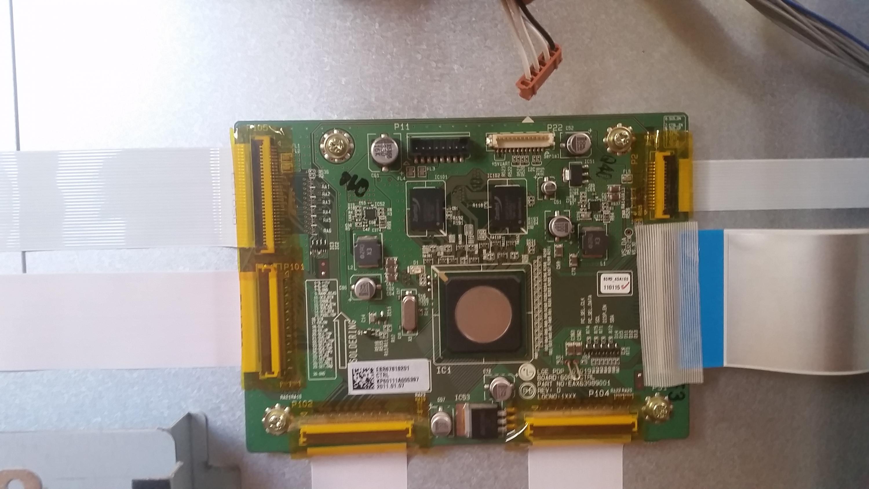

    Try this, Unplug the LVDS cable from the Controller Board to the Mainboard. (while the unit is off and unplugged) (all boards need to be plugged in Y/X ect)
    There is a spot on the controller board that you can jump with a piece of wire (Pins R51 and R52) that will bring up the test patterns when you plug the unit back in and turn it on.
    Honestly, it looks like you got a bad Xmain to me, check the solider joints on the back of the board on the 3 Copper inductor coils.

      I unplugged the LVDS cable which I assume is the one shown unplugged in the picture attached, jumperd out pins R51 and R52, plugged in the TV but the symptoms are the same as when the everything is plugged in, I hear relays clicking but the TV won't turn on.

        As for the solder joints on the back of the main board on the 3 Copper inductor coils, upon visual inspection they seem to be in good shape.

          The LVDS is the blue ended larger white ribbon cable, did you have it unplugged?
          Also, what is that plug hanging at the top of the photo? If that is connected to the PS to the Controller board plug it back in :P
          Then re run the test above.

            That plug hanging was the plug I thought you were referring to. I plugged that back in, unplugged the large blue ended ribbon cable, kept the jumper in, but the symptoms stayed the same.
              Re: LG 60PV450-UA Troubleshooting
              Can you show us how you made the jumper?

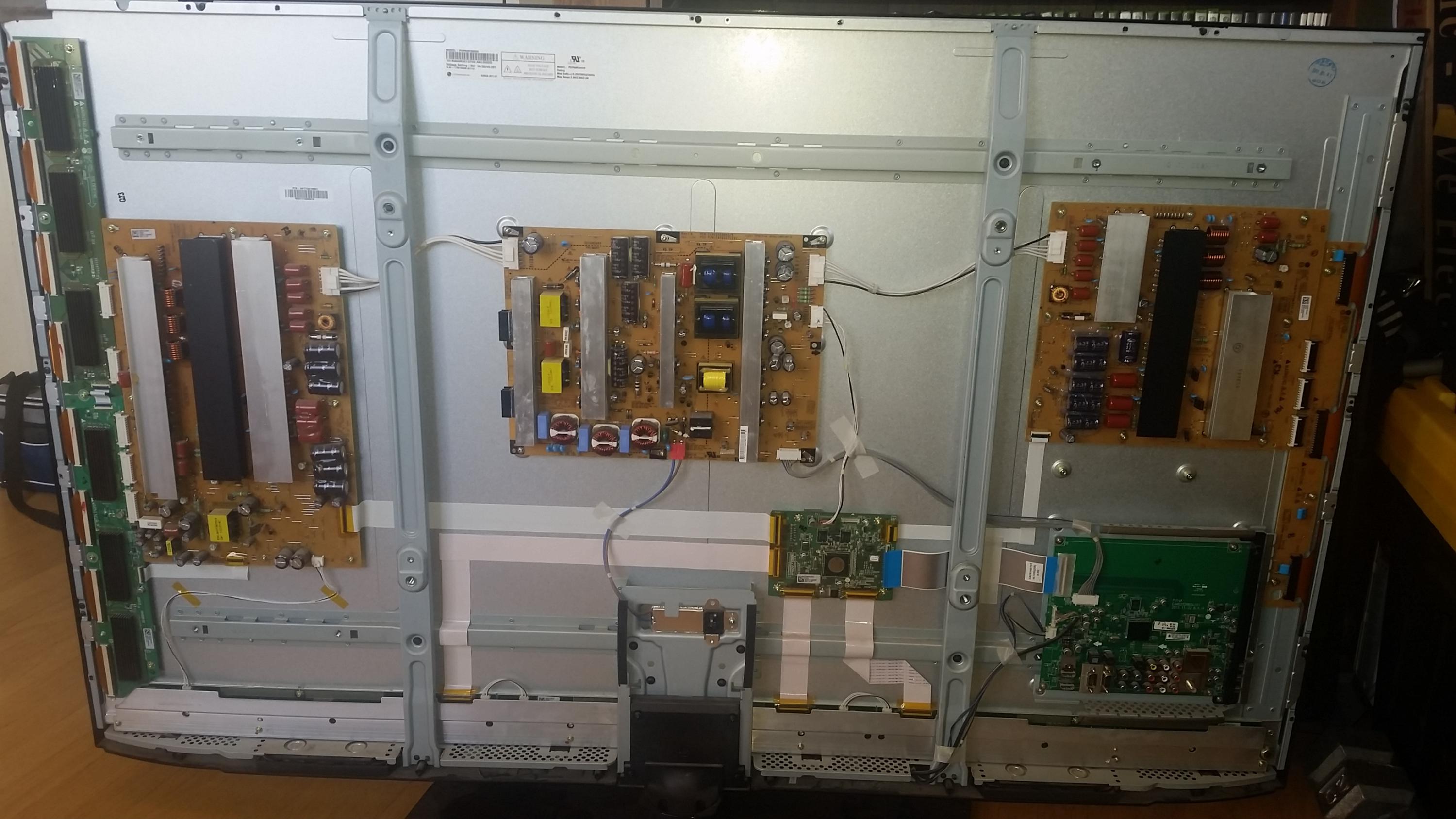

                Also take a full shot of the entire back if your panel too please.

                  For a jumper I used a little piece of bent metal, it shows continuity from R51 to R52.
                  I also attached a picture of the entire back.

                    So to establish what you have done, you only got the distorted picture of the menu system with the Xmain unplugged? So the Controller board/Mainboard is working.
                    Do the same jumper test with the Xmain unplugged.

                      I unplugged the Xmain board, left the LVDS cable from the Controller Board to the Mainboard unplugged, and the jumper in. I powered up the tv and it is running through the test sequence, with distorted image.

                        Interesting, when I was troubleshooting mine I couldnt get anything to show up with the Xmain out of circuit.
                        To me it looks like your Xmain is bad.

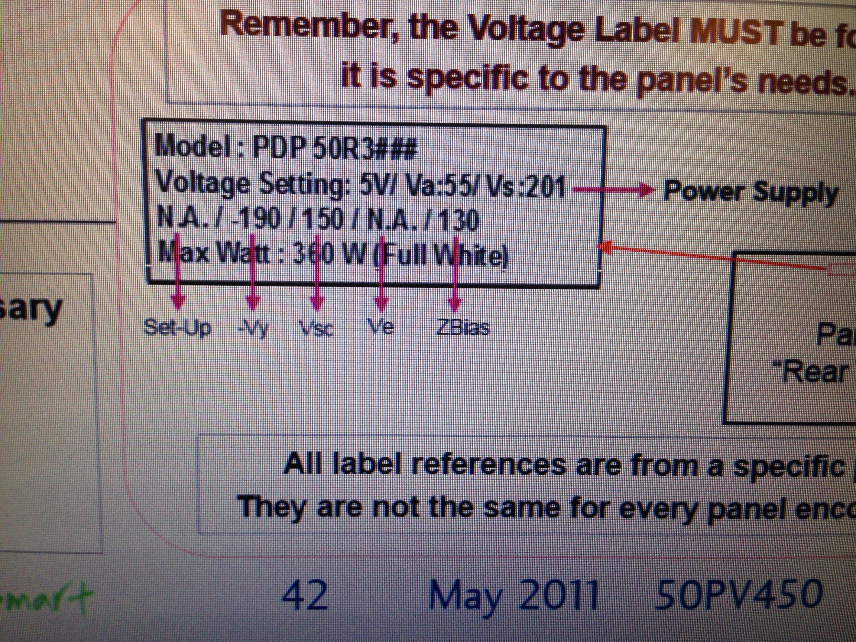

                        Get some voltage readings off your Ysus while the test patterns are going.
                        You will see VSCN and VY test points with + and - pads touch your probes to those points and see what your are getting.
                        Use the photo below as a guide, your voltages will be posted on the inside of your panel.

                          The voltages I got are as follows:
                          VY is -178.5. Listed voltage is -178.
                          VSC is 149.6, listed is 150.
