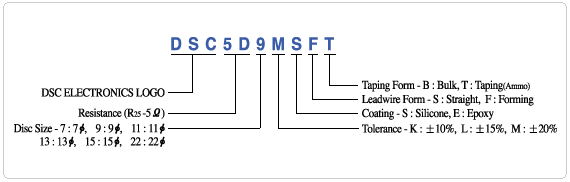

                      referring to the second attachment of my first post, do you know what that black round thing (with the white glue on its back, right next to the fuse) is? It has "DSC 5d-15" on it. I search on the web, it seems like it is a INRUSH CURRENT LIMITER. It has a logo, please see attached.
                      I cannot find the specification for it.

                        Its a thermistor, and yes it is a current limiter, They work by stopping the initial rush of current when first turning the PSU on, It protects the following circuit. As current passes through it warms up allowing the current to flow at full.
                        Resistance at 25c = 5.0 Ω
                        Max Steady State Current = 6.0 A
                        Thermal Dissipation Constant = 20c
                        Thermal Time Constant = 75 seconds
                        Beta Constant (25/85c ±10%) = 3000
                        Max capacitance (120vac) = 2450μf

                          Thanks, newtothis. Can you tell the spec with this "DSC 5d-15" info.? Or is there anywhere I can find the spec, as I have spent a long time trying to find it on the web already.

                              Re: Samsung HL61A750 TV Sub PCB (BP96-01726B) resistor identification
                              How to read the numbers
                                http://img96.xooimage.com/views/1/b/6/tab-40d0226.jpg/
