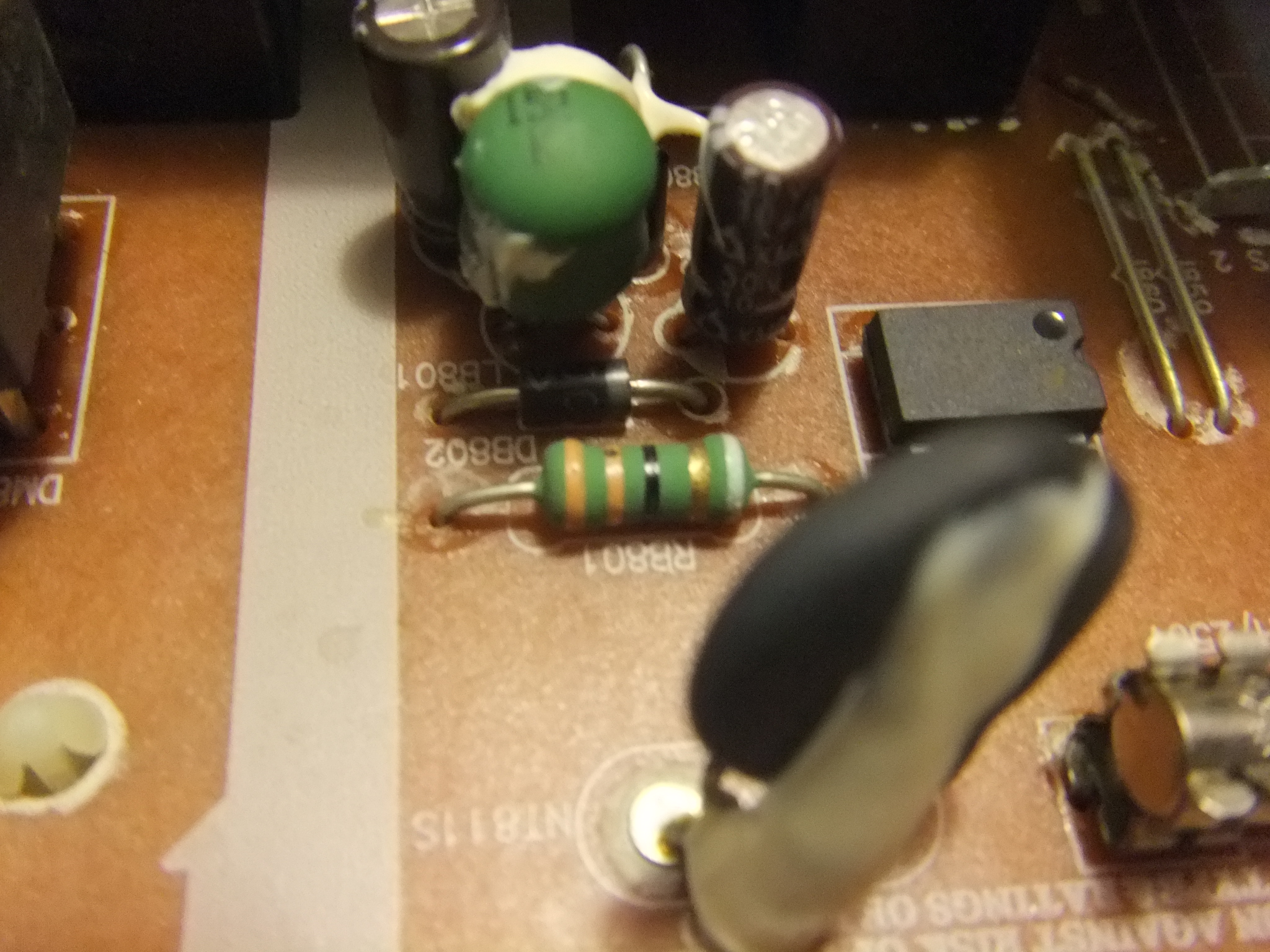

    I have a dead Sub PCB (BP96-01726B) with no 16V output. I have found out that the resistor is blown, but I am having trouble identifying the specification of the resistor. Could any one please help? Thanks.

    From what I can see, the band colors seem to be (from left to right):
    orange-orange-black-gold-white
      Re: Samsung HL61A750 TV Sub PCB (BP96-01726B) resistor identification
      33 Ohms 1/2W. MOX type. What resistance reading did you get using Ohm meter?

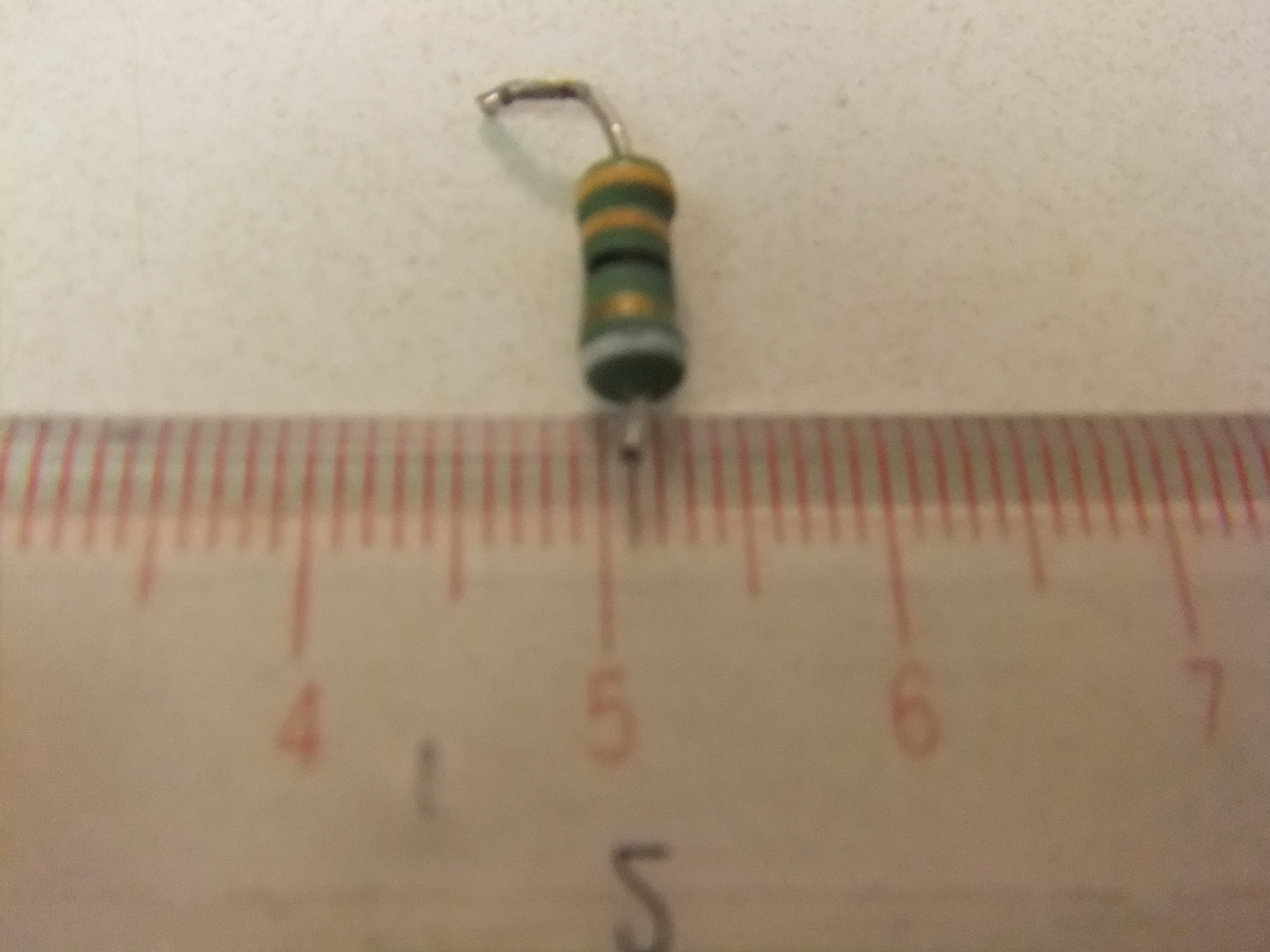

        Would you please explain how you can tell the wattage of the resistor?
          "Would you please explain how you can tell the wattage of the resistor?"Looking at the pictures and the component next to it.
          You can measure the dimension of the resistor and then check the dimension on the resistor you are going to order.
          The resistor may have been blown open due to too much current draw due to shorted circuit.

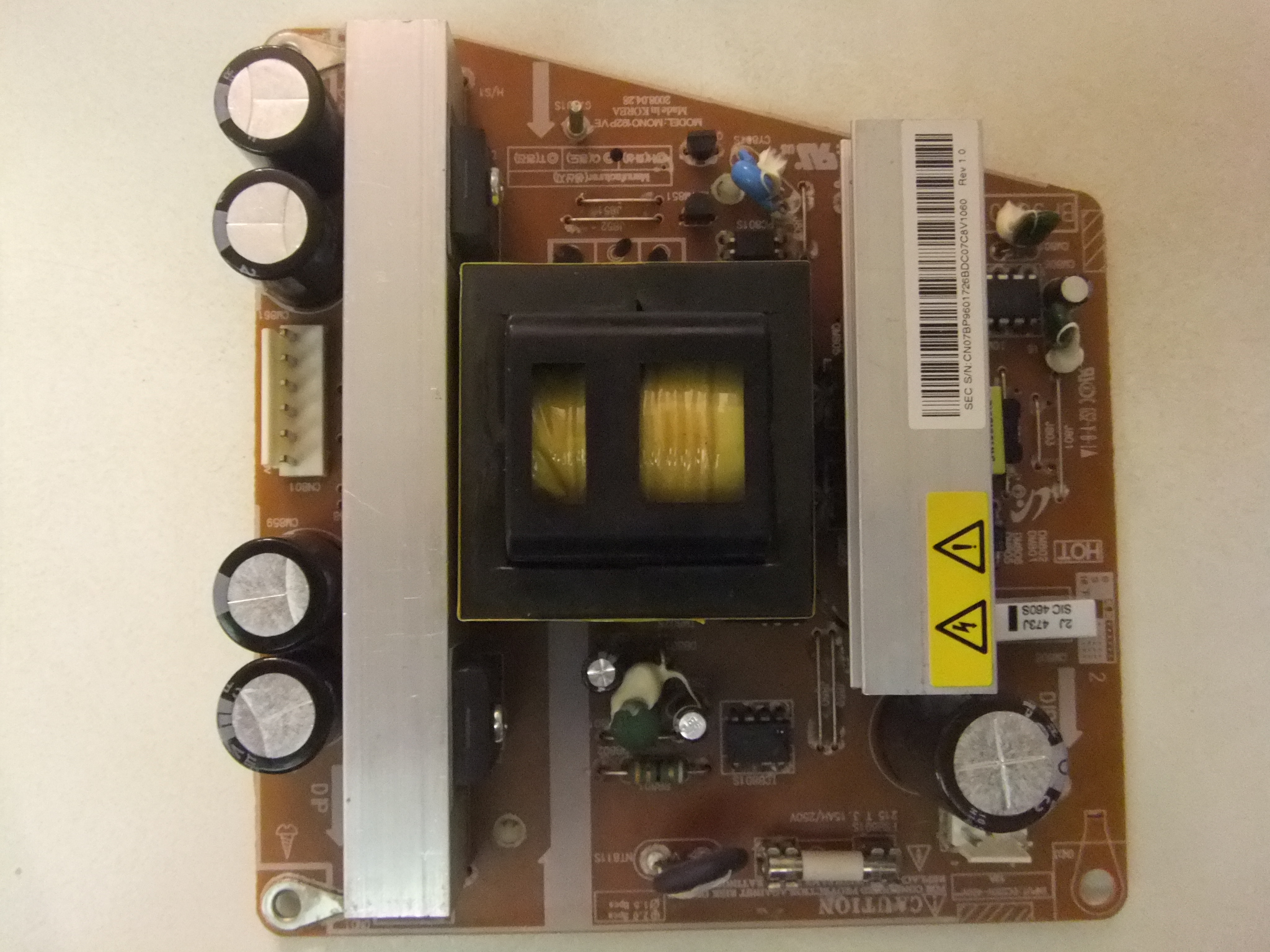

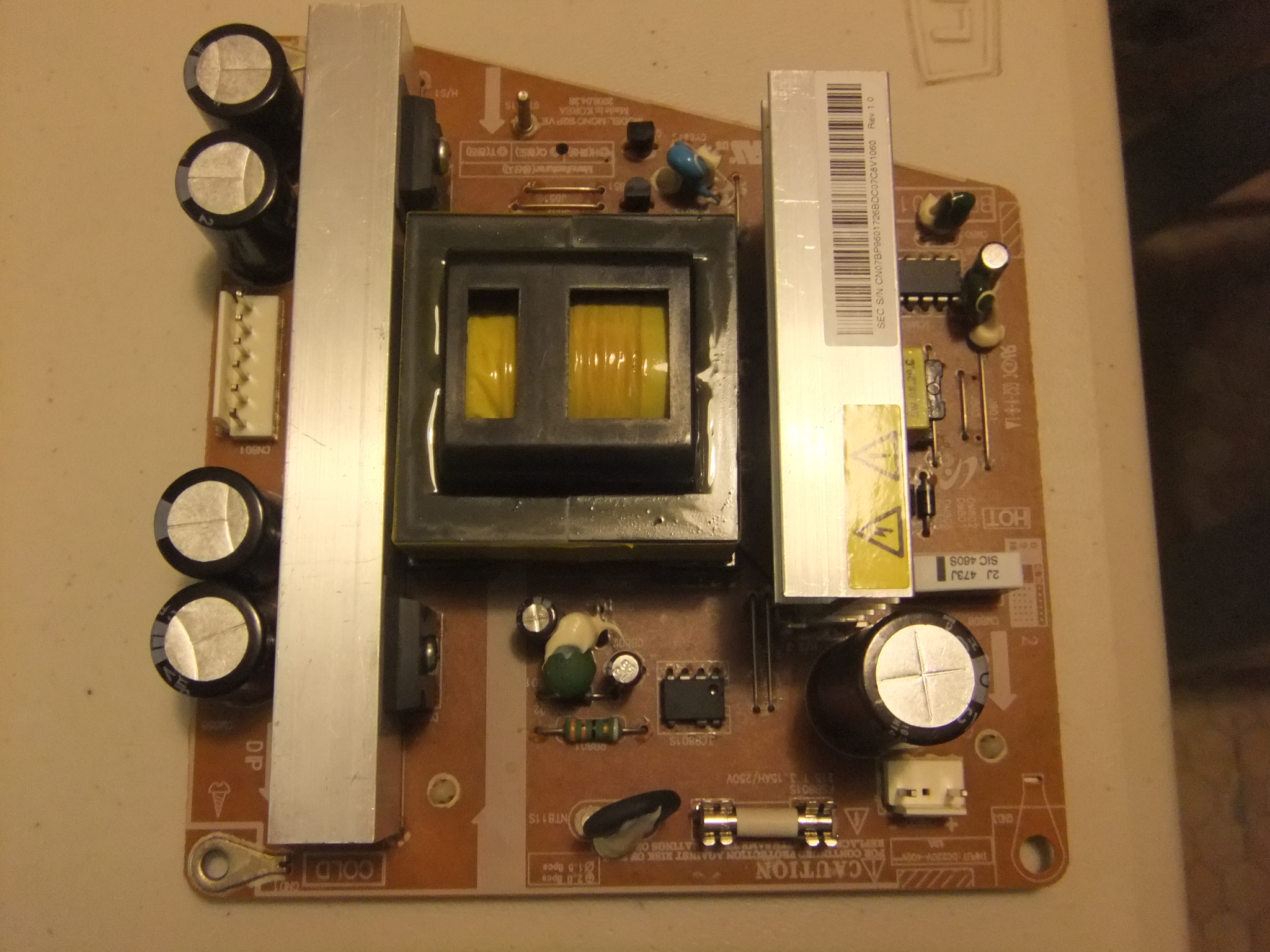

          Please post good clear straight shot pictures of the whole board top side and the bottom side so we can trace the connection to find out what the function of this resistor is.
                It looks like that resistor is for feeding the Voltage to that 7-Pin IC pin 5.
                You need to get the P/N as printed on top of the IC to find out what it does and to get the pinout of the IC.
                That IC may be shorted out and cause the IC to resistor to blow, you can check the resistance between that pin 5 where one leg of the resistor is connected and the Negative leg of the 450VDC cap to see if it shows low resistance.

                  yes, the resistor is for feeding the Voltage to that 7-Pin IC pin 5.
                  The printing on top of the IC are:
                  B821
                  LNK304PN
                  52889H
                  The resistance between that pin 5 where one leg of the resistor is connected and the Negative leg of the 450VDC cap is 1.003kohm.
                      OK, it is switching buck converter.
                      Check the resistance between D (5) and S (7) pin.
                        it is .996 kohm.
                          It is bad, it should show as open circuit. I would take that IC out and test it off the board again.
                          Since that high voltage form the 450V cap went through that bad IC, lots of components could have been damaged also because the circuit is made to produce low output Voltage to feed other circuit down the line.
                              The resistance between D (5) and S (7) pin off the board is more or less the same as before = 1.052 kohm. I guess that means it has to be changed, right?
                              Should I also change all the components in between the resistor and the 450V caps, just to be on the safe side? or is there a way to check them?

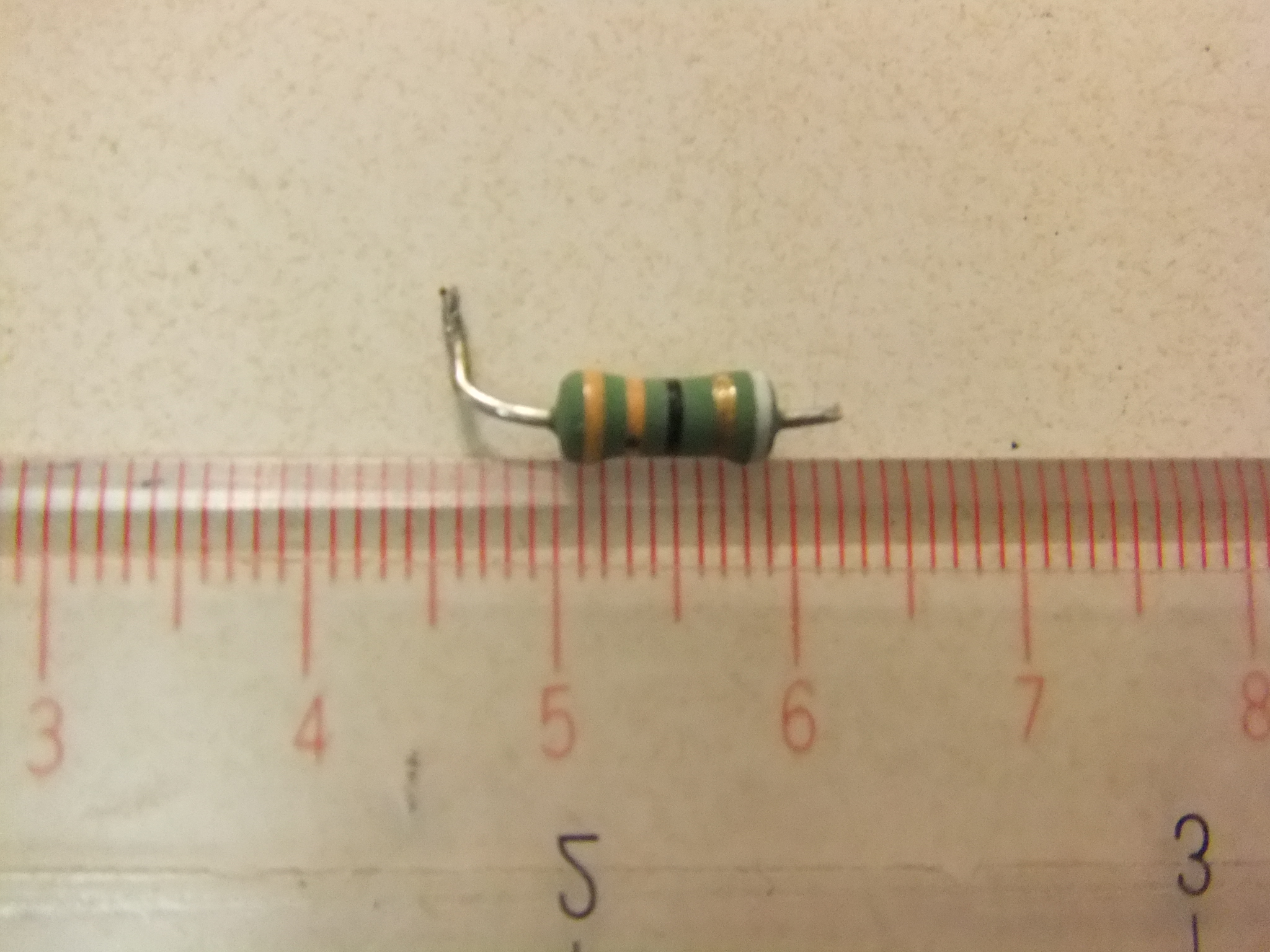

                                The diameter of the resistor is about 2.5 to 3.0 mm
                                the length of it is about 8 to 9 mm
                                From Digikey.ca, the 33 ohm resistors which fit the above diamensions can either be 1W or 0.5W.
                                Only the Panasonic ERG-1SJ330 one is metal oxide film, but it is 1W.
                                I am going to order all my parts from Digikey.ca, so can you please advise me which specific resistor I should choose? As I have no idea if I could use a higher or lower wattage rating of resistor, or if MOX resistor is not available, what else I should use.
                                Thanks.
                                  Digikey part#: RSMF1JT33R0CT-ND
                                  That should fit
                                      I would or one of each because they do make small body with the same Wattage as the bigger body.
                                      What worry me the most are the circuits and the components connected to the Source side, you need to carefully check them really well, since the high Voltage may have apper on the S pin before the resistor bunt open.
