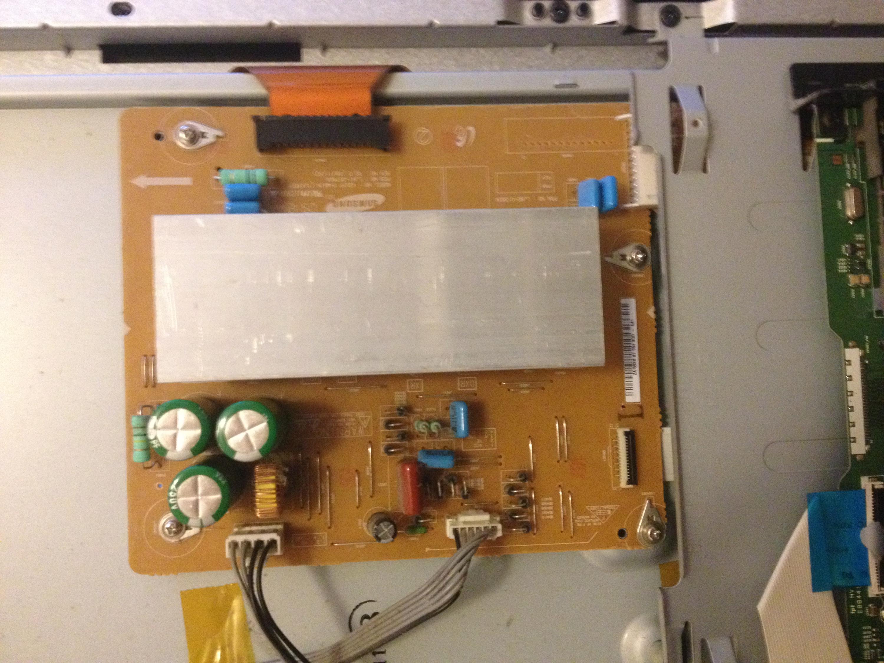

    Hi all got this set with just clicking, found burnt out z-main so got a repair kit as boards are not about
    now the set powers up with correct voltages on ps and i can see the VR-VSC and VSCH jumping around on the y-main so is that now working ?
    my question is how can i trouble shoot now to find the fault my basic knowledge can only get me this far.

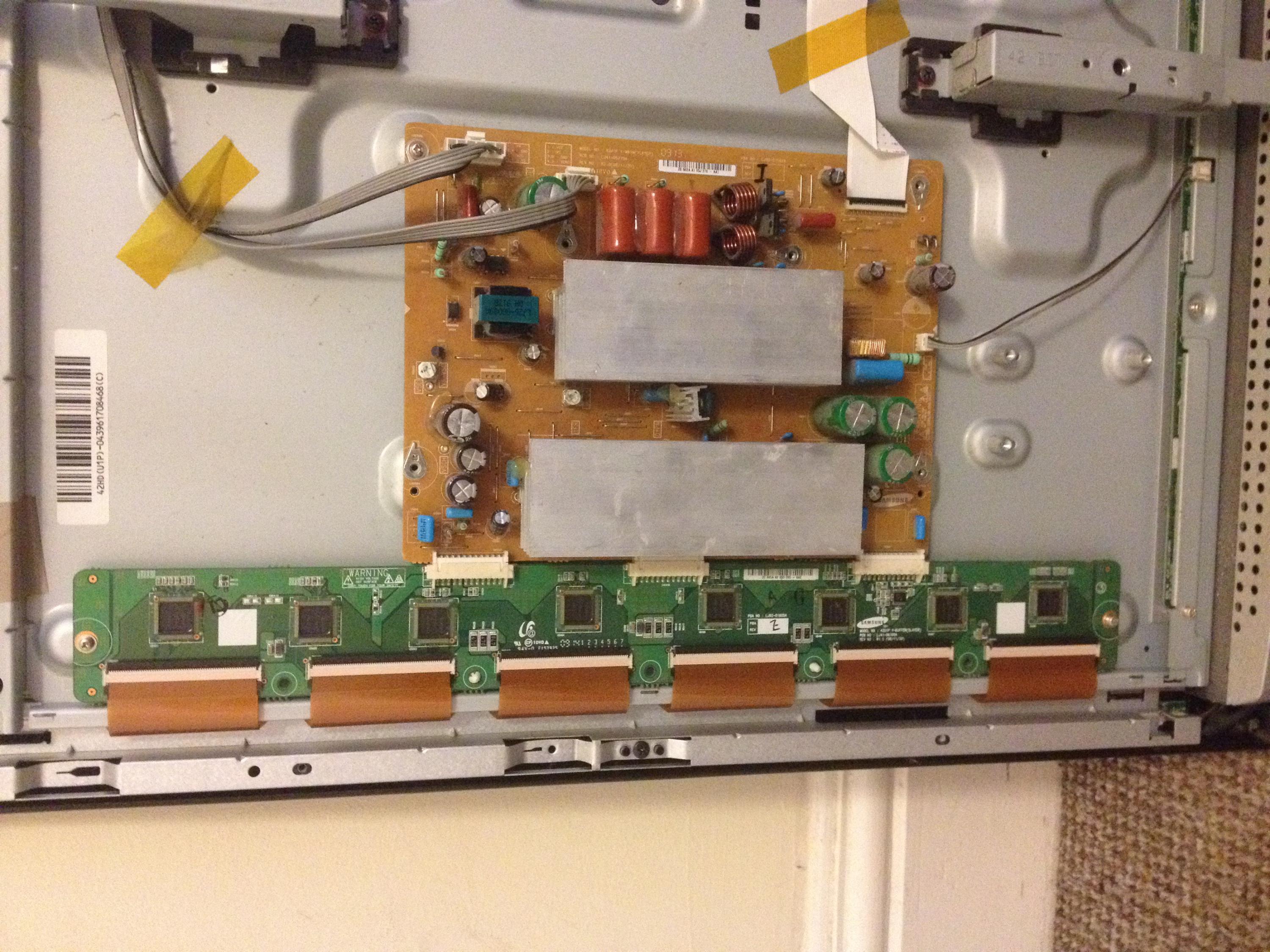

    Disconnect Y-buffer, if Vsc/etc come back, this indicates a shorted/bad Y-buffer (it's common these for the buffer to be damaged by the X-main somehow, not sure how.)

                    Re: PS42B430P2W PS42B430 Blank screen nothing - VA and VS good
                    sorry had duff readings changed batt in meter and now
                    VS 208
                    VA54
                    VSC -110
                    VSCH - jumps from 80 to 110
                    without buffers
                    vs 208
                    va 54
                    vsch -36.8
                    vsc -193

                        That suggests potentially bad buffers. To be sure, check using this test:
