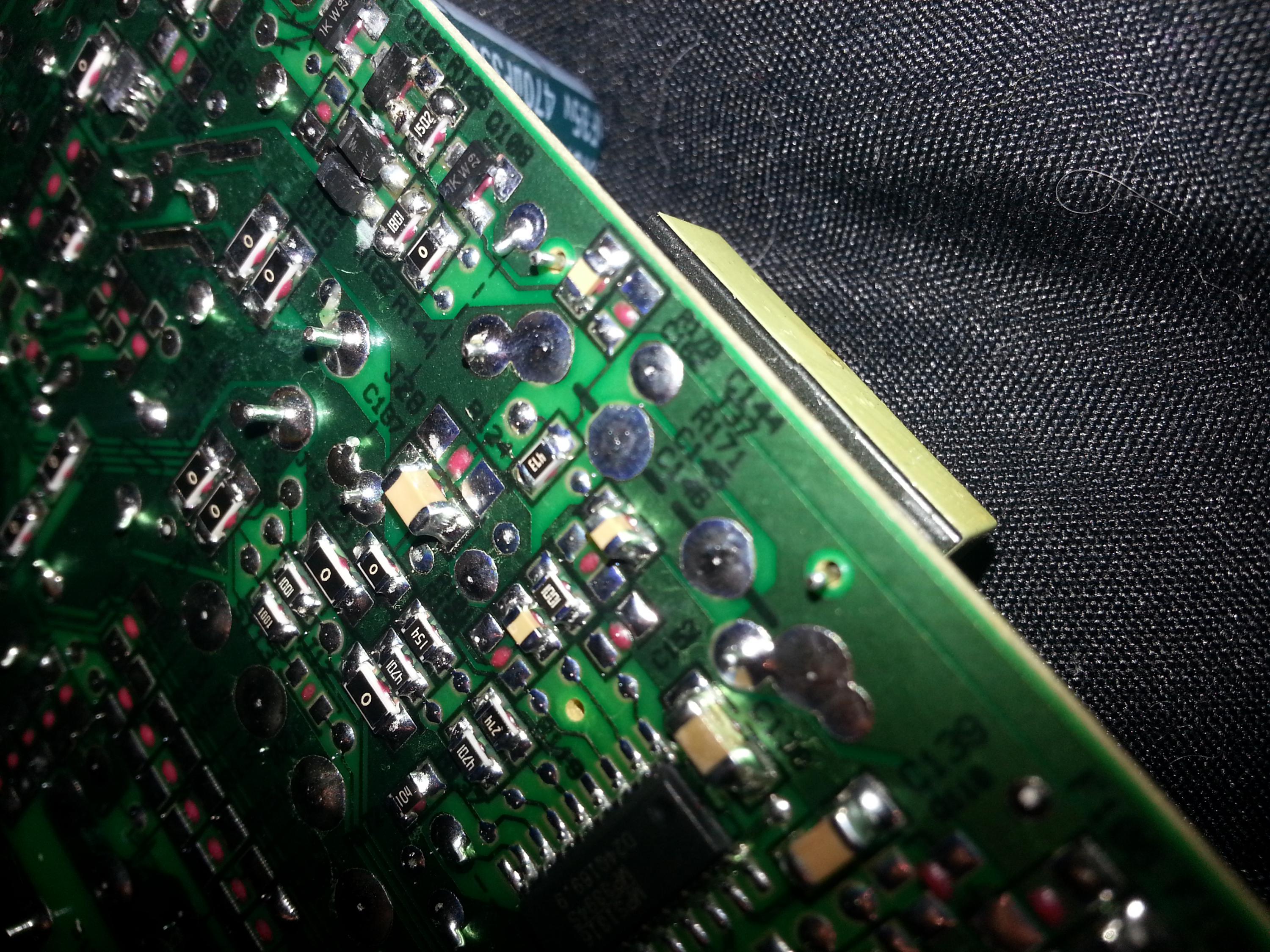

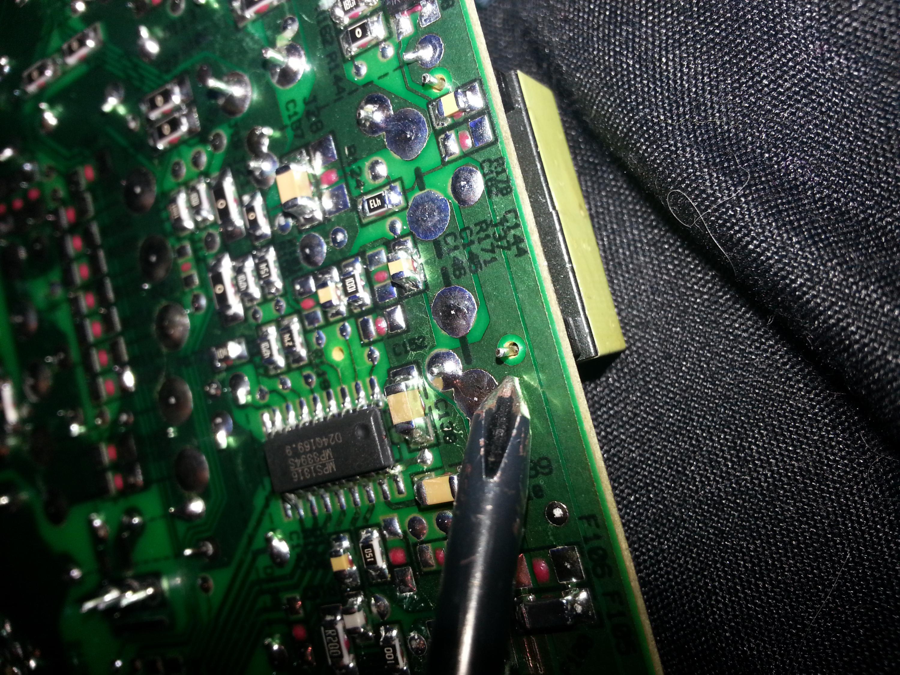

Should these pins be soldered in as its buzzing when itd on and when its pushed against it goes quite
vestel power board question
Tags: None
Re: vestel power board question
They're just mechanical mount pins. You can see the lack of a solder pad means they never intended for them to be soldered. The buzzing can be a normal effect, it does not mean there is a fault, as long as it's not audible from normal viewing distances.Please do not PM me with questions! Questions via PM will not be answered. Post on the forums instead!
