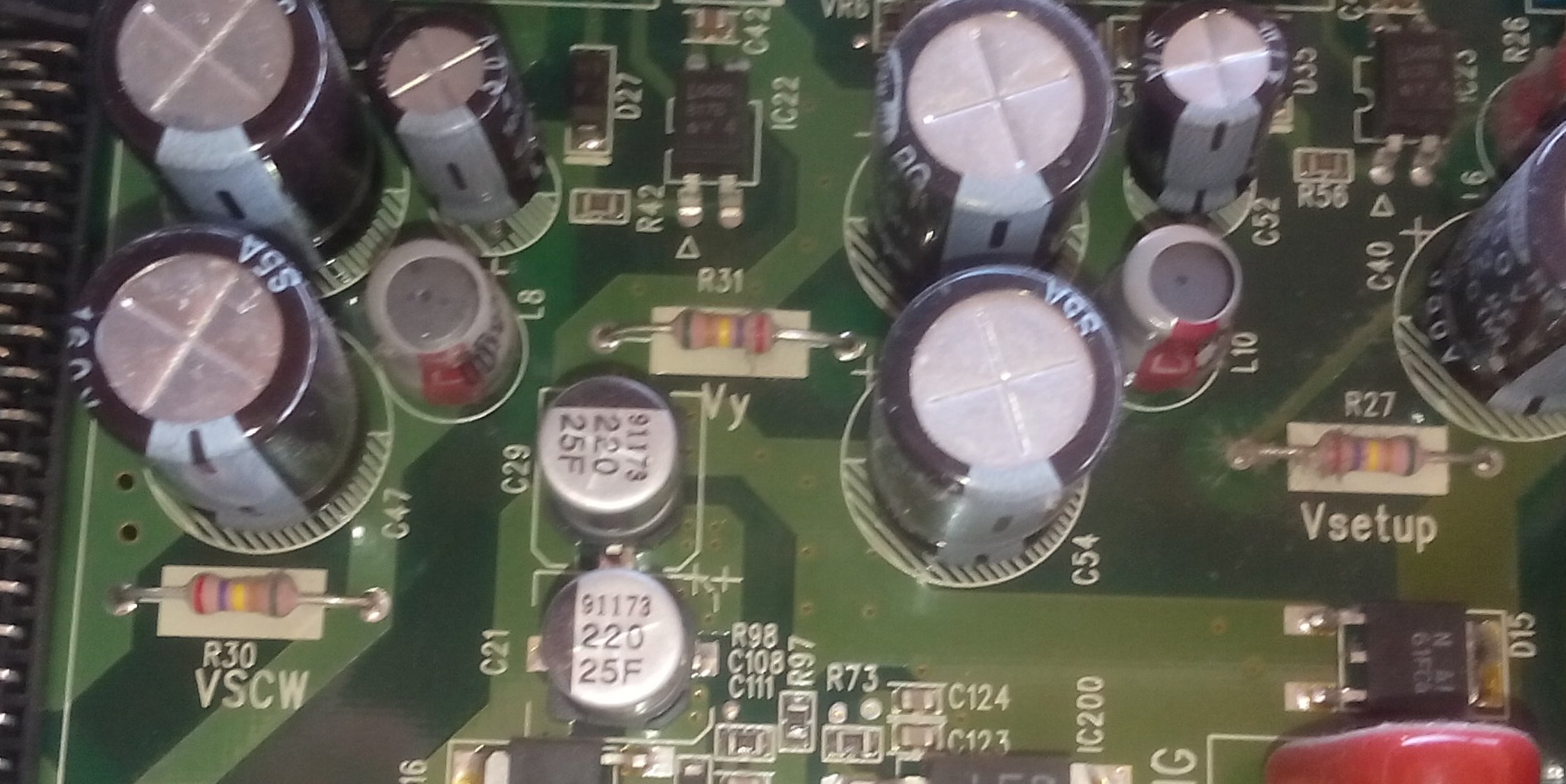

          Here's what I have accessible on the YSUS...
          VSCW, VY and V-SETUP
          I am assuming the VSCW is the VS/VW..
          I also assume it matters what side of the resistor I clip on the + probe??

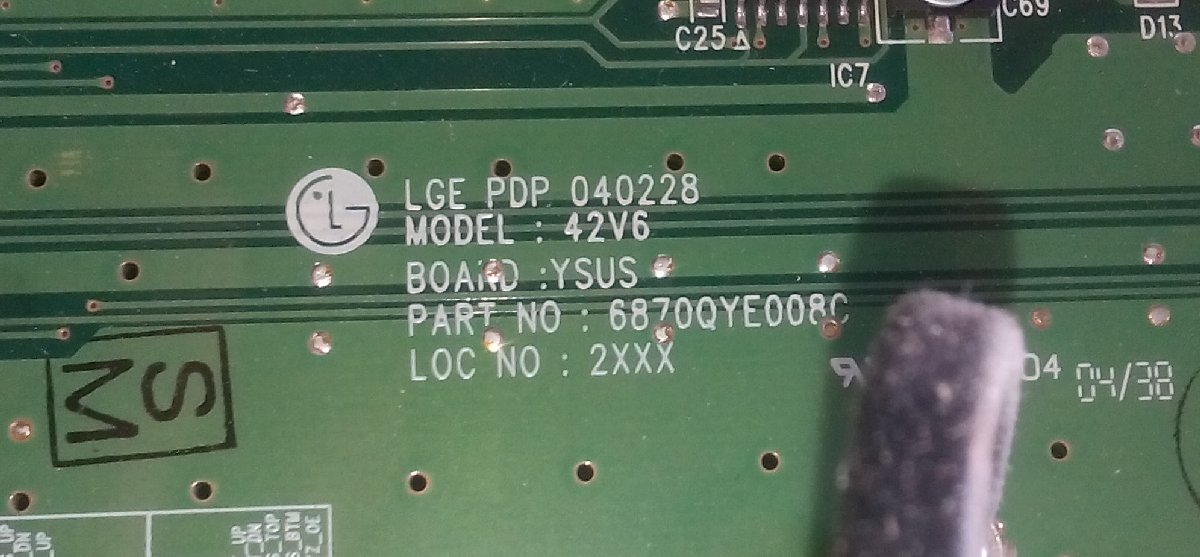

            Is this an LG panel inside?

              Re: Hitachi 42EDT41A Glitzy Solarizing- ZSUS??
              LGE PDP 040228
              Model 42V6
                That's the part number on the YSUS board..
                  Voltages will be measured across those resistors.
                      VSCW started at 121v at power up, then gradually went down..
                      VY started at -76v at power up and gradually went up..

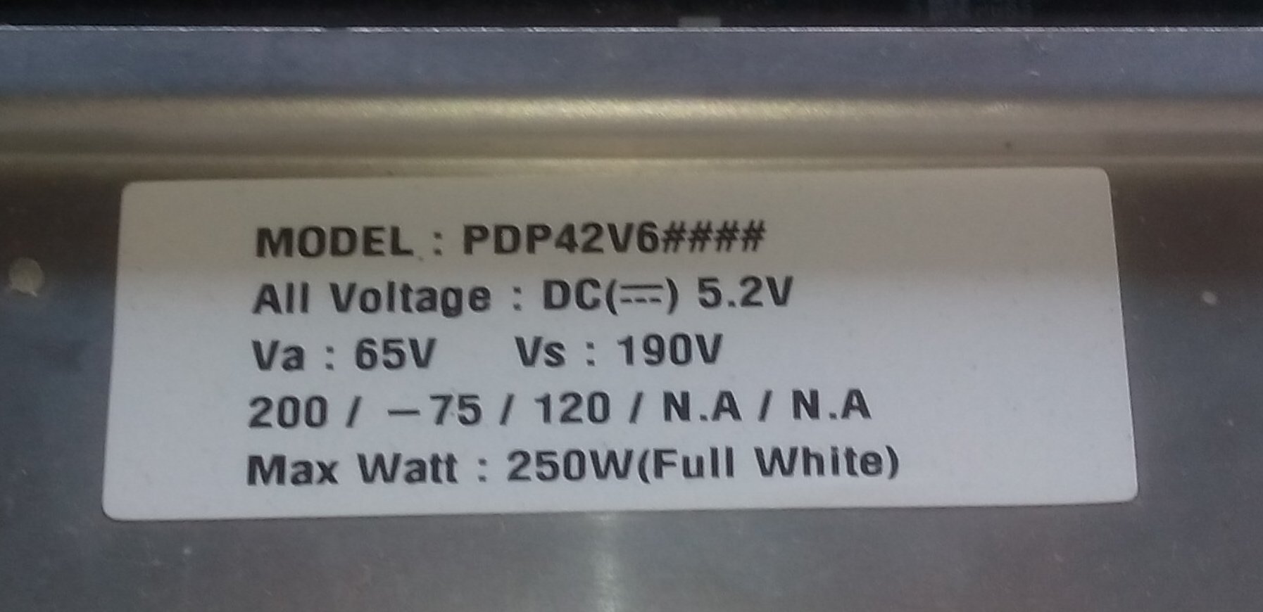

                      The Label says VS 160V...
                        Ignore polarity for most power supply testing.
                        Hypothetical example. Power supplies generally have a polarised output capacitor and an output rectification diode on the transformer side.
                        So, what would happen if the supply had -200V on it instead of +200V? And this was somehow a continuous operation. Three things:
                        a) the diode would be rapidly damaged by the capacitor discharging
                        b) the capacitor would violently bulge and vent. The chemical reaction inside the capacitor vents hydrogen peroxide which really stinks up the place.
                        c) the transformer, driver FET and control logic would probably emit the magic smoke, which would stop them working (as electronics work on smoke - if the smoke leaks, they stop working)
                        I'm assuming that none of these have happened. If so, ignore polarity for now.
                          Vs != Vscw.
                          I have not seen a Vs that low before!, sure it's not 180V?
                                  OK, measured VA and VS off the connectors coming from the Power PCB..
                                  VS shows 192V
                                  VA shows 65.6V
                                  Both are in keeping with the tag on the display...
                                  VS=190V
                                  VA= 65V
                                    Is Vs stable when picture glitches? Check on Y-sus and Z-sus too - could be bad connection.
                                    • Michale32086
                                      • Nov 2011
                                      • 1453
                                      Seems to be stable. Holds at 192v +/- a volt or so...
                                      Both Y and Z show stable 192 +/-
                                        Worth checking other voltages then and see if they drop out, including Va.
