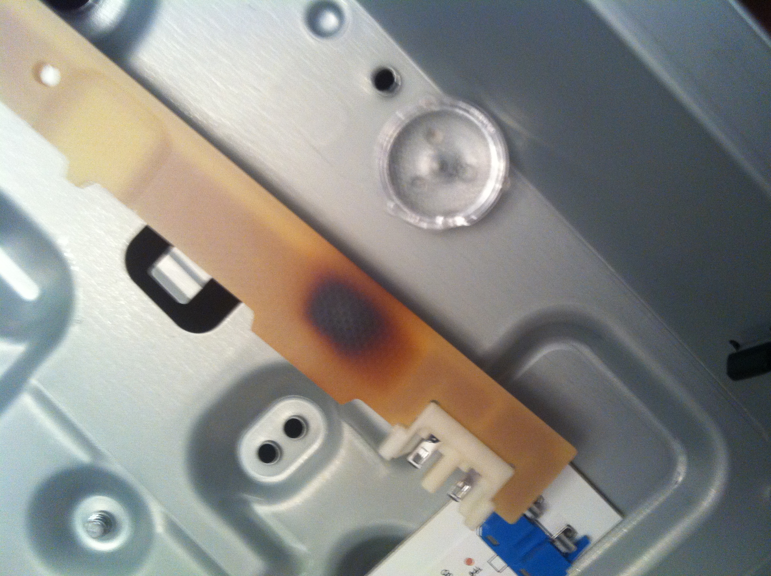

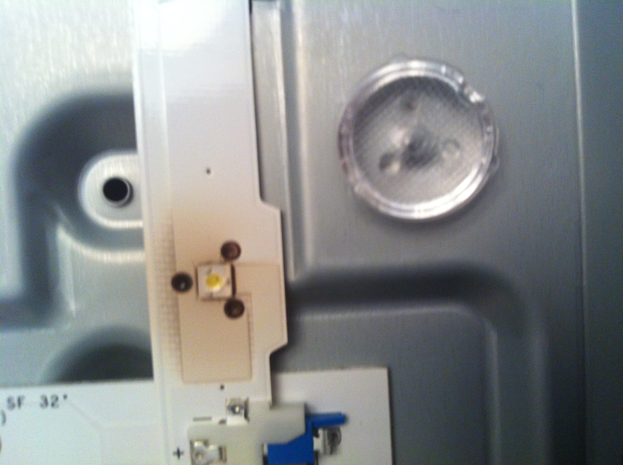

              Re: Samsung un32f5000 no video
              The back side of the string.
              Looks like the plastic lens came off and the led overheated?!?
                #47
                It got pretty hot didn't it. I hope the other will not go out later on too.

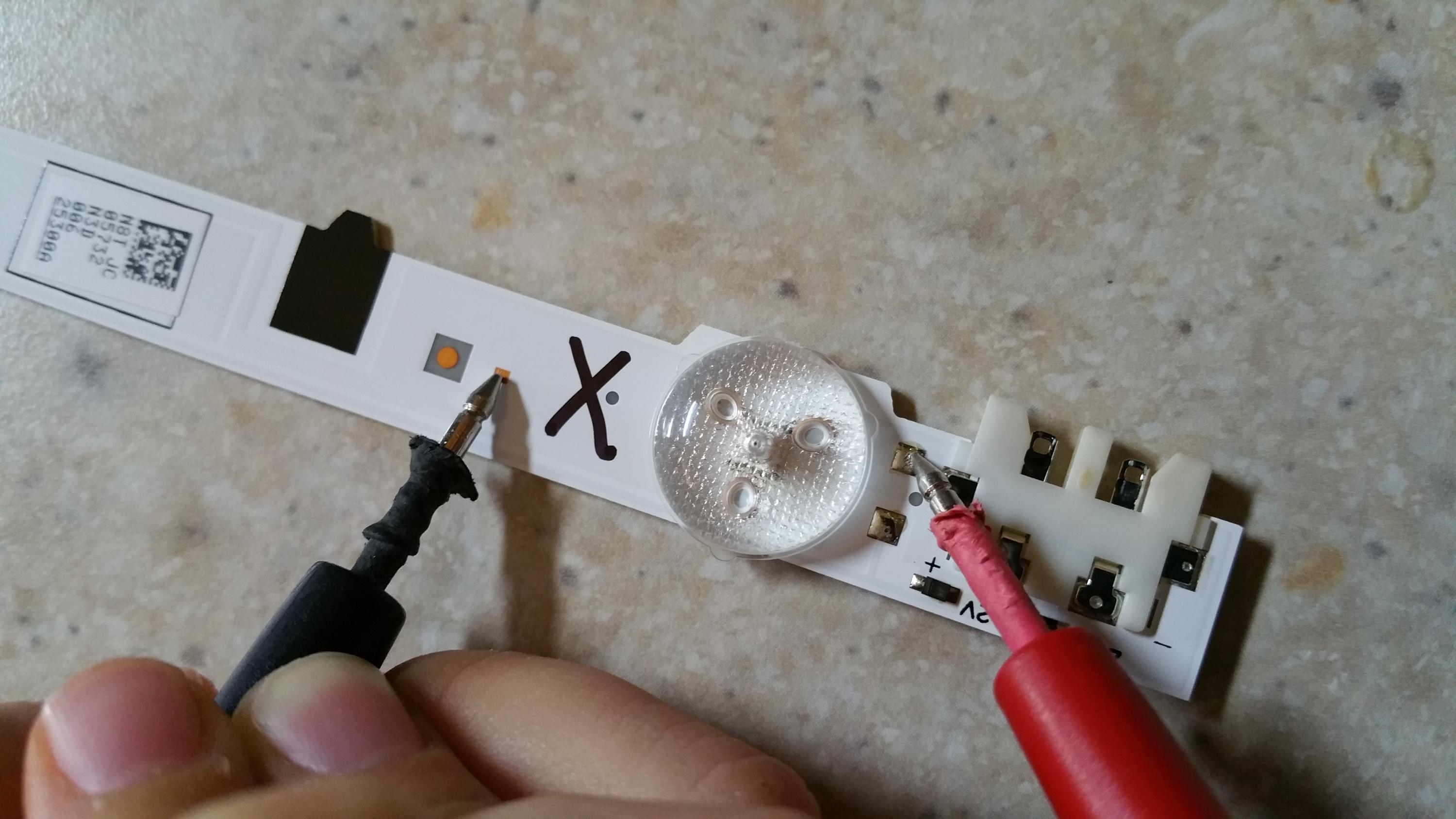

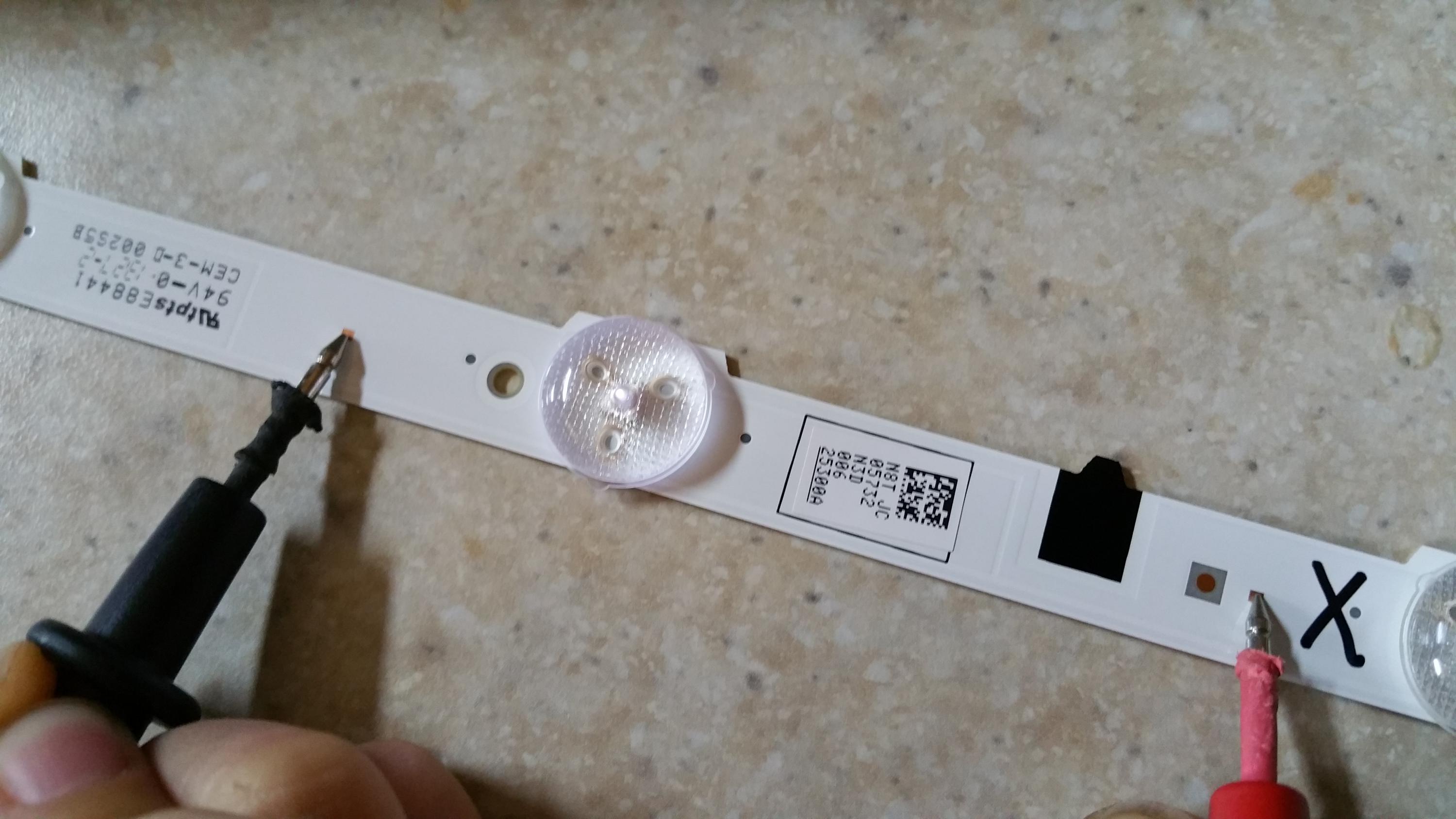

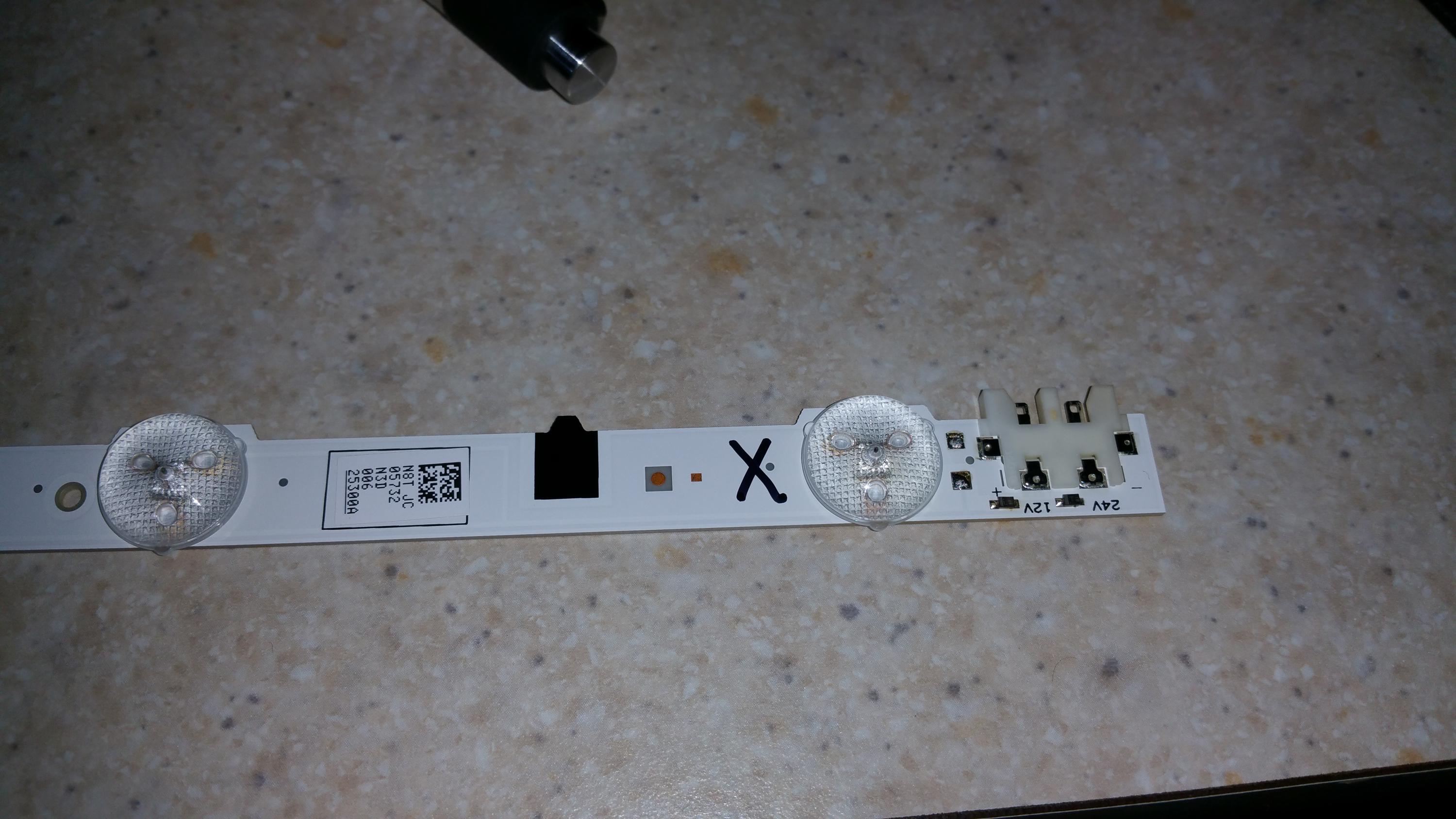

                        It is a pain to remove. I have the same issue on my set.
                        Here is how you can also test. I used a multimeter in Diode mode as it uses 3 volts to test. I only found one LED that was bad. The other tested good but it would not be a bad idea to replace the whole strip. So far I at least diagnosed and the next step is to look at individual LEDs and or strips.
                        Thanks to all for info.
                        I attached pics. The one that I tested bad was the very top strip and led closest to power input.
