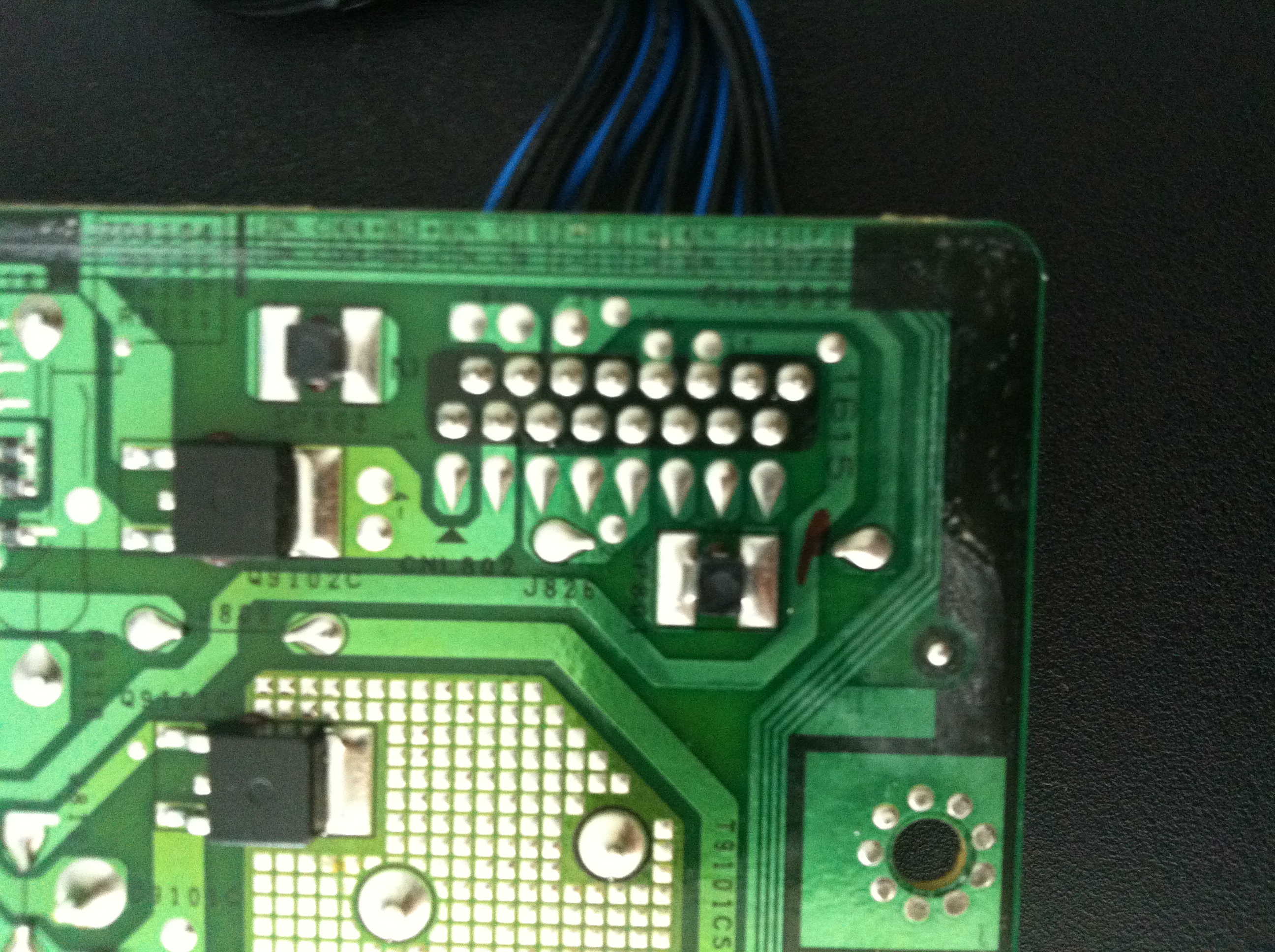

    unhook the main board from the power supply. Take a 500 Ohm to 1k resistor and jumper PSon and BLUon to 5v Stby. The power supply should be all on and the backlight should be on. If that doesn't go, unplug the backlight on the power supply and measure all outputs with you DMM on DC, use chassis GND or the GND pin on the connector for the negative lead.
    heres my test results ...
    #1- 13.1v (b13v)
    2- 4.7v (pwm_dim)
    3-13.1v (b13v)
    4-0v (eco_on)
    5-13.1v (v amp)
    6- 4.7v (blu_on)
    7-13.1v (V amp)
    8-0v (gnd)
    9-0v (gnd)
    10-0v (gnd)
    11-5.3v (b5v)
    12-5.3v (b5v)
    13-5.3v (A5v) ---is this the standby 5v?
    14-3.1v (PS_on/off)
      Re: Samsung un32f5000 no video
      The command signals are fine:
      6- 4.7v (blu_on)
      14-3.1v (PS_on/off)
      13-5.3v (A5v) ---is this the standby 5v? Fine, 'A' for always ON power supply which means STBY power.
      I would agree with Tom that you may have open LED in the LED string.

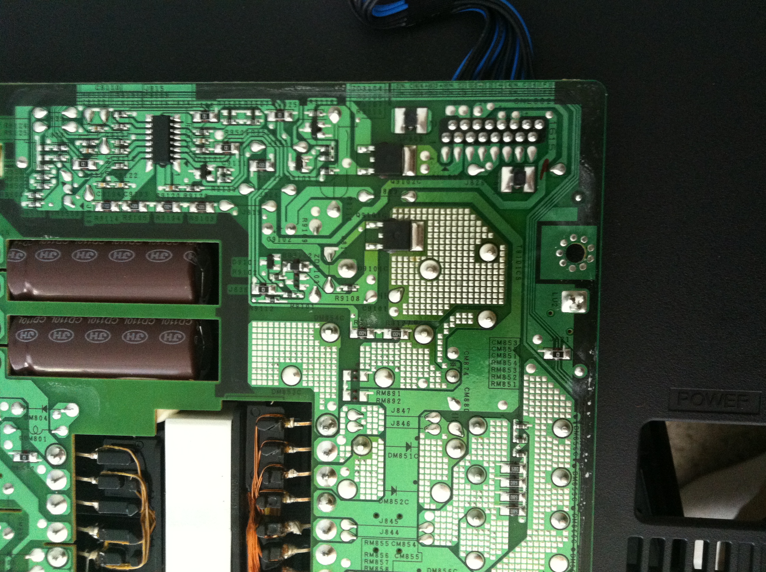

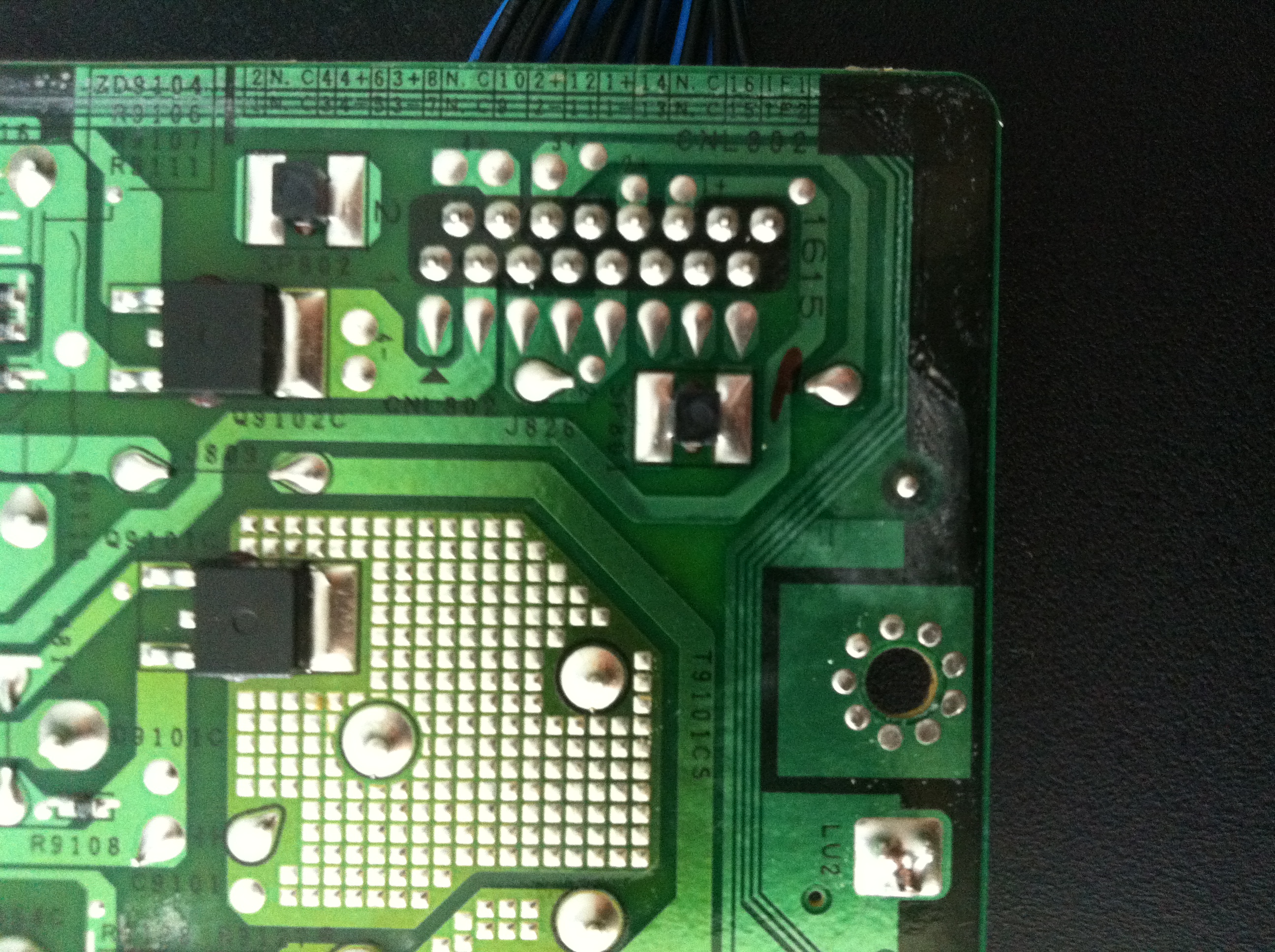

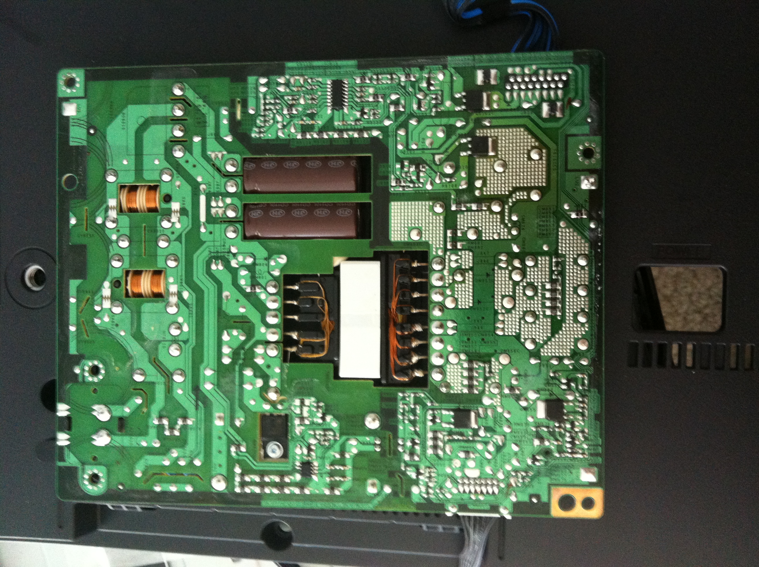

          https://www.badcaps.net/forum/attach...7&d=1423588702
          Can we see the bottom side of this section to see how the LED strings are connected together?
          • redtux777
            • Aug 2014
            • 40
            Pull the board to get a pic?

              How are these?

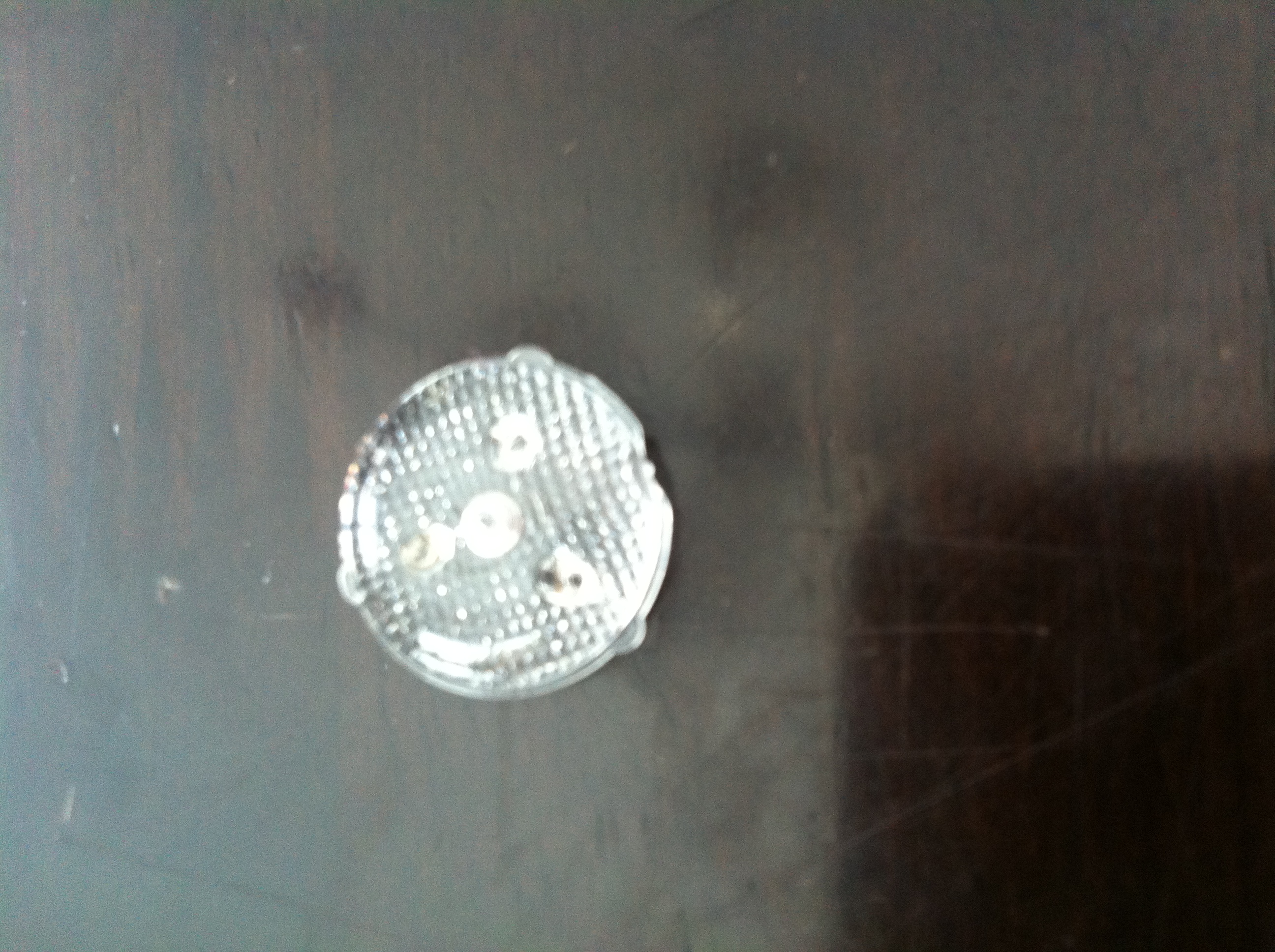

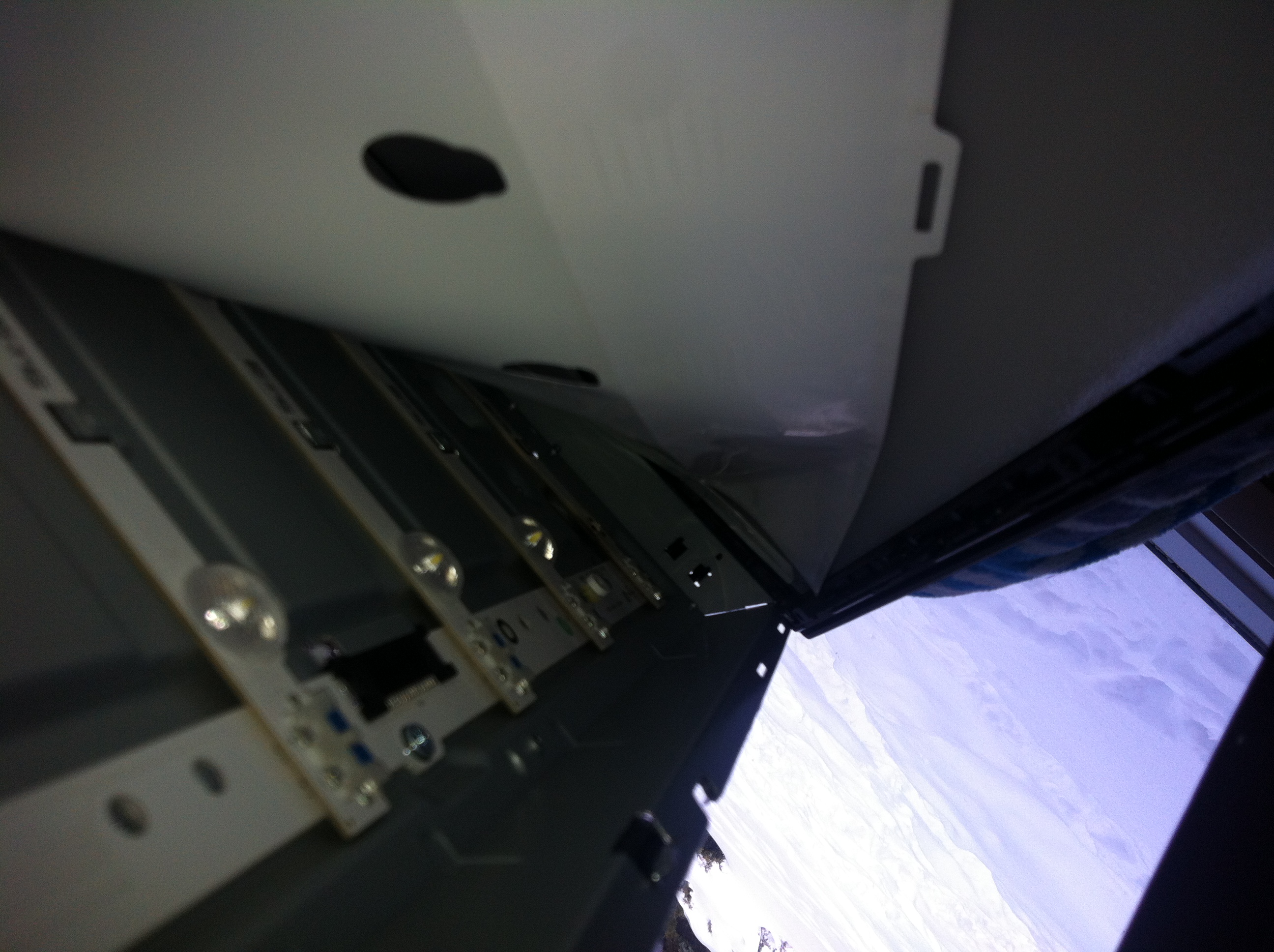

                            There are a lot of clips holding the bezel / screen on to the metal.
                            I have it mostly open and can see inside there is one glass top lose inside
                              #34
                              That is the LENS for the LED, for that LENS to come off the TV must have been hit hard. You may want to look real close at the LED strips.

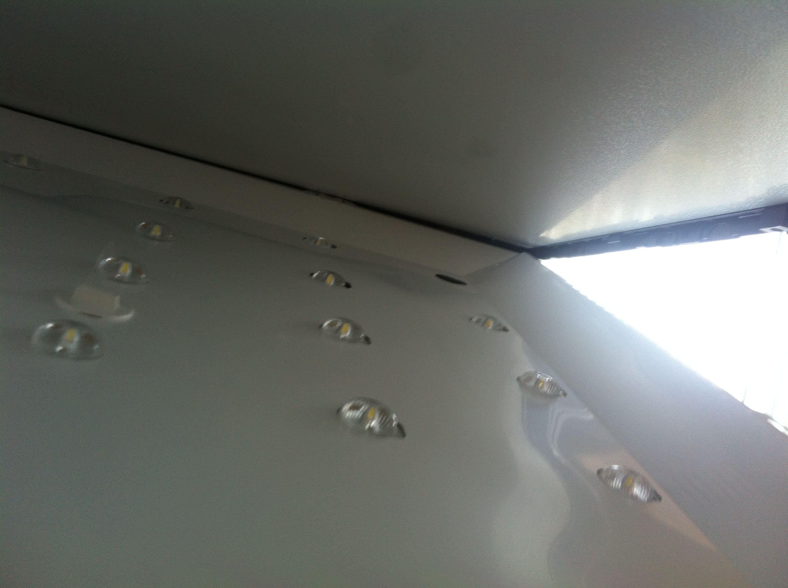

                                Looks like where the one that came off looks a little brown ...hard to see at this point
                                  #36
                                  You can use 3V batteries with 100 Ohms resistor in series with the battery to limit the current and use it to probe for bad LED (you will have to figure out the Anode pin and the Cathode pin).
