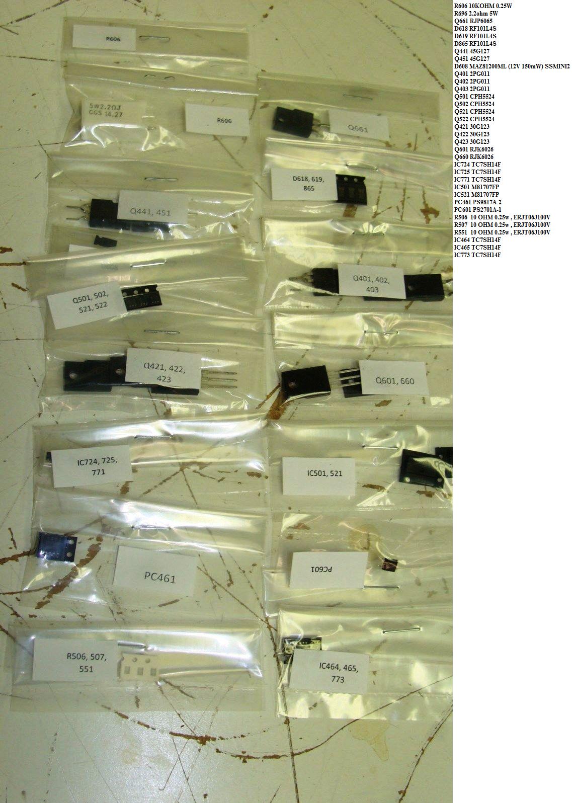

                  This is a 4782 kit with 34 parts looks to be the SJ kit
                  R606 10KOHM 0.25W
                  R696 2.2ohm 5W
                  Q661 RJP6065
                  D618 RF101L4S
                  D619 RF101L4S
                  D865 RF101L4S
                  Q441 45G127
                  Q451 45G127
                  D608 MAZ81200ML (12V 150mW) SSMINI2
                  Q401 2PG011
                  Q402 2PG011
                  Q403 2PG011
                  Q501 CPH5524
                  Q502 CPH5524
                  Q521 CPH5524
                  Q522 CPH5524
                  Q421 30G123
                  Q422 30G123
                  Q423 30G123
                  Q601 RJK6026
                  Q660 RJK6026
                  IC724 TC7SH14F
                  IC725 TC7SH14F
                  IC771 TC7SH14F
                  IC501 M81707FP
                  IC521 M81707FP
                  PC461 PS9817A-2
                  PC601 PS2701A-1
                  R506 10 OHM 0.25w , ERJT06J100V
                  R507 10 OHM 0.25w , ERJT06J100V
                  R551 10 OHM 0.25w , ERJT06J100V
                  IC464 TC7SH14F
                  IC465 TC7SH14F
                  IC773 TC7SH14F

                          just realised there's at least 1 part not shown, Q702
                          i would add Q701,702 , 818 to the list. I was wondering why SJ had a count of 35 and this only had 34
                          also these can get taken out when ic521 shorts out
                          ic561,562 tc74vhct541a
