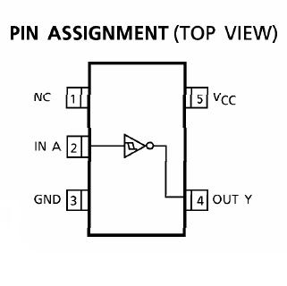

                    this is probably not accurate but i found when they blew vcc - gnd would be shorted. Do you know what it is and have data sheet?
                    Also the 4844 is a cut down version of the 4782
                    https://www.badcaps.net/forum/showth...ghlight=2pg011
                    i know what I've done, I have IC1677 but will be IC1677xx, will have to check
                    P fet is right next to the end of one of the heatsinks SMD, will be Jxxx on it
                        No, but I recall reading about it in your other thread.

                                  All check over limit.
                                    Yeah, ok but what is OL? I would have expected some resistance there that was measureable. on the 5081 boards I think around 6k
                                    • lookimback
                                      • Aug 2013
                                      • 1489
                                      Re: Panasonic TC-P42S1 10 blinks, bad SC maybe solved.
                                      I checked them again and got 5k. That's weird. Maybe I just didn't press hard enough with the probes.
                                      ------------signature starts here------------
                                      • tw2005
                                        • Oct 2011
                                        • 6458
                                        sounds more like it. I think the protective coating on the board causes that. It's happened to me plenty. So 5k exactly or a bit more? Sounds like it's ok. All those feed off Ic771 so that would also mean the other would read the same. i would check vin -vout resistance to be confident ic771 is ok.
