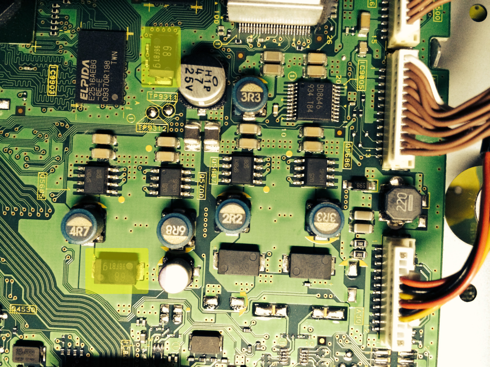

                                      lookimback, When you power on the TV does the fans spin up then stop? (My TC-P42S1 fan does not spin up at all).
                                      The two yellow shaded diodes are shorted. Any ideas?

                                        Yes, only for a second though.

                                          you might be better off starting a new thread on your TV. they're 68uf 4v caps
                                          C5689 sits across the sub 3.3v line, C9989 sits on the P1.8v_DDR2
