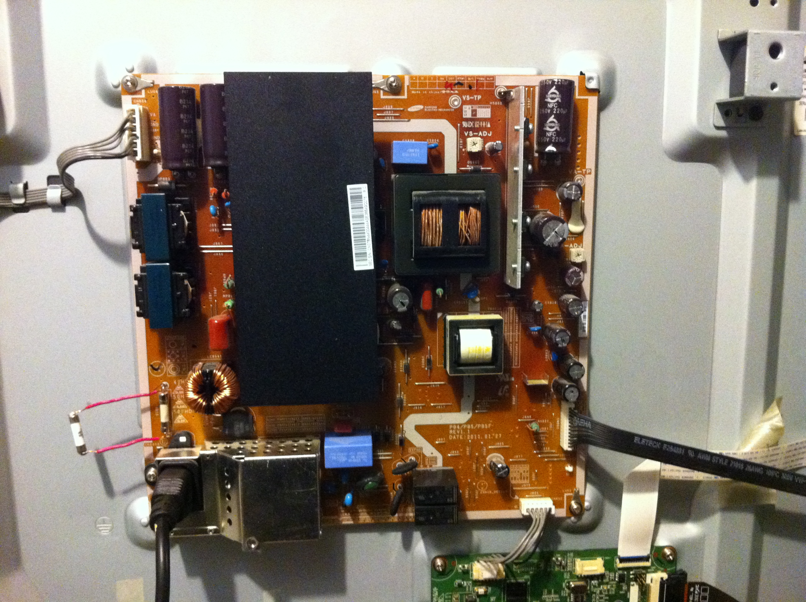

    When I got this 3D TV it was dead, I opened the back cover and found the fuse was blown. After doing quick inspection on the PSU, I found apparently no shorted components in the heat sinks and the capacitors looked ok. I replaced the fuse and plug the TV and for my surprise the fuse didn't blown.
    When I plug the TV I can hear the relays, the red LED blinks 6 times and the LED will flash in response to the remote control, despite that the TV will remain dead.
    When I do some voltage testing with everything plugged I don't get any VS or VA, I get PS-ON=0.18V, VS-ON=0V and all other low voltage seen to be ok (STY, D15.V, 5V, etc.}
    When I try to run the pattern test doing the jumper (PS-ON to GND), jumper 3 &4 pins and disconnecting the LVDS to the main board nothing happens, the only change I see is that the PS-ON goes from 0.18 volts to 0 volts.

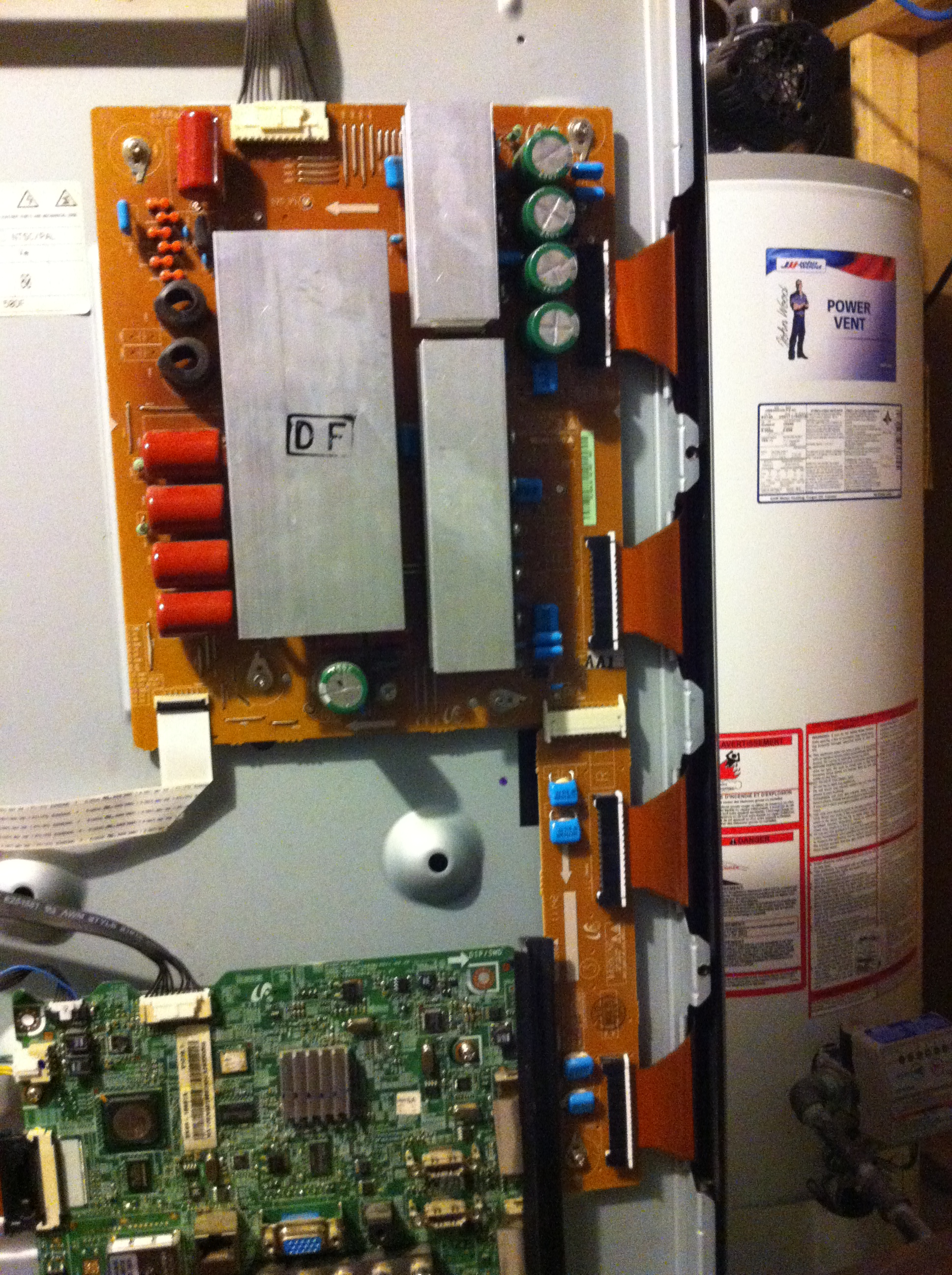

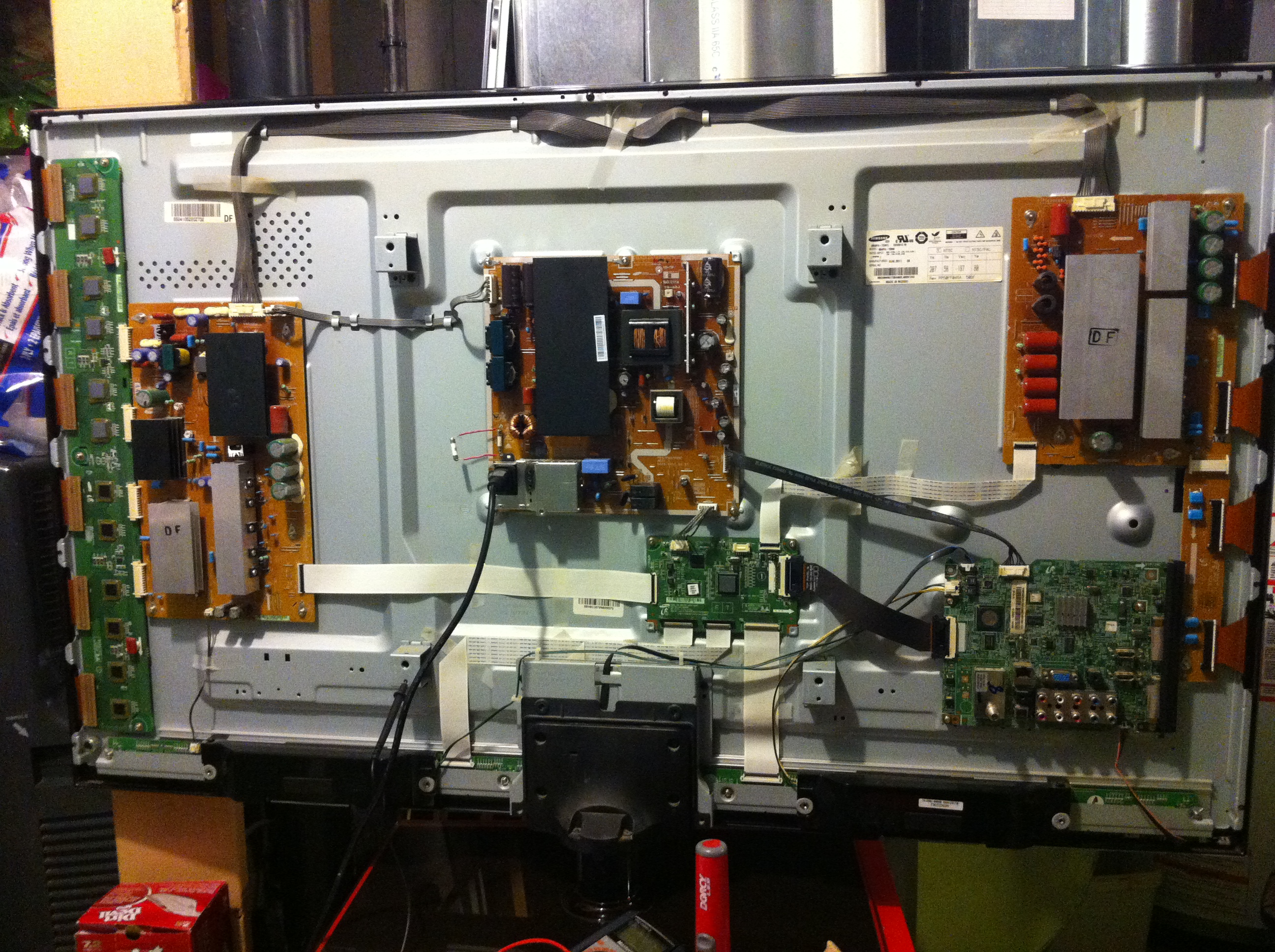

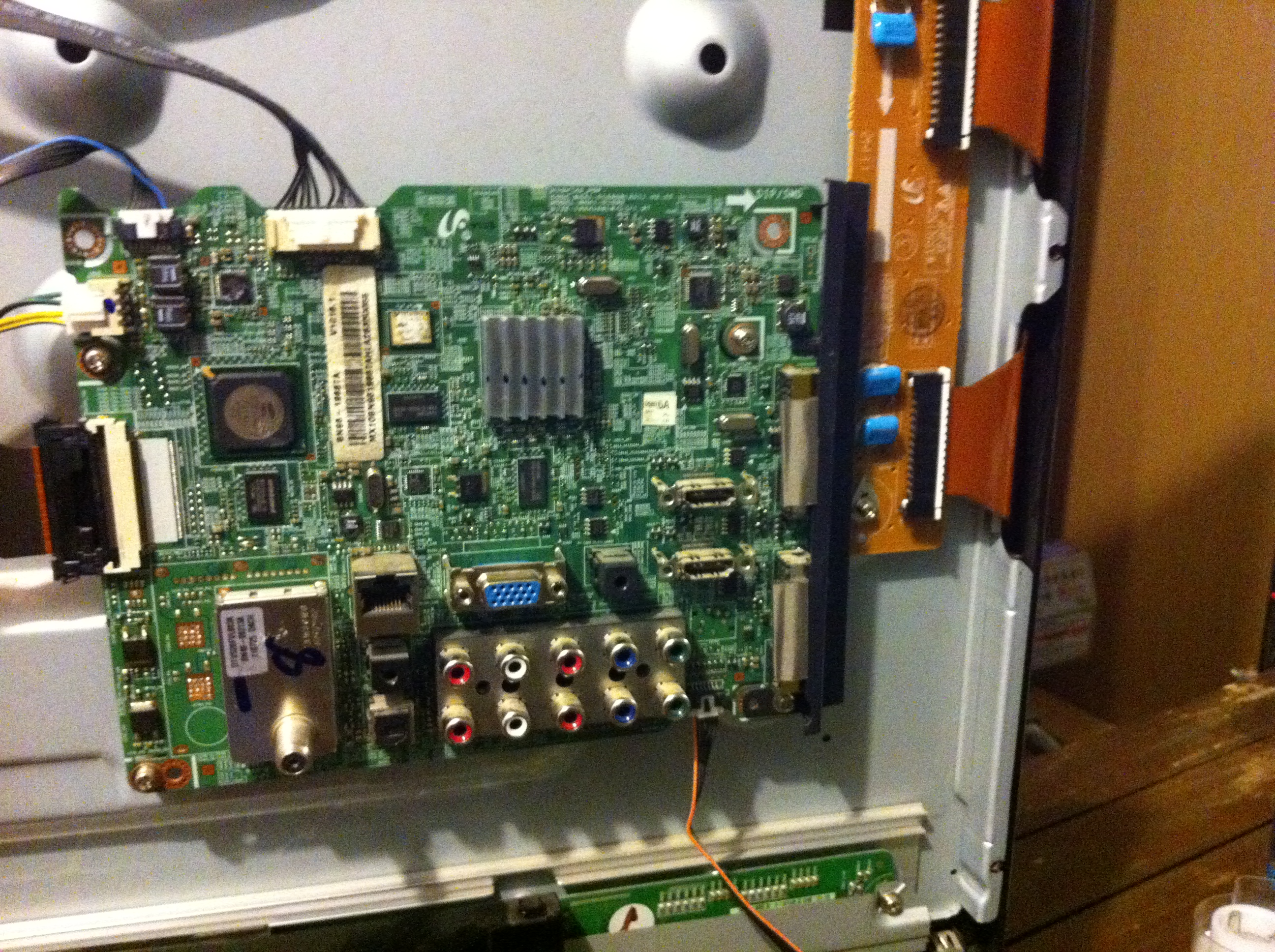

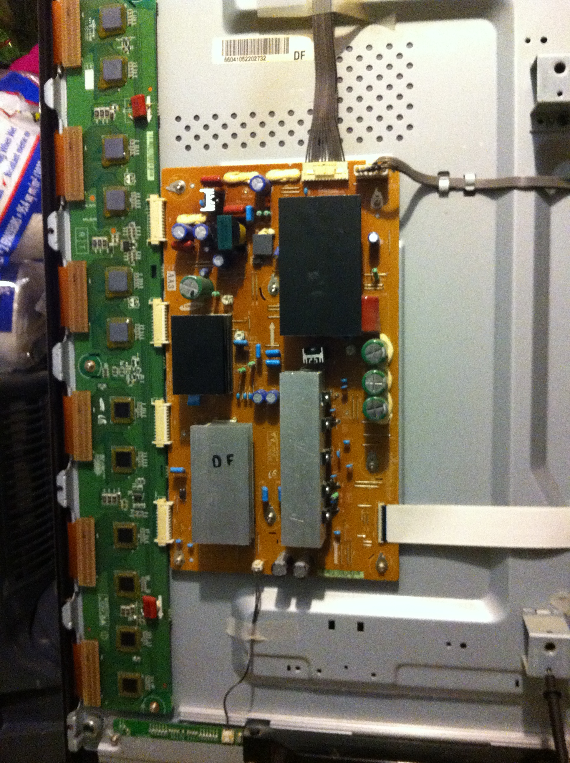

    I have attached some pictures.
    I am not sure if there is something wrong with the PSU, logic board, or both, if it is not something else?

    On these sets the you need to monitor the vs or va right when the tv is turned on. If there is a fault (and I suspect a shorted buffer ic ) The voltage will only come up for a sec. and shut down.
    I found disconecting the buffer board from the Vsus resulted in the same problem as the vs and va would not stay up. On mine I found one shorted buffer ic, replacing the complete buffer board restored the tv to working condition. If you remove the buffer and check with your ohm meter from the ground on the buffer (usually pins on the white plugs connected to the large ground trace) and to any of the pins on the connectors that go to the panel.
    If you read any shorts from the panel connectors to ground, that buffer ic is shorted.

      there are some diodes mounted to the heatsink to220 case 3 legged, check them for open or short. if one or both go bad there will be no high voltages. should be near vs, va testpoints if I remember right. only one has to be bad to cause this. I have a post on a pn50a550 somewhere on here with the replacements listed.there were some revisions to the d model powersupply but should still have the diodes.

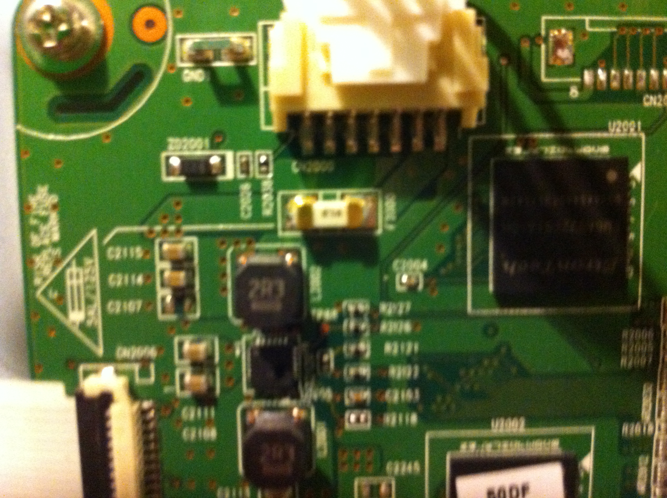

                      Thanks Tom66, I think I might have found something.

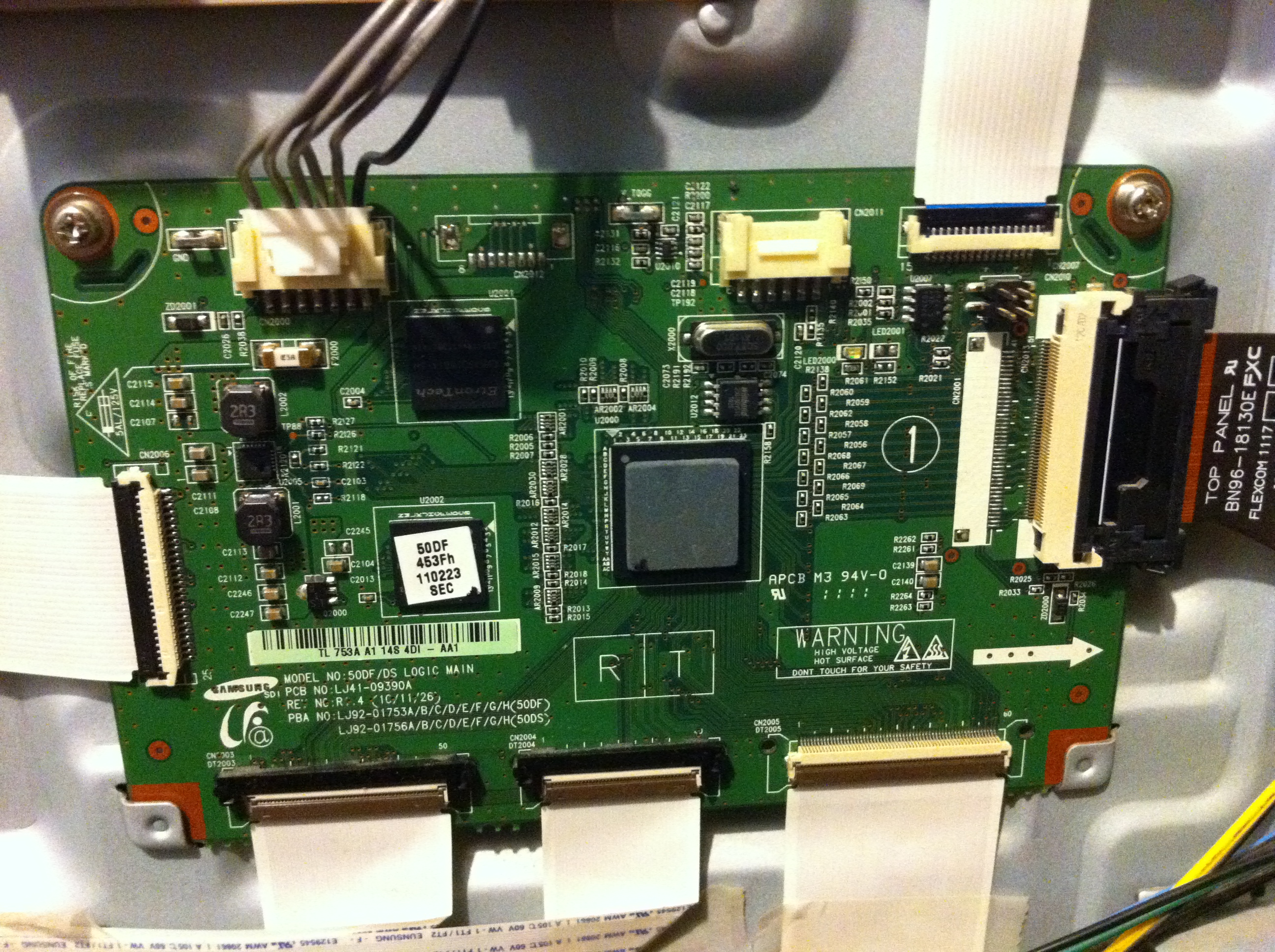

                      No matter what I did when I was trouble shooting the TV: I wasn't able to get the 3.3V of the VS-ON on PIN 6 of the connector CN 802 (the one that connects the PSU to the Logic Board) in order to turn-on the TV.
                      So I took my multimeter, unplugged the CN 802 connector from the PSU and got what it looks like normal resistance readings to GND on PINS 1-5 but on PIN 6 I got only 9.98 k-ohms which might be too low and might be also what is causing the VS-ON to stay at 0 volts.
                      Also just underneath the connector in the Logic Board I found a small SMD fuse with white body and golden metal plates on each side. It is labeled as F2000 LF5A (see the picture), which is open and is somehow connected to the PIN 6.
                      If someone have it handy, it would be great to verify the fuse and the PIN6 to GND resistance readings in a working logic board.
                        Re: Samsung plasma PN51D550 bad PSU or bad logic board?
                        VS-ON will be driven from the main CPU on that board, which will turn it on or off, so I wouldn't expect to see significantly low resistance to either supply rail.
                        Are you saying the fuse is blown?

                          Tom66 yes, it is blown. I tested in continuity/diode mode and got an OL.
                            I would try replacing it, see if it blows again, sometimes fuses fail for no obvious reason.
                            As a quick test you could find a car fuse of approx the right rating and solder that across the existing fuse with some wires.
