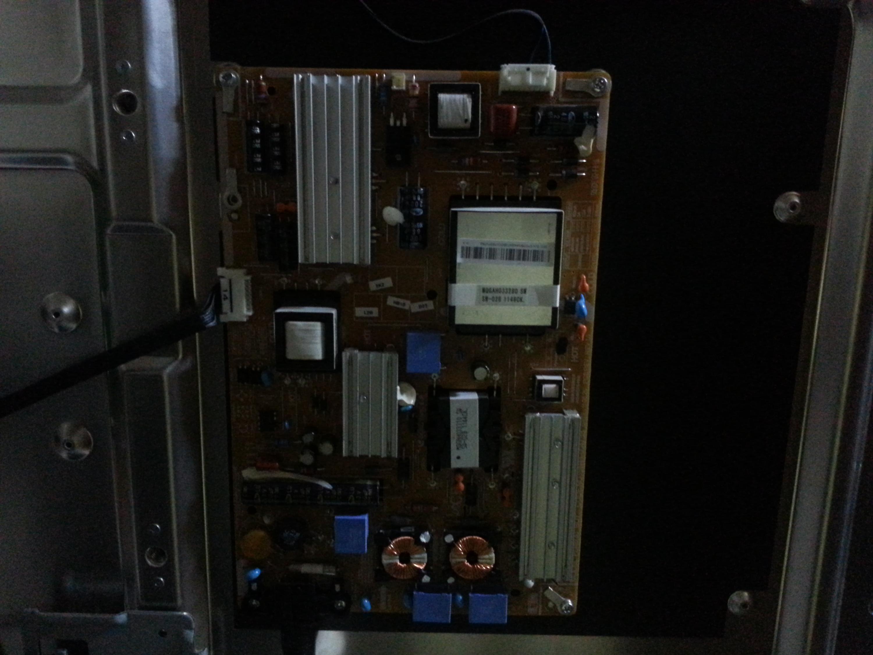

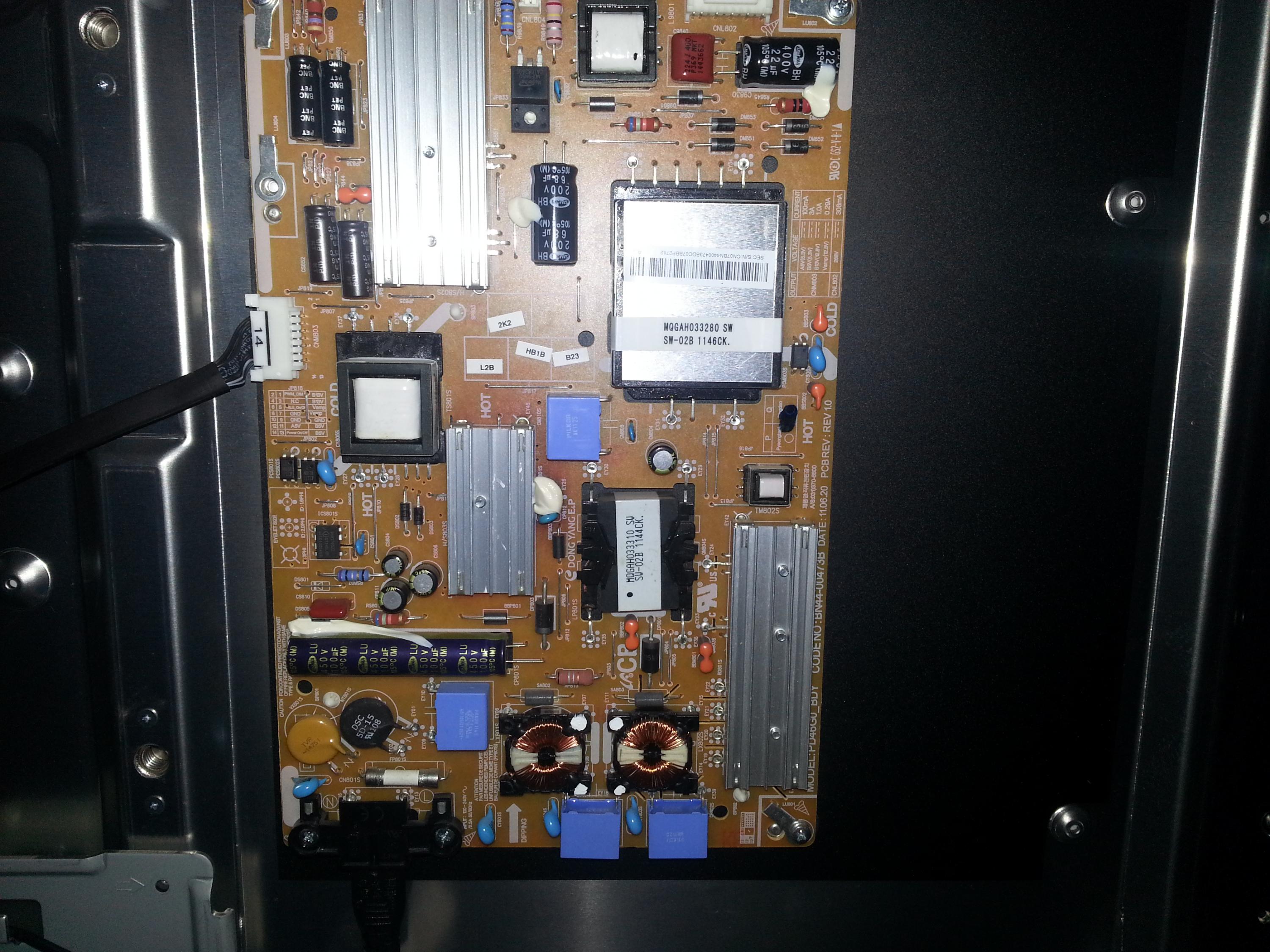

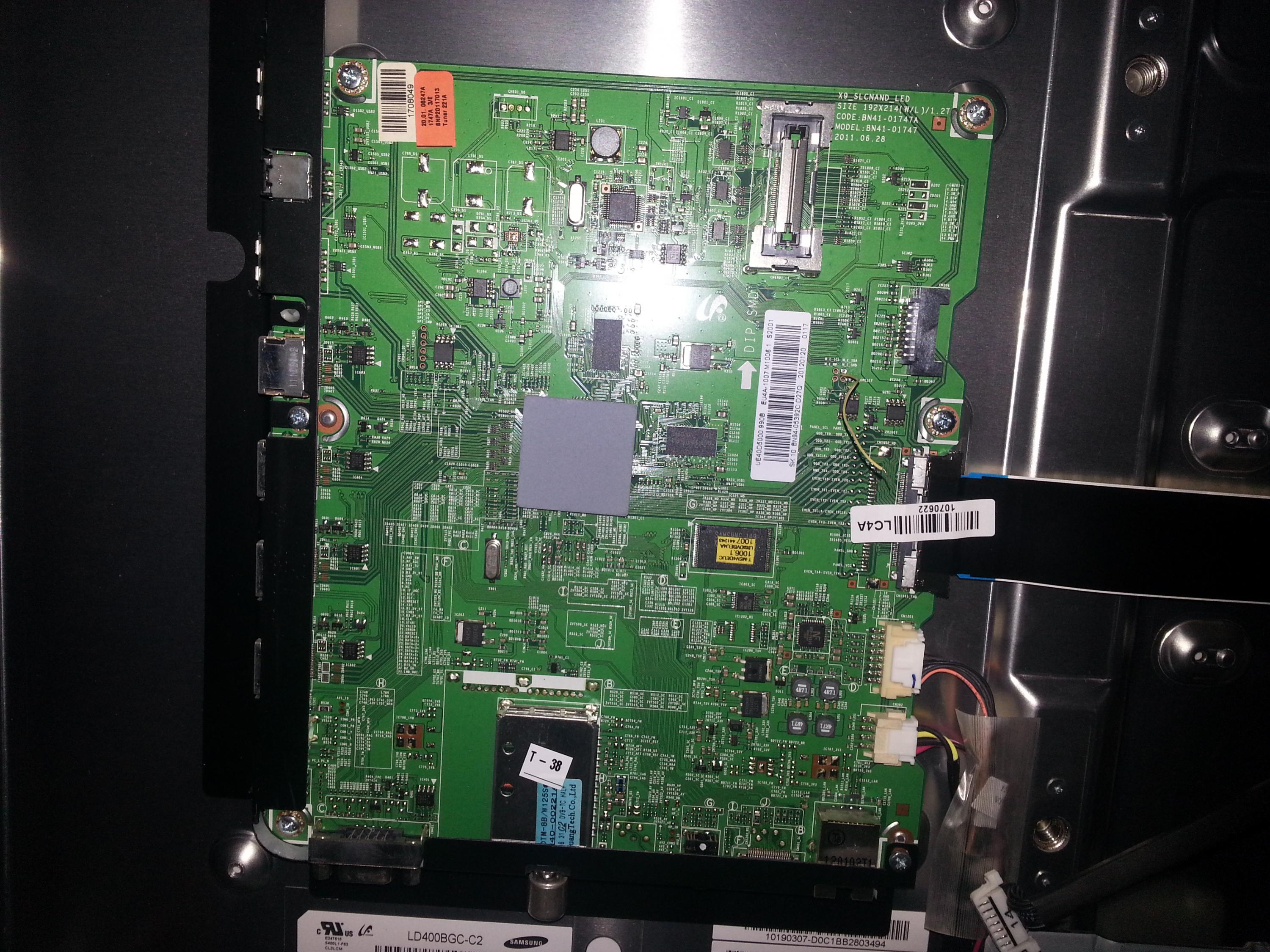

    I have an UE40D5000 that does not start and the red light is blinking... I can also heard a sound that seem to come from T-con board or panel :s...
    I changed the PSU, the main board and the T-con board, so I'm without new ideas!
    If somebody has any idea on what I can do to solve this problem ??

        Re: UE40D5000 red led blinking (PSU, Main board and T-con changed)
        Ok, disconnect the cable between the main board and power board. Does the backlight come on?
        • wilecoyote
          • Jan 2015
          • 6
          • FRANCE
          No, the backlight stays off... Should I search for a backlight problem ??
            To me that indicates backlight fault (power board or LEDs inside panel)

                        • ReeceyBurger123
                          Never Give Up !
                          • May 2014
                          • 7325
                          • Britain
                          Images of the boards ? I had the C series blinking Led and restarting failed Bga solder on the mainboard Cpu.
